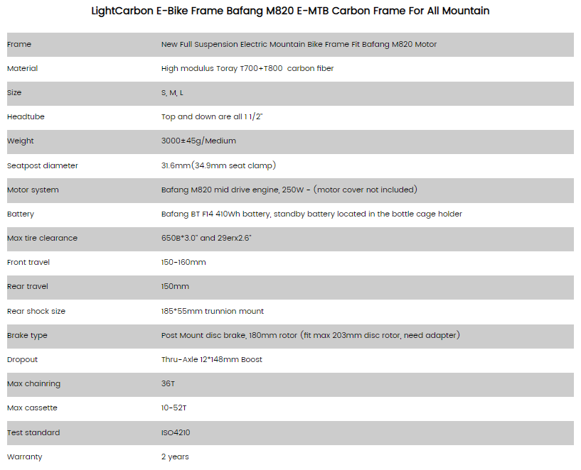

Hmmm..but they are referring to a Bafang Battery BT F014 which is speced on Bafang Workbook, and a completely unknown Battery type ZS BT 740. No info on that available…
Bafang Battery BT F014 produced only 43V. The ZS BT 740 can be manufactured by the 420W and 740W 36V frame manufacturer. The battery is not removable. To remove the battery, you need to remove the motor.

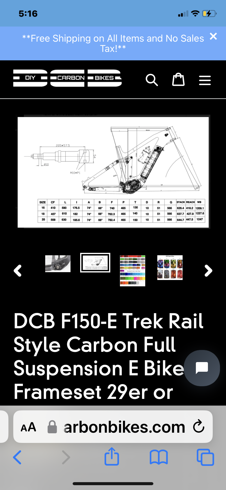

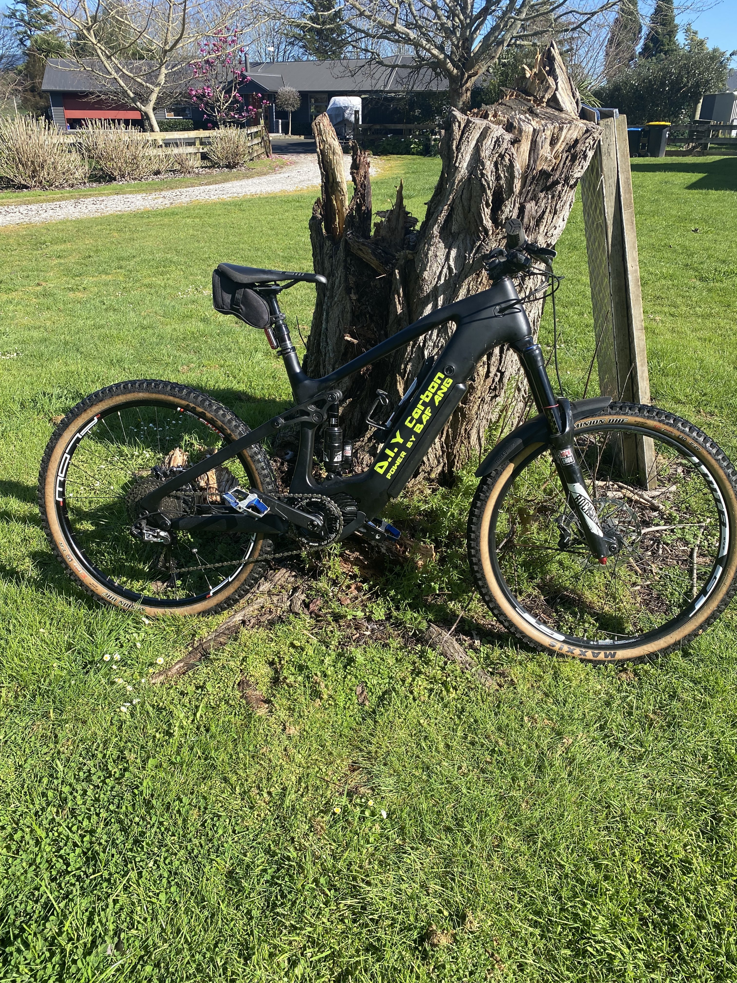

Try diy carbon in the US. I got my frame and m600 set up from Ty and it looks very similar to what you are showing here I wouldn’t rate him as a customer service oriented guy but I got my stuff eventually just no back up.the frame will take the 640 w and 840w BAFANG battery.
It handles well and seems to have good geometry.plus came in at 20 kg with the smaller battery I have it on 27.5 s and 170mm up front and 160 on the rear

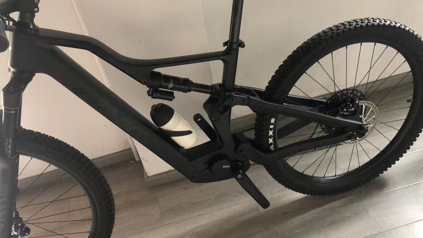

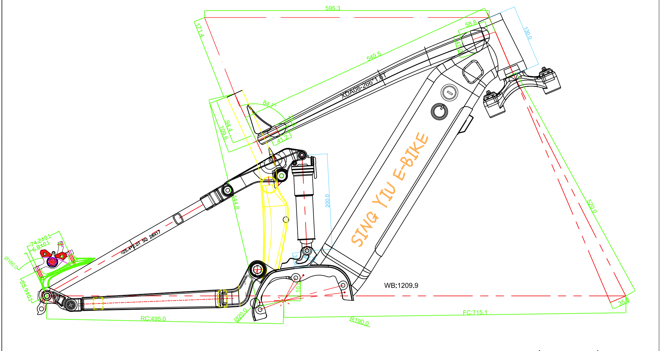

Take a picture of your frame. Does the framework have a specification?
Here you go on specs and the quality is actually pretty good they take a 180 mm rear disc and I did fit a 215 rear shock and just had to grind the pivot trunnion out and turn the shock upside down
A6169BE0-2495-4945-A714-1C3AA0964CCF.png 53A88A4B-A57E-41AC-A86E-0E9F957B0502.png 92069F9B-A0D2-4721-BAF5-67F90CC921D7.jpeg

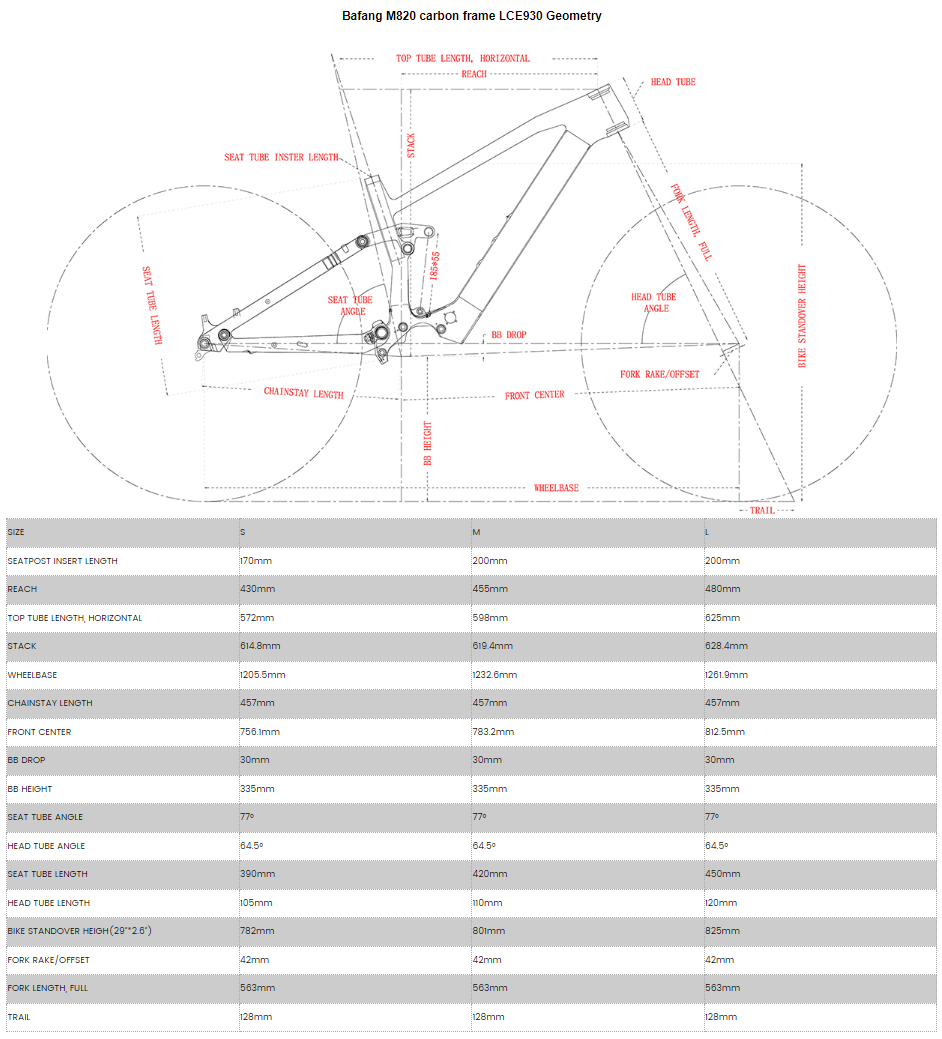

You're comparing apples with lemons, this has nothing in similar to the frame Lanton shared, bigger motor, heavier, 100% diff geometry, etc. You can compare it with the LCES004 from lightcarbon maybe.
Probably the only thing that's the same is the linkage.
The geo of that frame is not really modern in my opinion. Short reach and slack seat angle / steep steering angle.

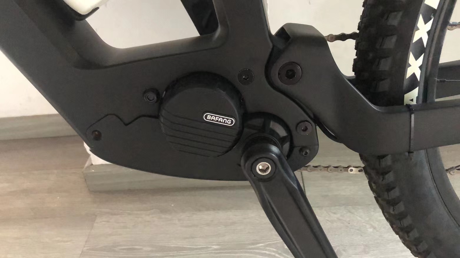

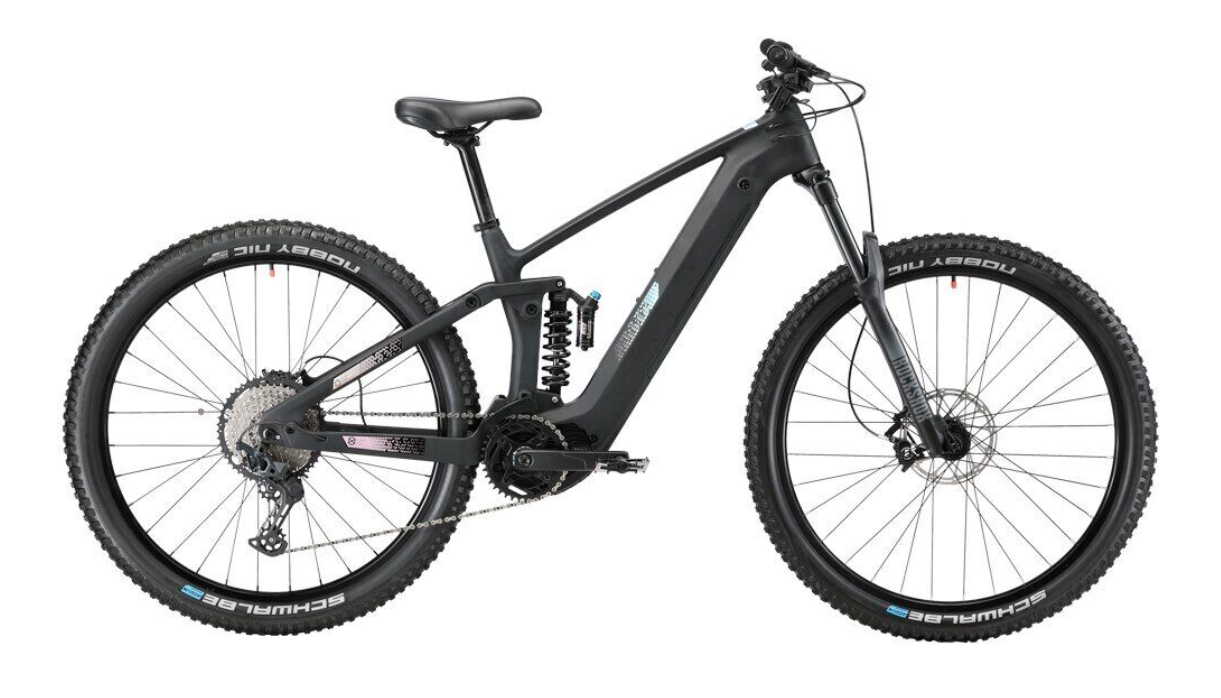

My first electric bike was with a triangular handbag and a carriage motor on the frame, it did not cause inconvenience. A small and lightweight battery that is easy and quick to replace in the mountains, I find convenient. A non-removable battery or a removable battery as in the photo is very inconvenient. Who do you think makes this frame?

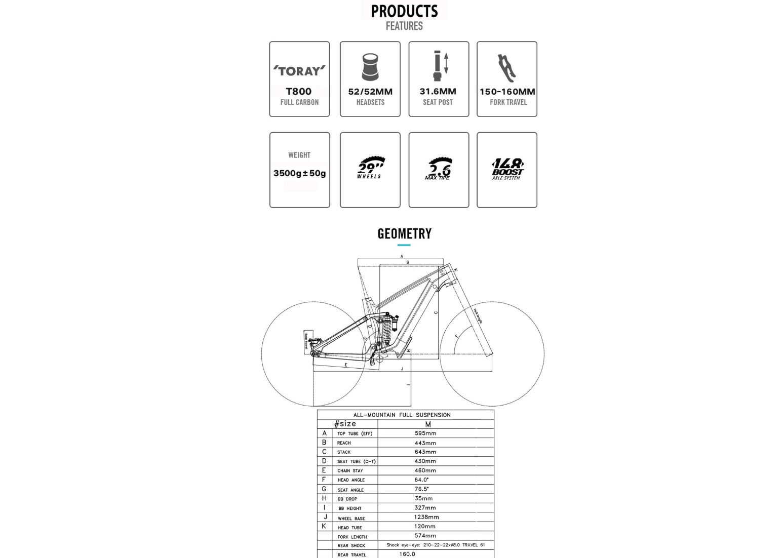

Very similar to dengfu. I don't like this design. The battery must be removable. I wonder how much this frame weighs. They don't give me this information, only photos.

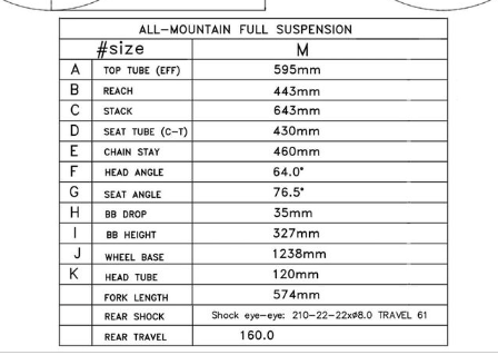

I saw this somewhere already. Remember the extremely low BB @ 327mm. Looks like the Kabon
€ 922,34 30% Rabatt | KABON Neueste E-Fahrrad Rahmen Mtb T800 Carbon Faser Elektrische Fahrrad Frameset Interne Kabel Hinten Motor Drive mit Batterie fall Kit
It doesn't seem there are many longer travel bikes with the bafang M series motors and a BB that isn't too low.
I wonder if you could use offset shock eyelets to raise the bb a little? Or a slightly longer eye to eye on the rear shock?
Original spec shock length is 210/61 mm. You could use a 216/63 mm shock and finetune the length by using offset bushings.
