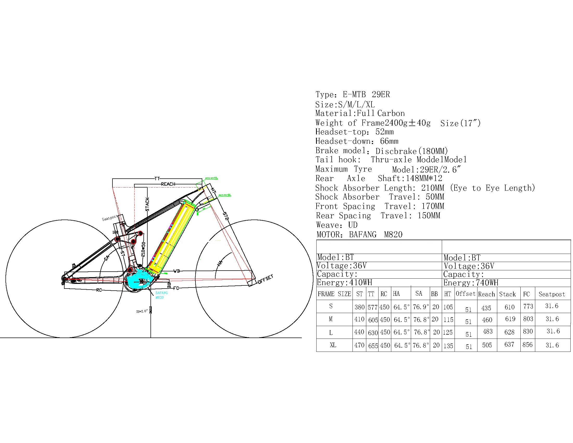

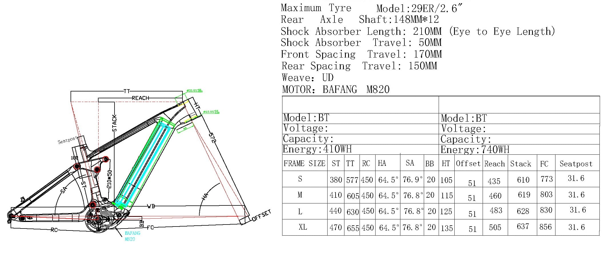

What can you say about this frame? Does she have modern geometry?

Yes, this is quite modern I would say. One thing that surprised me is that they chose to put 740wh battery on a light build. Personally I find that's good, but many will disagree
You can install a light battery bafang F014 410W. But this battery will not be enough and you will have to hang a second one on top, which will come to a weight of 740W. I like the removable battery, then there is a choice.

Because many have a rear wheel of 27.5 and a front wheel of 29. I also have such a set of good wheels. I also have a Pike fork with a 140mm stroke. If you install such wheels and a fork with a stroke of 140mm on this frame. How badly will the geometry deteriorate?

Mullet setup usually slackens things up by about a bit less than a degree. Over forking has similar effect also.

Can You please provide a link or specify manufacturer and model?
I can't yet. The manufacturer asked not to give this information. Soon this frame will be on sale. We will compare three major manufacturers Dengfu, LightCarbon and incognito. And choose the best frame.
