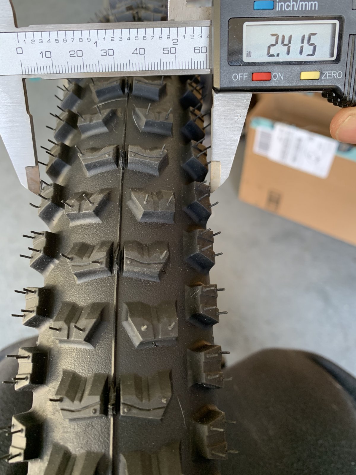

@outerlimits Any chance you can get some measurements of the tread and the casing width? Assuming that you are still on 38mm rims as well? I have been eyeing those tires, but have heard they are fairly small for 2.6

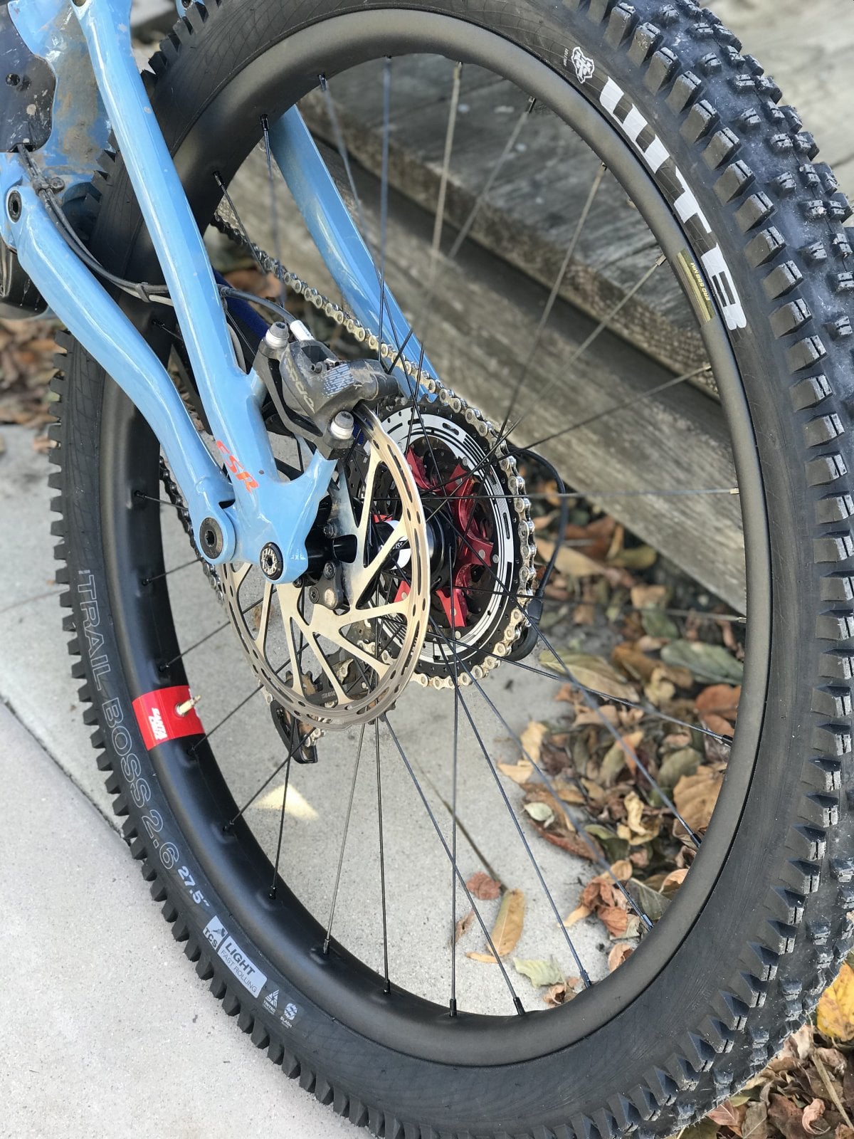

Side note - I have been running a WTB 2.6 Trail boss on the rear of my Kenevo w/ SC Reserve 37. True 2.6 (even slightly wider at tread) on 37mm rims. Other than a pinch flat early on running too low pressure, i have been loving the tire. Rolls great, grips well and is super predictable compared to the stock butcher. Tread wear seems higher than the Butcher it replaced, but I am ok with that given the performance. WTB also sent me a free tough casing to try when I told them about the early pinch flat. Can't complain about that!

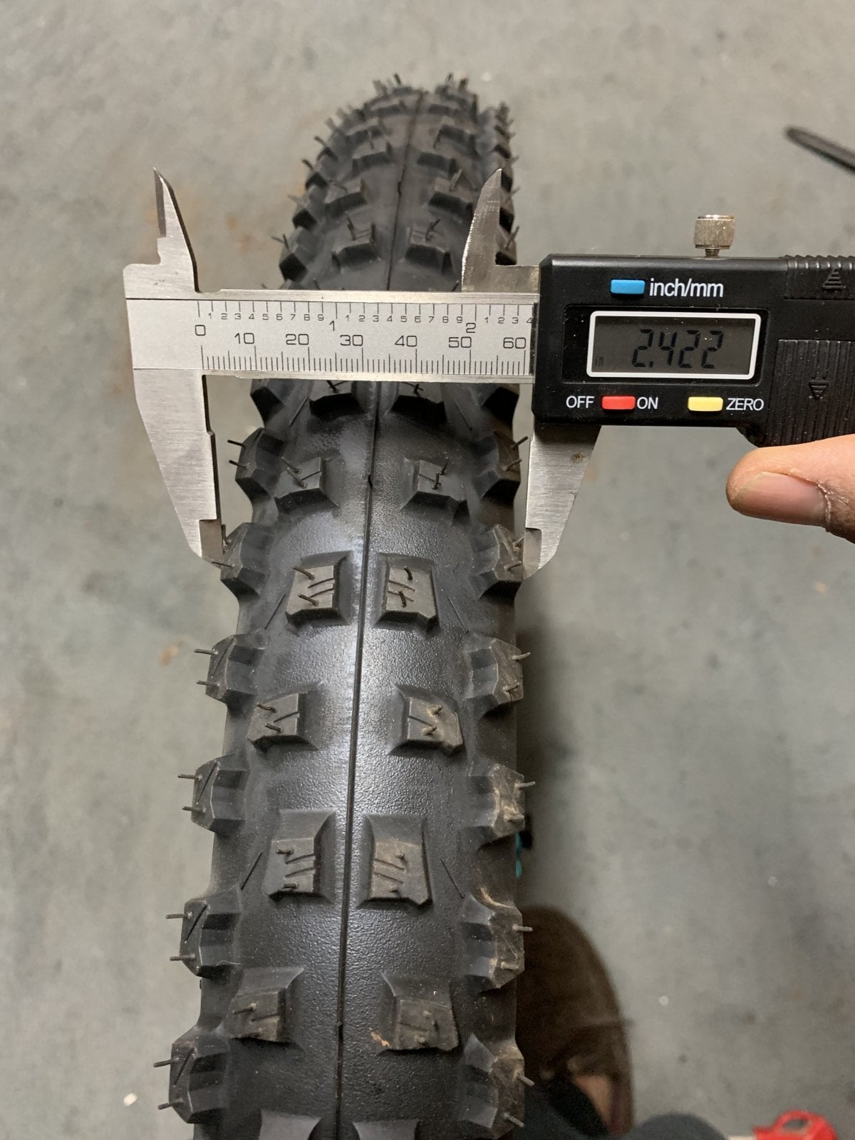

Ok pic of box and quoted figures.
Rear black Dimond case at 26psi measured 69mm at the wall and 63 at the tread.
Front grid case at 22psi measured 66mm at the wall and 61at the tread. Fitted to the standard 38mm inner rims running tubeless.
Must get some stretch as initial fit up at 40psi they measured lower and the tread was wider than the walls.
Time will tell if they are durable or not.
