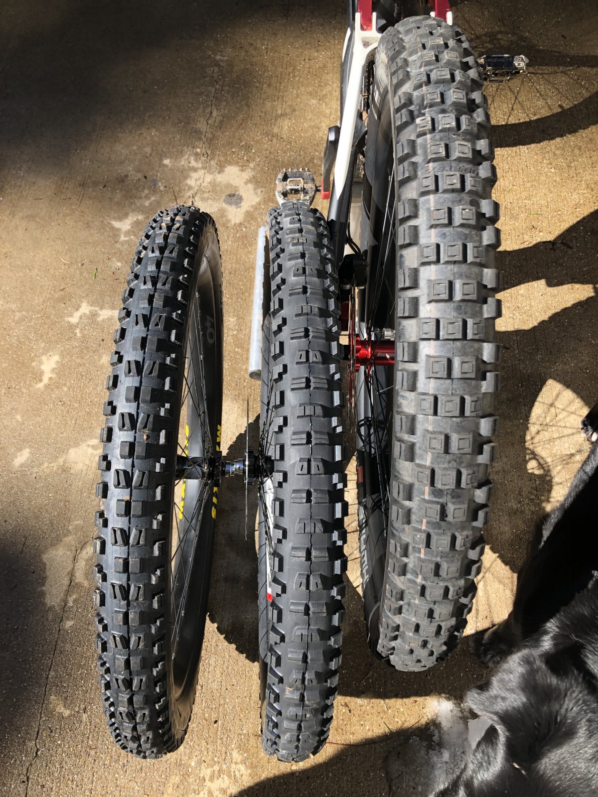

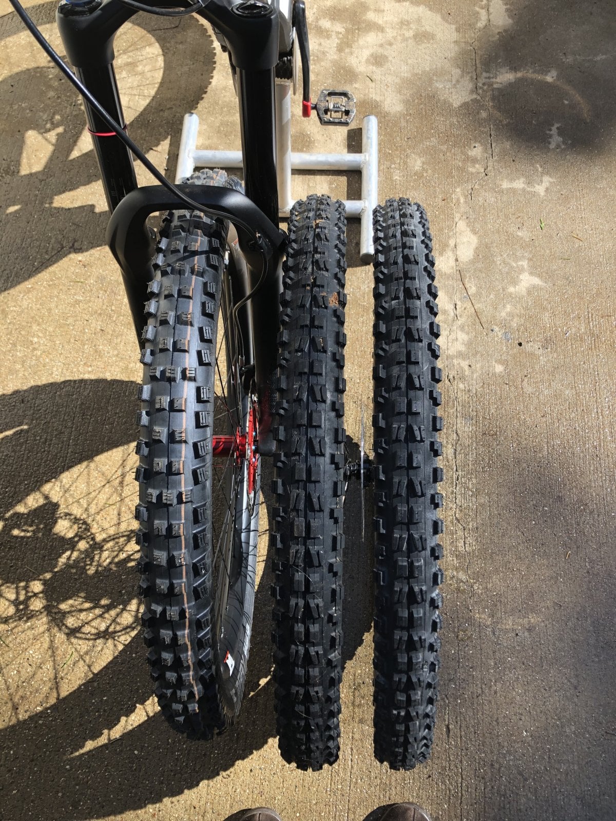

I’m really liking the MM 29x2.6 soft comp adix front with 27.5x2.8 Eddie they surprising leg fast on wide rims. Considerably slower on narrow wheels.
Same tires mounted on 29x30.5-32-35-36.5. Mary was considerably faster rolling on 36.5 and measures exactly 2.6 on the 36.5 rim.
Eddie was mounted on 32-34-36-40-43 ear and it measures 2.8 on 43 and again is faster on the wide wheel.
Looking at the pictures, rear 2.8 Eddie on 43, next is 2.8 DHR2 on 34 and far left is 2.6 DHF WT on a 40
Front, 2.6mm on 36.5 to right is a 2.5 DHF on 35 and far right is a 2.5 DHR on a 30
View attachment 11053View attachment 11054
