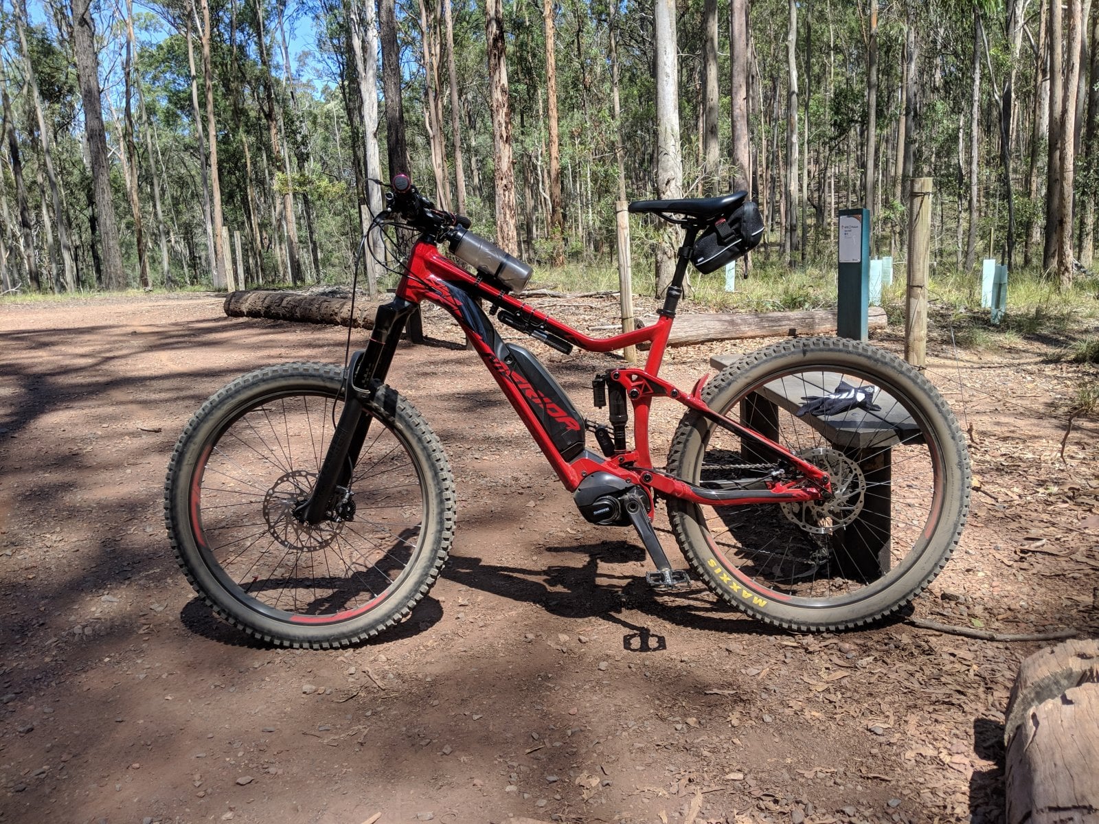

Hey mate, hit the trails today and had a blast. As mentioned DHR2 front and Rekon+ on the rear both in 27.5x2.8. i think there is a marked decrease in drag which will be nice for commute and possible increase battery range. I'll say I'm no professional rider, but no notable loss of rear grip compared to the DHR2. Setup tubeless 17psi/23psi
This is the one i bought here
Obligatory pic below ?
