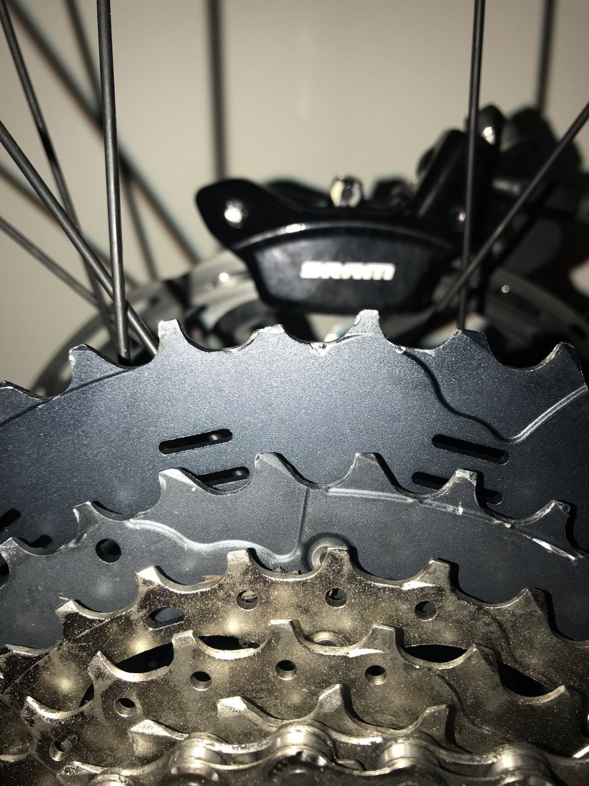

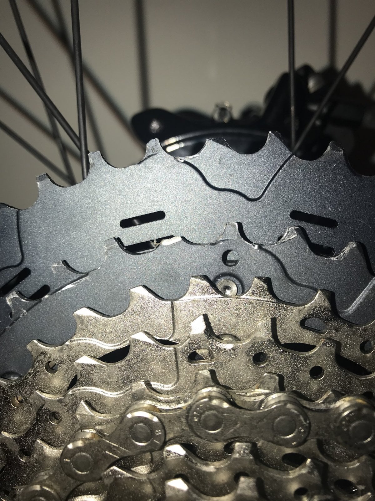

Did it feel like your chain was being dragged off the cassette rather than smoothly slipping off? Mine sounds really painful in some gear changes, like it’s being forced off the teeth.
I've personally had no shifting issues and it's pretty slick for a low end shifter... pretty impressed really as I had low expectations so perhaps yours isn't setup correctly. However I've always been gentle with shifting and was surprised how easy it was to "feel the shift tension" on an Ebike and it's easy to control the strain level as you shift.. not too dissimilar to a normal bike really. So far I've found being caught out in the "wrong" too high a gear is mitigated by the motor somewhat.
