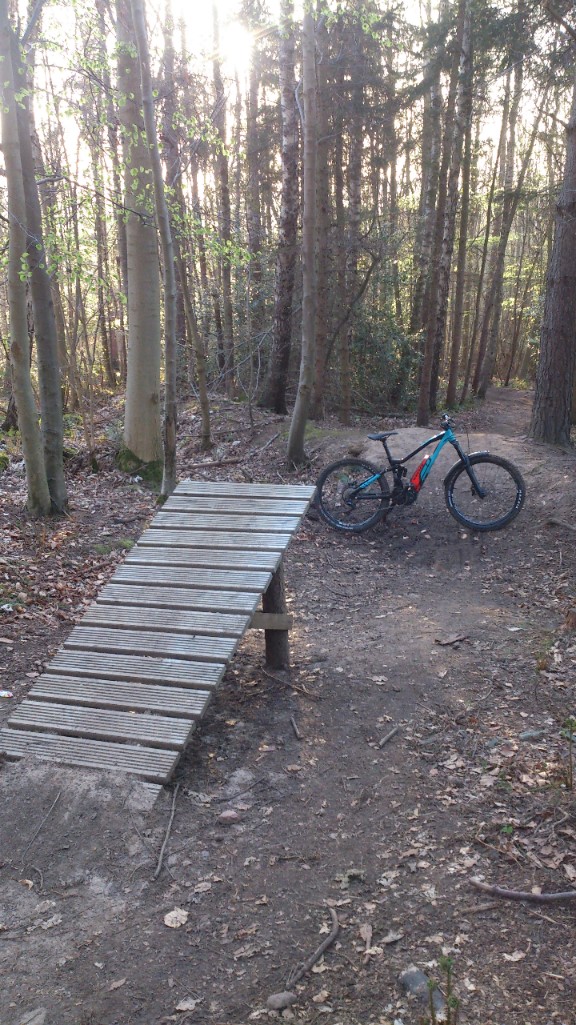

Here's an E-bike in the gap between a 25ft jump from today
same jump different perspective ;)
Sorry. I have no action shots. I had the place completely to myself. and barely know how to work my phone's camera nevermind work out how to get pics/vids of yourself riding.

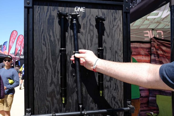

just saw this pic on single track, shows that the One Up Dropper has a shorter static body than the reverb:
Sea Otter 2018: OneUp Components New Tools (And Dropper)
"The final thing that OneUp wanted to show was the comparative lengths of its posts. As well as having an option to have an in-between drop, perhaps if the longest drop post option is just 10mm too tall for you and your bike, it also has a shorter static body than some other posts, seen here with a RockShox Reverb (also with 170mm drop) for comparison"
Also it appears you restrict/set the max extension with the shim sytem they supply - very intresting:

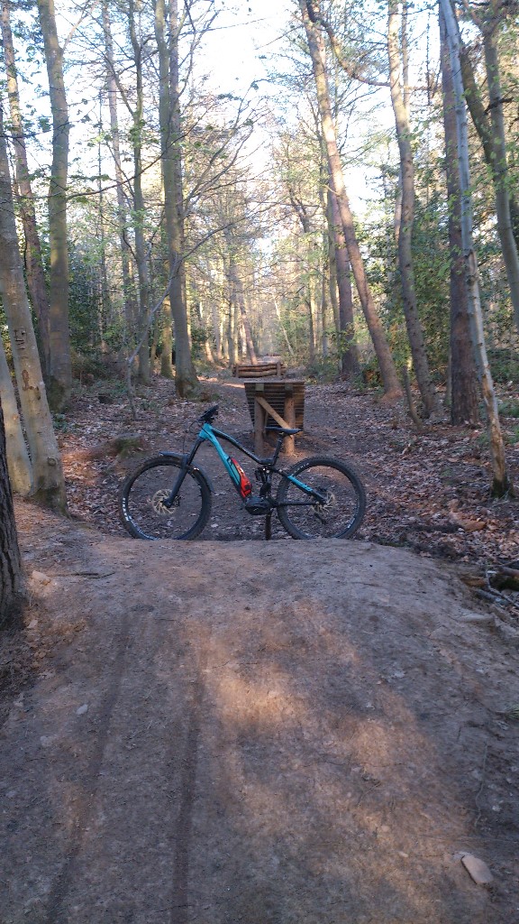

Talking of the bike. My car was in the garage overnight last night so this morning I commuted to work on the Sommet. With the new tyres fitted the bike rolls so much better it's actually noticable when you exceed the motors limit on the flat. To my work it's a 10mile commute with a couple of short sharp hills and the ride normally takes me around 35mins on my roadbike not murdernig myself but putting in a fair effort. As I was riding an mtb I went off road (doubletrack, singletrack and farm roads) for the first 2 or 3 miles. The commute took 40 minutes. I knew the roadbike aws faster. The difference was I wasn't even sweaty when I arrived.
After work I had an hour and a half free while my youngest was at football training so I did a local XC loop on it too. 13.5 miles of mainly dry woodland trails (fairly flat with one technical muddy rooty loop). The new tyres have transfomed it's playfulness. the 3C were too draggy but also so grippy it was a major effort to make traction break free when I wanted the bike to drift. Now I can break traction in corners at will. in the mud/roots in boost this is sooo much fun it's unbelievable. power wheelying and drifting while pedalling is amazing fun! :D
I hit a small tight set of dirtjumps the local kids ride as I cut through one wood and.. .erm... Yeah.. .well.. .this bike's still shit at that... I over jumped one so had to pump hell out of the next transition to make the next gap but ended up supercasing the next landing. (I built the jump years back so didn't feel too guilty ;)
