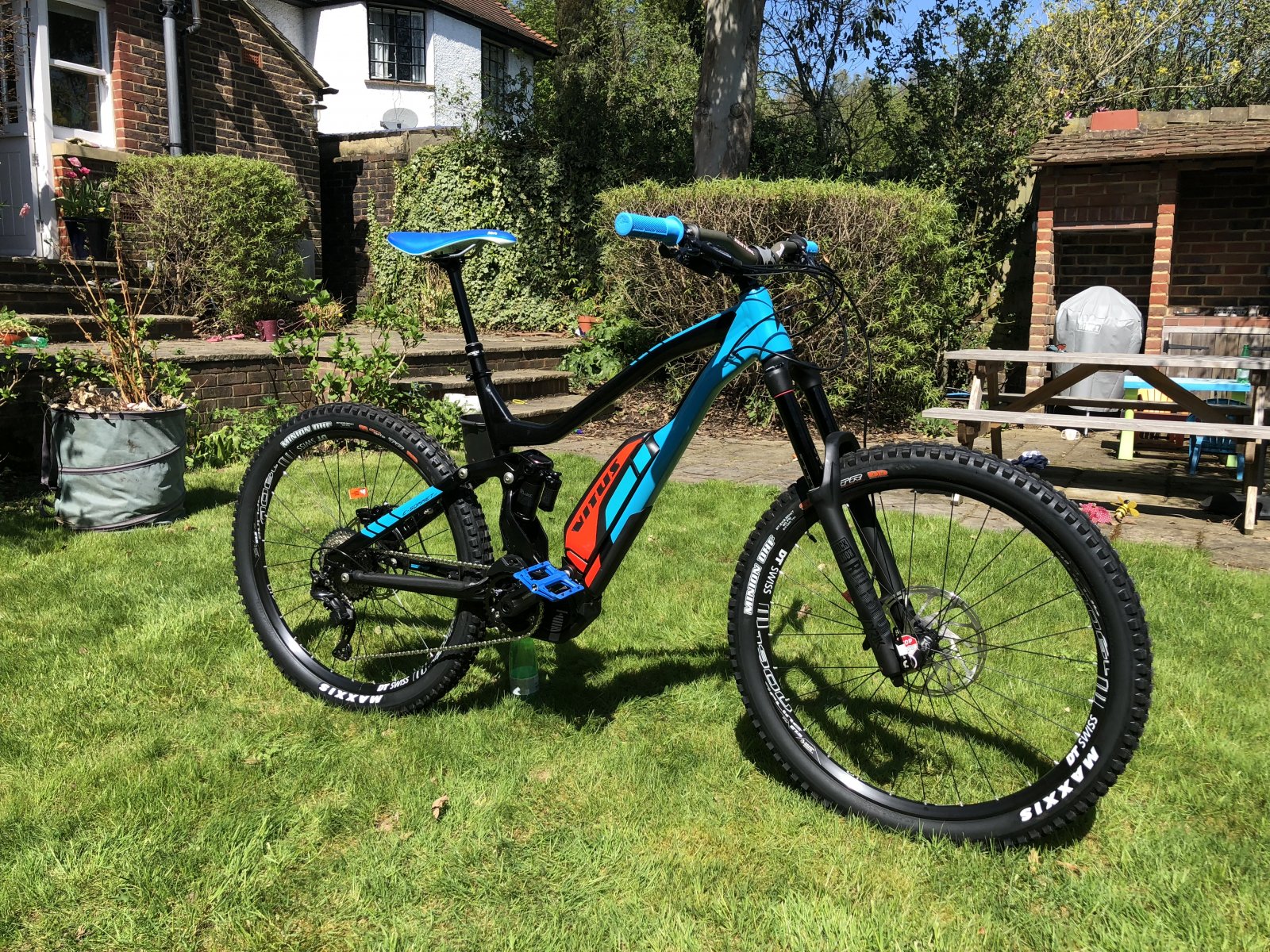

Vitus E-Sommet VR
Fresh out the box, with a few mods . .

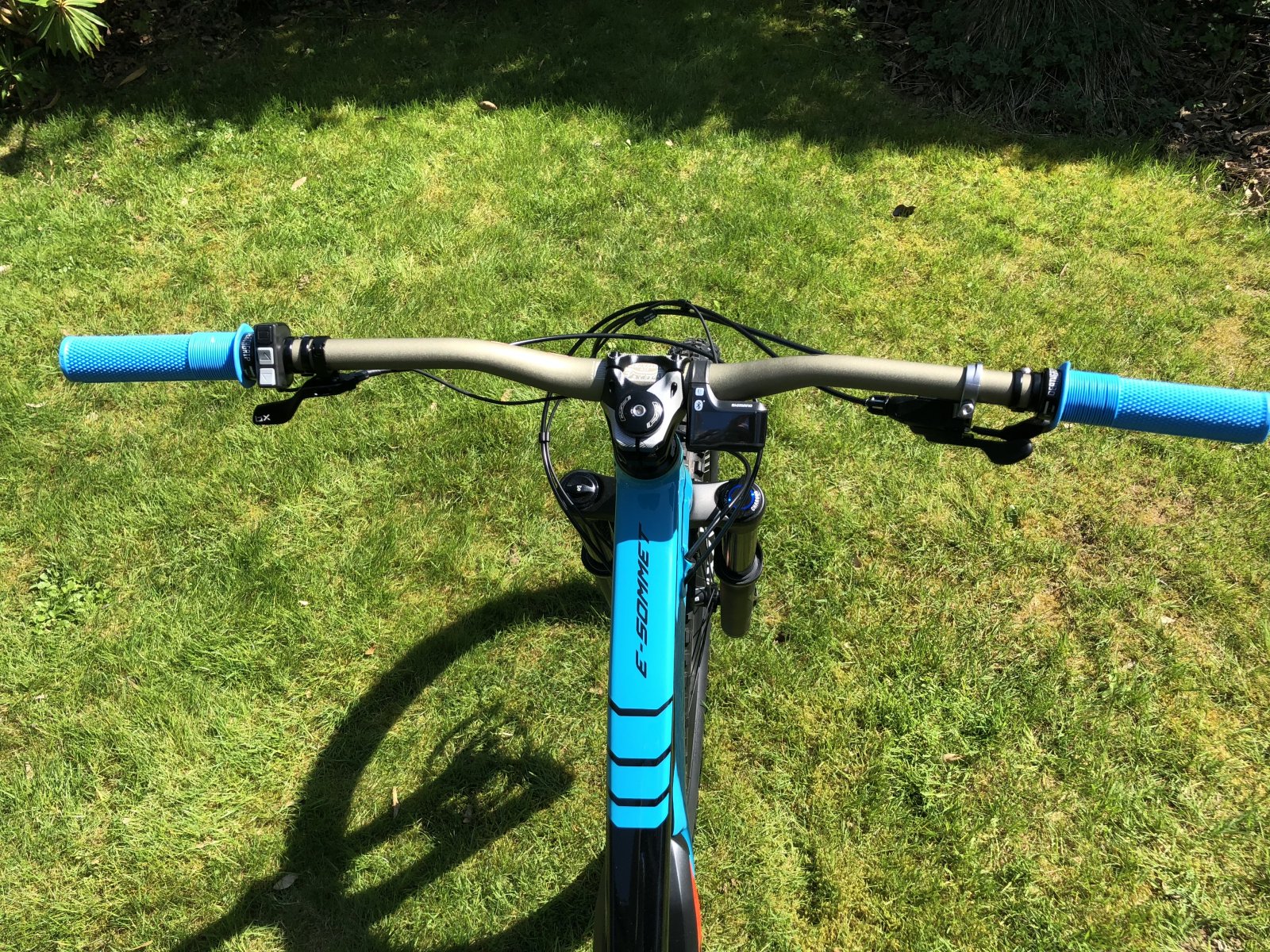

DMR Deathgrips
E6000 Controller
30mm rise Fatbars

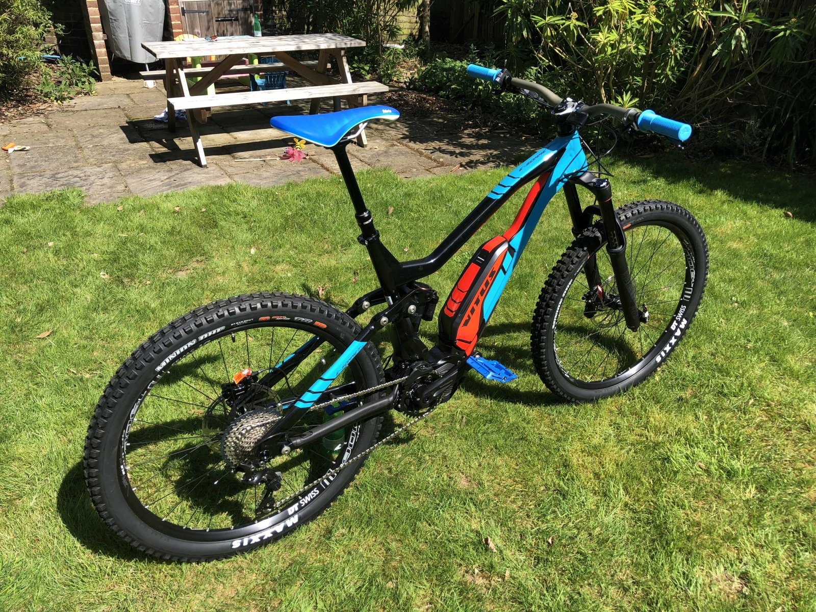

Fabric Scoop Cell saddle (not sure about the blue looks wise but comfiest saddle i own)
Nukeproof Neutron pedals
Fractured ankle prevents testride, but initial thoughts are in needs a dropper post that i can insert further.
Looks a lot better in the flesh than i was expecting, and PDI'd well be CRC.

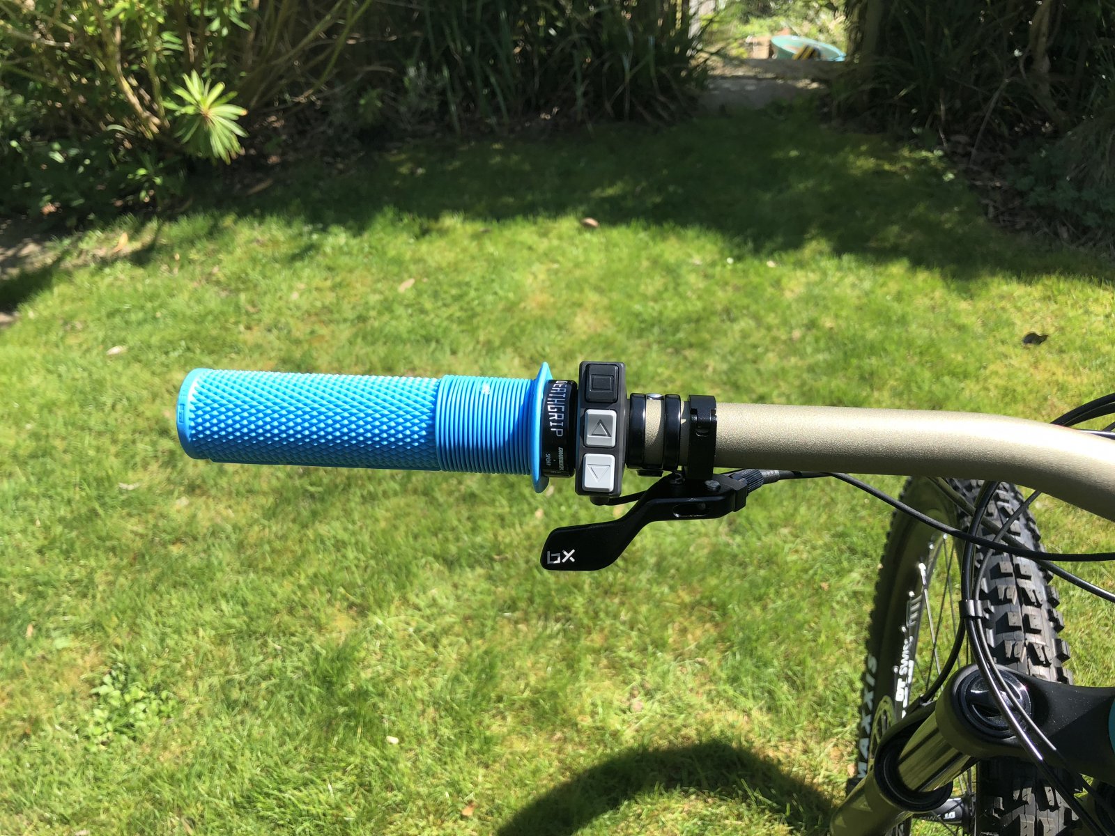

how's that E6000 controller? does it have a positive click on the buttons or more of a soft push.
I'm really not feeling the love for the paddles on mine right next to the important remote ;)
Re dropper length , my medium vitus came with a 150 dropper , its great for me at 5’8 but it’s as low as it will go and don’t run a low seat . Anyone a bit shorter would have to change to a 125 post , that’s in a reverb which generally have one of the more compact insertion lengths .
Could be worth asking chain reaction if it could be exchanged before purchase for potential future buyers . Looks like a superb bike , incredible value compared to most others out there .
E6000 controller does have a positive push and click, nice bit of kit and under 50 quid, you just unplug the e8000 unit from the display and plug in the e6000.

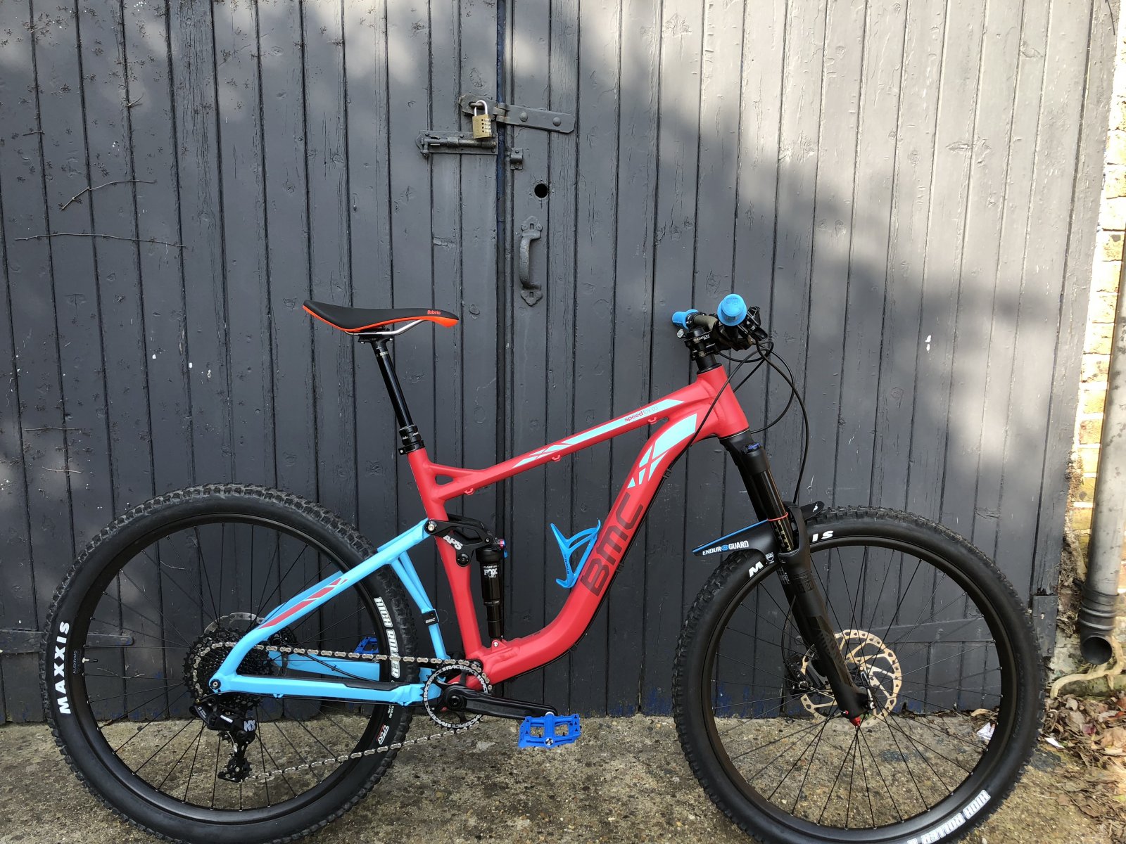

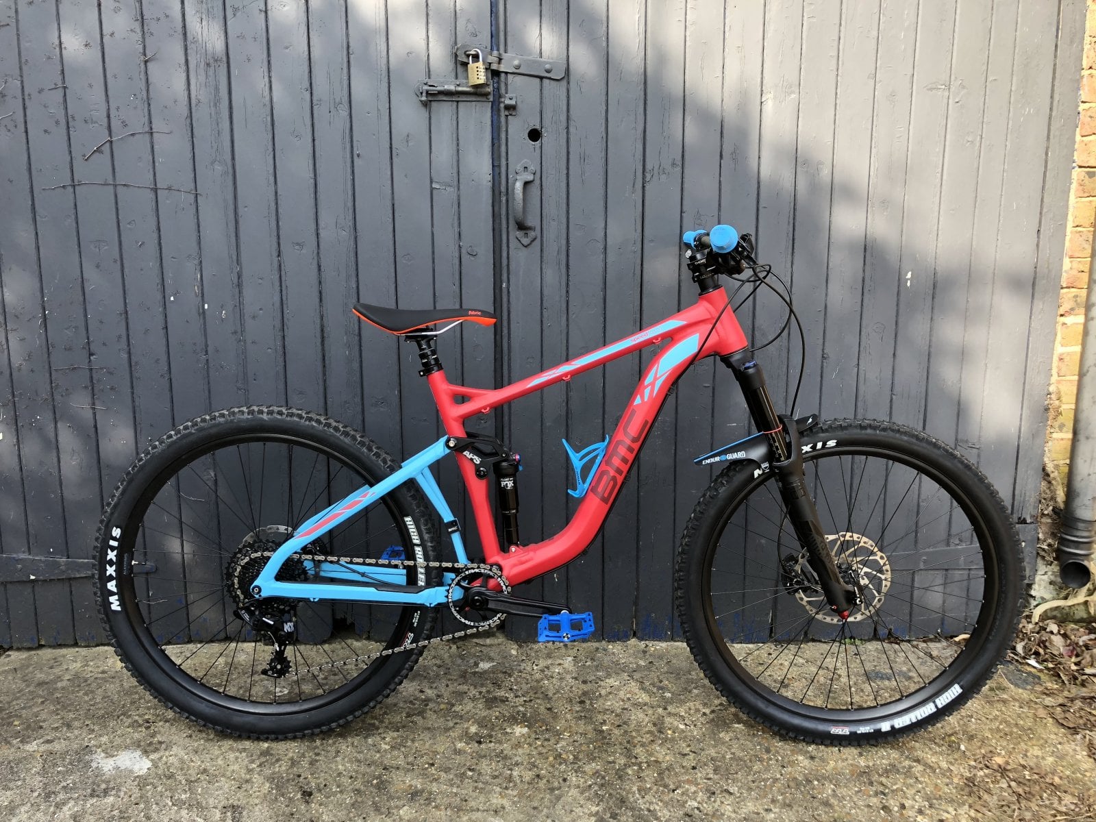

For me (its a size l) the main thing i wasn't expecting, but am very pleased about, is it has a very low standover, at 700mm, versus the 770mm on my BMC Speedfox Trailcrew, which i always thought felt pretty low. However the seat tube is taller, on my BMC i run a 150mm Reverb that as you see it in the picture at full extension, but slammed down, fits perfectly, whereas on the Vitus the 150mm dropper is probably 20- 30mm too high for me.
Pic attached of BMC for reference

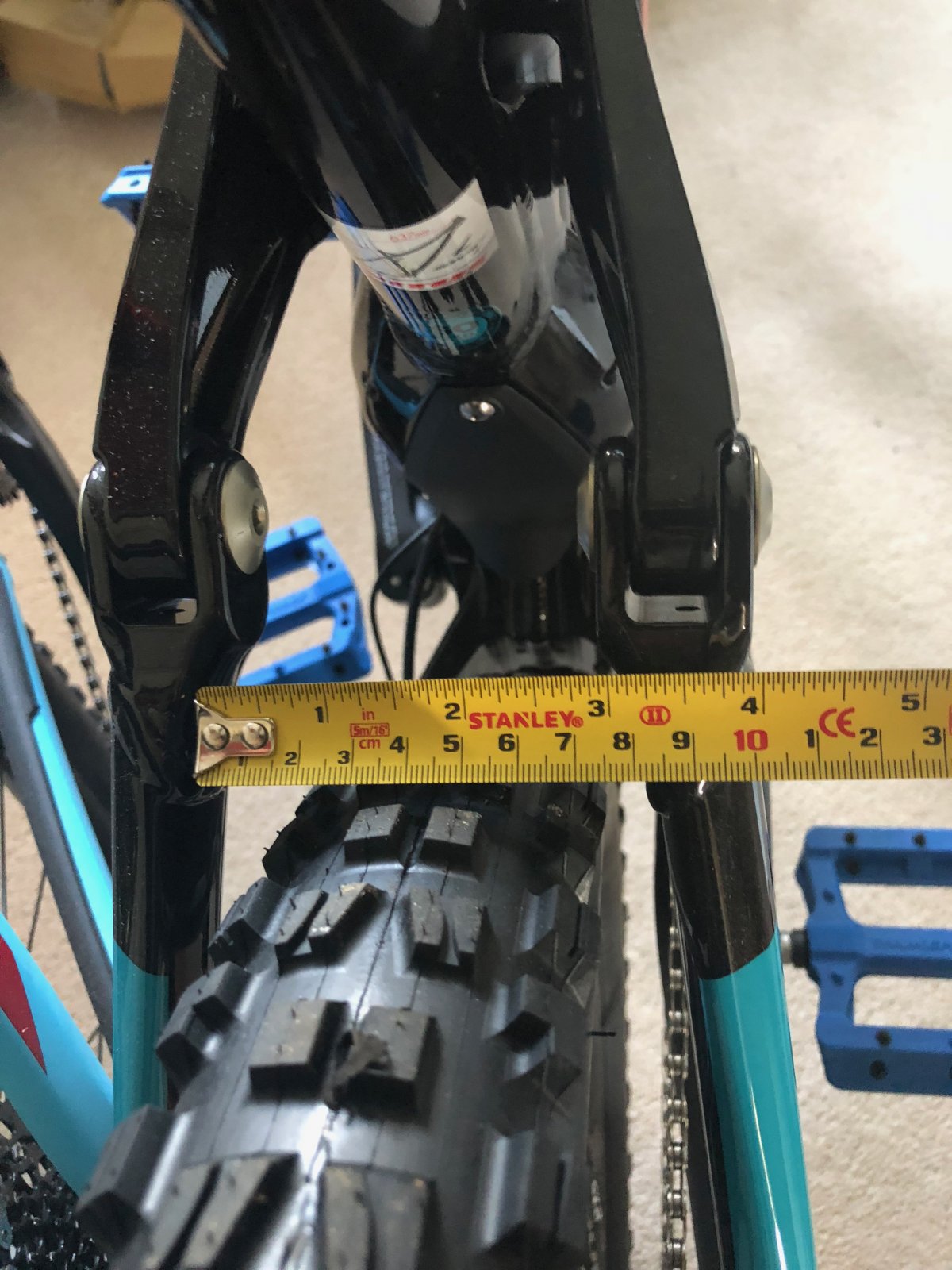

I also have a 2.8 Minion DHR maxxterra to go on the back, hoping to get it on later today. Anyone tried 2.8s? Fit ok?
On Vitus website says it will go up to 2.8 - you have aprx 80mm/3.25in between both the seat and chain stays at the point of the stock 2.5 tyres tread ends
May I ask why you're fitting such a large rear tyre?
FWIW. I've ordered smaller/lighter faster rolling tyres for mine a 2.5 DHF exo and a 2.3 Minion SS exo for the rear.

A lot of ebikes come with 2.8s, I have mounted mine and just got back from a ride. The stability and traction were insane, disagree that it handles like a pig, I think it absolutely flies downhill! I'm loving it, even better than I had hoped for
Also the standard 2.5 is Maxxgrip compund with the DD casing and the 2.8 I have fitted is maxxterra with Exo casing. I only had one short ride before changing so not meaningful but if anything I found it rolls better

Yes I think the 2.8 maxxterra rolls better than the 2.5 Maxxgrip. I had read a lot about them having a fair bit if resistance so made the change early. Should help battery range too
