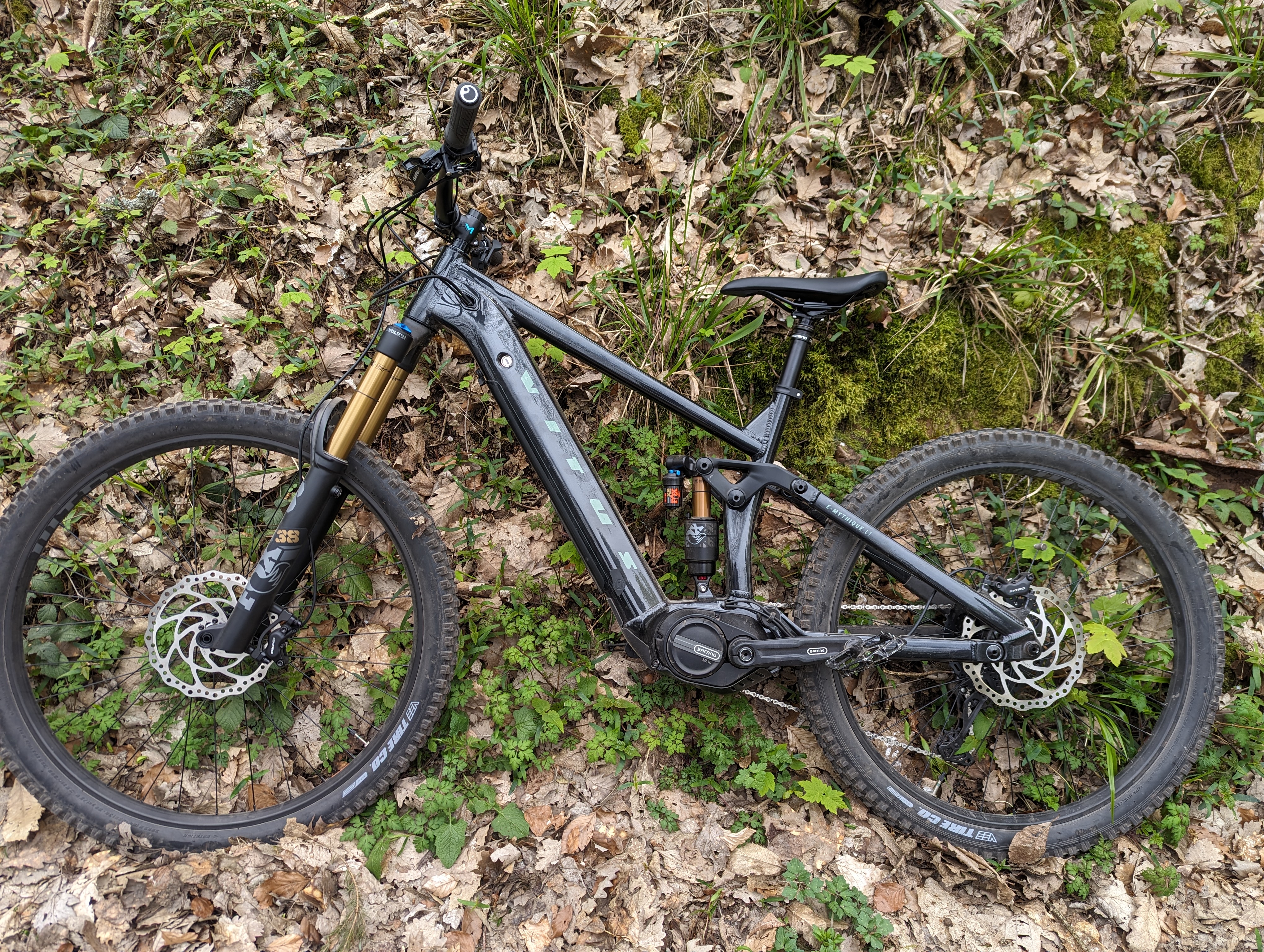

After a way too long brake, another ride with the Mythique LT.
Changed the shock to a X2 due to curiousity (and an interesting offer). Still working on the suspension settings.
The bikes gives the rider a lot of confidence. The geometry is very well chosen.
Brakes are OK, but more stopping power would be nice. -> Switch to Formular Cura4.
I am still not convinced with the microSHIFT Advent X. Can't shift in the lightest gear. -> Switch to (mecanical) SRAM GX-XO1-Mix.
Did some technical up-hills in Boost Mode. Plenty of power for me. No need for more.
I am still very happy with my choice.

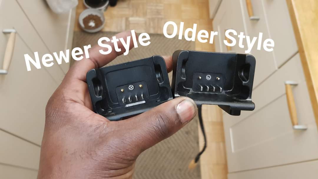

Has anybody had problem with Vitus E-Mythique LT battery release which? It seems to have lot of play on in and out direction from the frame, 3-4mm. Any resolve suggestion for that?
I have the mega play, but no solution. Took the screw/bolt out and put some threadlocker on the threads, since the screw has come out of some peoples' bikes (seems unrelated to the play).

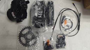

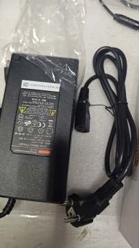

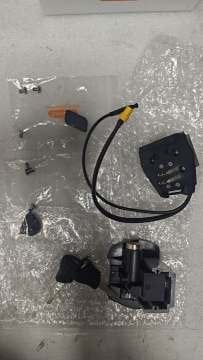

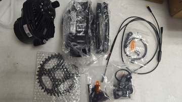

Just a quick update on how to source spares. We do have 2 E Mythiques and I was a bit worried that due to the Vitus shutdown getting spares would be tricky. I couldnt find anything in Europe, apart from the motor. Another member pointed me towards Changzhou Fieldebikes Co so I gave it a go and order the full set
- motor incl. cranks and control unit
- 36v battery and charger
- lock and lower battery mount
The lady was very helpful and we sorted the details in a few days. It took a bit to get the battery , but now, after 8weeks everything has arrived and works flawless
It might be a bit exaugurated but I hate when I cant get a fix for something that breaks. So far no big issues on the bike , but will post a bit more shortly
