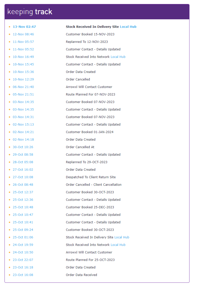

I still think this is a contract/payment dispute between CRC/Wiggle Administrators and the courier.
Anything else would be the courier being complicit with a retailer trying to recall bikes for what end?
I’m sure the retailer would much rather be delivering bikes that people have paid for.
I suppose the courier hasn’t got any other message to put on the tracking, hence the ‘wrong warehouse’ one.
CRC have now refunded me the whole cost of the bike (that never arrived). It took 3 weeks from order to refund, having never actually had the bike delivered, but we got there.
A little faith restored in CRC as I didn't need my credit card company to do a section 75 chargeback.
So after two refusals from ArrowXL to deliver the bike they are going to try for a third time tomorrow. According to CRC/Wiggle they have 'sorted out' their issues with the delivery companies. I've even had a call from ArrowXL confirming the delivery window, so I'm feeling strangely optimistic...
