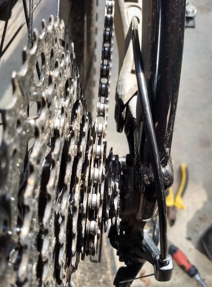

Checked and the derailleur was out of alignment again - I have changed forks/bars/wheels been off .. so opportunity for it to move I guess ... still seems to move around a lot compared to anything else !
It's unorthodox, but have re-routed the gear cable on the inside of the seat stay. It's a straighter run for the Microshift and hopefully just far enough out of the way not to get mauled by chain slap. It sits against the existing frame protection pad on that side.
With the cable rerouted and yesterday's index, shifting is super smooth...
But still random jumps on the 11t.
The original shift issues through the range were the adjustments screws moving/cable settling.
I think the v1 Microsoft has a bit of a design flaw, probably addressed with the v2.
In the 11t there's hardly any spring tension left so the derailleur can move around quite easily from left to right as the tension in the chain varies.
Winding thr limit screw in hugely reduces the lateral play as it moves it back into the zone where the spring is still effective, but....... It won't go into gear when changing again.
Repeatedly adjusted to get the minimum limit to still engage the gear, but then it slips - randomly as you vary pedal pressure.
Varying the tension on the bottom pulley and the mech moves laterally :
Shortening the chain would move the mech back within its optimum limit, but there's not the scope to do that.

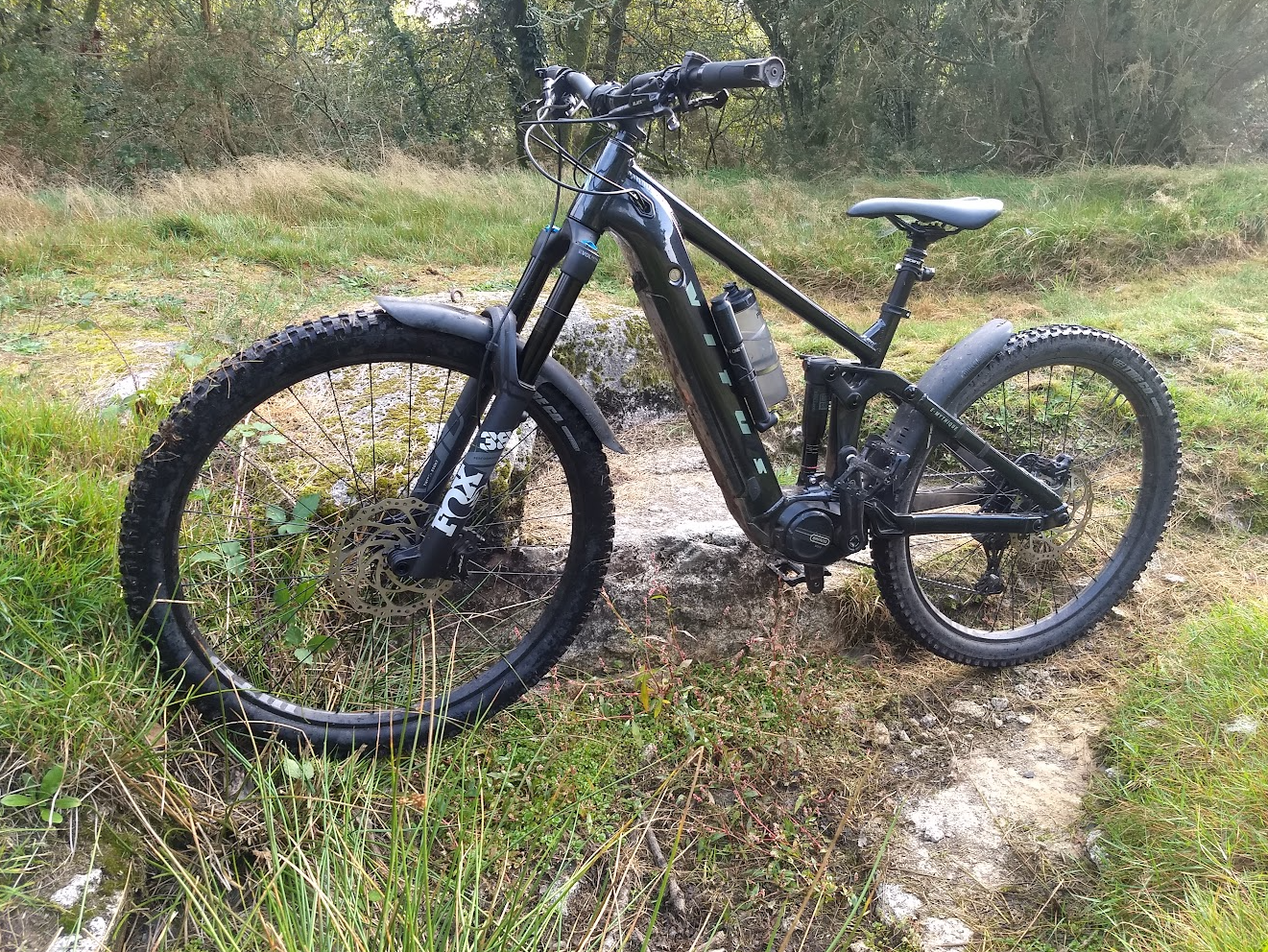

Had a much more "testing" ride on the Fox 38 setup this morning.
1100m, 30k, 70% battery used. Left it in T as I was lazy.
Basically - the fork is perfect for me ! It just does everything faultlessly ! The rear shock I also can't fault. It's better again with the Fox 38 (The Lyric is vastly overdue for a service). Sped up re-bound 1 click part way through (which had made it a tiny bit harsh before, but felt great today).
The bike's a bit of an enigma. It's slacker than the Kenevo and the Jam and feels more stable than both. But somehow, it also feels more agile !
I really like the Kenevo with the 27.5/27.5 and really really liked this with the Kenevo front end on it. I was concerned with lifting the front and going back to 29 that it would feel sluggish and ungainly - but it doesn't. The Focus (29/29) feels bigger and slower than the Kenevo, you can't flick it around the same as the Kenevo, this still feels like you can just think it and it happens. It's more surgical than the other two and more composed - at all times. Over jumps, off drops, everything just feels easier and like you have so much more control. Even when it's sliding, you just think about where you want it to go and it goes there.
Weight wise, with the 38, 29 front, 2.3 disks it will have crawled back up. Not sure what it is, 25.8 ish with all my crap and tools on. Really didn't feel heavy at all today (except when lifting over fallen trees) so I'm not worrying about weight with it anymore.

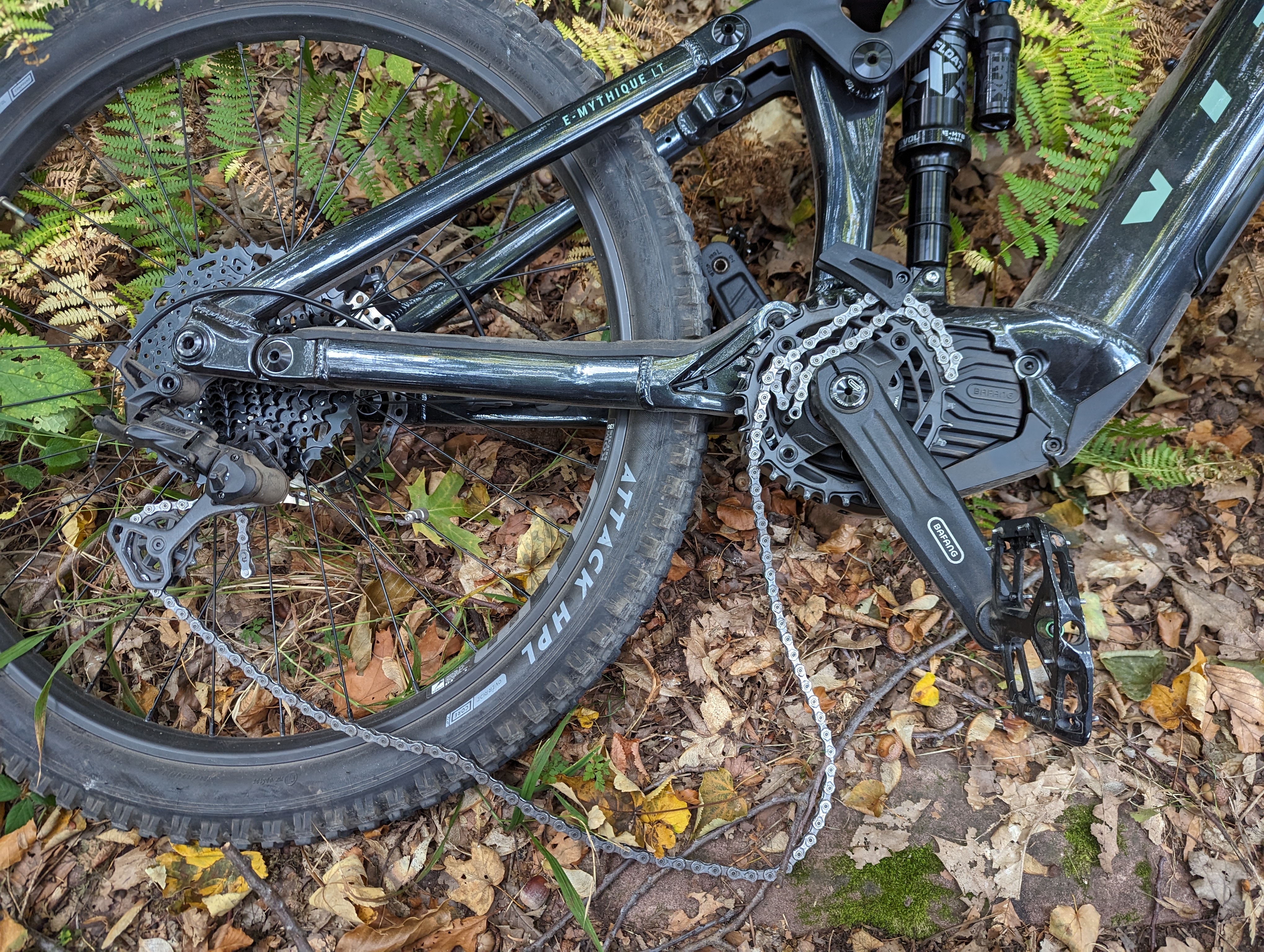

Bad luck today :(
Wanted to try out the new shock but the chain broke on the half way up the hill. The way down, I tried a little bit riding chainless.
Need more rides to correctly set up the shock.
Unfortunate. I was looking forwards to hear how it rode. It looks good !! 🥳
You're clutch is "off"- though you might have done that to try and sort out the chain ! :) The chain guide isn't level either, but again, you might have loosened it to get the chain off.
You can see your seat stay is starting to rub from the shifter cable, it's a straighter run with the Microshift if you run it on the inside of the chainstay and it sits against the existing rubber protector.
Did it break with a "ghost" shift ? I think the KMC chain might be junk. Even with ghost shifts, my SRAM 11 speed hasn't broken, yet the 10 Speed KMC broke on one of the first rides.
I cannot remember If I had a ghost shift before the chain broke or not.
The shifter cable definitley needs to be changed or I will see some aluminium soon.
10 or 11 Speed SRAM or Shimano chains will work both?
10,11 or 12 will all work. The spacings are all the same, just the plates are thinner. I think the 11s works better than the 10s as there's a tiny bit more space - but that could just be subjective.

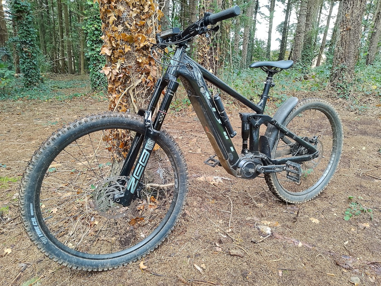

Quick mod with a "lightweight" build .. or slightly lighter ..
180 Zeb's (actually measure 185) to try as an alternative to the 170 Fox 38's.
Loam lab grips/bar ends/granite stash tools replaced by the original super light Vitus grips. No mud guard. Loam labs 35mm stem. One up carbon E-bars. Saves 800g with the 50g saved on the Zeb over the 38. Don't think it will make any difference to how it feels when riding.
