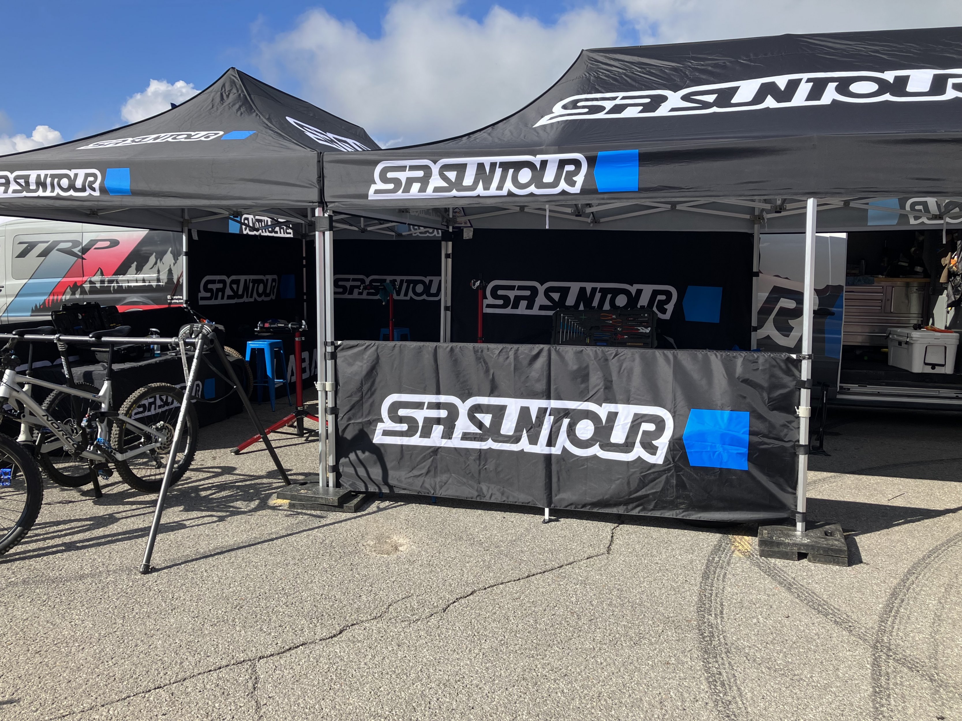

Tried to talk to the SR Suntour guys and get there opinion about it but no one was around.
Good try. Would have been nice to have some insight from people who probably know about the damping they used and any potential assembly issues - and fixes so people could maybe strip it themselves.
I was hoping to catch one of the mechanics there to chat. I’ve found the techs in the pits to be really open and straightforward with questions. Lots of Suntour stuff riding around there too.
