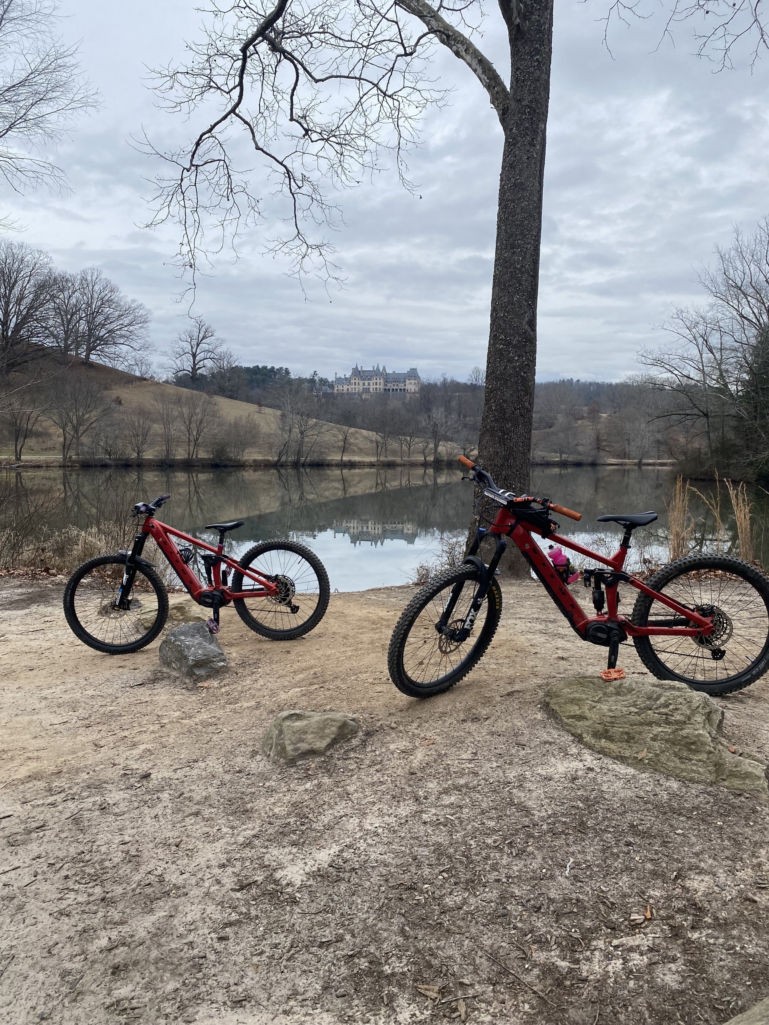

The wife and I went to a weekend getaway (pretty rare with three kids) and did alot of riding over the weekend. I put a 160mm Fox 38 Performance and Fox float x2 performance elite on mine off another bike for the trip. Really in love with this bike and this suspension. Absolutely could not ask for more. Highly recommend upgrading fork and shock if your on the fence. Transforms this bike.
