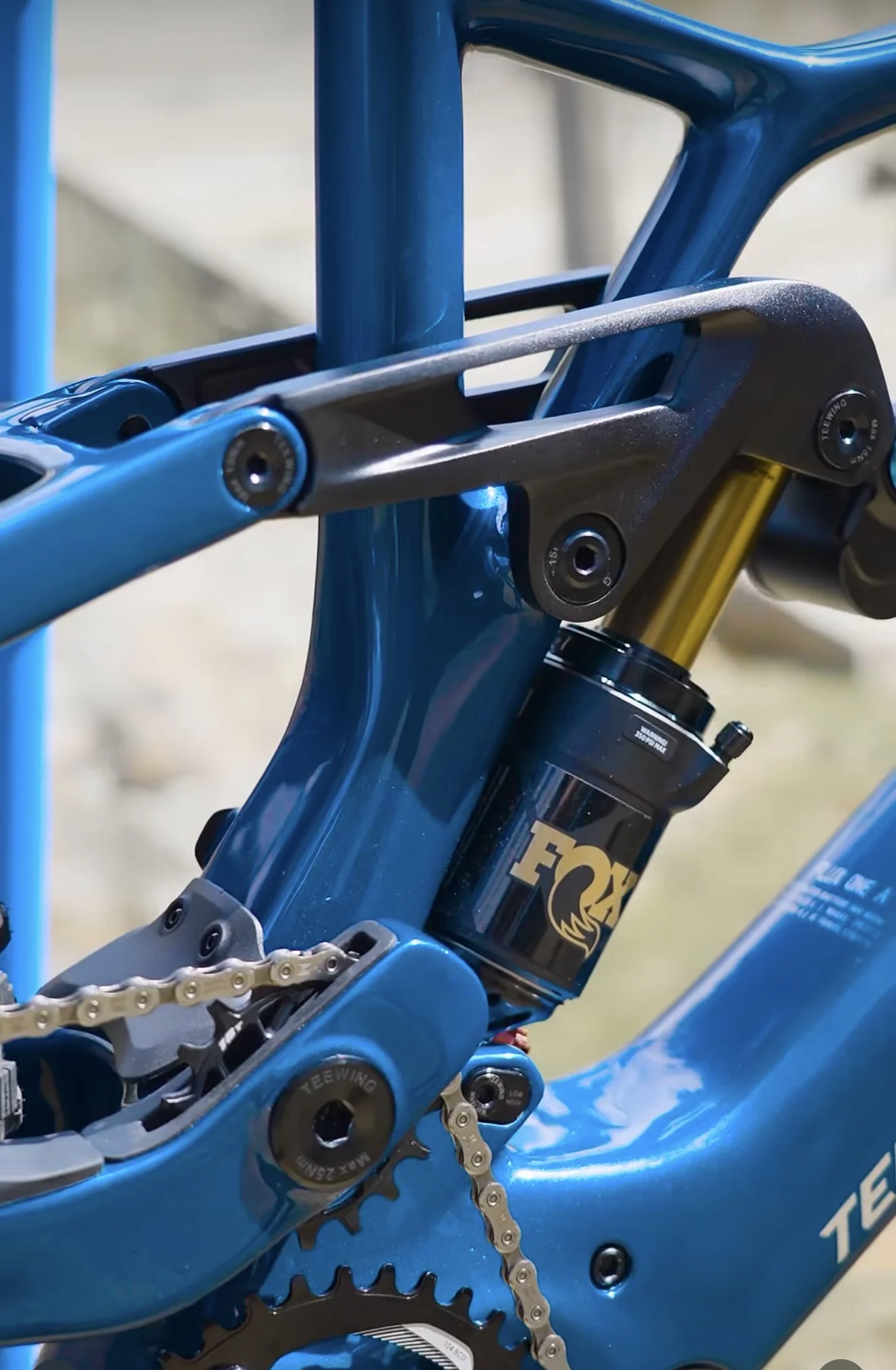

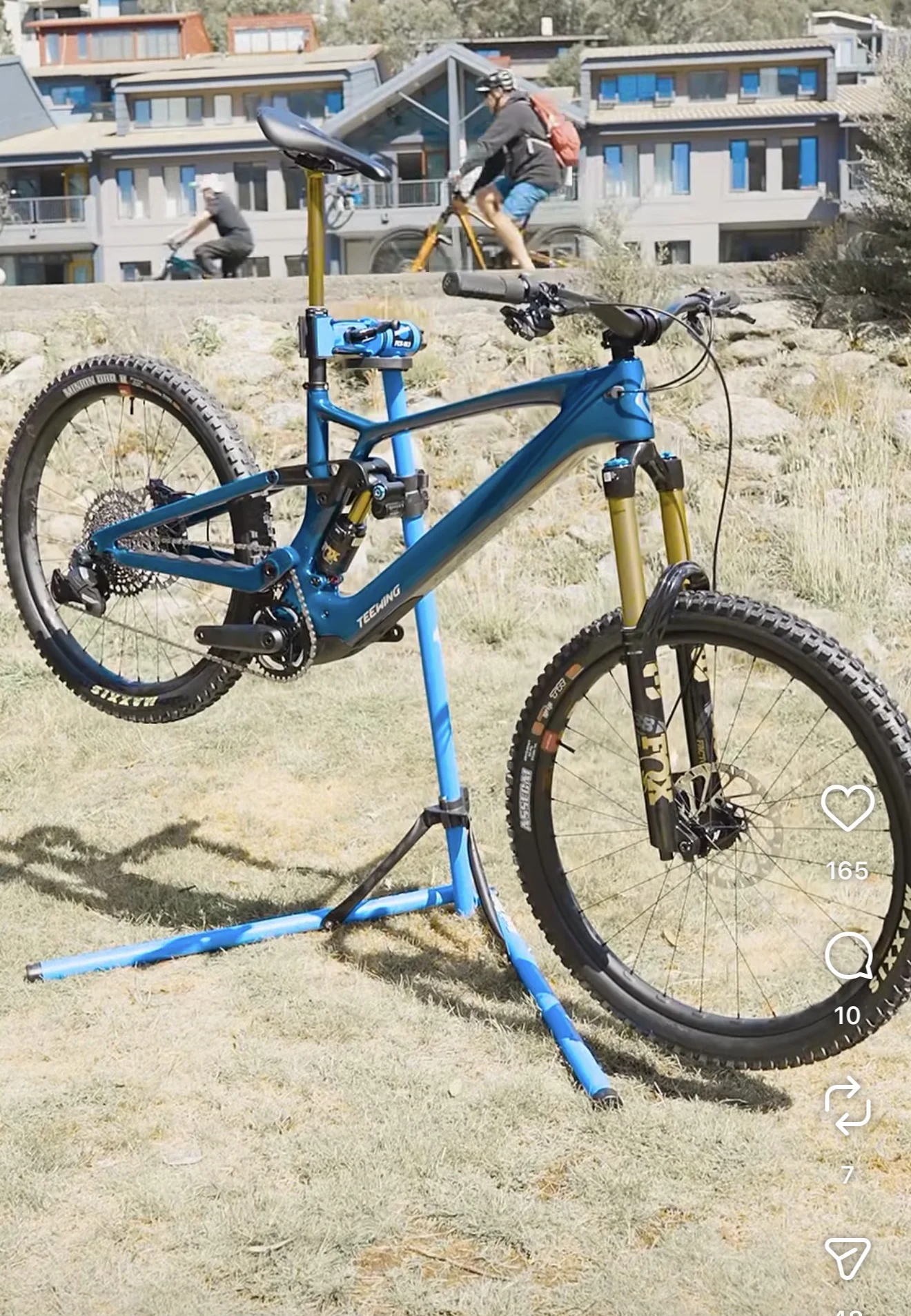

There aren’t many pics of the blue other than the stock pics, does anyone know if the color in this video is supposed to be the Cosmic Blue available from the factory? It looks totally different than the stock pics from Teewing, looks very similar to the Teal Sparkle on the Bullit.. Hopefully it’s something specific for an early build bike.

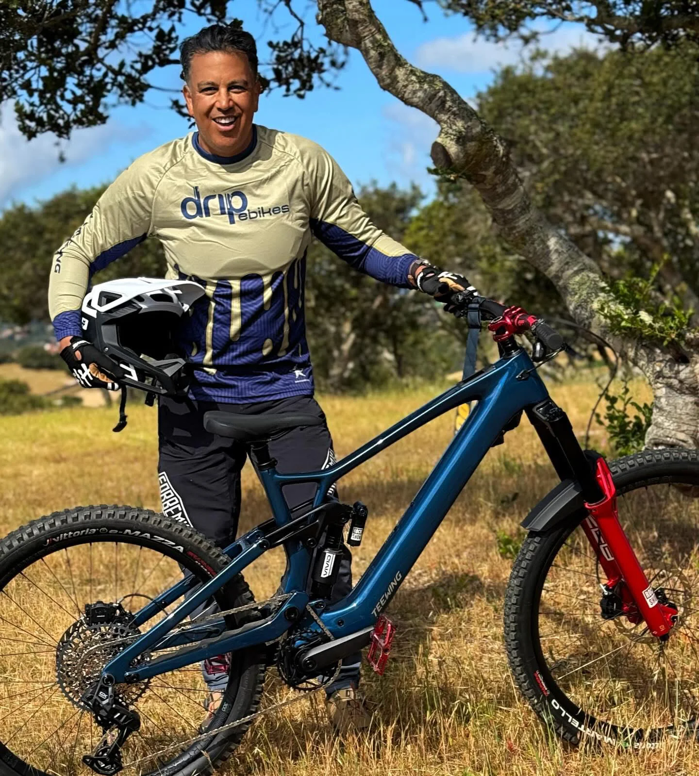

Check out Drip E bikes Facebook. They are at sea otter with the blue paired with red Zeb
Good call, I guess it is the same. Very interesting color, looks entirely different depending on the lighting. Hard to believe these are all the same color. I’m not a fan of how teal-ish it looks in the sun, I like the darker metallic blue look it has in the dark, but it could grow on me I guess.

This bike he had at sea otter is almost my exact build but I went with vivid coil. We’ll see how the Superman colors look in person

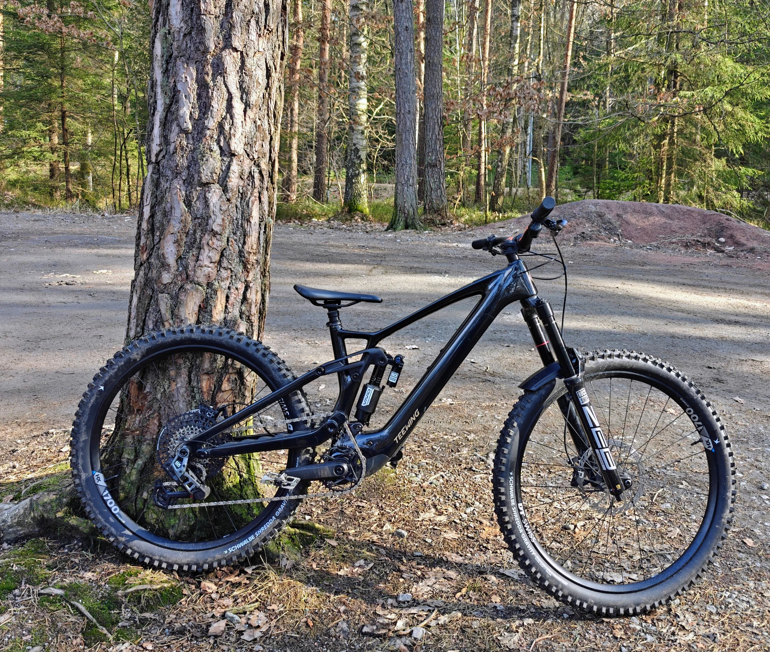

I have a medium Flux and a 180mm Oneup 30,9 with a chim and can set in almost the bottom. Is about 5 millimeter left.
That's a nice looking bike, congratulations! How do you like it so far? Also that is great info about the actual seatpost insertion depth! That is interesting you are running a 30.9mm with a shim, rather than the 31.6mm. Depending on if the restriction at the bottom of the tube is a hard stop, or a sort of slight narrowing, running a smaller diameter post could be a way to get a bit more insertion depth out of the frame.
Not that 5mm is likely to make a big difference, but if the Medium Force allows one to fully slam a 180mm OneUp, then it seems the Flux is more restricted, which seems like an odd choice for Teewing to make when designing their 2nd bike, especially one intended for even more aggressive riding than their first bike.
I have been on a Orbea Wild until now and had no plans of a new bike. But when I got the chance to try this one out for a couple of times I was in love. Is a hell of a bike. And so much fun. In the short and high setting it a hoot to play around with and with the chain stays in the long setting it's becoming a real beast on the fast and steep. Haven't had the chance to get a 29er in the back yet. But it's coming. It even climbes better than the Orbea which is a surprise.

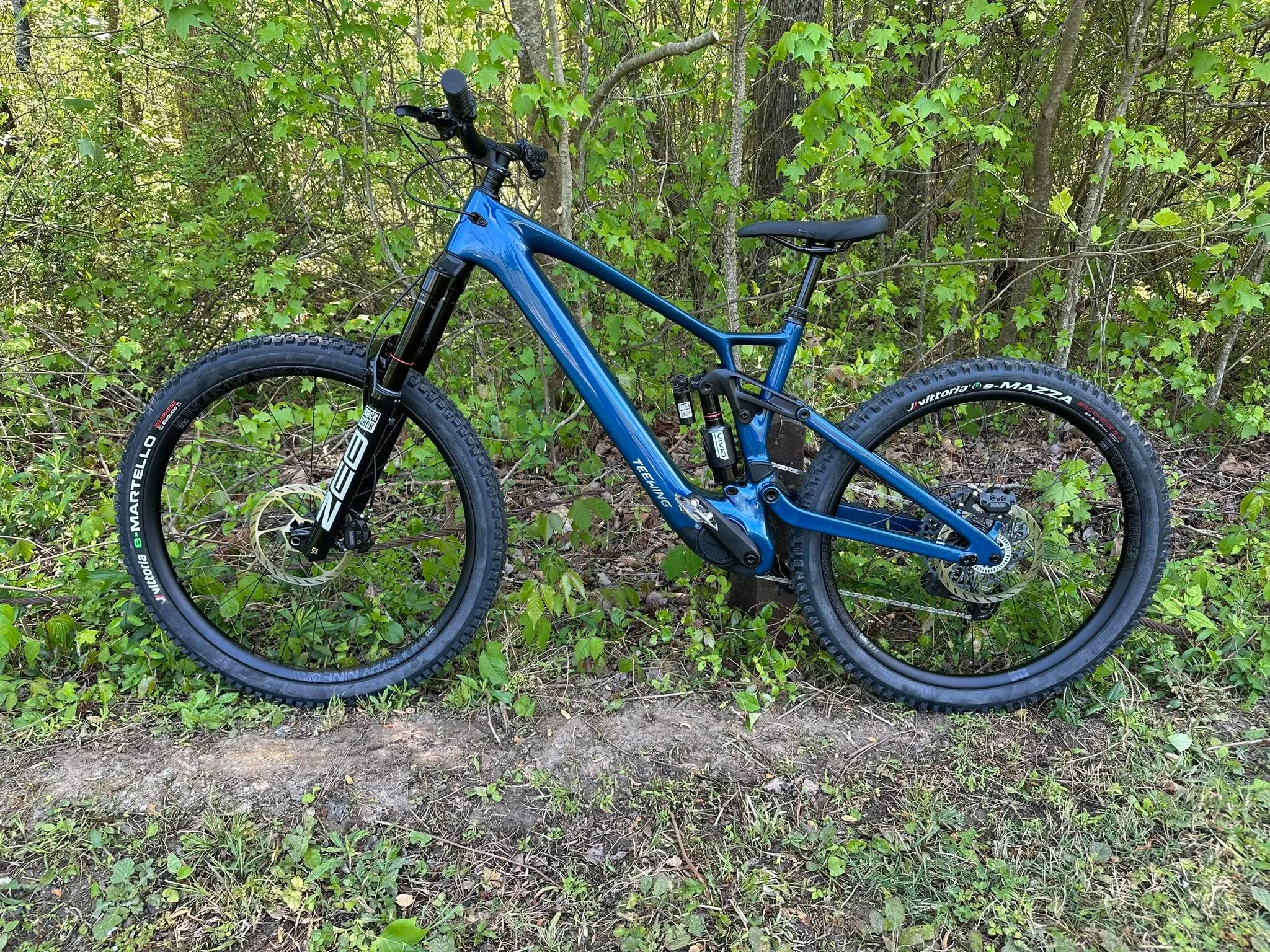

I also ordered the Blue Flux today with Red ZEB, Vivid Air combo. Added Red Race Face stem, Red stem spacers and Red lever on the dropper post as well as red set post clamp. GX components with cable, DT Swiss 1501 Carbon wheelset, One Up dropper post. I might change the pedals to red as well. Don't want to go to overboard.
