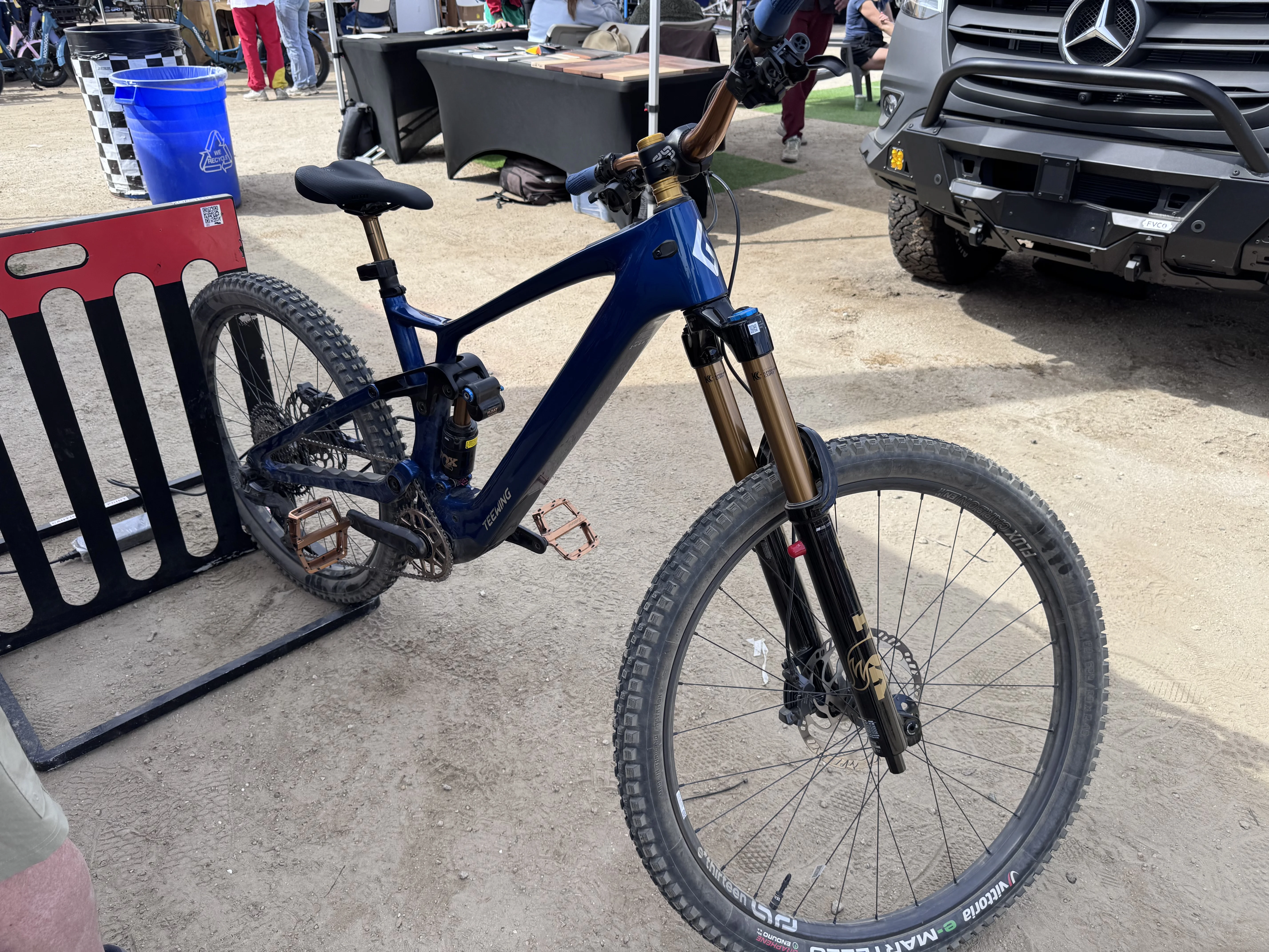

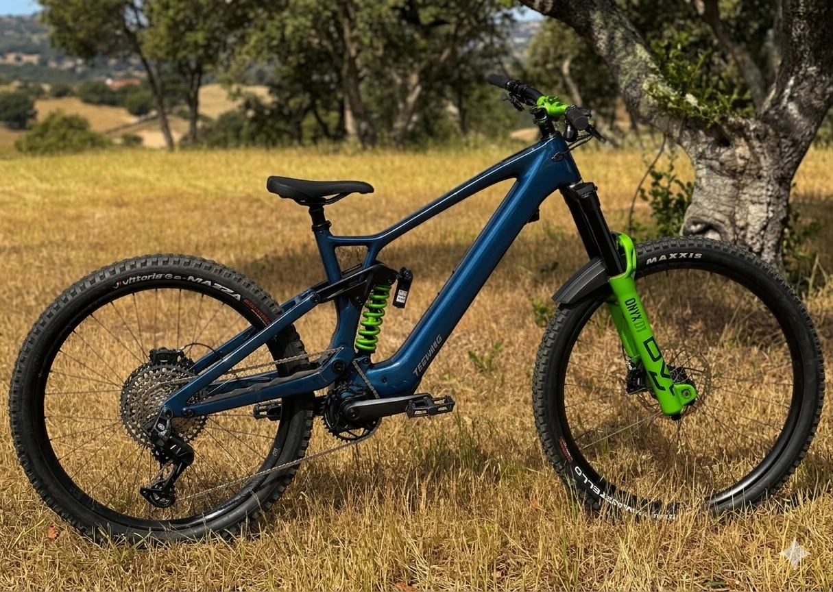

lol, it does look classy, I’ll give you that. Just never been a big fan of gold myself. What I definitely don’t like is the blue frame with kashima, so if I go blue it’ll be a Rockshox setup.
Decisions decisions… GX or X0, Carbon or Aluminum wheels.
They had a Blue and Kashima at Sea Otter, it looked pretty decent. Only thing I would have changed is the gold stem cap and spacers and gone black. Their color was a little off. Could always do Performance Elite fork and shock if you didn’t want the Kashima and didn’t want to go Rock Shox. In person though, that Superman combo was pretty clean.
That actually doesn't look bad, you're right.

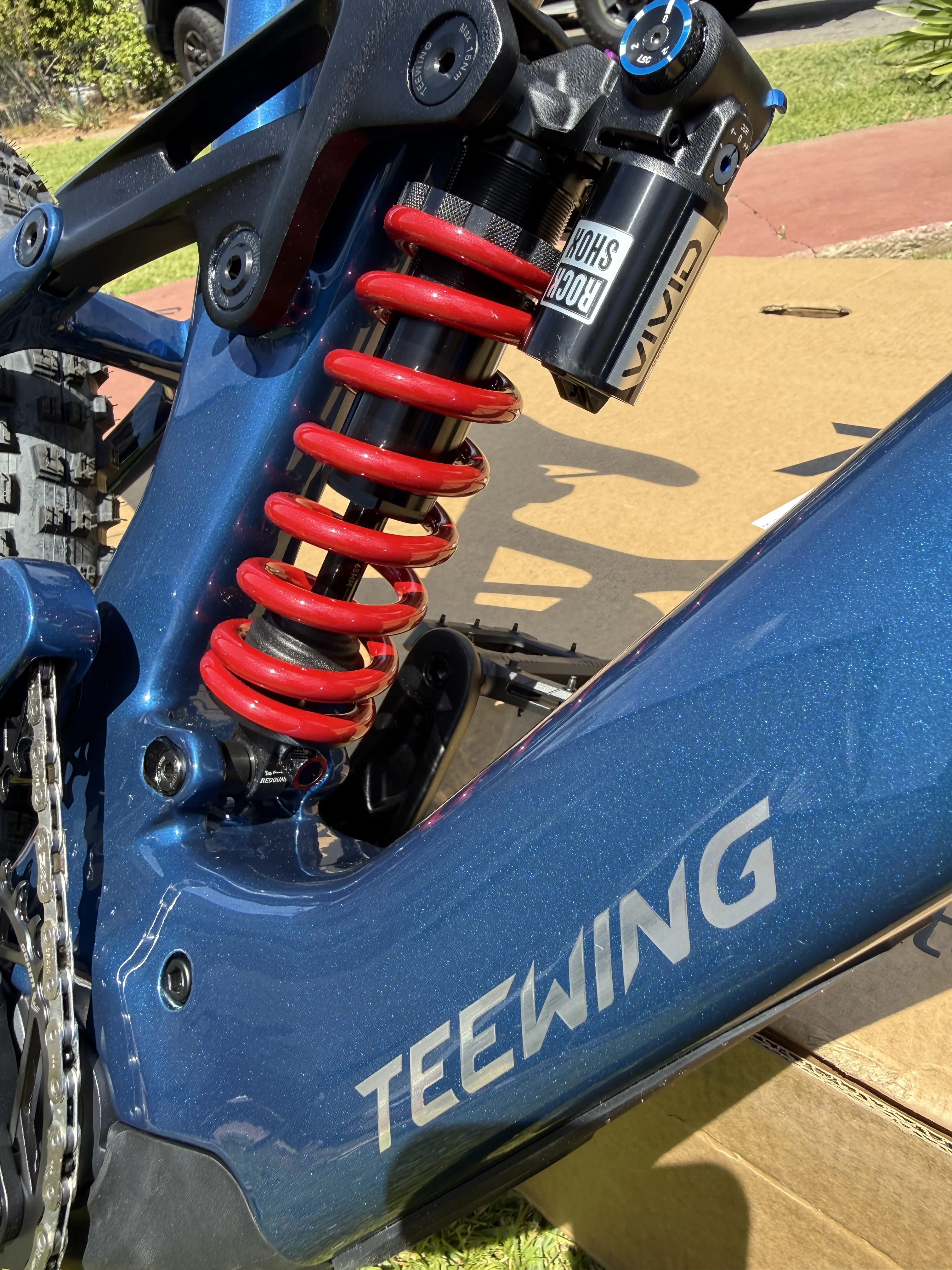

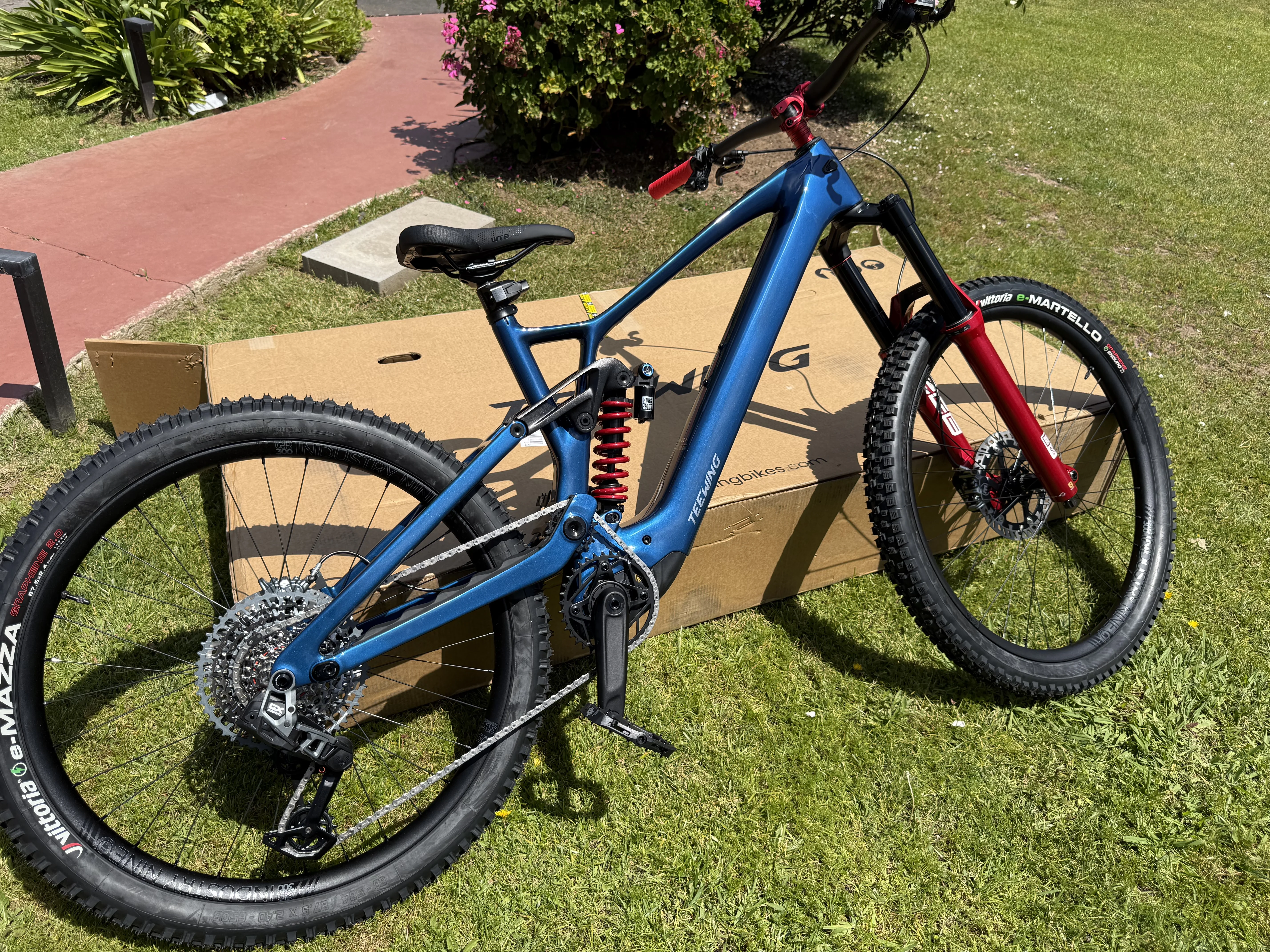

Oh man, you took my idea of using a red spring if I go with the superman theme! And are those the MT7s on there I see? You have almost the same build I'm considering, even down to the tires lol.
Yep MT7s (used to MT5s). I9 hub sounds awesome. So far my only complaint is that SRAM still ships AXS chargers with micro USB. What decade is this…

Damn, more people doing the Superman, might have to change mine up. Go with Ohlins and make it like Wolverine or go DVO and add some green parts.
That looks pretty good actually!
What size is it?
Size Large. Feels like the same size as my Santa Cruz Tallboy if that helps anyone.

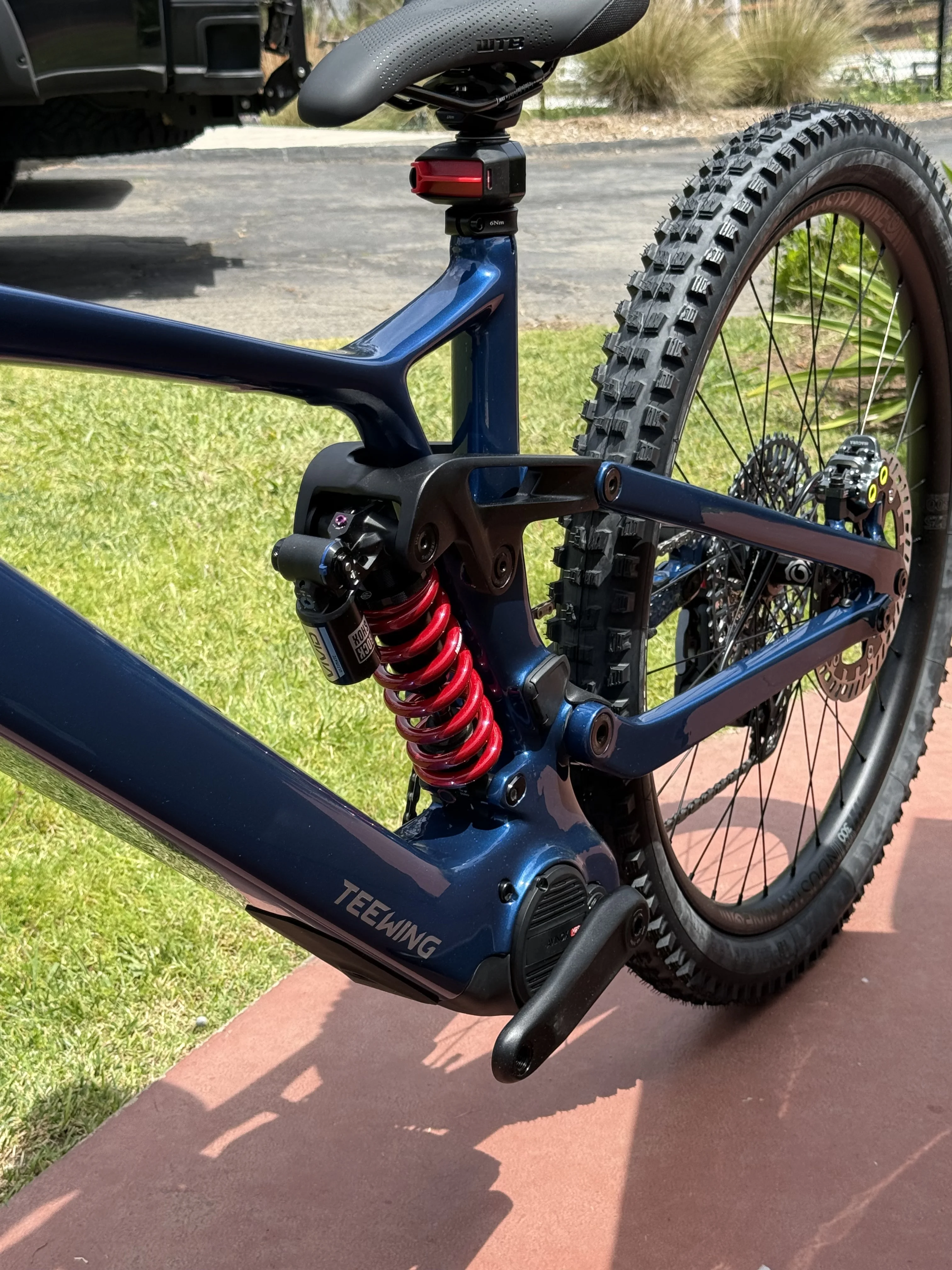

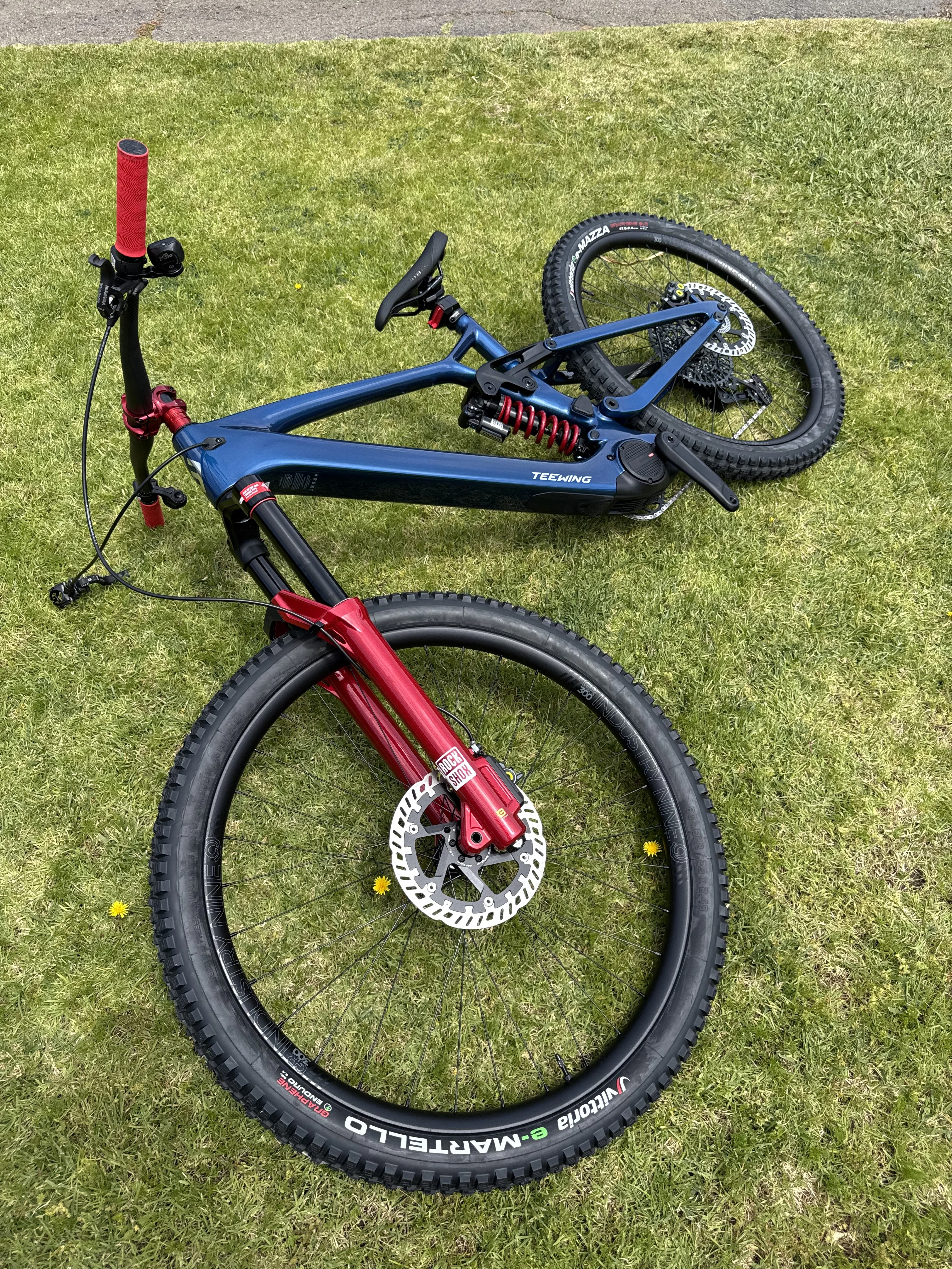

Did a quick street lap (still need to ride wrap)
Motor is just silly fast. Ive never tried an M1

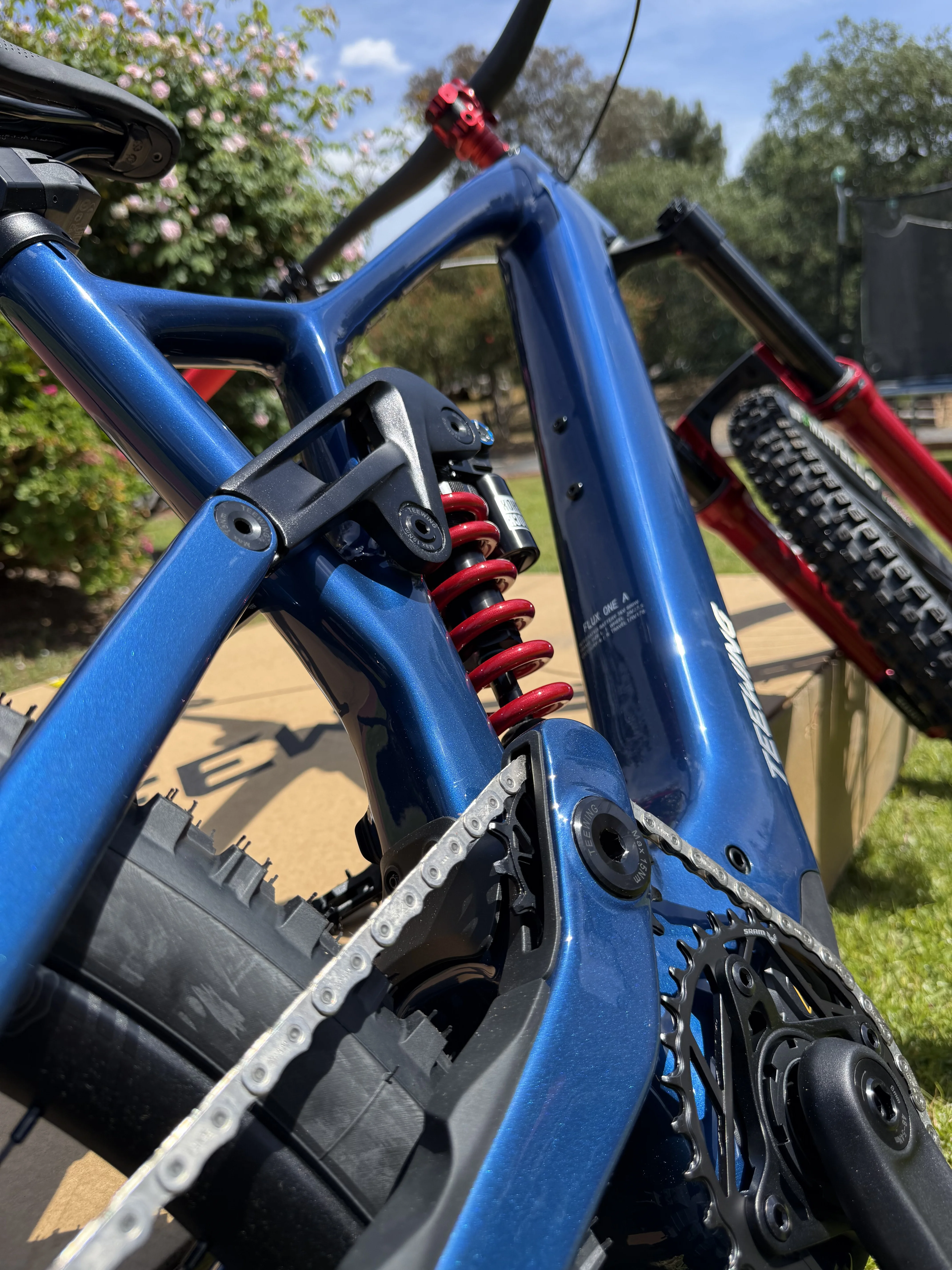

There are tool storage threads in the underside of the top tube.
Reverb AXS doesn’t quite drop as far as I’d like or am used to but I’ll give it a go.
Hard to really gauge anything yet.
Feels like a super solid bike. Very quiet. Shifting without pedaling is weird as hell.

The way your plant looks makes me think my original plan with the orange would be fine. It was just some of the pics in the bright sun that made the paint look really light that made me question it. Seems like Superman is popular, I don’t want to cramp anyone’s style 😂

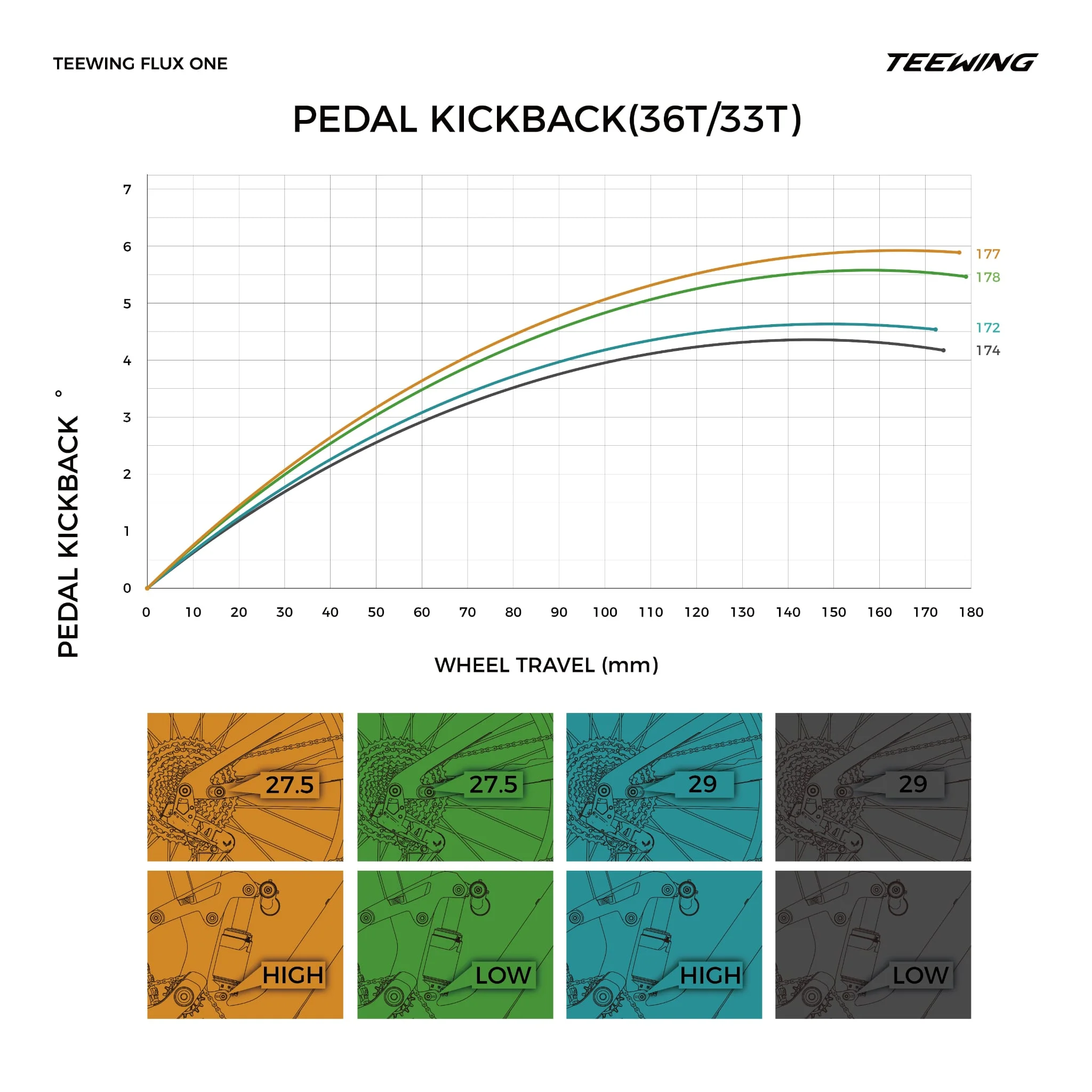

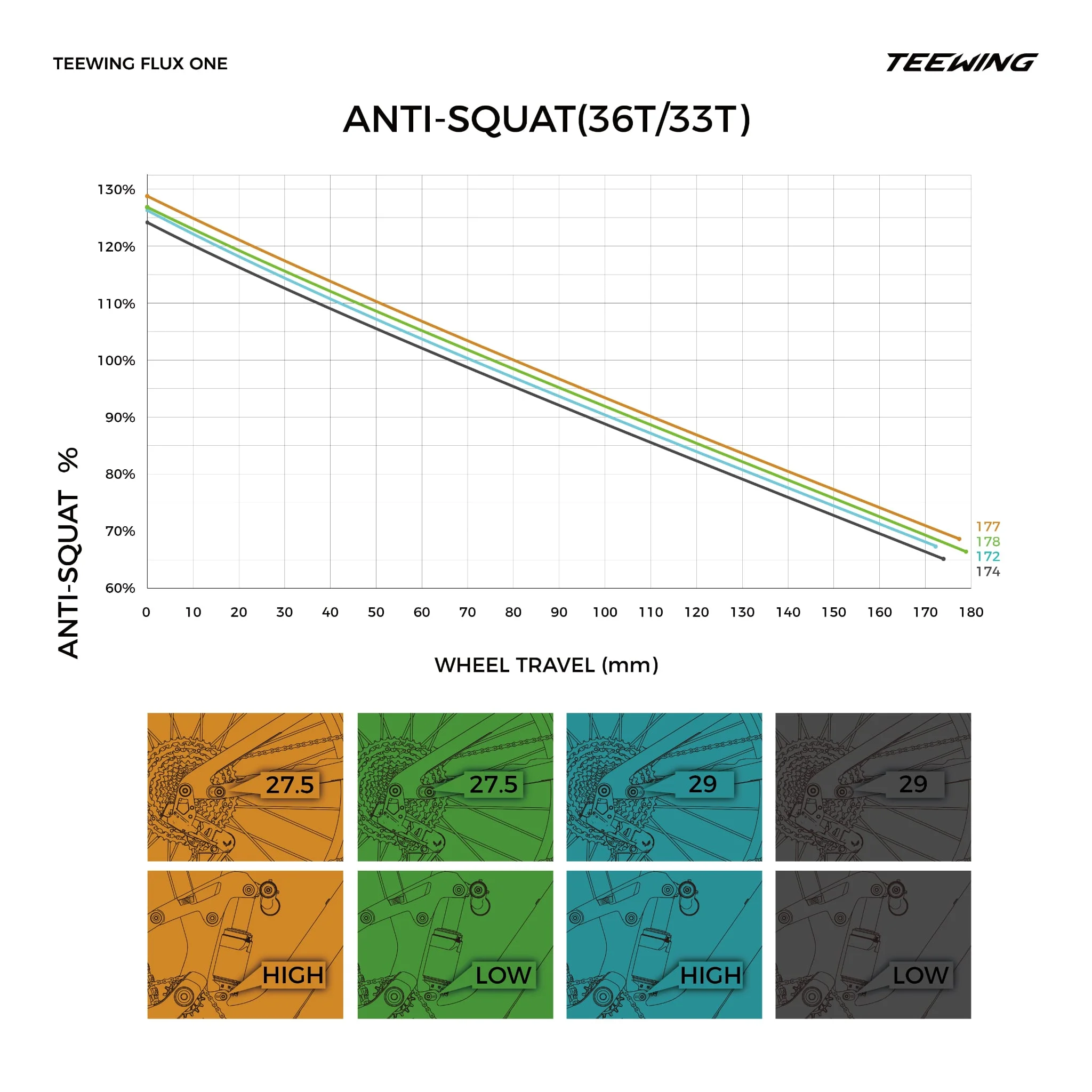

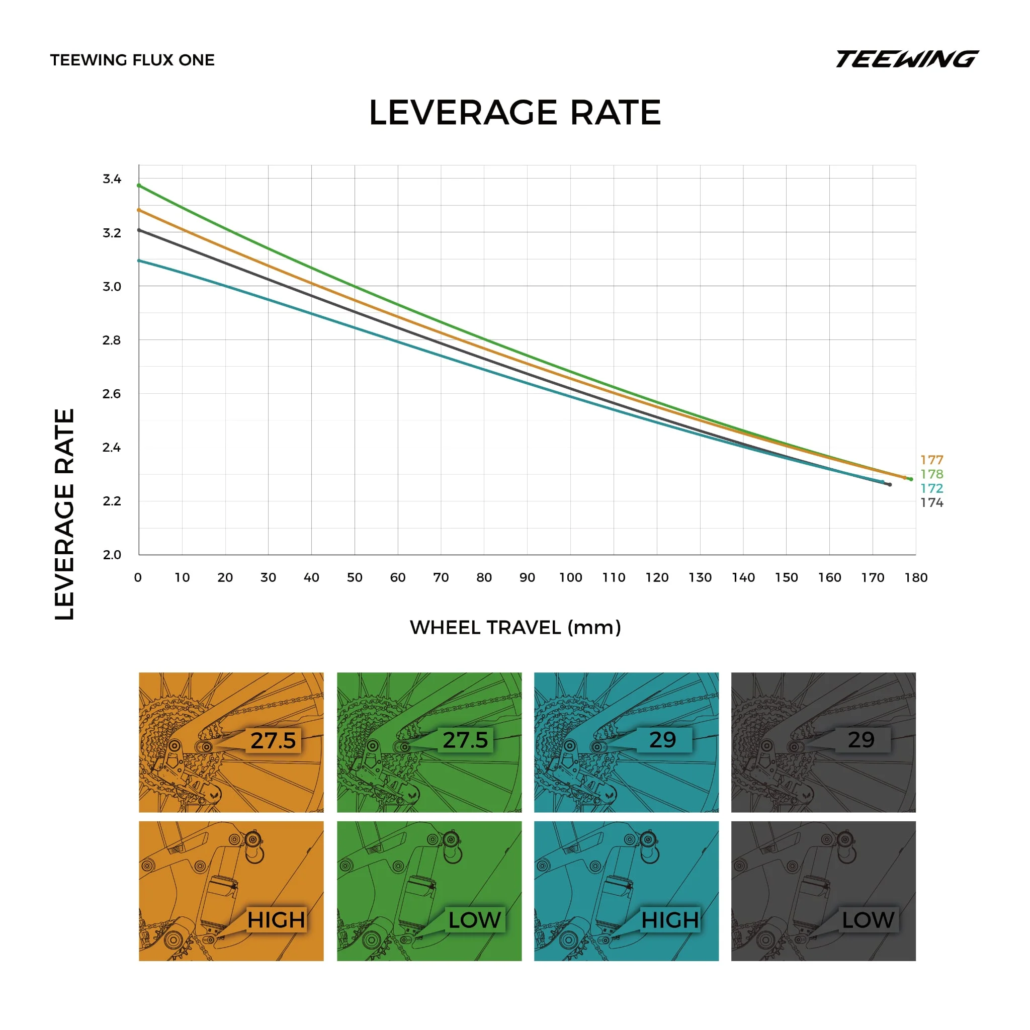

OK, finally the official, long awaited, yet readable, kinematic graphs for the the Flux, compliments of the Drip folks:
Up till now, I've been trepidatious to fully consider this bike without having these in hand. They seem to have done their homework. Some quick thoughts:
  1. Still holding out until I see wheel-path graph. Hopefully this will be coming.
  2. Impressed by the anti-rise graph (my preference for it to be well below 100%) to reduce brake jack.
  3. Leverage ratio slightly less progressive than the Rogue but more progressive than the e-Dred
  4. Ramp nearly linear on all setting so air shock could work well in all modes. Coil more welcome in the progressive setting.
  5. 36/34 point to take anti-squat graph a decent balance in lieu of a range graph.
Based on what I see so here and not having a wheel-path graph, I would personally run the bike MX, but in the 29er setting.
