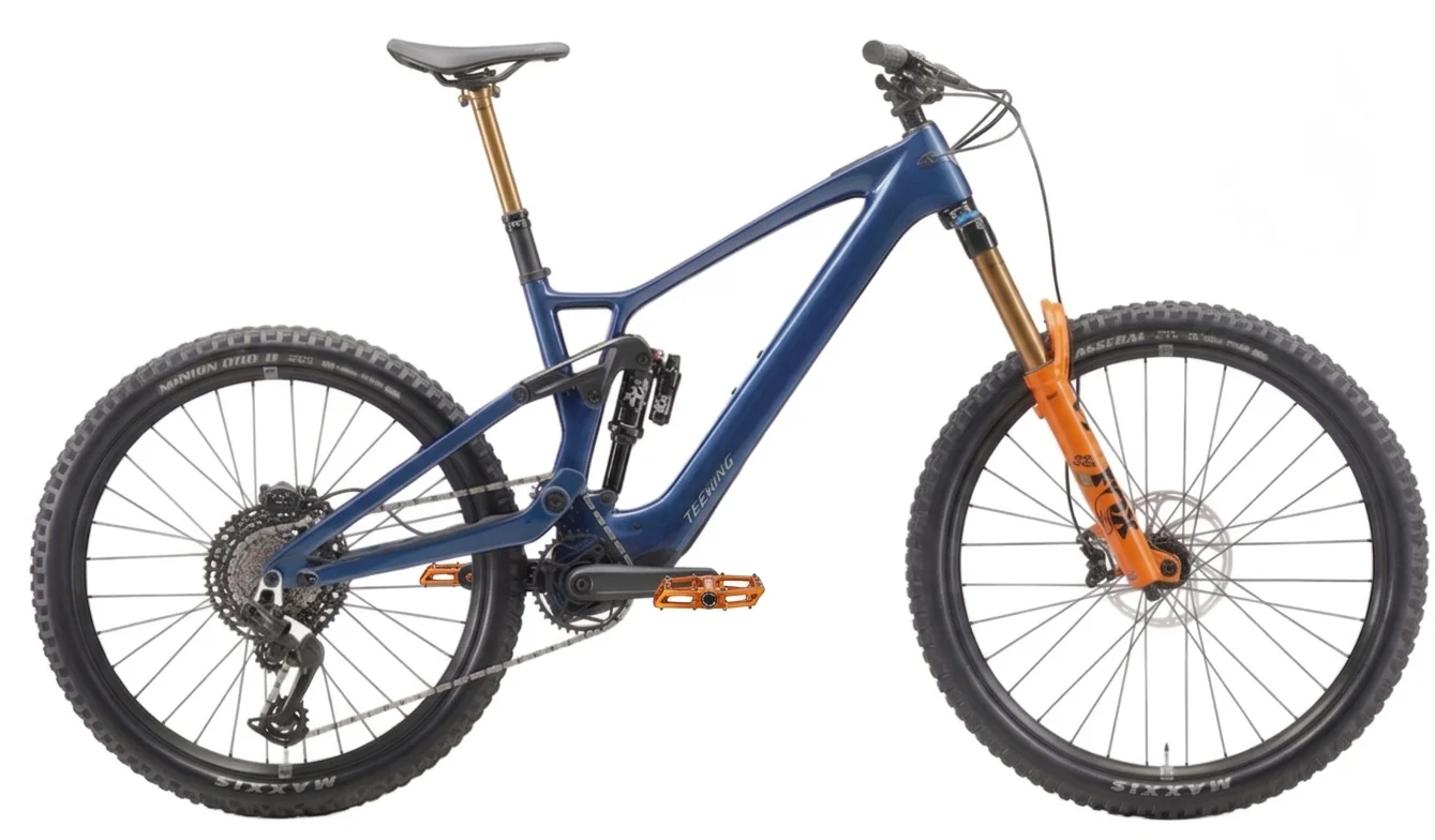

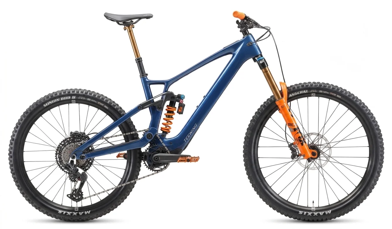

How do we feel about orange and blue…
Would have orange stem or grips too. Black seems so boring so I was thinking of going with the blue frame.
Love it.

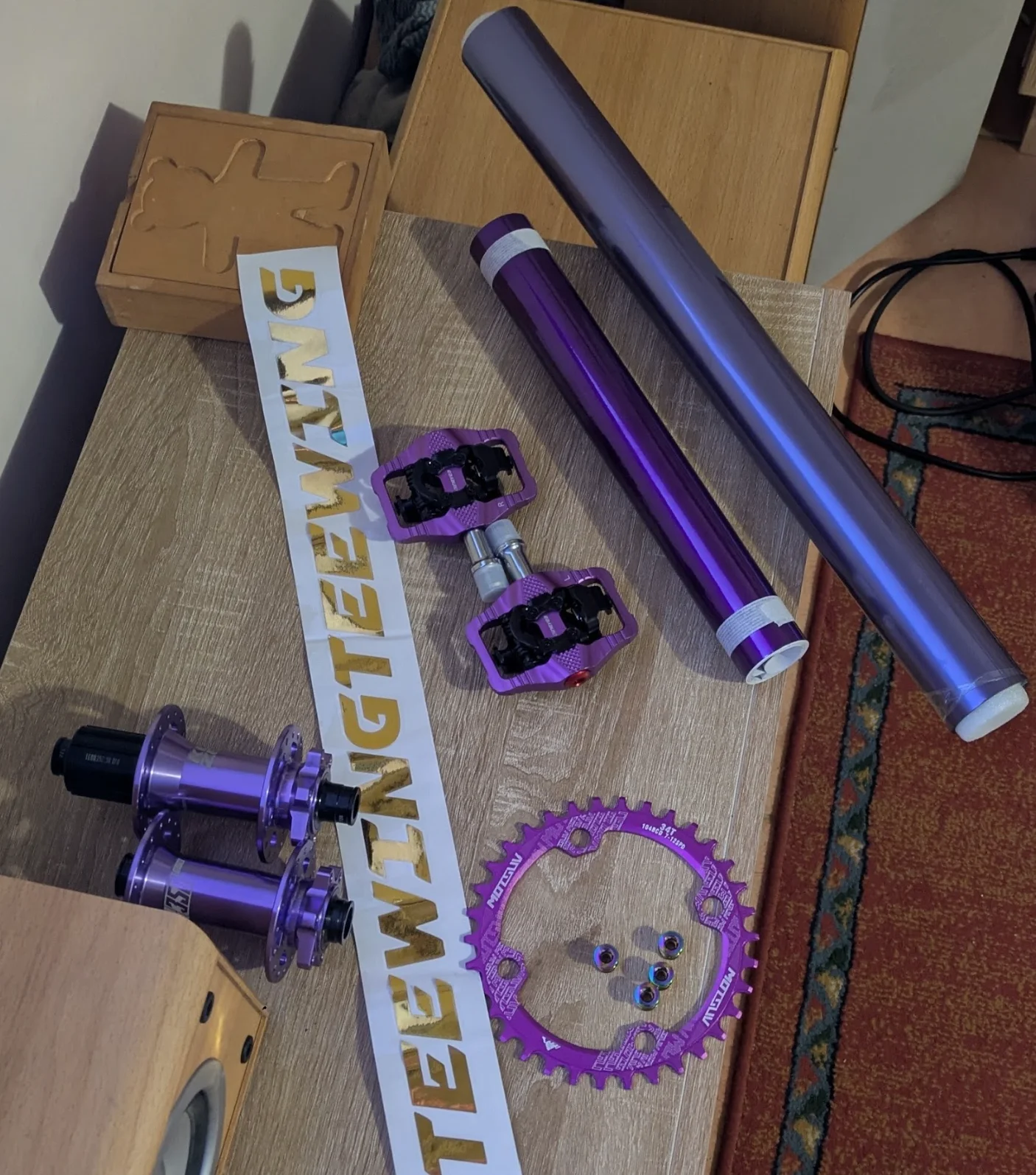

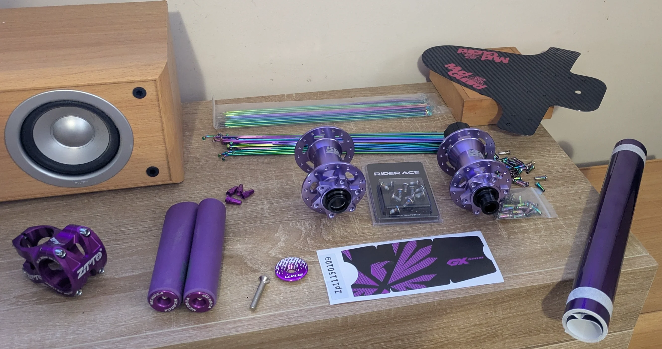

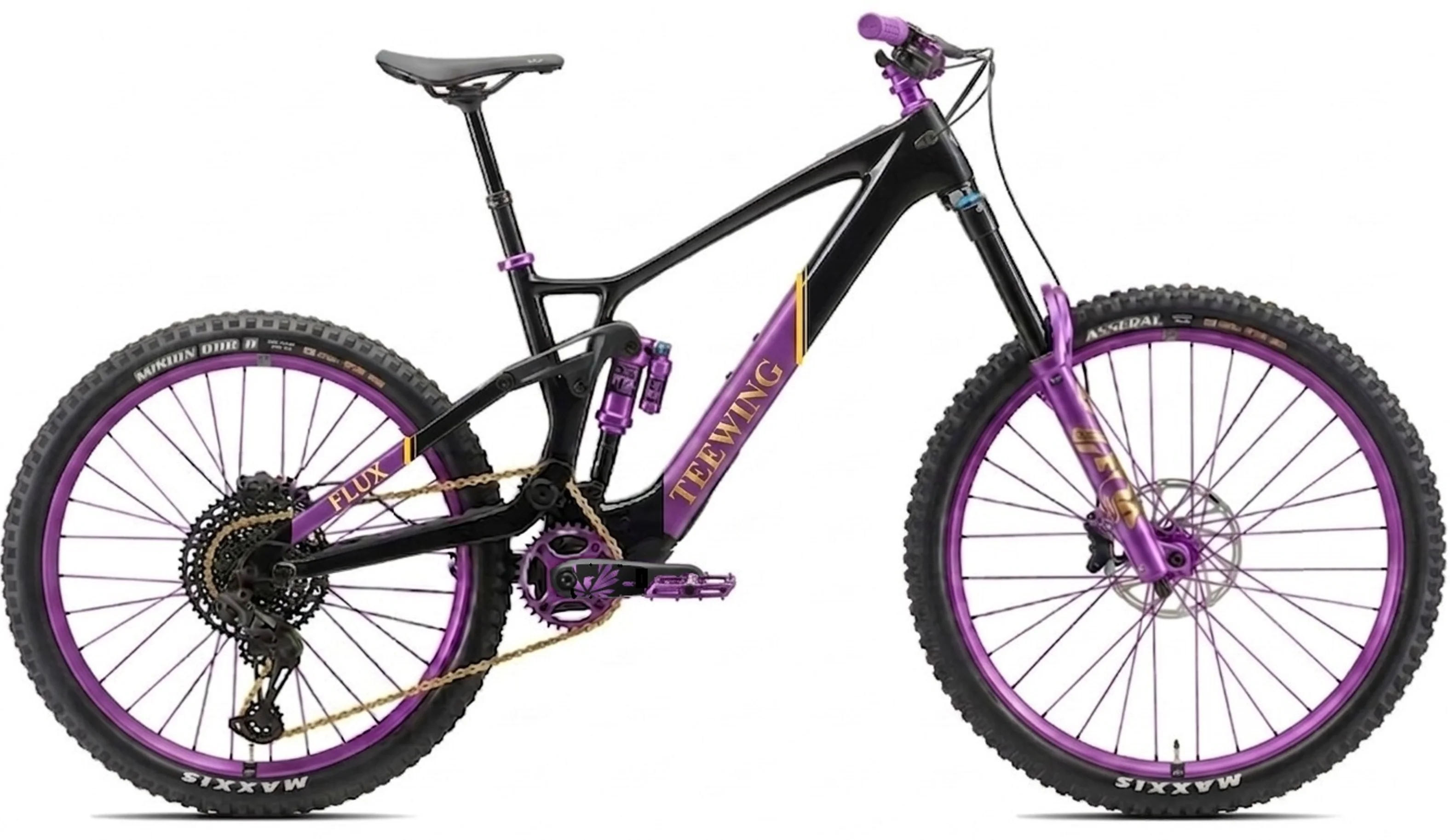

I'm adding lots of lavender, purple, Including a vinyl wrap, and a touch of gold to my black one. Wheel rims, hubs and most accessories purple or lavender. The decals gold, as well as Renthal Gold Bars.

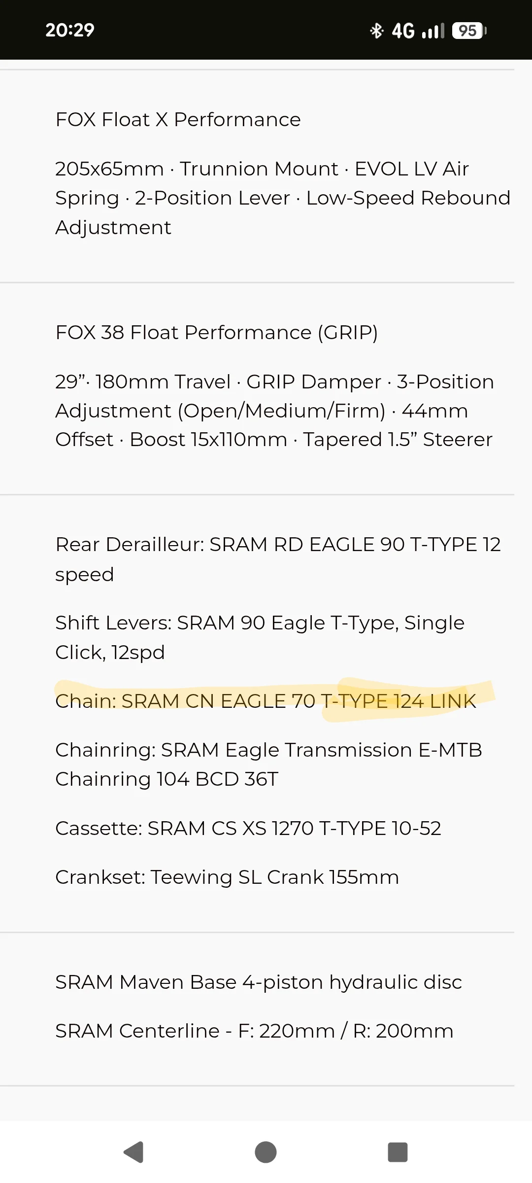

Gathering a few parts required to build onto the FLUX frame.... reusing a good amount of gear from the Norco to get things moving, aware to upgrade as required.....
Helpful advice here would be great regarding the chain.... opting for steel composite and am aware l require two chains, but then how many links to add to one chain to create the desired length?

Teewing website says 124 links. I bought a 126 link KMC T-type gold chain.
I'm hoping that will work.

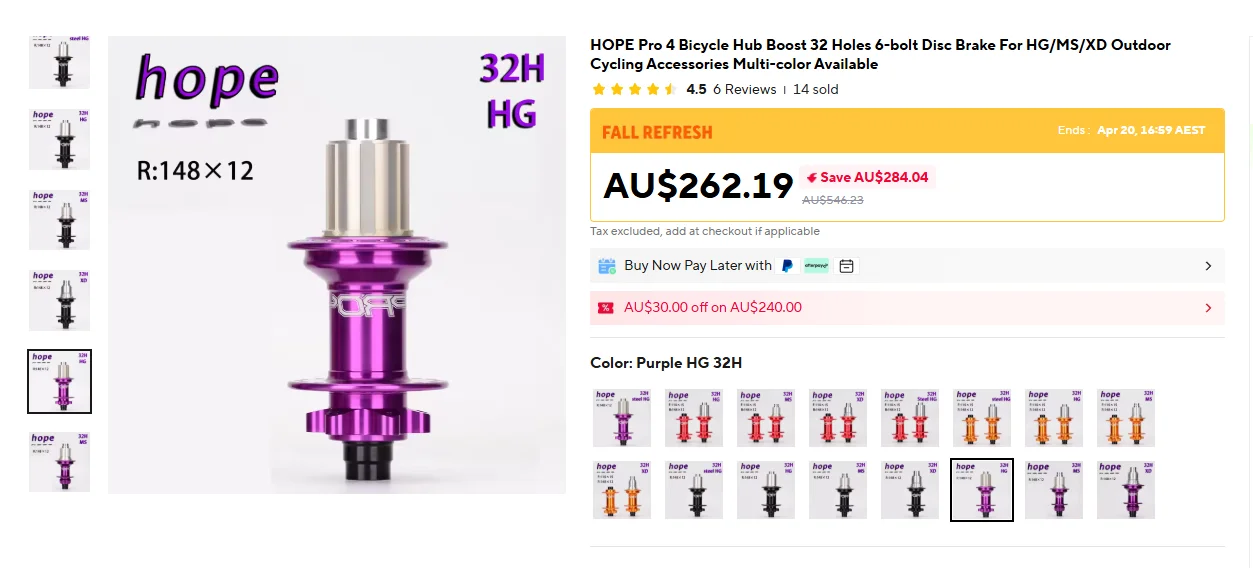

I've been running the Koozer XM490 Pro on my 1000 watt Amflow. They have held up really well. I have gone to the Koozer 350 for the Flux, which is a stronger 40t ratchet hub.
Worse case if I experience issues, is I'll upgrade the rear to a Hope Hub. They come in the same Lavender colour.
