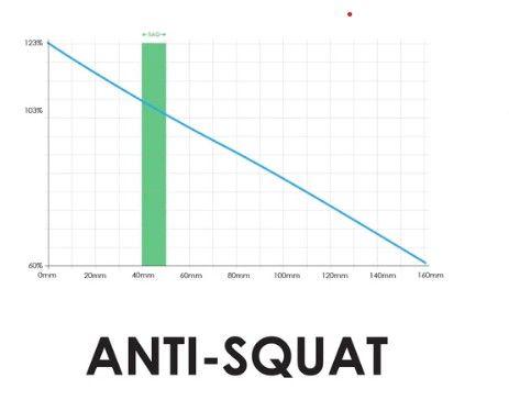

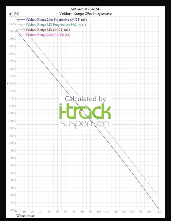

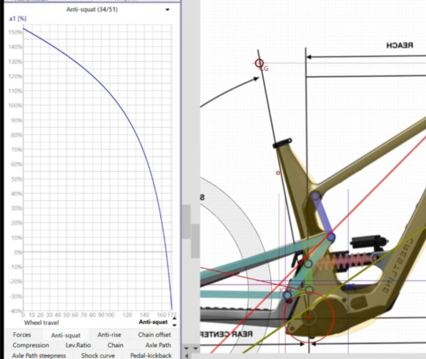

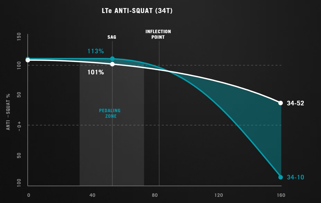

I decided to do a little more research into kinematics and I think the correlation to what I am looking for equates to a linear anti-squat chart where sag and beyond < 100% , lower the better.
Velduro:
Chromag Low down:
Crestline (RS181, but should be similar for RS180) reference post
Yeti LTe - which is well in the negatives late into the travel. Quite curious how I would jive on this bike, but way too expensive imo.

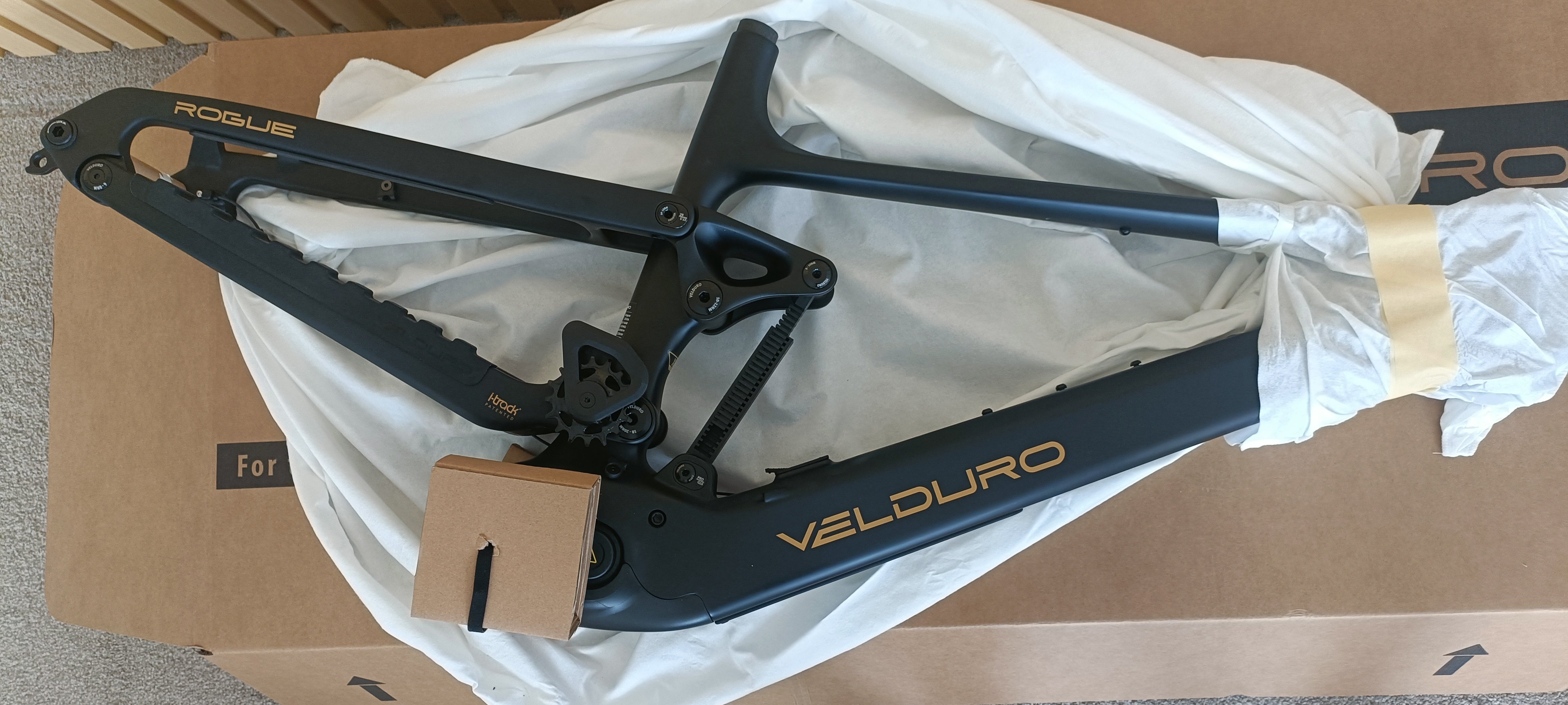

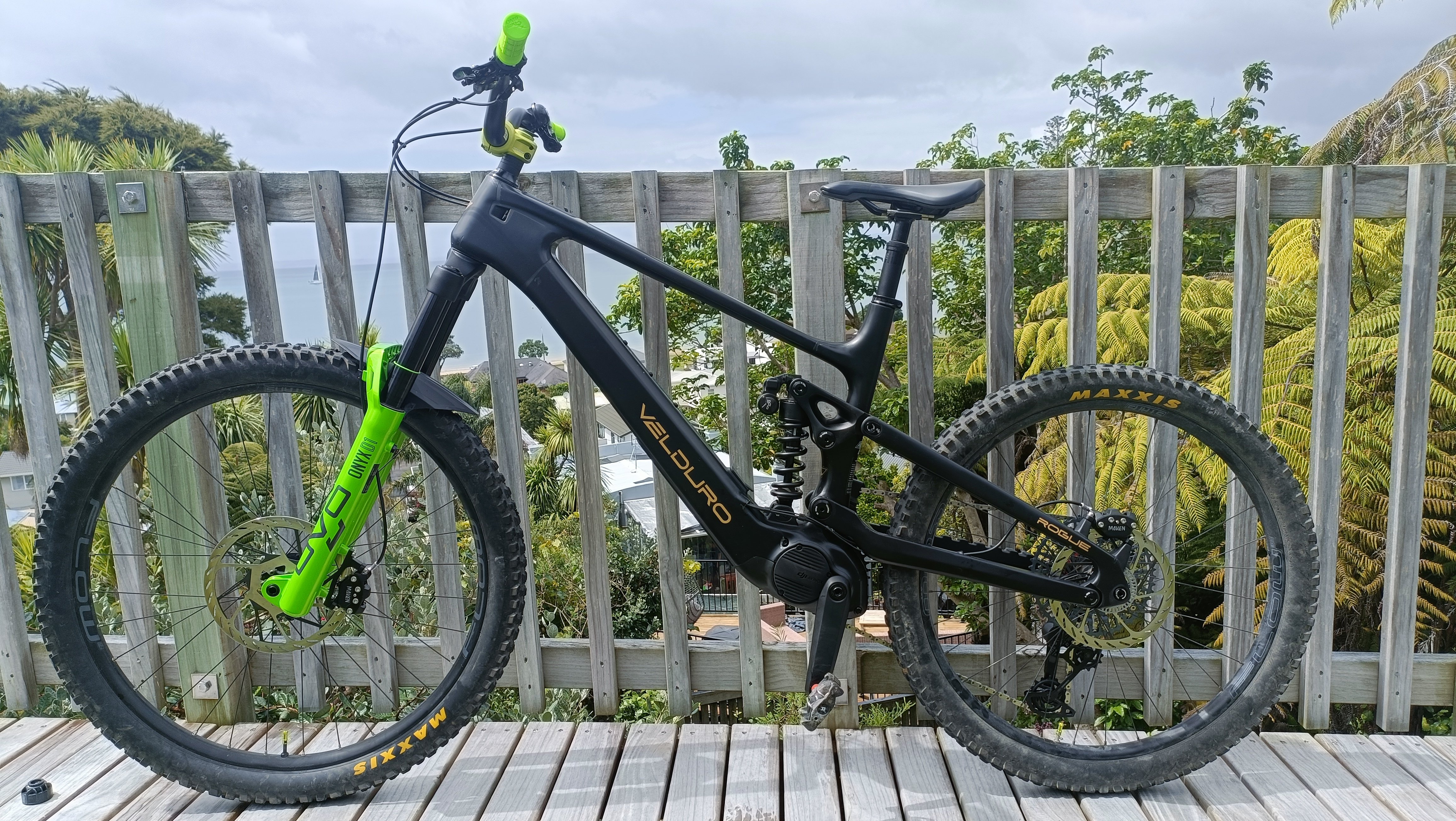

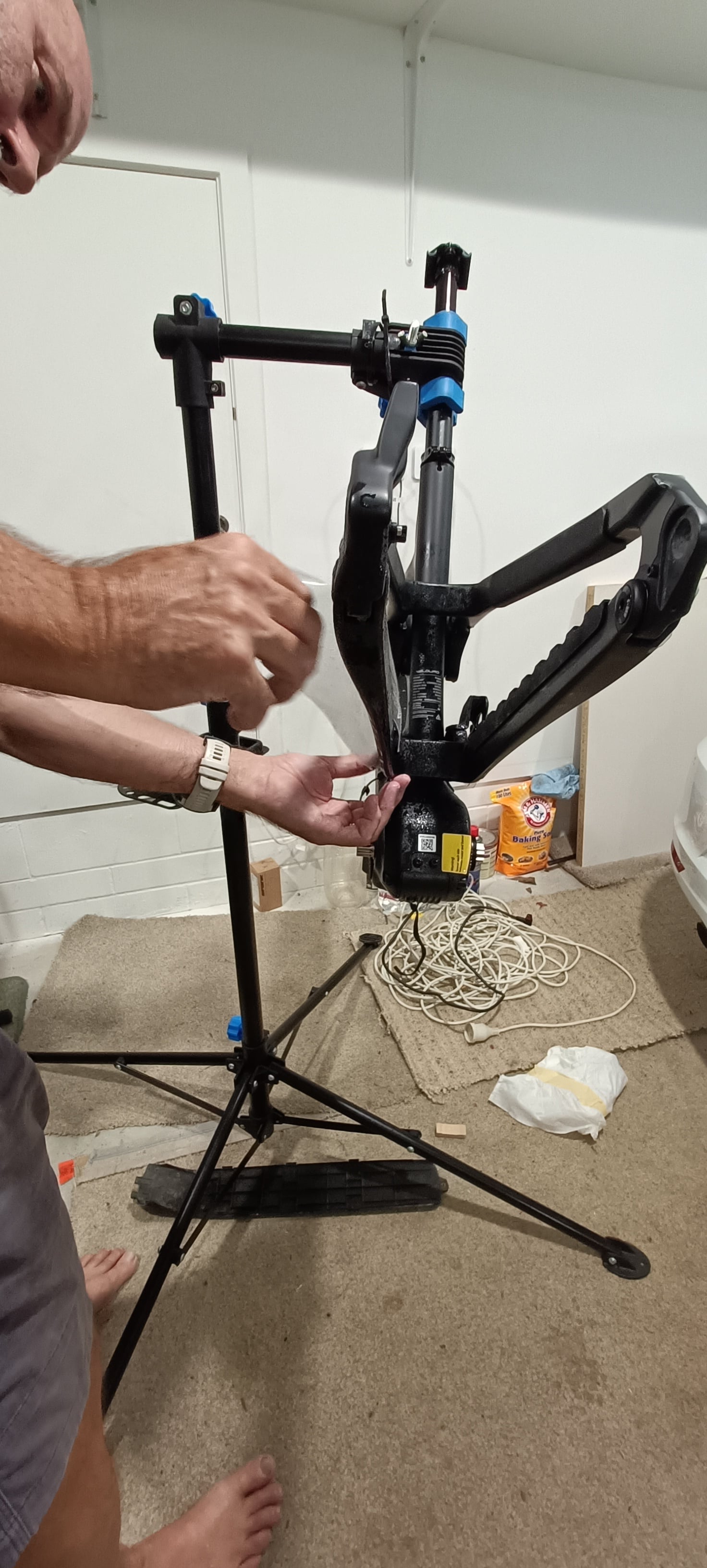

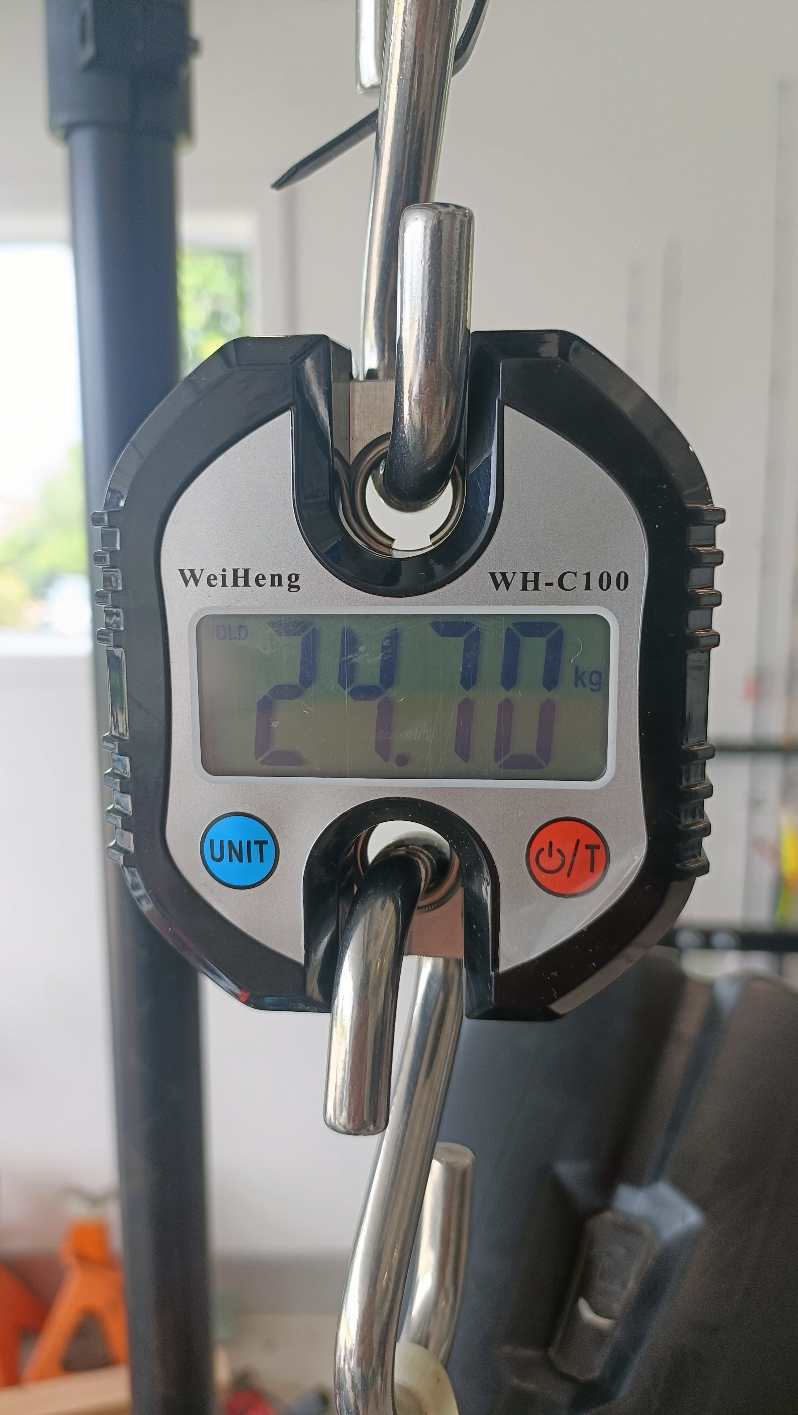

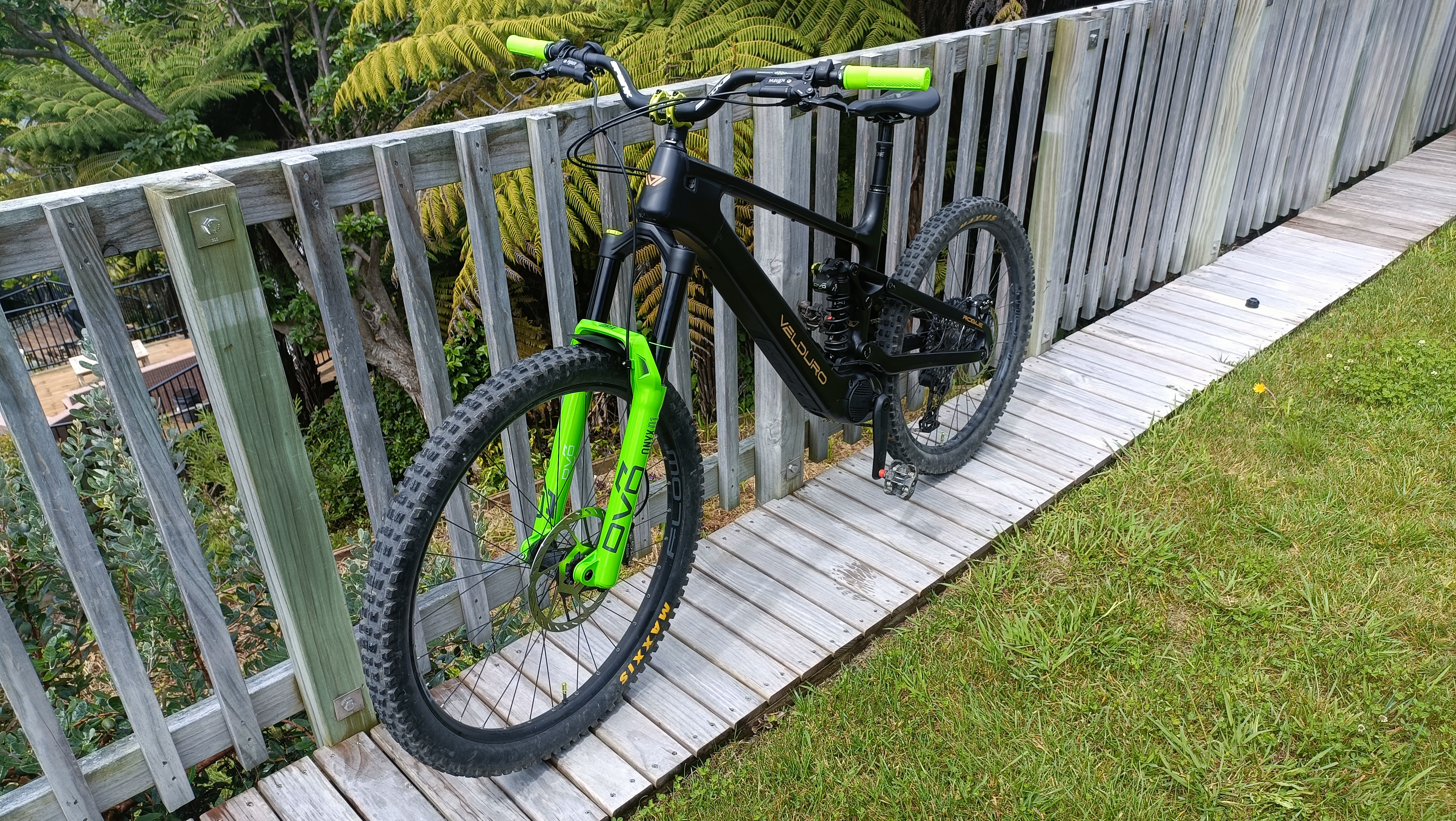

Has anyone fitted the "spare" motor spacer shims that come with the frame? There were none fitted when I removed the motor and it seemed a reasonably tight fit. Edit: tried to fit them and its not possible gap is too tight even for a single spacer.
Other than that, a rear brake bleed and lubing the chain, my XL is ready to go - just need it to stop raining now!
Ridewrap was not fun to fit.... hard to remove all the air bubbles so not going to try.....
