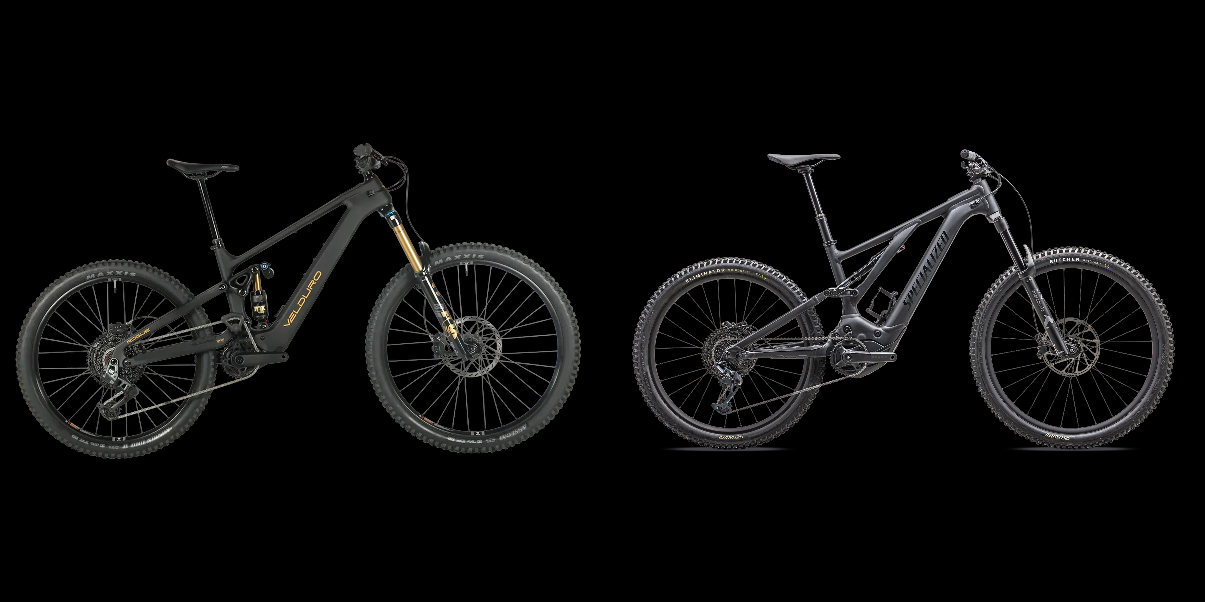

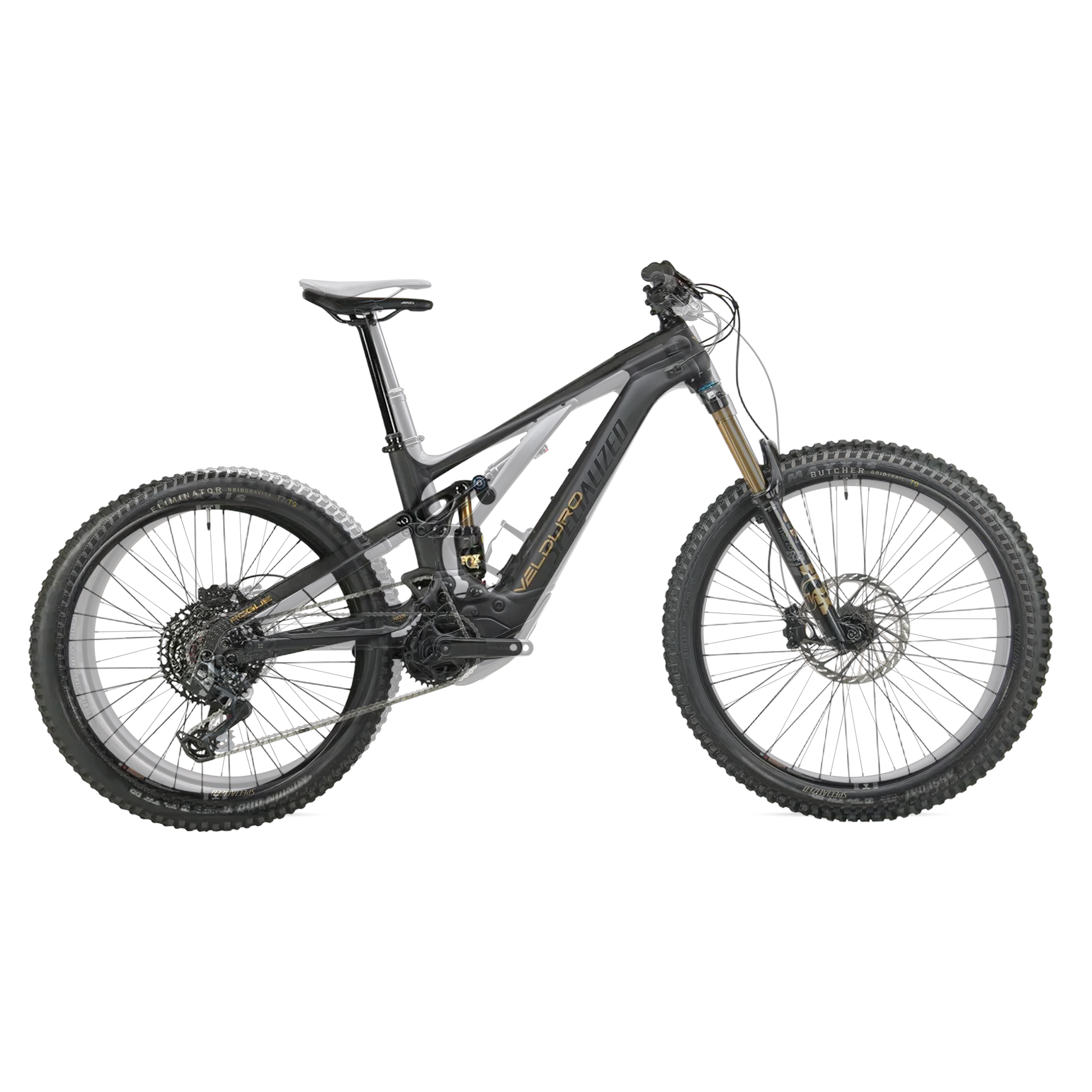

Rogue and Gen 3 Levo as requested. >
Hate to say it, but the Rogues downtube is nearly the same thickness as the old Levo's in these pics, not taking into account scaling and sizing differences. Of course the same can't be said if the comparison was to the latest gen Levo. Still, the Rogue is a an Avinox steed, so there should have been no comparison and would have been silly if the Levo was compared to, say, an Unno. I'm not trying to harp on the bike's aesthetics (I have a deposit on one), and while I really like the bike's appearance overall, I have a gnawing feeling that the downtube could have been made slimmer, as has been afforded with other bikes that use Avinox's slender battery system. OTOH, this this might be some optical illusion, as I've yet to see any Avinox bike in the flesh.
Have you seen it in person? What ebike you ride now?

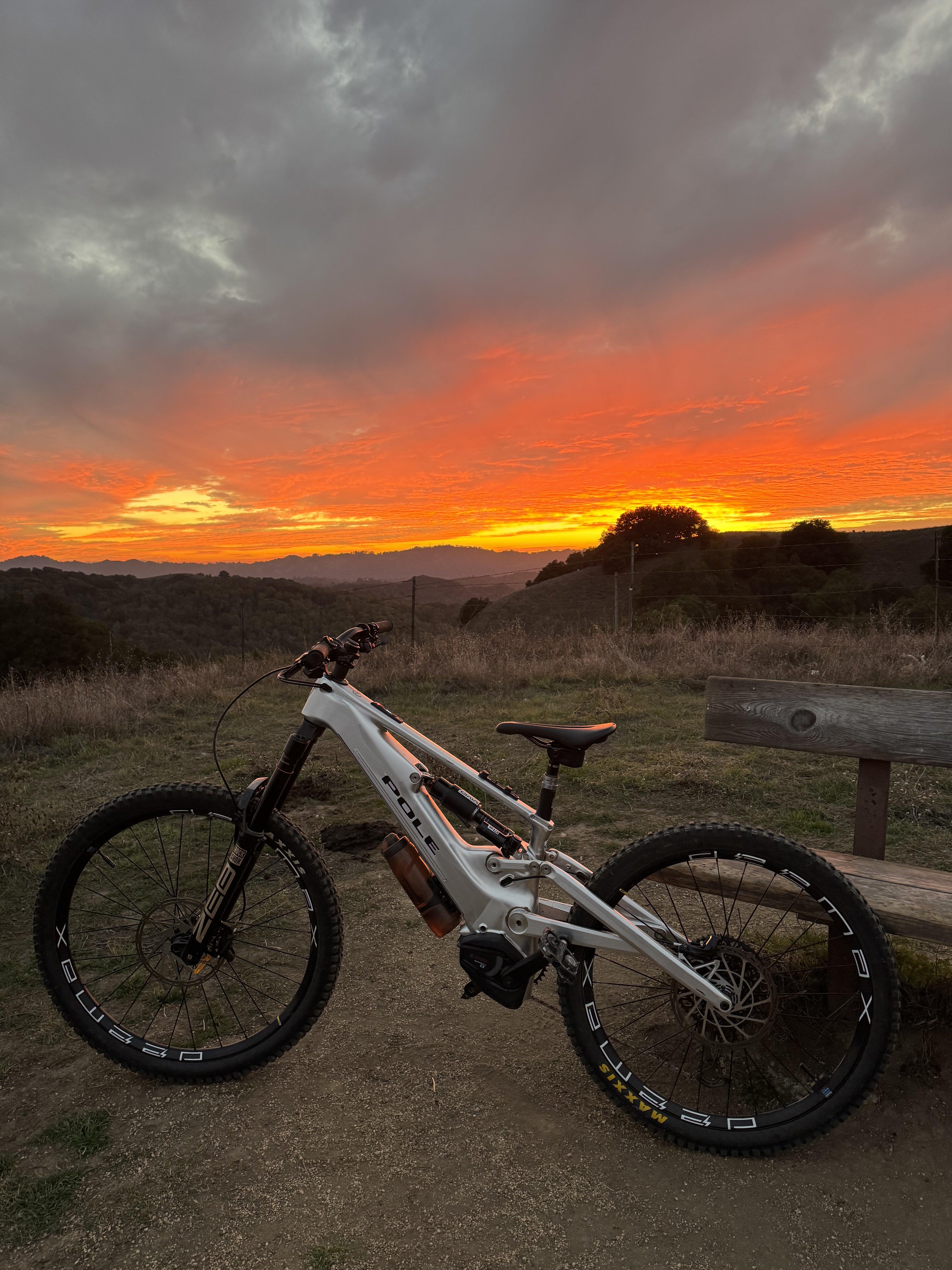

Quite the all round beautiful bike'n nature sunset scape capture slickrock.... Polaroid at its finest 👍 This be now kept in the stable warm dry and clean collectable.....

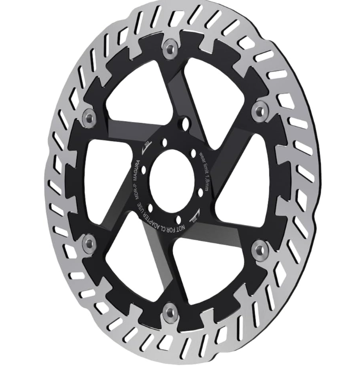

The Magura MDR-Ps are the best rotors I've used, and by a long shot.
They are thick, they are 2 piece, they never warp, they are hard to overheat, they have a lot of bite, they are lighter than they look as the center section is Al, heck they even look great imo.
Also, if you see that little hole above the mounting holes, they sell a snap in magnet that on some e-bikes with rotor mount speed pickup can be used in place of your stock magnet pickup. My Fazua 60 is able to utilize this.

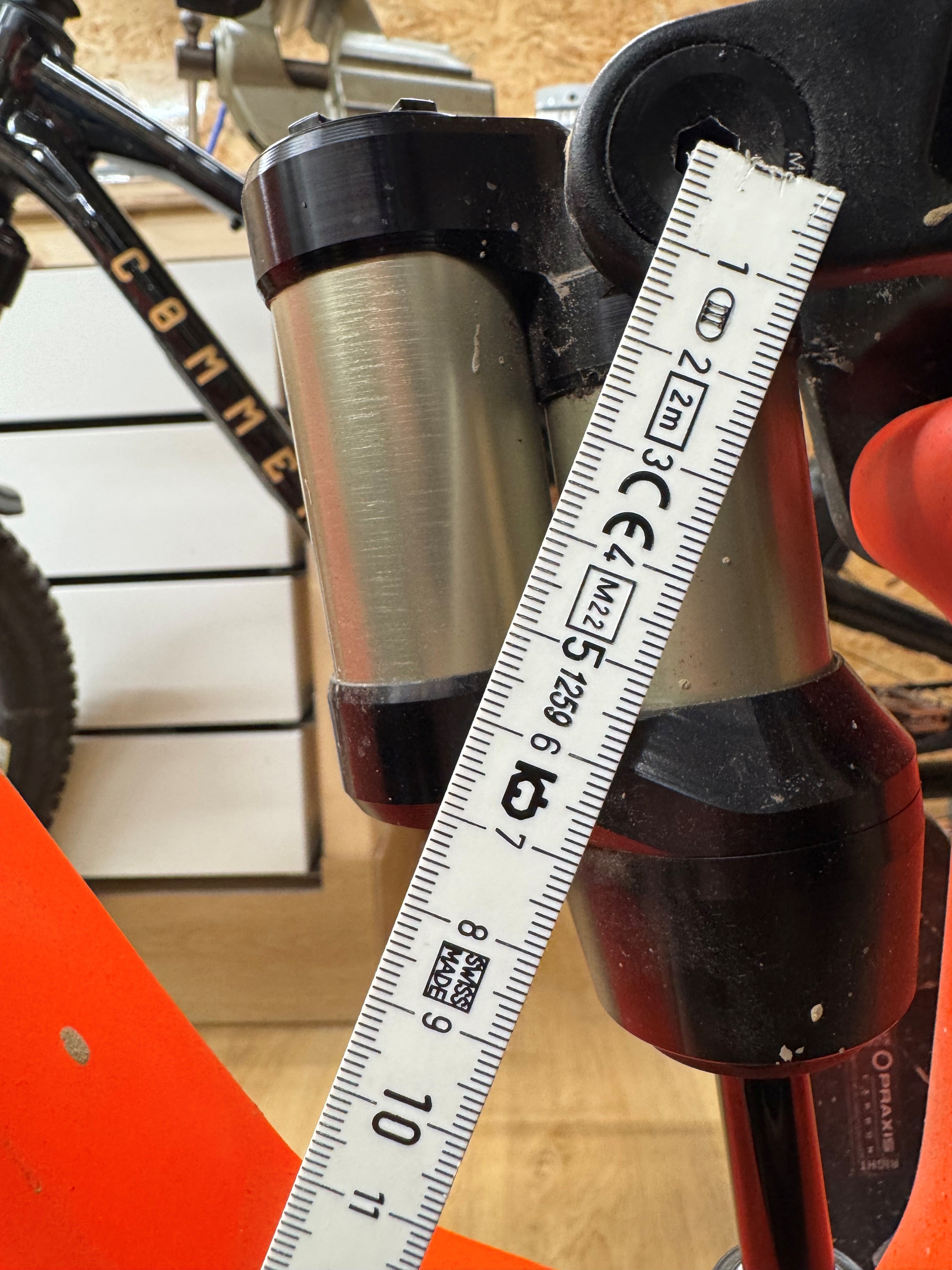

Has no one planned to install the Intend hover monocoque?
I measured my Intend Hover Gamechanger at home and according to my measurements, it should fit. Cornelius from Intend also confirmed to me that the monocoque is very similar in terms of dimensions. Is this shock list from Velduro really correct or did they just write something down?
ah, perfect, no worries for me then. Thanks.
