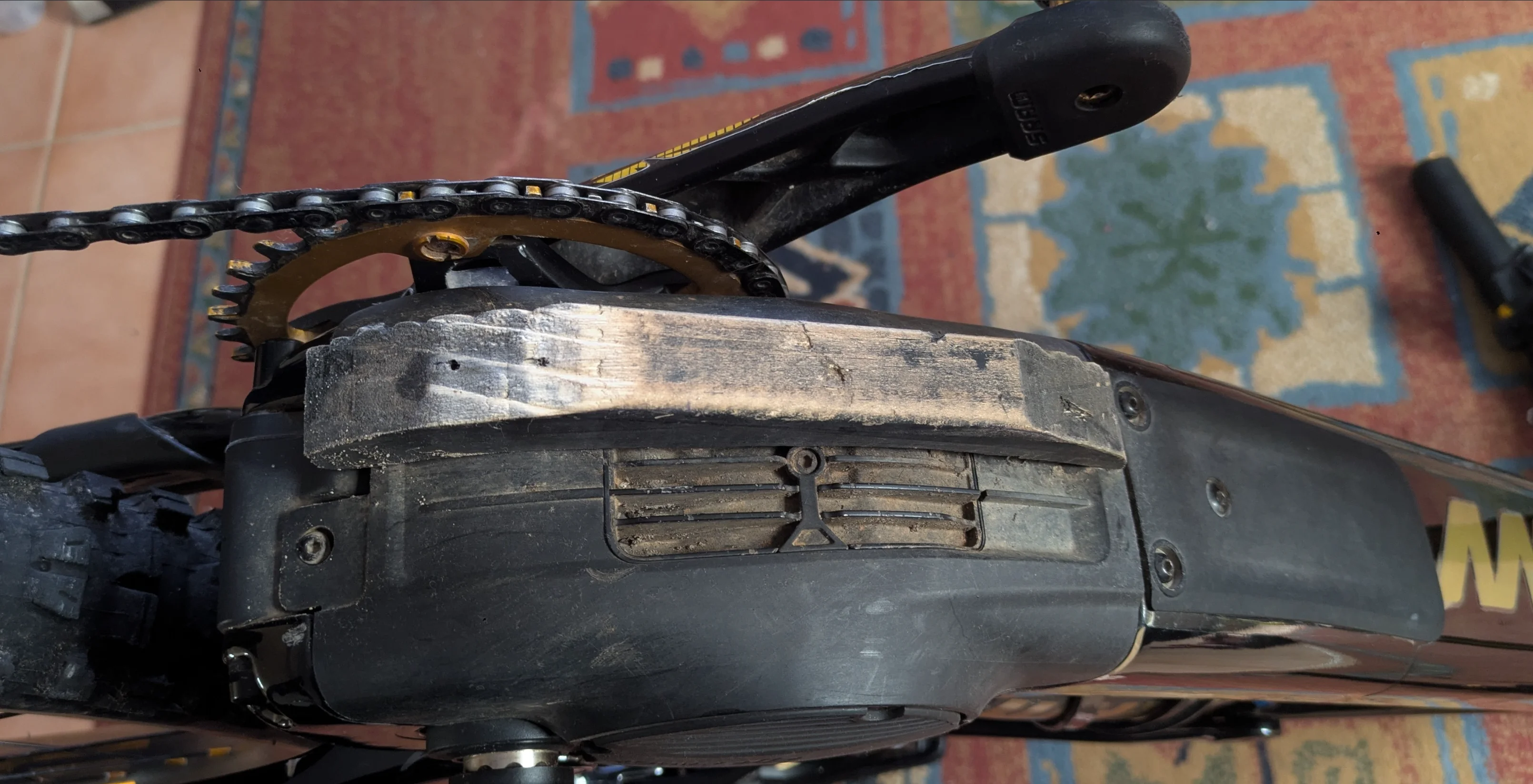

Have you found/installed any protection for the motor/chainring area?
No I haven't. Thought about but have not done it. TBH Ive never run any protection there in the last 15 years and never had any hits that have done chainring or in the last 3 years, motor damage. Touch wood.

Yeah I'm with you on this one. My chainring and chain are the guards. Never seen the need to run anything and never had an issue. The way I see it a chain guard would only make things lower and consequently easier to hook up
It really depends on the terrain you are riding. I had an impact on my chainring that bent not only the chainring, but the avinox spider. I also have had little nicks taken out of the chain, which then causes wear to the $600 cassette.
I installed this homemade timber guard, and you can see the wear and impacts. I've been running this for about 9 months. I did replace the timber guard once after a big impact caused a larger split. But this one has been on for about 5 months. Takes me about 20 mins to whip one up using a jigsaw and some decking board offcuts, that I have heaps of.
It literally only protrudes a few millimetres higher than the chainring, and you slide over things much easier than sliding on the chainring.
The confidence this has given me when climbing a big vertical obstacle has vastly improved my climbing. It also has given me the confidence to roll off any drop, not caring at all about damage to the bike. You can literally see the gouges I've caused in the guard doing this. If I break the the timber guard. I just make a new one when I get home. And being under the motor. You literally cannot see it's there, unless I turn the bike over.

You can order your bike with with a custom chain guard from Velduro that mounts to the underside of the motor cover. This has been covered several times earlier in the thread that you can search for and get some some detailed pictures.

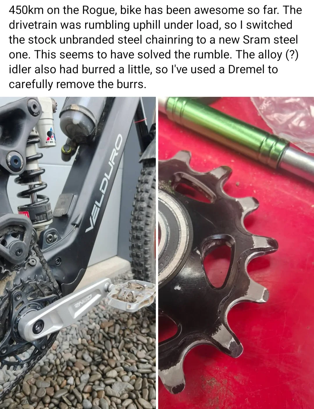

I saw this post on fb. Don't know if the idler is a proprietary part, hopefully not.
I'm surprised the idlers are made of aluminum. Since they're the first thing inline with the chainring, there's going to be a lot of torque on it. The weight savings vs steel is negligible at the smaller than chainring size and 1200w of ebike power will definitely wear it quickly.
I'm not convinced that it is aluminum. I read somewhere that in their first prototypes it was, and it was wearing too quickly. So for the actual saleable parts they use steel. Can't find the source though. Can someone confirm?
I’m pretty sure it’s steel. It’s fairly heavy.
I’m at over 500 miles on it, zero issues.
