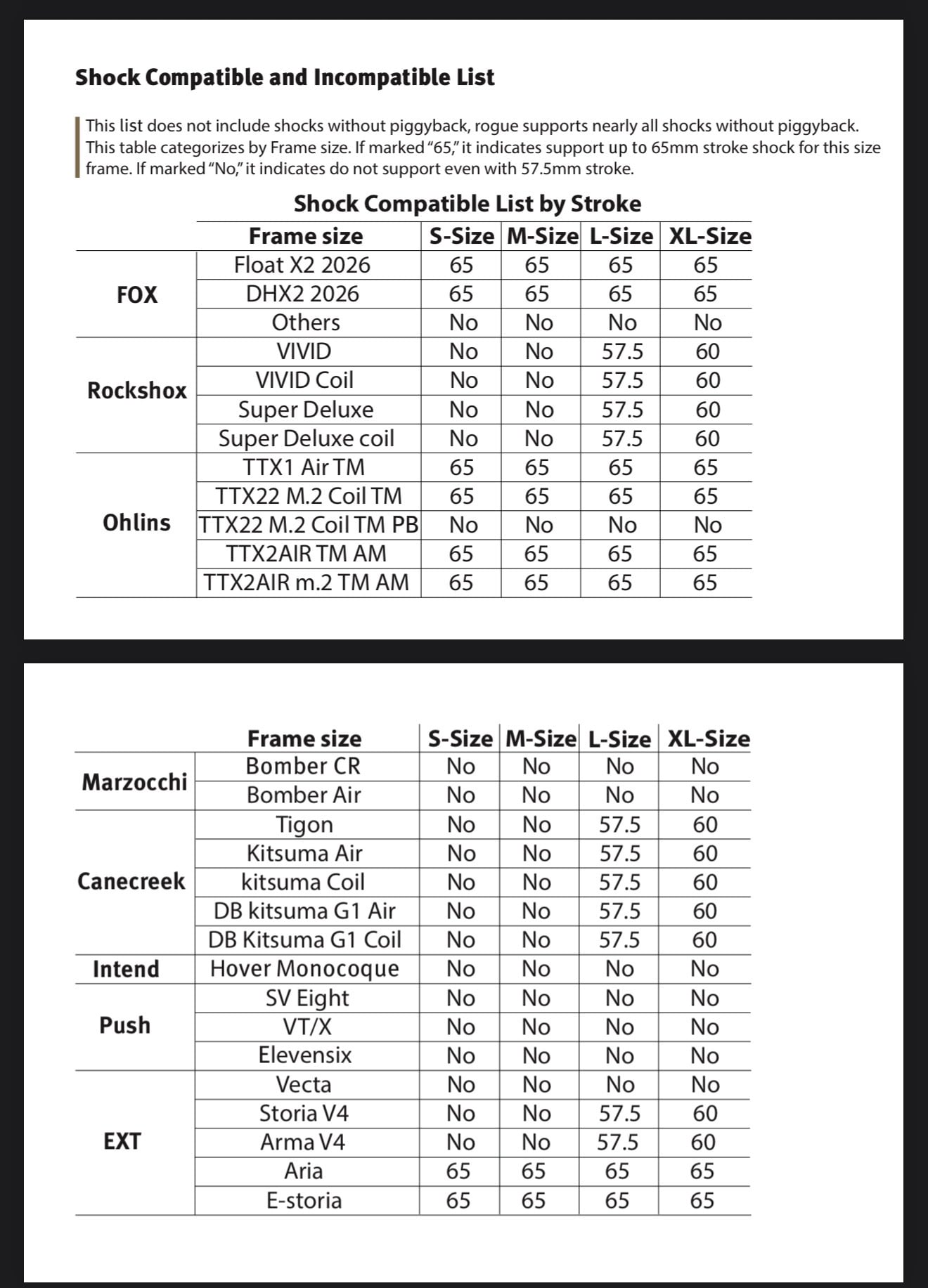

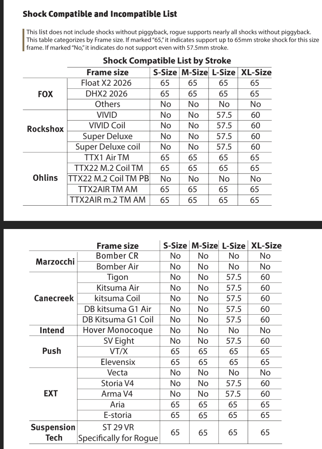

This chart needs some updates! Push VT/X installed and works like magic 😉 I'd recommend to do actual shock measurements (like the pdf indicates) and make your shock decision accordingly.
so how can this be? according to velduro this shock doesn’t fit, yet i saw several on facebook already. this is the only gripe i have with this company is, inconsistent information
anyone know if you can fit the vivid air to this frame?
According to Velduro: no
The clearance between Piggyback and charging port is not enough at max travel they say. I would very much like to see someone try though, to see if there really is collision or if its just tight.

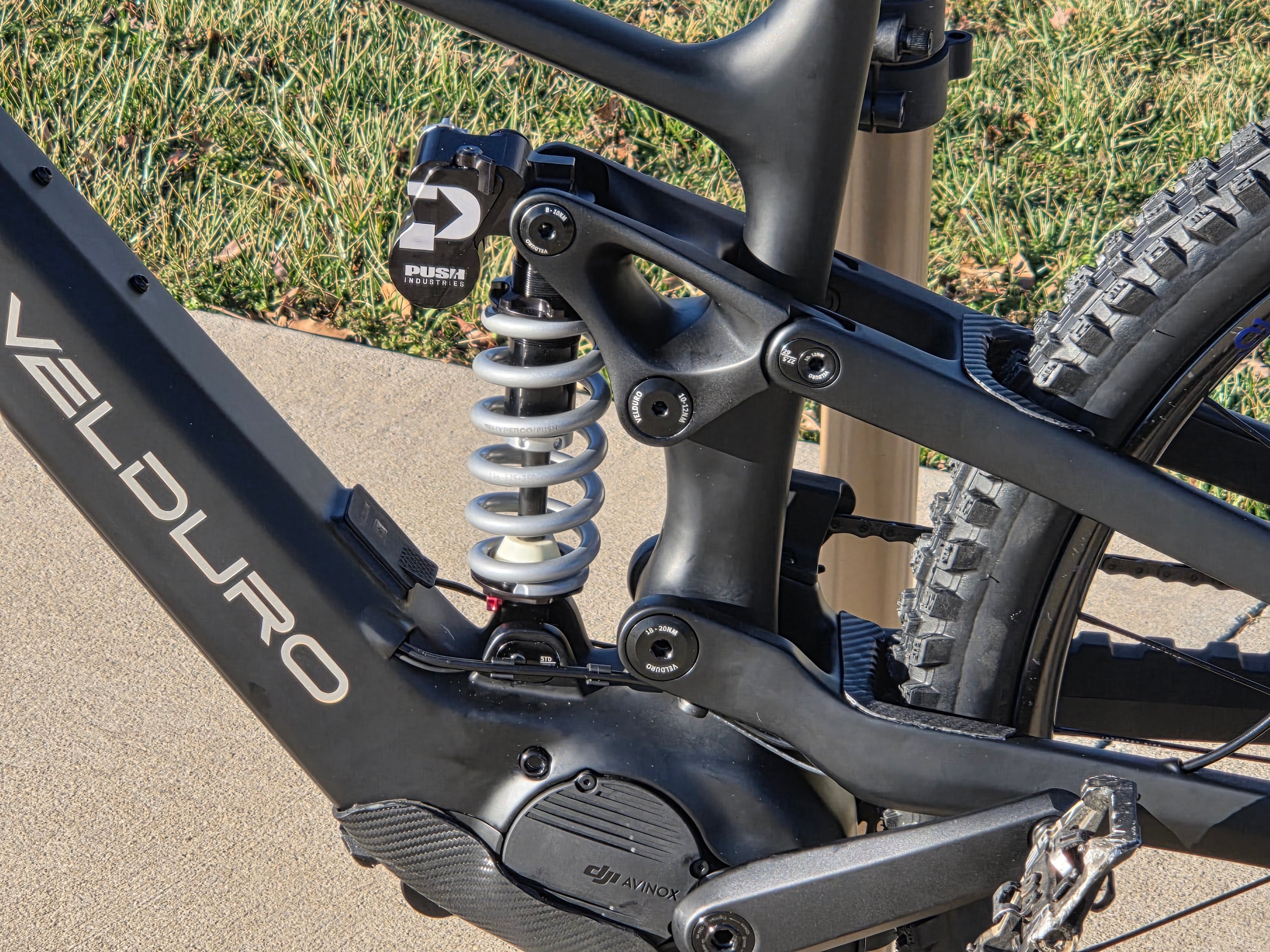

What is that below the motor? Is that a selfmade motor cover? Or something you can buy? Looks very nice. And sturdy.
On my current bike I have something similar that I made out of cutoff of an aluminum pillar for a porch roof. Works, but is ugly as sin and heavy. But after buying (and destroying) the third motor cover I was afraid next time the motor itself would take a hit, so I needed something that could take a beating.
Maybe it's just me, but I don't trust anything I see online without verifying, unless I know I can trust the source. I'm sure Velduro is doing the best they can with the info and timeline they have available, but they are not waiting for perfection when communicating, what I can understand with a new company/product. Ideally, instead of the "No" they should have indicated "TBD" for the shocks they had no real info on at the time, and use "No" only for the once they know for sure it won't fit. On the positive note, they clearly explained fitment requirements and detailed measurements, meaning anyone who is really interested to know if they shock will fit or not, could do they homework. How I see it, it's up to us to trust the source or do the homework.
Self made. Thicker >2mm for the motor cover and ~0.6mm for chain and seat stay. We have a lots of loose rocks in various sizes on our trails, which are getting thrown up or getting stuck between the knobbies of our aggressive tires, and end up scratching the inside of the chain and seat stays.

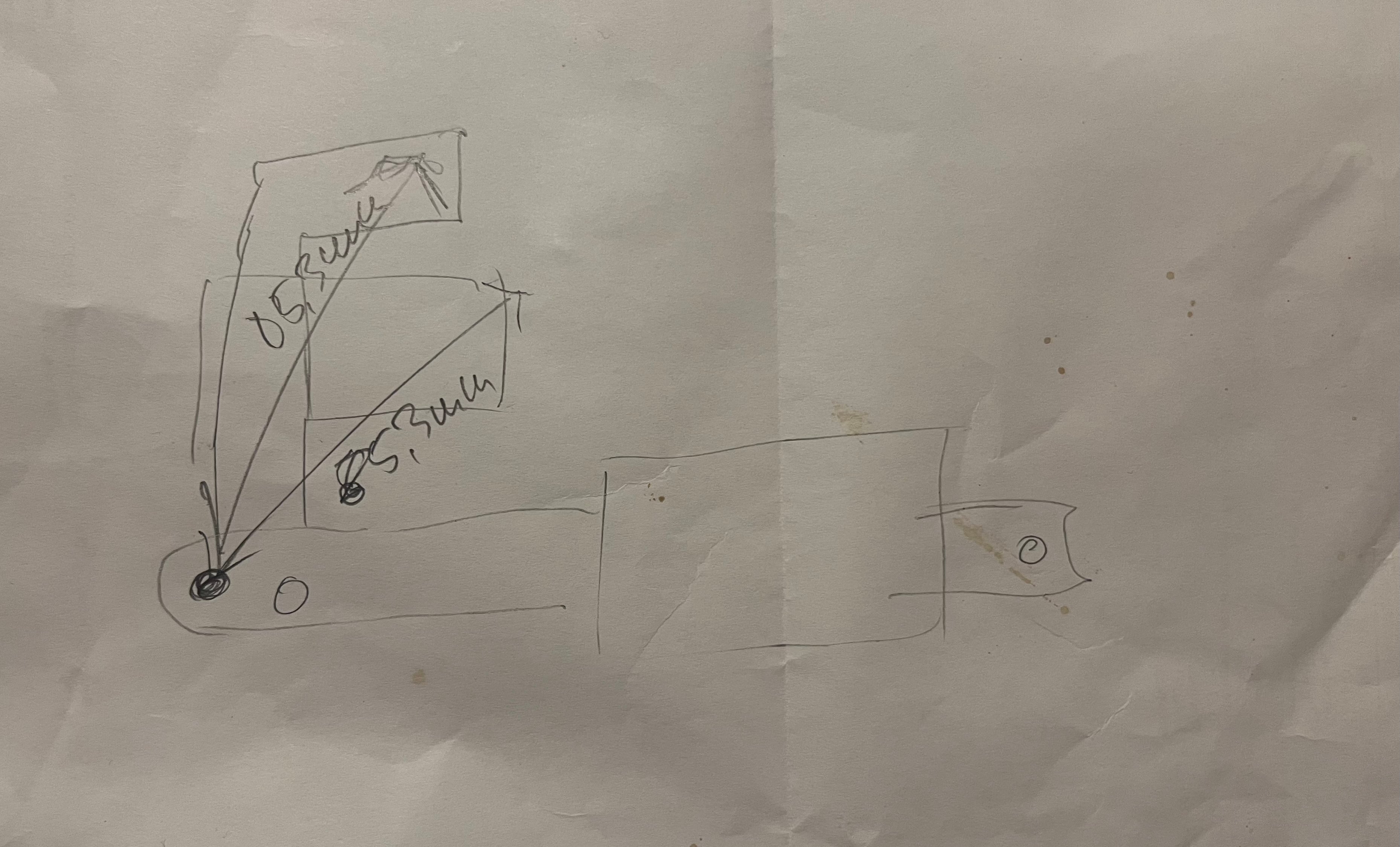

so why DOES the push fit? why could @Alex NZ fit a vivid? according to velduro they don't fit.
my problem is that i need to rebuild my fast suspension fenix as it is in a 230x65 config right now. just changing it to trunnion is WAY cheaper than also having it fitted with the older style reservoir they used in earlier shocks. so it would REALLY be helpful if they would provide a better guide line here because the one provided lacks in accuracy...

why just giving one length is not enough:
both lengths would be ok according to velduro, but im pretty sure the shock with the taller reservoir in my sketch will hit the downtube even if the diagonal to the outer point is the same…
Like I've said. Velduro mixed up the "horizontal" and "straight-line" wording confusing everyone. But, if you start thinking you'll realize, if no part of your shock extends beyond the "absolute distance" corresponding to your desired shock stroke and frame size (plus your comfort of safety) you will be fine. You guys can keep getting upset that Velduro is not spoon feeding every detail and mixing up words, or can take initiative and start thinking/measuring etc. to find answers.
BTW, both shock on your sketch will fit without an issue as long as the distance is less than the "absolute distance" required. If you don't understand it why, then start with properly scaled sketch. If that's not enough use play dough, wood or 3D print and build a model.
Or just trust me 😉
