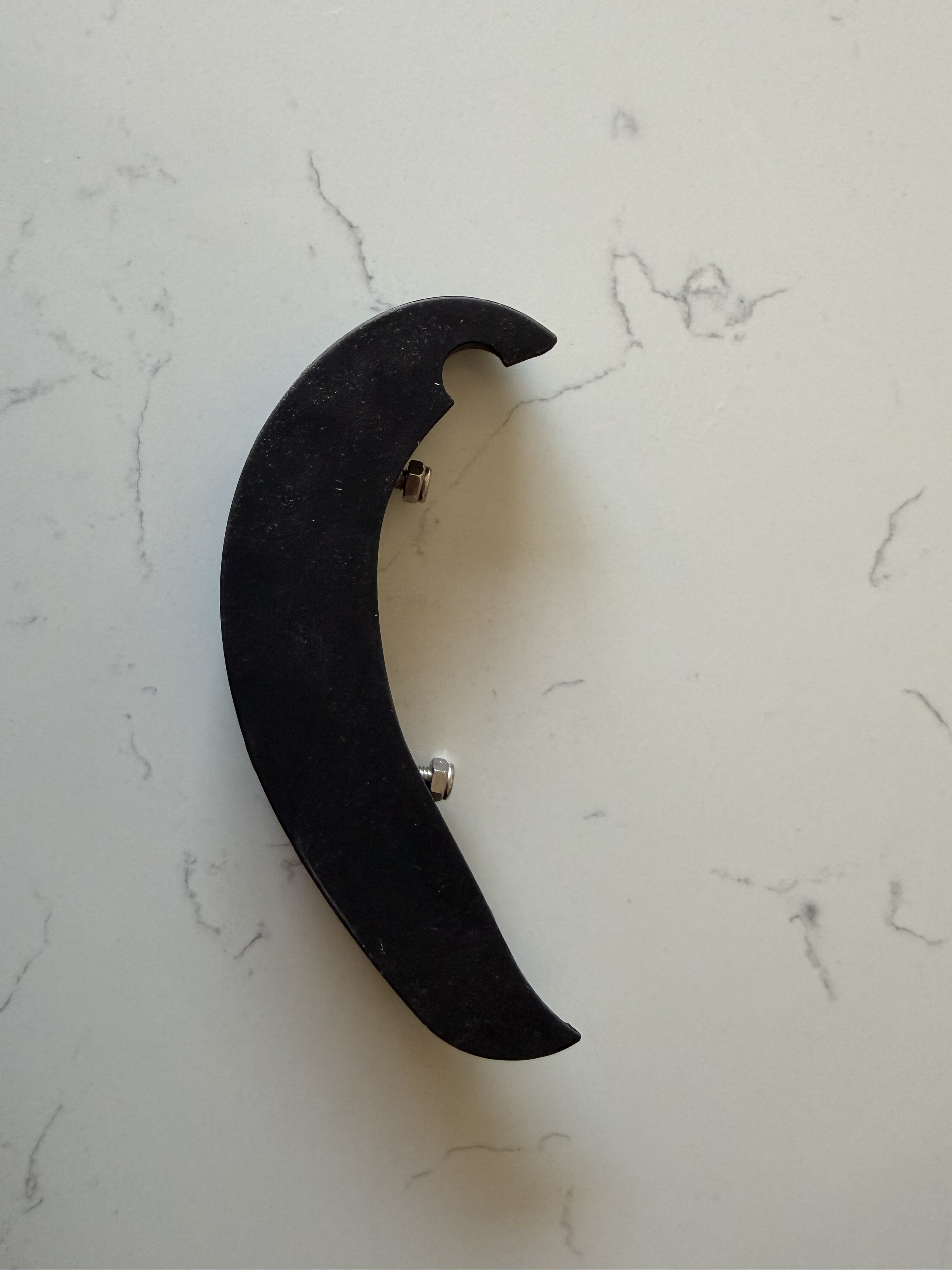

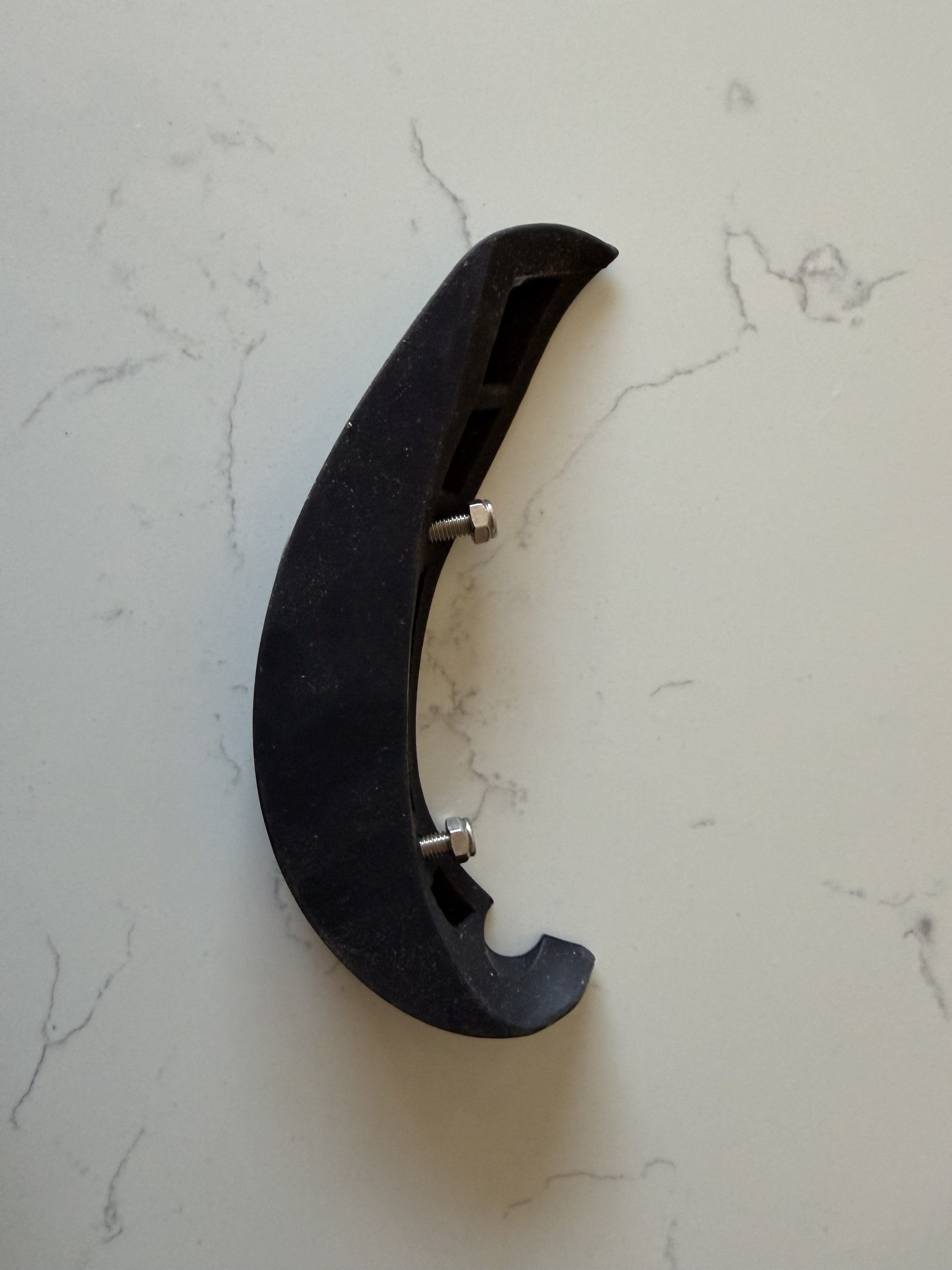

I purchased a bash guard from Velduro for $17. It is separate from the skid plate and bolts to the drive side of the plate. Connected with two bolts. Hope that gets you close to your answer.
Edit- the piece is molded from a hard rubber.

Apologies dude, and yes this is exactly what I wanted to know (i.e. that it's the OEM guard). What threw me off is that you had to pay for it. I was told the guards came with the bike from my Velduro contact and I recall during a prior unboxing video that the guard came in the box. I'm just glad Velduro has a solution to the M1 that got worked out early on.
Would be awesome if Velduro made one that protects the whole underbelly of the motor, I think as it stands it's simply plastic? I'm sure a robust plastic but nevertheless, rock vs scissors...
