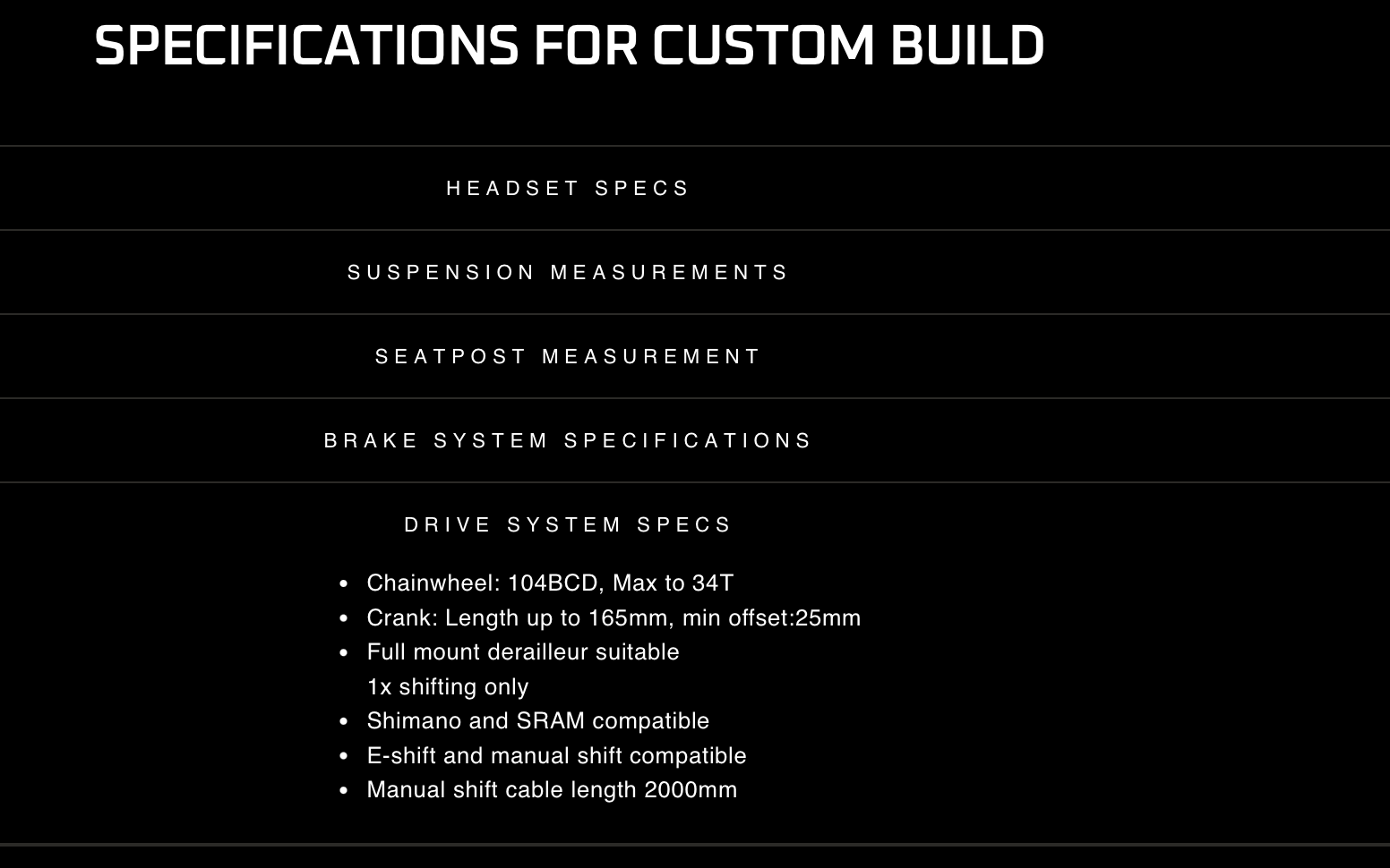

Sethimus is correct, the Avinox motor has a power port, my understanding it's the same one that Bosch uses and therefore uses the same cord, that can power the Transmission derailleur.
Furthermore, the Rogue frame also has the correct wire routing built in to accomplish this.
Think about the Vala/ Bullit CC frames that run Bosch motors, the motor is capable of powering the Transmission derailleur, and Santa Cruz didn't even mold the frames to accommodate this. So incredibly stupid.
this is promising, ...just looked them up - £185RRP!! wow
Just need confirmation of same connection as Bosch, I presume so as there is only 1 type available unless the Avinox builds that have this are factory bespoke setup.
I had spoken to Velduro about this a while back and they confirmed that you need a 780mm cable such as this one:

Sethimus, I think you miss understand - it is possible to wire the motorised mech to the main battery pack (on Amflows at the very least), this is what I am querying, not the routing of cable.
a picture for those who are not able to read. price question: why mention "e-shift compatibility" if all electric derailleurs are wireless? exactly, there is a cable port. ffs. not THAT hard
hint for the future: manufacturers usually provide such information. you need to look them up. plus, that topic was discussed in here already SEVERAL TIMES. reading the thread also yields information...
no avinox support for di2 so far i'm aware of, so only axs compatibility. exactly the opposite with bosch
That doesn’t clearly state that the mech can be powered from the main bike battery - that is my question.
Any bike can have e shifting installed as you say why list, but it’s not specifically stated.
As stated by Suns_PSD on the Santa Cruz Vala you can’t do this even though the Bosch motor/battery can.
hence why it's explicitly stated. else, it makes no sense of even mentioning it, as EVERY BIKE IS WIRELESS COMPATIBLE

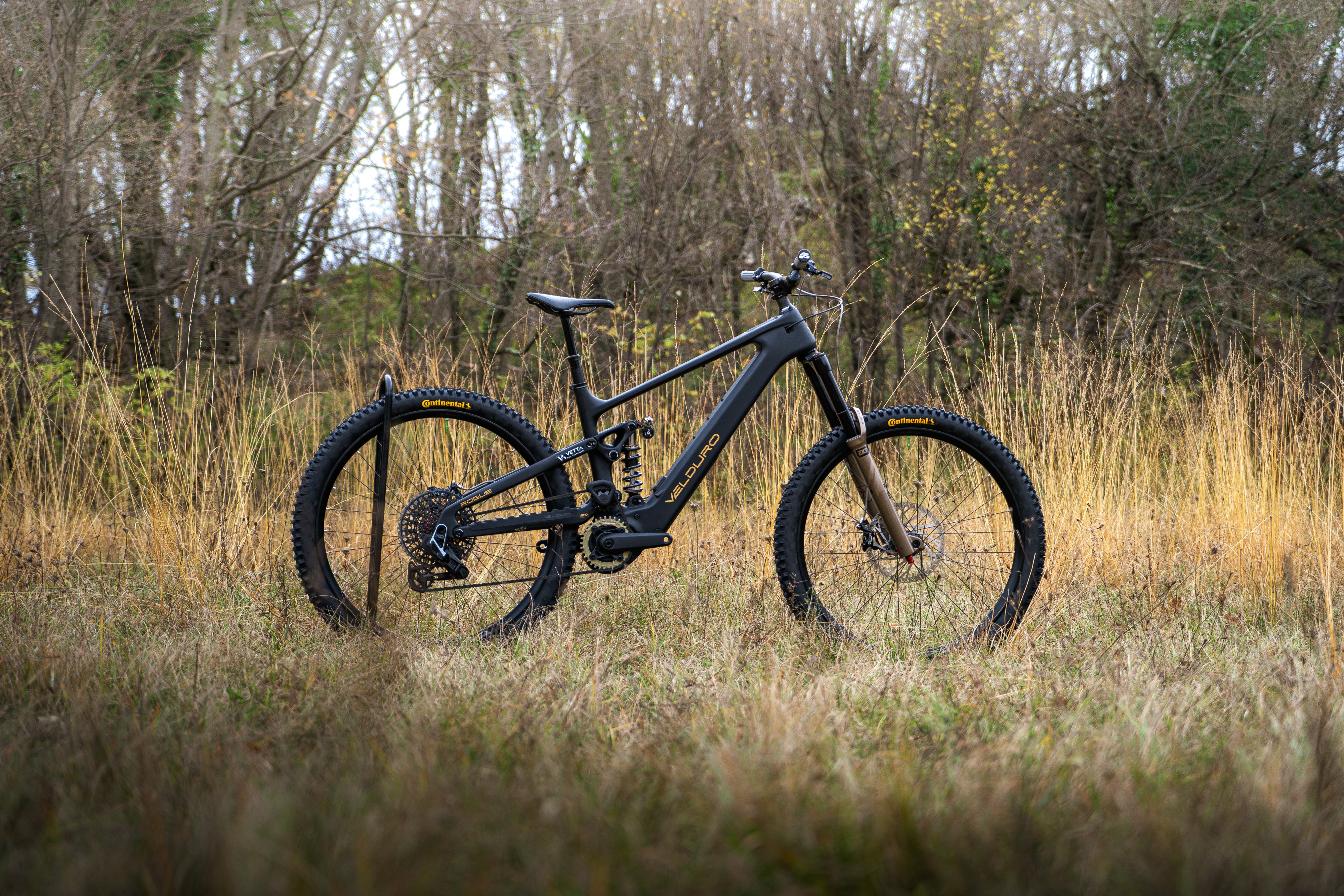

Hi friends,
to make the wait for the new bike or frameset a bit easier, I invite you to read and check out our Velduro Rogue VETTA Dream Build.
If anyone has any questions about the bike, we’re happy to help! 🙂
– Luka
