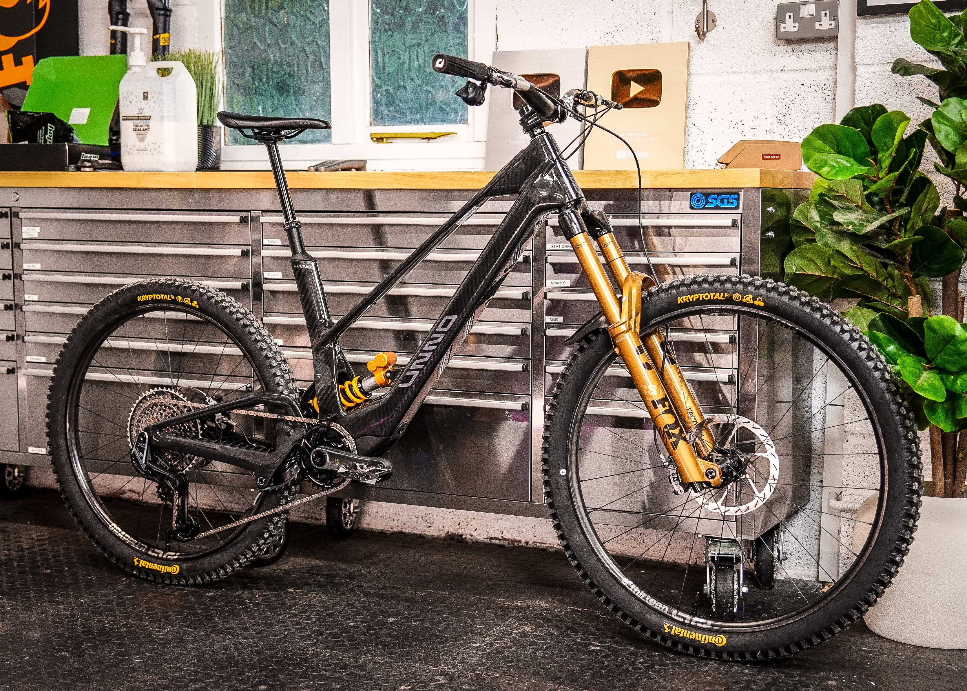

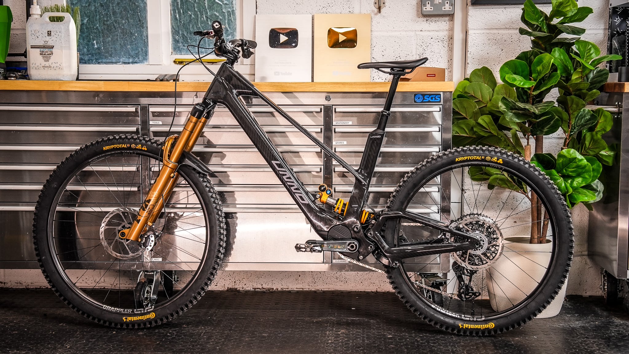

Unno Mith released with DJI motor, 800Wh battery
Finished
- 22.17KG
- 800Wh
- Sidekick Hub
- DH Rear Conti, Enduro Rear
- 210mm Dropper
- Ohlins Coil
- Sram Maven, 200mm front & Rear
Measures 1317 wheelbase, 455 chainstay in S3, 862mm front centre

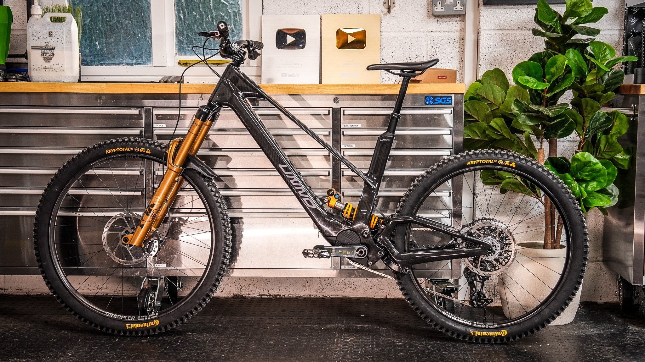

That's an outstanding weight for that build/ size/ battery pack.
It's unlikely that I'll be able to buy this bike in the USA at a reasonable price anytime soon, but still I'm eager to hear/ read about the handling and rear suspension performance of the Mith.

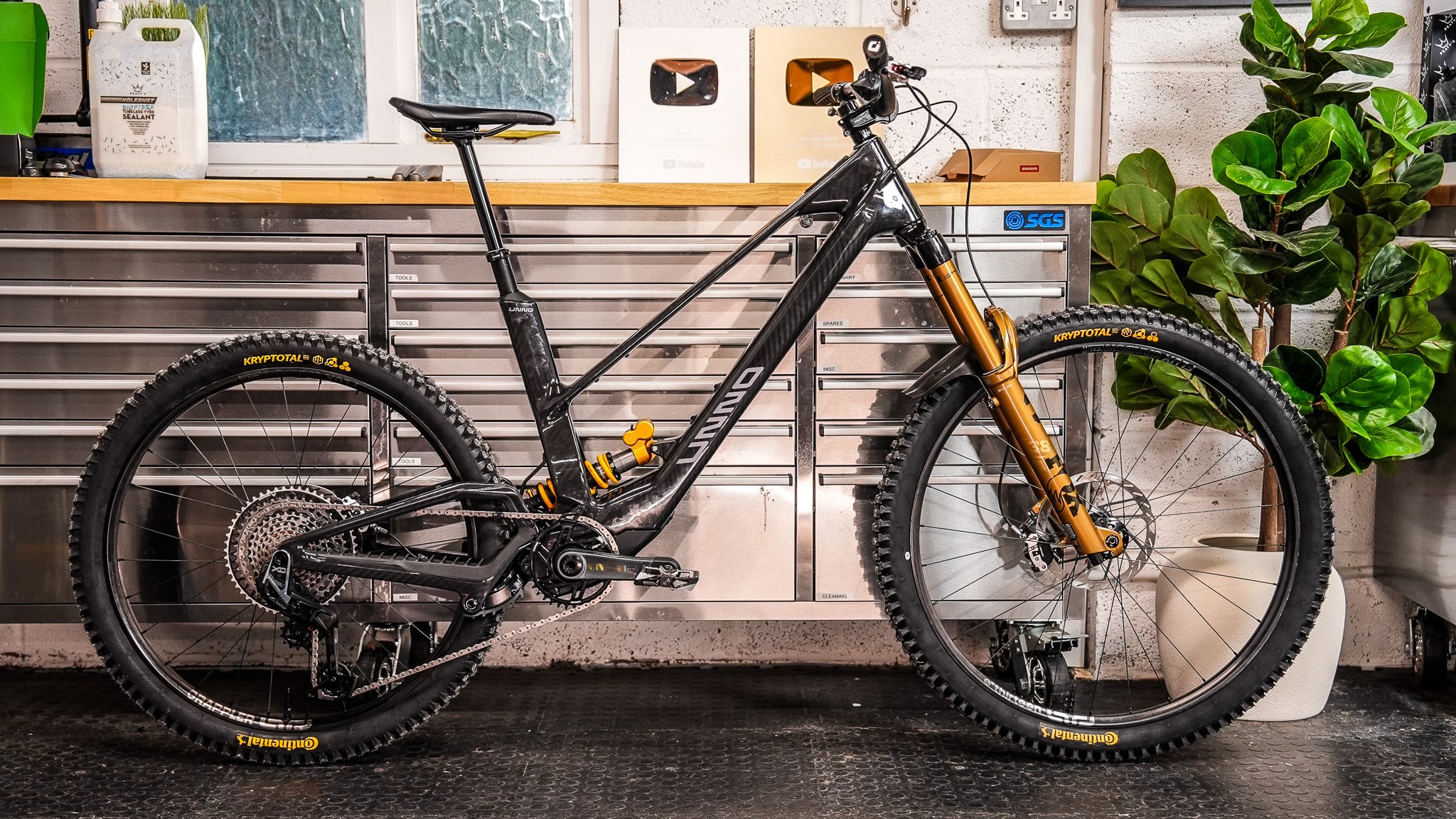

The bike seems really well designed. All the small parts, plastics are well thought out (motor cover, covers for rear cables etc). The chainstay cable routing for brake, speed sensor and AXS power cable all have inner tube runs, so super easy to run these (many bikes just hollow out a wide space and often need to spend a time fishing the cables through).
The motor area is so compact, its really tight in there with all the cables. Its actually the smallest cable area of any bike I've worked on, they've tried to minimise any spaces in the frame to reduce the size of it.
Interesting, the bike I’ve been riding is also similarly larger than the geometry chart. (1325mm wheelbase)
The S3 was on the big side for me on paper in the first place, this is ‘really’ big for a large.
I would like to measure the reach also, but based on the other numbers, I wouldn’t be surprised to see it over 500mm, which goes some way to explaining why it feels quite a bit bigger than my own bike which is comparable on paper, but feels noticeably smaller in reality.
I do wonder if the S2 is similarly oversized, if it is, it would probably be more suitable for me.

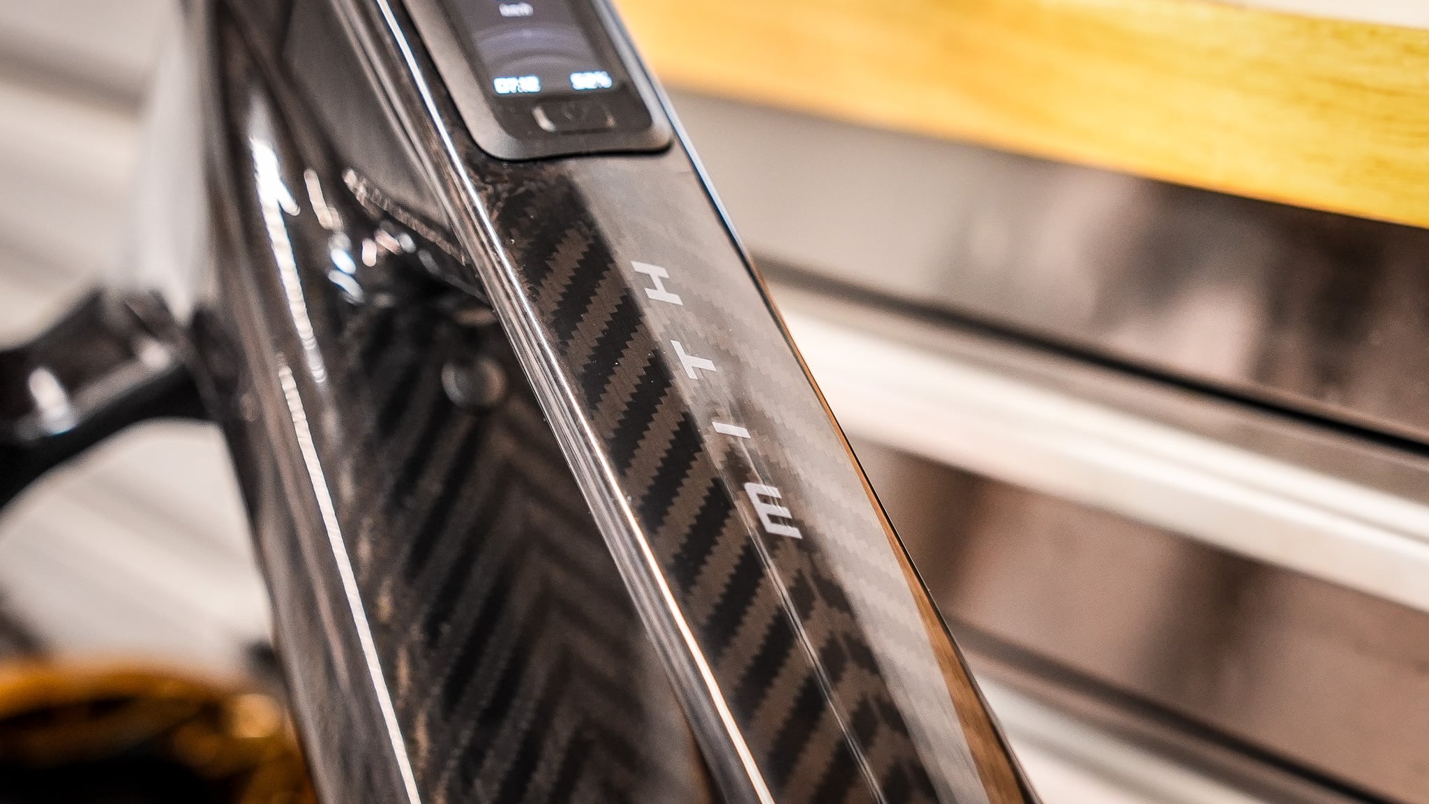

Man the frame is insanely nice.
From the picture, nice is an understatement. Just curious, the finish is very glossy which is lovely, is that from an abundance of resin in with the CF lamination or is that a clear coat finish.
I measured the reach less than published. I should have added above that I’m running a 180mm fork, stock is 170mm (that’s all I had available - I will order 170mm air shaft).
That fork reduces reach by approx 5mm and changes the other numbers very slightly (about +5mm wheelbase/front centre)
With the 180mm fork the reach measures 480mm which is a fair bit shorter than published.
Clear coat on top 👍

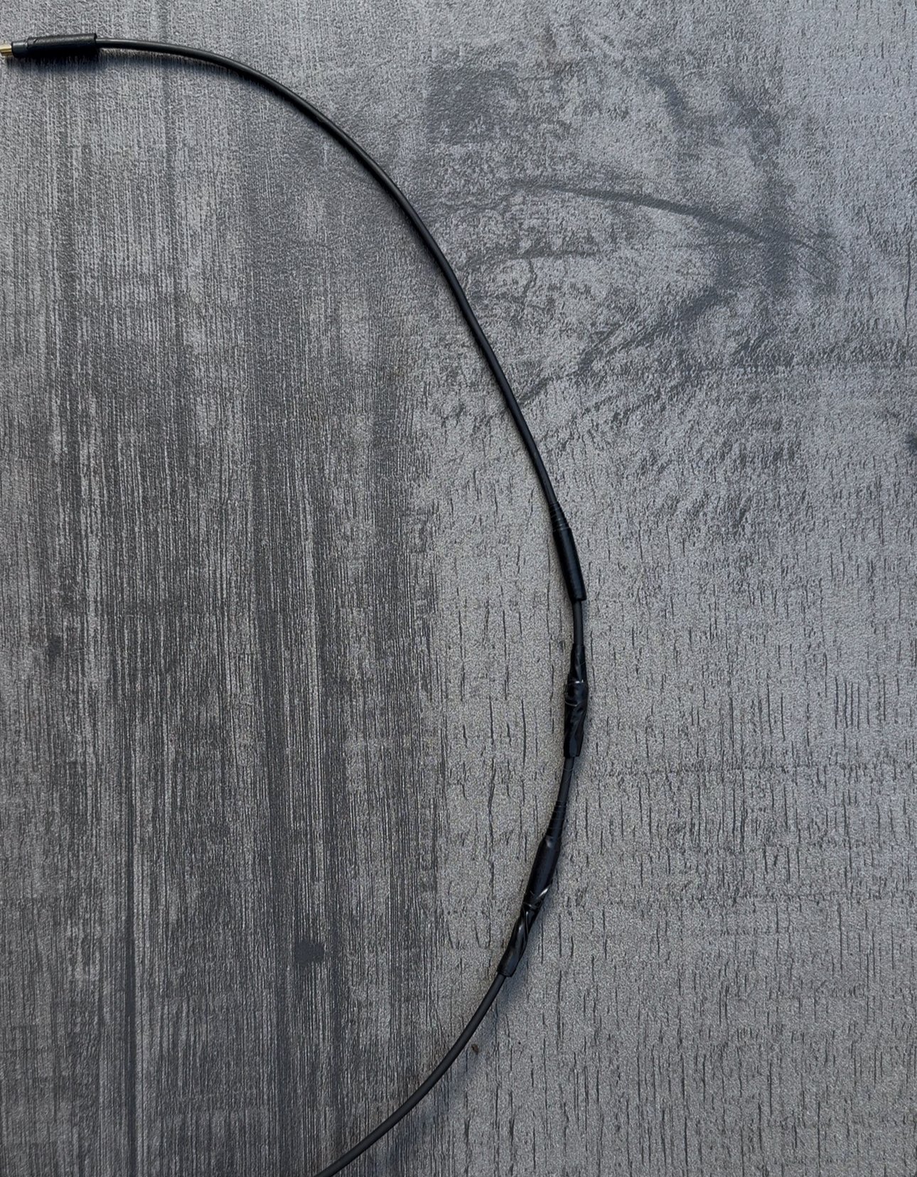

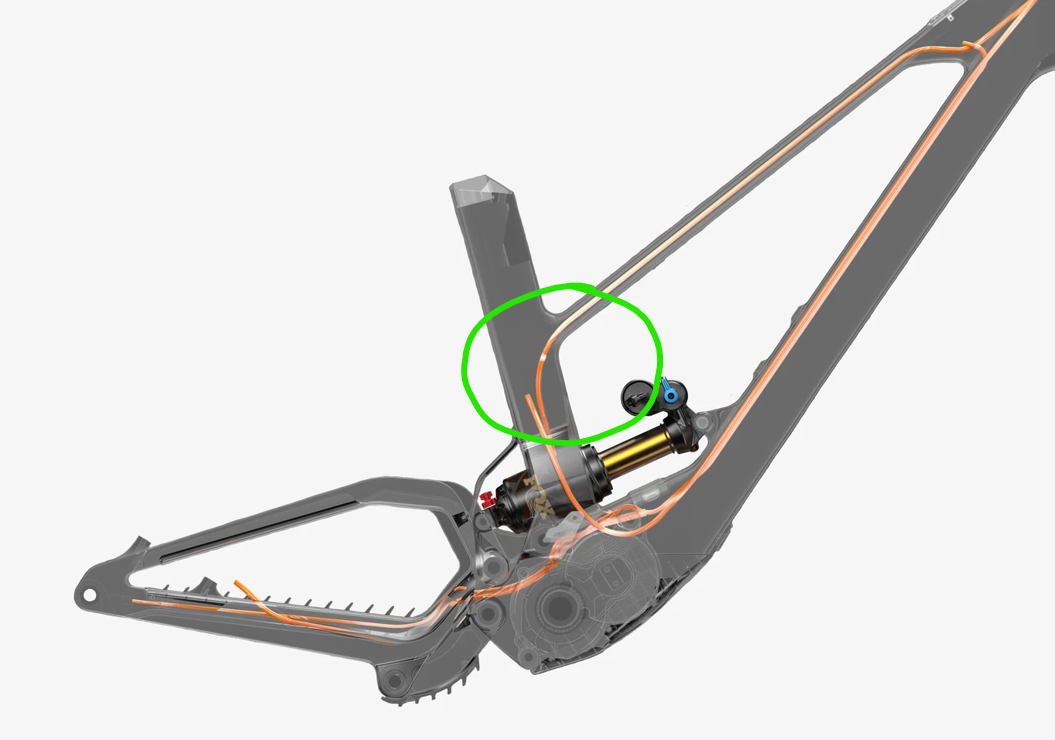

My rear brake cable is rattling a bit. I think it is coming from the seatpost area.
I am thinking of adding some foam tubing to the brake line.
I think you have to lower the rear end of the motor, for reaching the brake line in that area.
Can you confirm this Rob?
You won’t be able to add foam tubing to the brake line as the tube that it runs in is already too narrow.
I wrapped my brake line in some electrical tape at intervals along the line, to minimise any free space in the cable tubing.
I also did this for the cable that runs from the motor to the display, and the cables that run in chainstay.
Yes you will need to drop the motor to access that brake cable run.
Taking the motor out is easy. Getting it back is very tight due to the packed cables and the orientation of them.

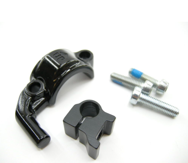

There is this Formula Mixmaster clamp, so you can save yourself the clamp for the dropper post! Screenshot 2025-09-08 142651.png
