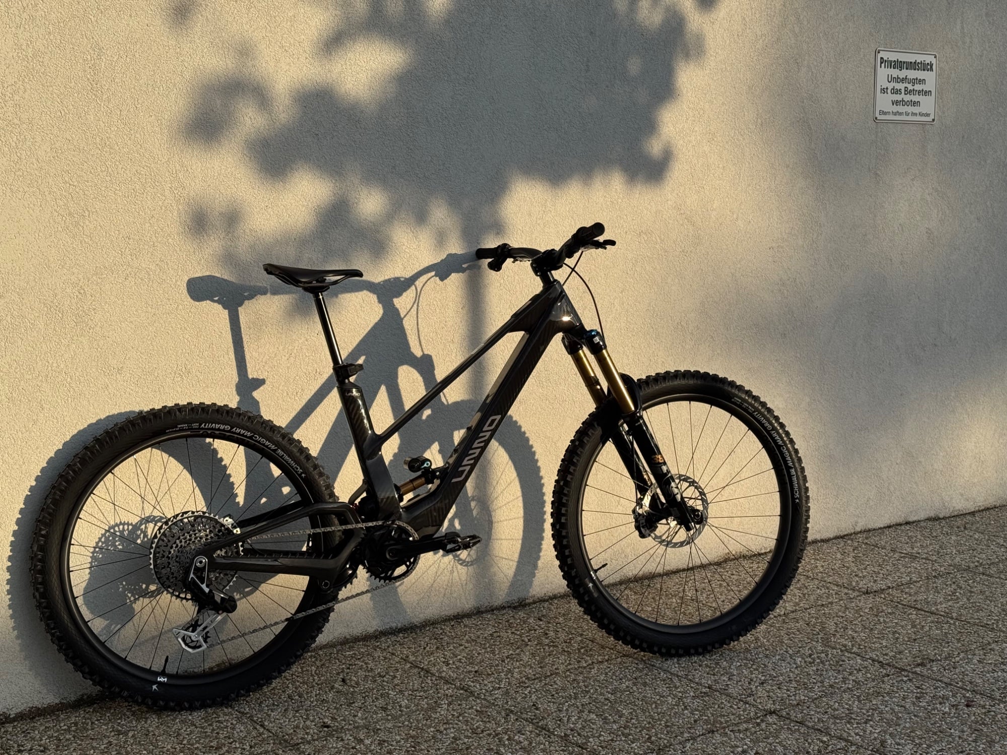

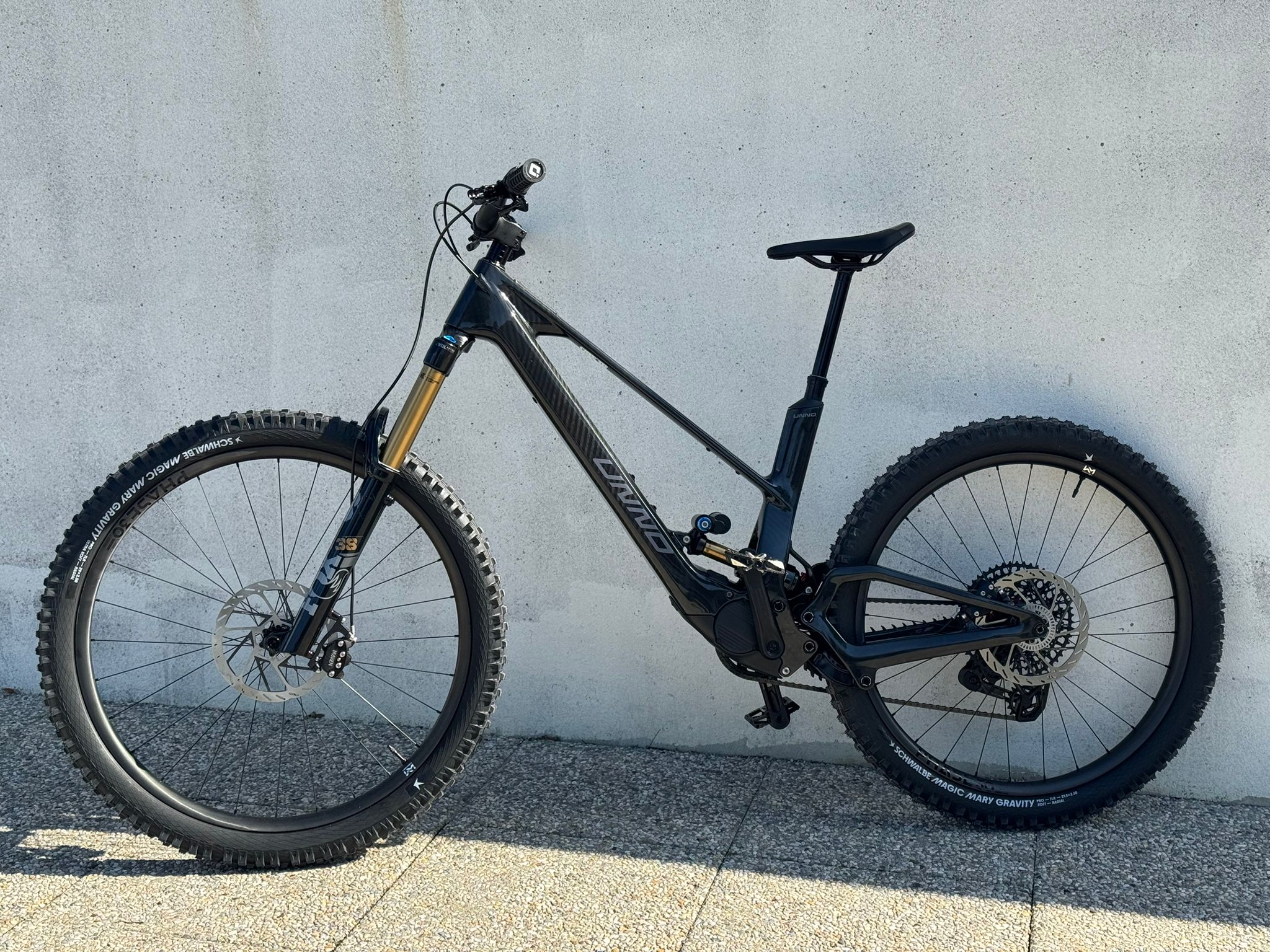

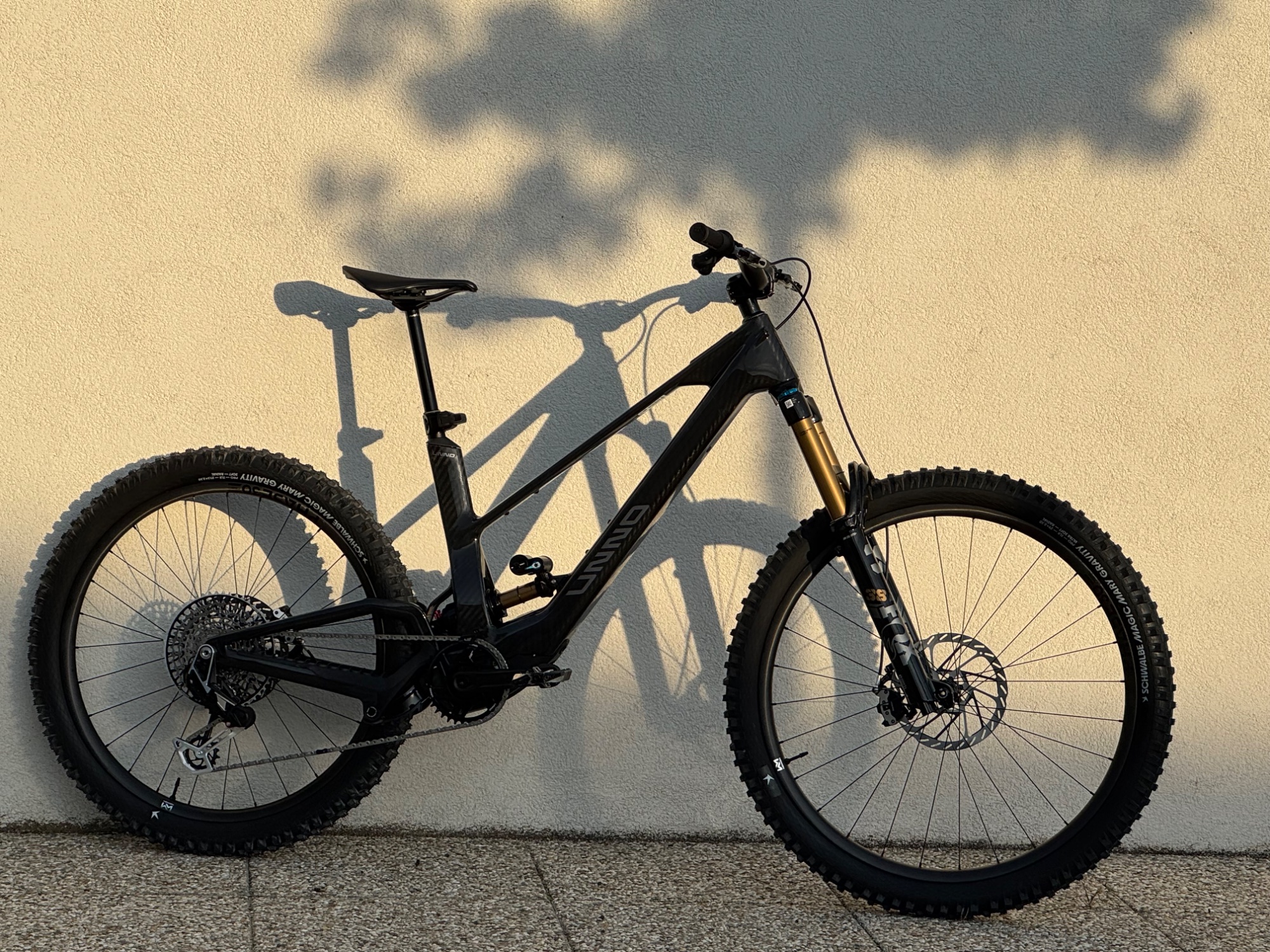

Bike setup with exact shock tune as Unno spec and also 170mm fork. Running e13 sidekick hub.
Suspension tune is great. Nice and supple over roots and chunk. Sidekick hub helping here too.
Noise is so much quieter than the Crestline with the earlier gen motor. Almost a non issue. Not silent but much much quieter.
Need to play around with suspension setup a bit more to balance the bike out but first proper ride been great.

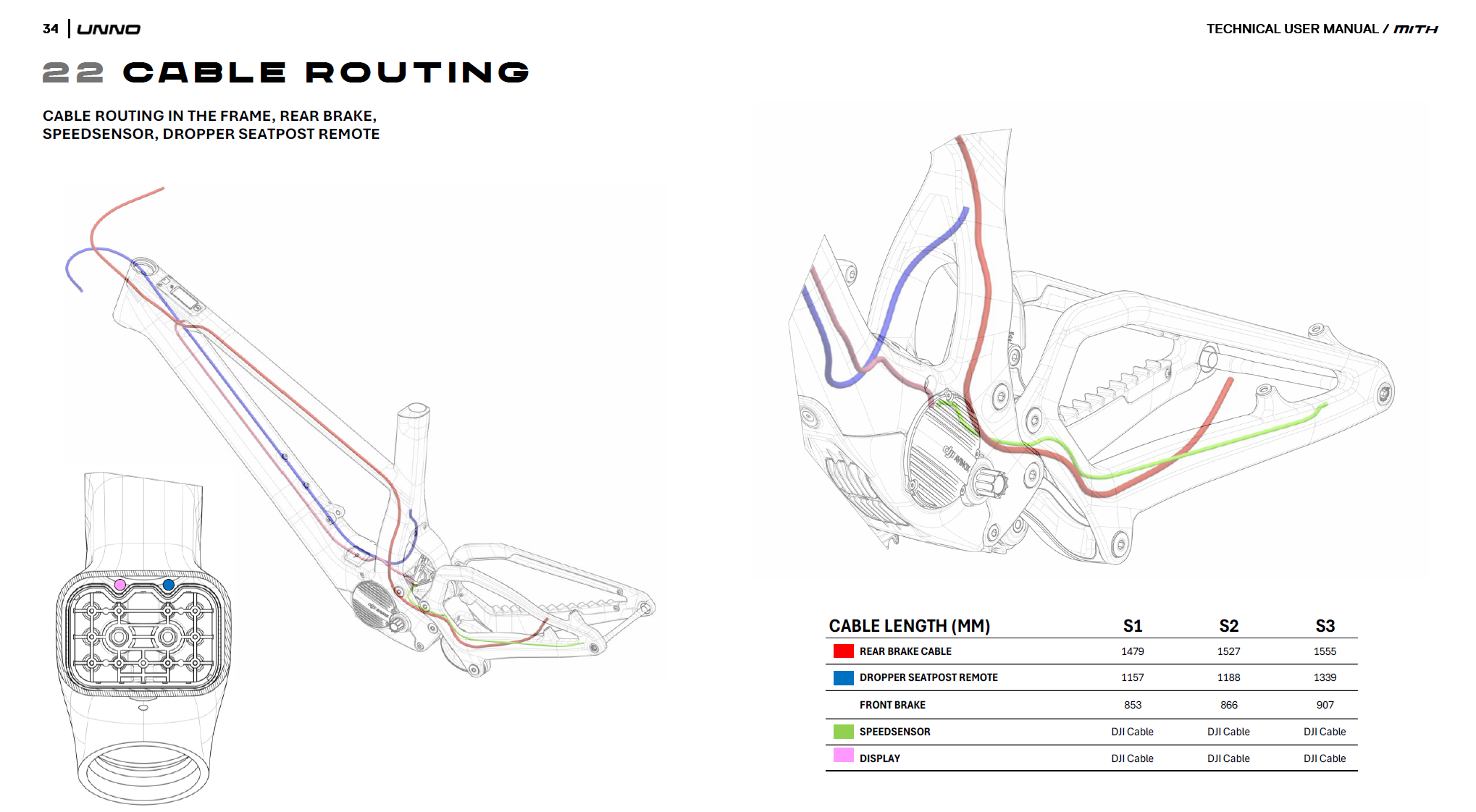

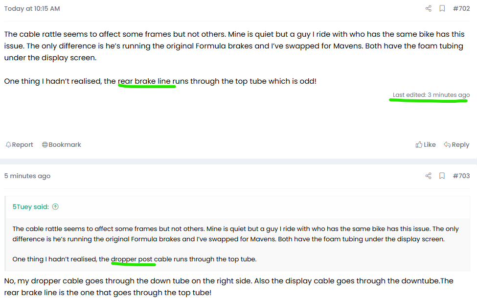

The cable rattle seems to affect some frames but not others. Mine is quiet but a guy I ride with who has the same bike has this issue. The only difference is he’s running the original Formula brakes and I’ve swapped for Mavens. Both have the foam tubing under the display screen.
One thing I hadn’t realised, the rear brake line runs through the top tube which is odd!
One thing I hadn’t realised, the dropper post cable runs through the top tube.
No, my dropper cable goes through the down tube on the right side. Also the display cable goes through the downtube.The rear brake line is the one that goes through the top tube!
It is also written the same way in the manual

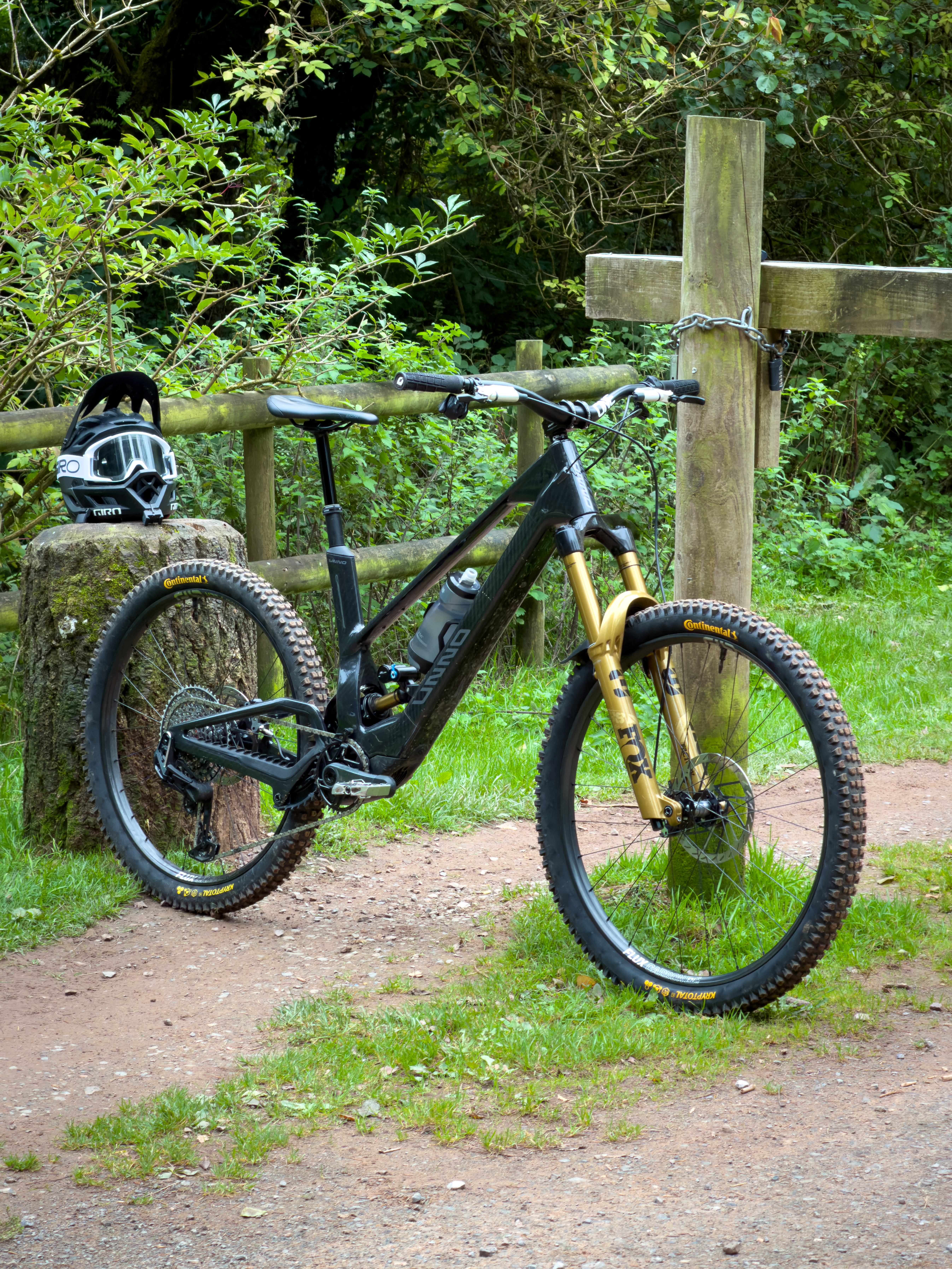

Ive been fortunate enough to borrow one for an extended period of time, which I have been riding alongside a similar travel Bosch Gen5 bike (With not massively dissimilar geometry, apart from the stack height). In total I’ve done about 500km on it and ~60,000m of descending.
Im the same height as you, and I would say, the S3 is a little on the big side, but the S2 would be too small. On paper, the geometry looked ‘ok’ to me, the only thing I was hesitant about was the big reach and high stack - which is a bit of an outlier, when stack increases, reach can get pulled back due to a similar span, but an 820 measurement is massive for an L frame size, it’s bigger than a significant number of XL’s. When you factor in the wheelbase, the extra weight of it being an ebike, it really is a big bike, full stop.
Unsurprisingly, it feels big on the trail - my riding is mostly S.Wales off piste, so, long fire road climbs, and steep, natural, techy downhills. I think after the amount of riding I’ve had on it, I can safely say that is not its strong point, it’s quite simply too big for a lot of the trails I ride, and that’s before I get into some of the suspension quirkiness. Where it did feel better was high speed, open stuff, and I would say it was one of the better bikes I’ve ridden at that, if you persevere with setup.
Probably the next point. I’ve ridden it with the stock Fox suspension, a Zeb Ult/Vivid Air & a Push SV8/9.1. I can safely say I have never ridden a bike where I have struggled to find a balance in the suspension as much as this one. I commented on this before, but it continued to be a challenge to set up. I’m not a wobbler on a bike, I race a reasonable amount still, and a quick check on the last 20 races I’ve done, I’ve podiumed 50% of them & won 20%, so I feel confident in settling a bike up to feel comfortable on it, but this one….. I think it came down to the very light tune on the shock needed, combined with a higher amount of sag & making that work with a fork that didn’t feel like crap, was not easy - the window of balance is really small on this bike.
Other things of note. A like for like comparison with the updated Gen5 Bosch, they are pretty similar in normal turbo now, the mega boost on the DJI was fun, for a while, but it absolutely slaughters the battery. Both in Turbo for me at 85kg with the same wheels & tyres are done with 1500M of elevation. The integration of the DJI looks better, of Bosch could make the CX motor in the SX sized body, it would be a draw, but it does stick out on the NDS a bit & doesn’t look as good. Obviously the DJI has a whole lot more customisation available, but once it got it set up so they were similar in power delivery, I never bothered with it.
Rattling. Cable rattle is real, I think it’s a combination of the brake hose & head unit wiring, but it’s annoying & I couldn’t complete.y silence it. Motor rattle is also very real. It’s kind of on a par with my old Gen4 CX motor - you get used to it, but it’s there and annoying. When I jumped back on my own bike (either a Gen5 Bosch or TQ HPR60) it’s only then you appreciate how utterly silent they are when descending.
Bottom out buzz. Seen a few reports of this & also experienced it - it’s actually quite significant & concerning, if you recreate it with a shock you can bottom out hard in a non riding test, it’s not just a little bit of buzz, the mudguard is getting crushed between the tyre and the back of the shock body, that to me is a bit of an issue, if it bottomed out real hard & caused slowdown at the wrong moment (or even worse, locked the rear wheel) it could pitch you forward, and that would get real ugly, real fast.
The rear linkage, when I saw it originally, I ad some concerns about surviving a UK winter, and I never really got to find out, apart from early September where we got a two week window of constant rain. It wasn’t a positive experience, I got some fairly significant clogging, and as the suspension cycled, it didn’t help. That would be a real concern for me.
