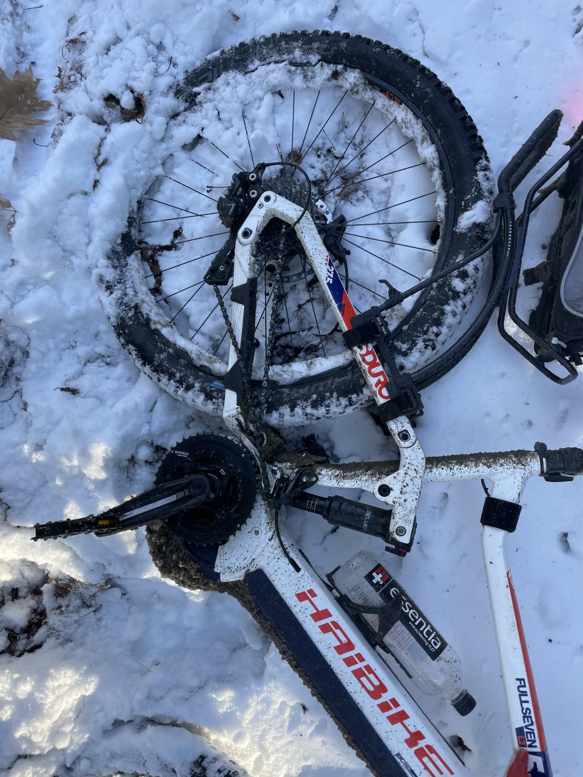

How are you guys making out with the 36T on the Levos? I am about to change mine, but I noticed that the clearance between the 36 ring and the chainstay will be very small, and if I ever get chain suck it will be a damaging jam up. The 32 ring allows the chain to pass between it and the chainstay without damage.
it can be wrenched through the gap , however it wrecks the paint.
Better than your legs spinning like crazy in top gear though.
Thanks. I’ve never had chain suck on this bike, eventually it happens on all of my bikes in the worst possible place. . . Maybe time to make a little lower block between the chainstay and the sprocket to ensure it can never happen. Here is a beauty of a time for it. We carry links and tools on our rides but having to work with gloves off is priceless.
