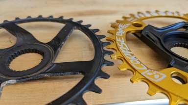

    Bosch SX 30T chainring direct mount
    Hello, Looking for a 30T chainring (yes a small one) for my bosch sx motor. At the moment I have a "SRAM XX Eagle T-TYPE 1x12 Chainring for Bosch Gen4 | Direct Mount - black / silver 34T" chainring. But I like something smaller. I like to climb steep sections, and also sometimes with the...

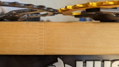

    notice washer in back of sprocket
    Difference in Hight is maybe 10 or 15 thousandth not enough to really thing about that's why I put the washers behind the chainring that pushed it out enough to notice

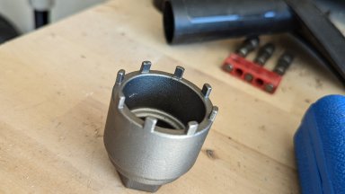

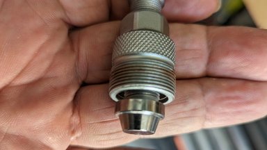

    tool to remove chainring nut. Nut is plastic
    tool to remove cranks the bike is a 2022 Trek Rail 9.7 Bosch CX
