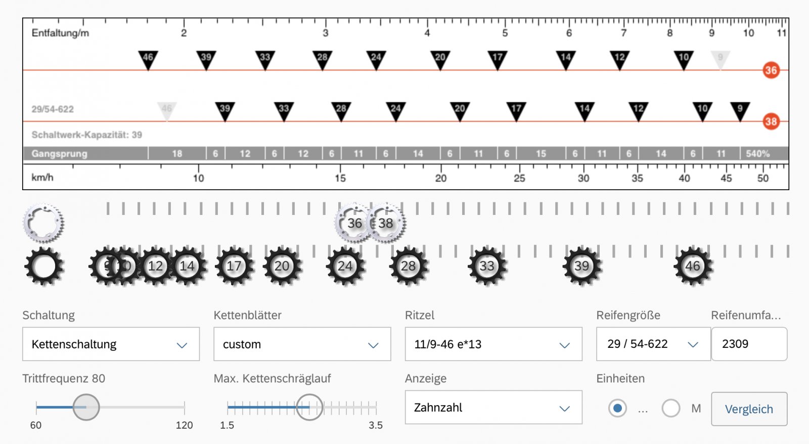

2 less teeth at the rear results in more speed than 2 more teeth at the front. At 80rpm its 44km/h to 39km/h. means, changing the cassette has more speed effect, but is more expensive.
@Mike Smith 10-36 is faster than 11-38.

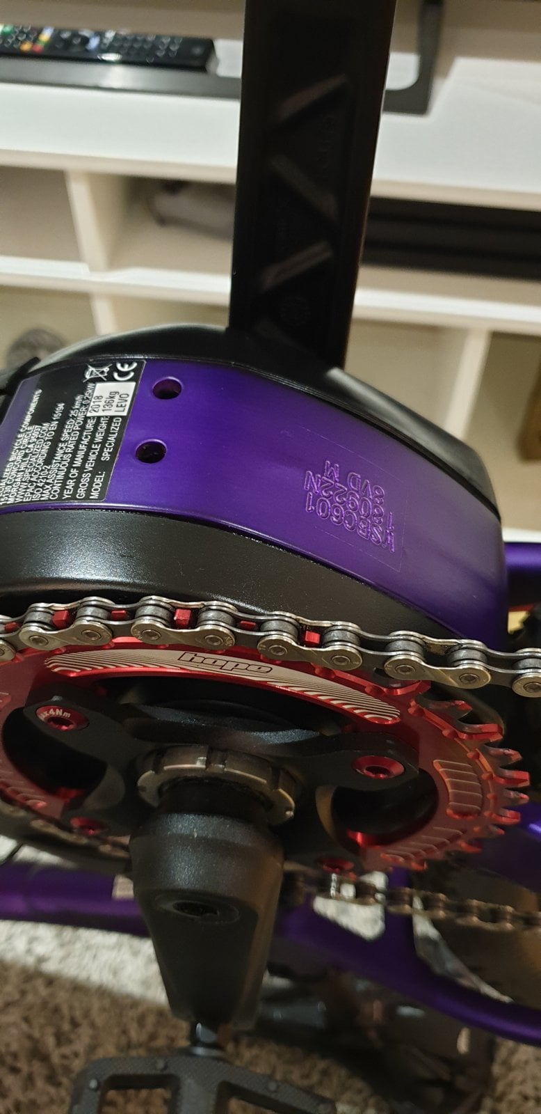

Fitted a Blackspire Snaggletooth 36t chainring today, no need to remove the crank and spider, only the drive side pedal. A bit of a fiddle fitting the bolts, a found rolled up bit of sticky tape helps to hold the ‘nut’ in position underneath the crank spider when putting in the bolts. I’ll update later after a few rides.View attachment 1894
Hey Andy, I bought the same chain ring. I was wondering how the wear on the aluminium is working out for you. I have done about 300 kliks so far and have really just taken the color off the teeth.
I think it’s easier just to remove crank, one bolt? No hassle fitting a new bolts, no tape.
