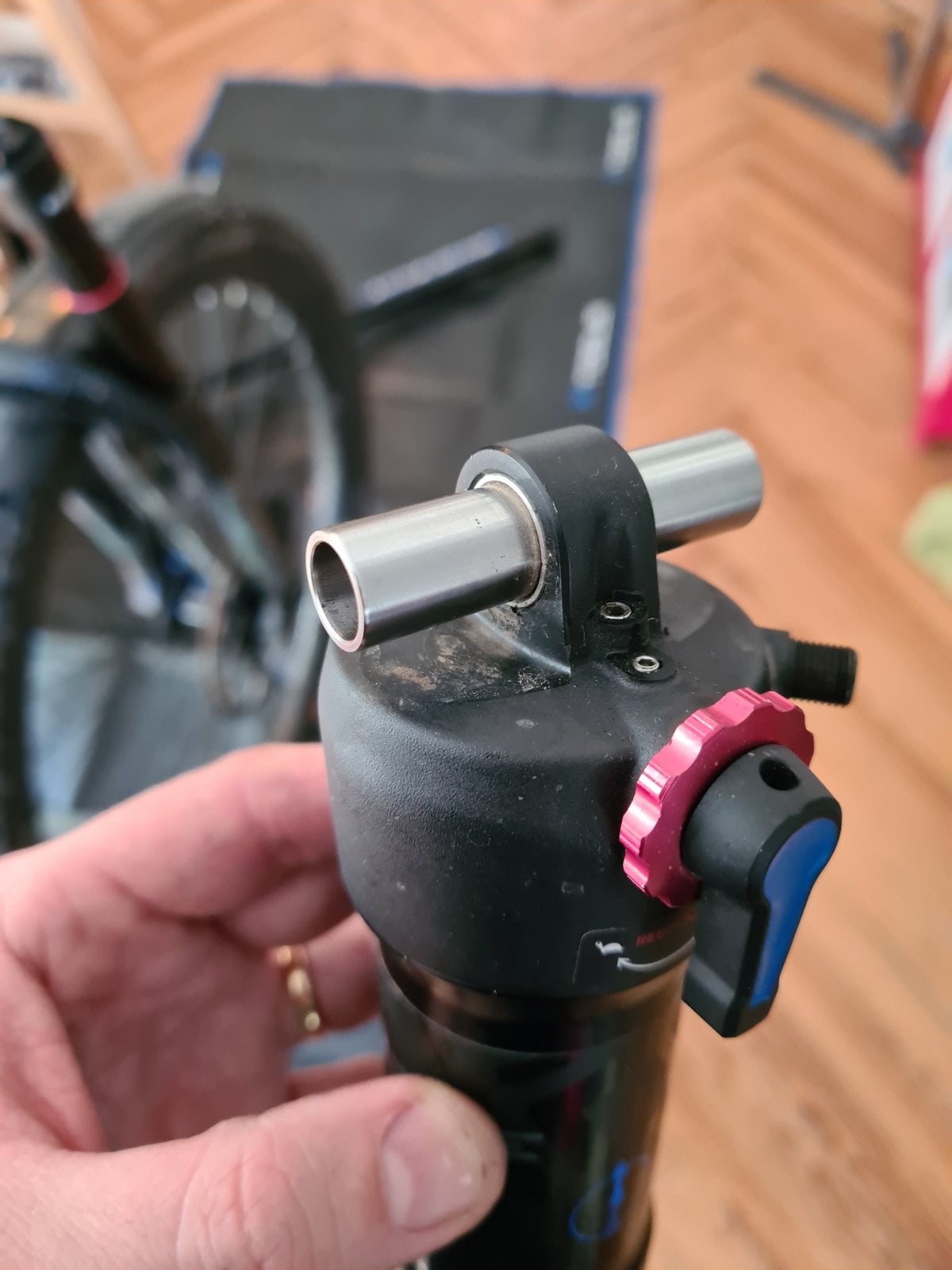

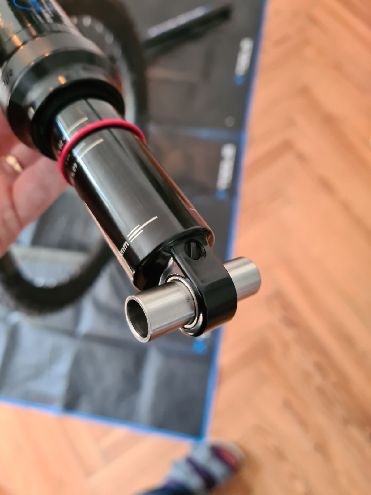

First of all: In 62,5mm Marzocchi Bomber CR seems to fit (XL Rail 5 2020). I was just able to hold it side by side the stock shock - couldn't fit it unfortunately since it came with just one DU bushing installed.
And I'm a little bit confused about the stock shock mounting.
I removed the screws to get the shock out but these silver "axles" remain inside the top and bottom mounts of the shock - I think these are standard bushings between "axle" and shock mount but they won't rotate or move.
I think I have to reuse these since I couldn't find any Fox mounting kit with 54mm (total width for top mount).
A completely new Bomber CR obviously comes with those new Fox plastic bushings, so I thought to remove the single Du-bush and fit both top and bottom mount with these new bushings. There are complete mounting kits from Fox though but I neither know if I need this nor am I able to find it with correct size.
What am I missing here?
You either need to completely remove and reuse the hardware, including eyelet bushings, from the stock RockShox shock or purchase new kits from FOX for the Bomber CR. If you’re looking to source the FOX kits, the following parts numbers might be useful:
