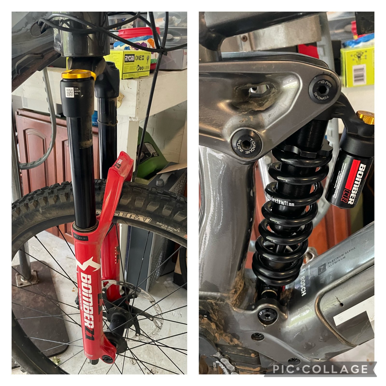

Marzocchi Bomber CR & Z1 Coil. There’s been some talk about whether the Bomber CR coil fits the Rail
I just made the conversion & got the Z1 Coil as well….it fits & there are no issues w/ it hitting the DT at full compression on a Size XL…it’s really close but doesn’t hit. I’m 220lbs and did a full WWE jumping from the ropes move on it w/o the coil installed and it didn’t hit
4 rides on it in the real world so far and no issues w/ it hitting the DT
Huge upgrade to how the bike (2022 Rail 7) feels on & handles the terrain compared to the RS Deluxe Select + and Domain.
So pumped to be riding like it’s 1997!

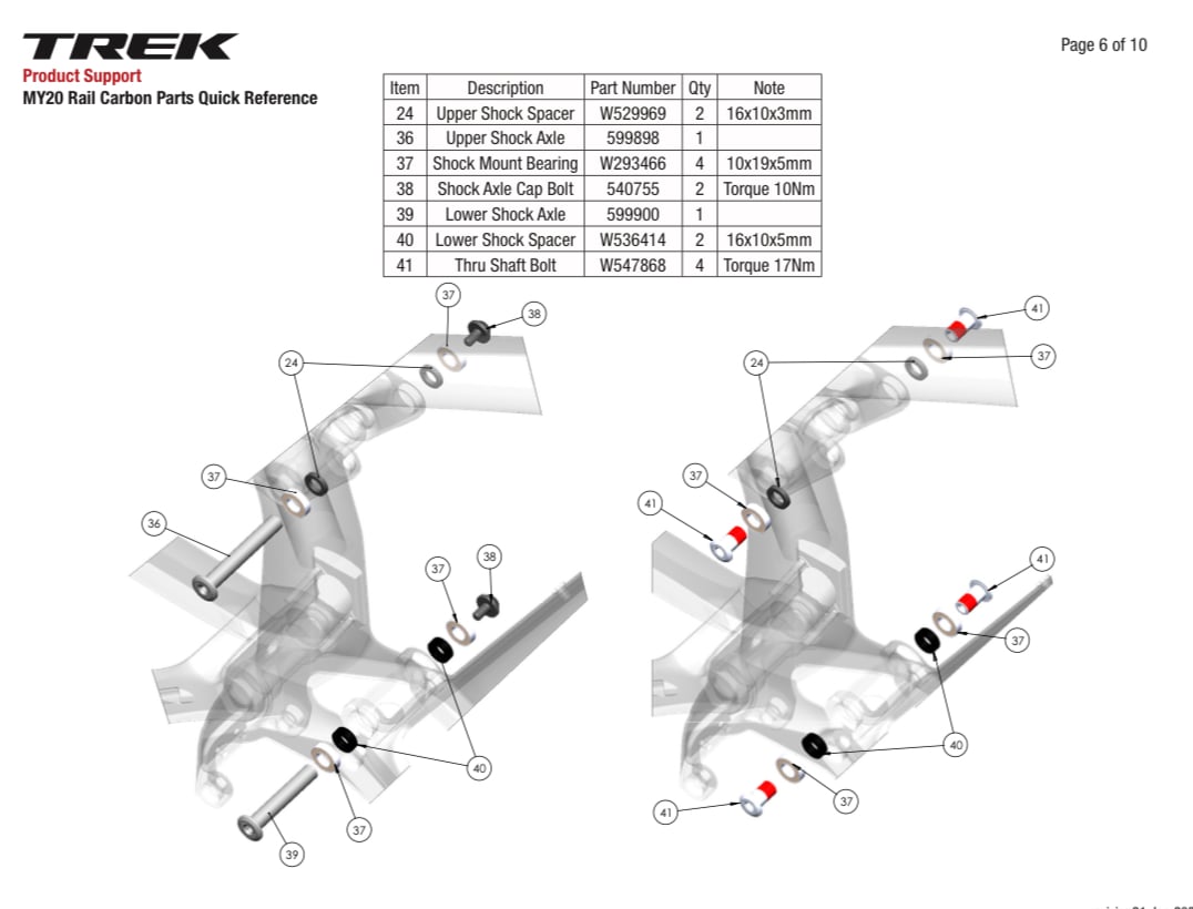

Yes...these are the FOX part numbers for the traditional eyelet type shock mounts that fit the Rail.
If your Rail originally came with the trunnion type shock, you’ll also need these items from Trek:
• upper axle - 599898
• lower axle - 599900
Does anyone know where I can get no. 24 from w529969 without paying £11.99 for one? Like WTF?
