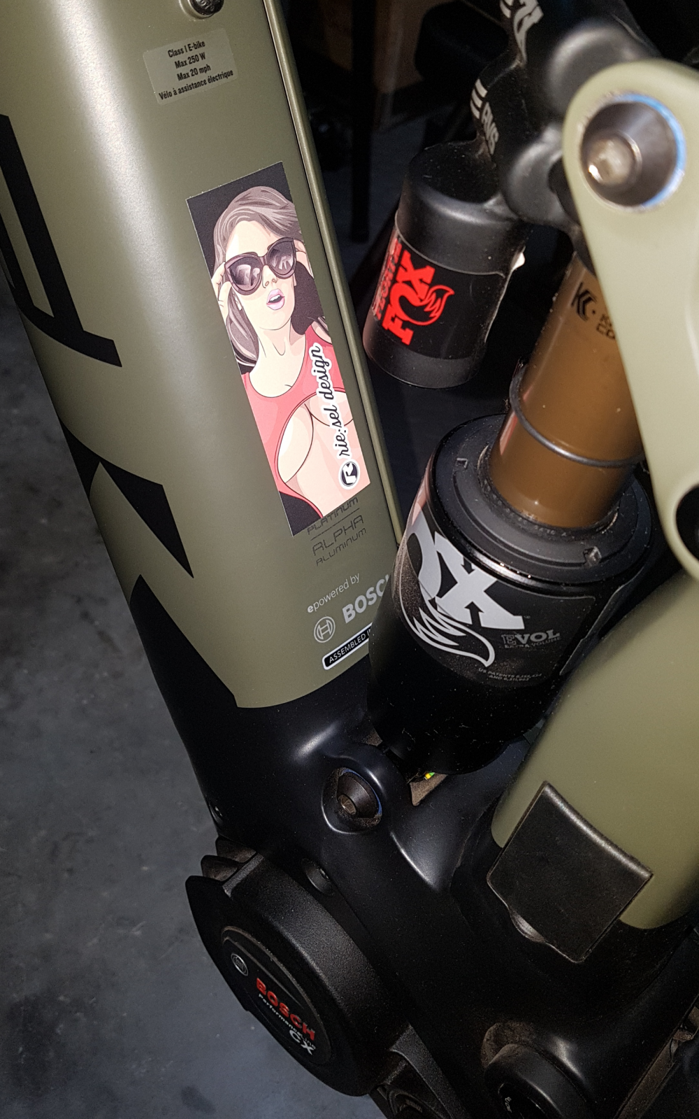

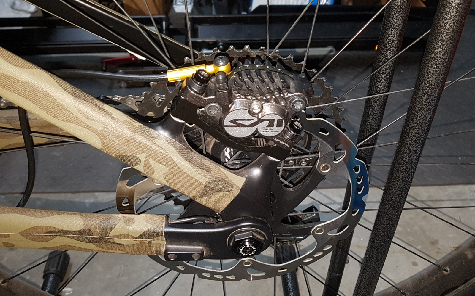

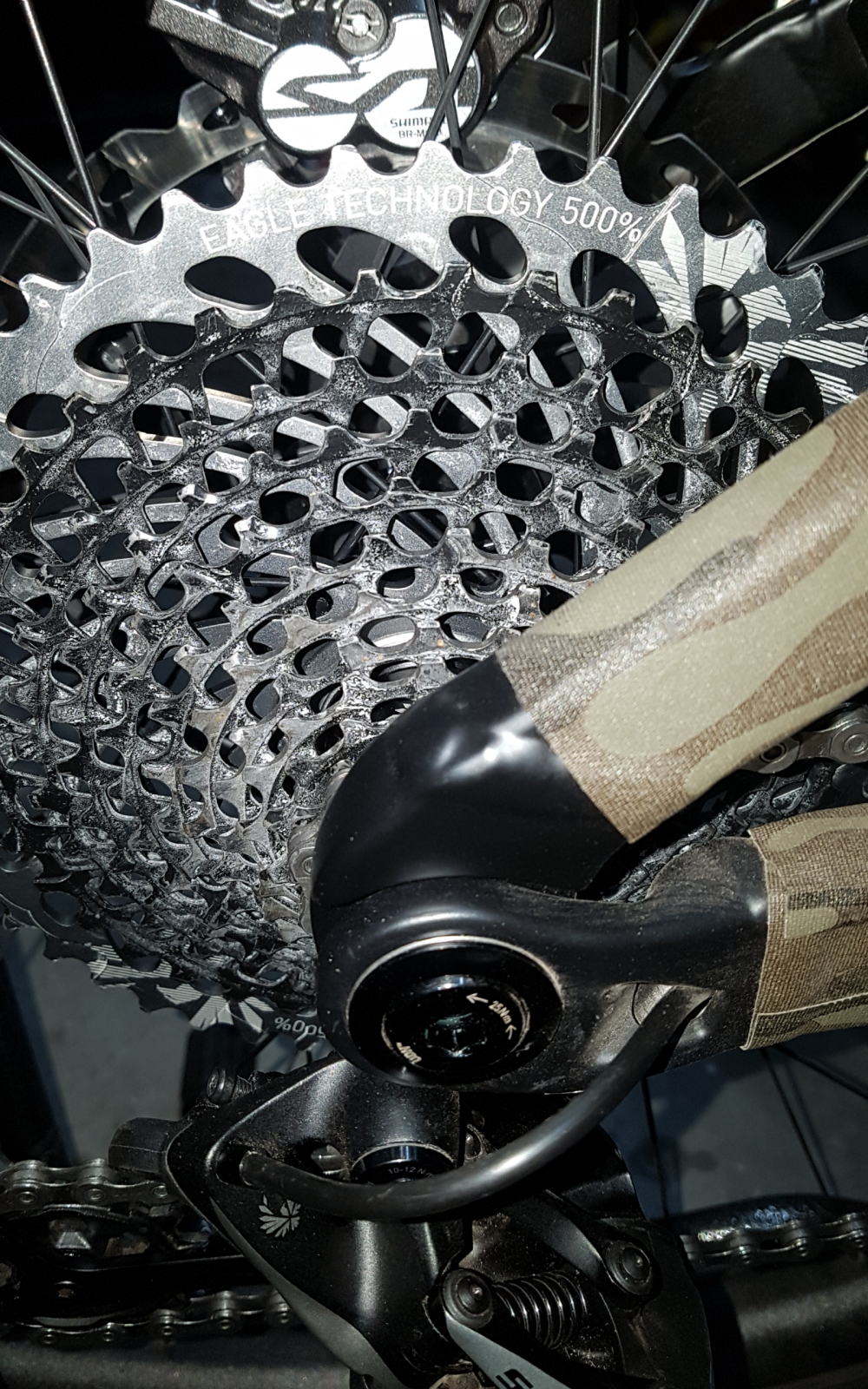

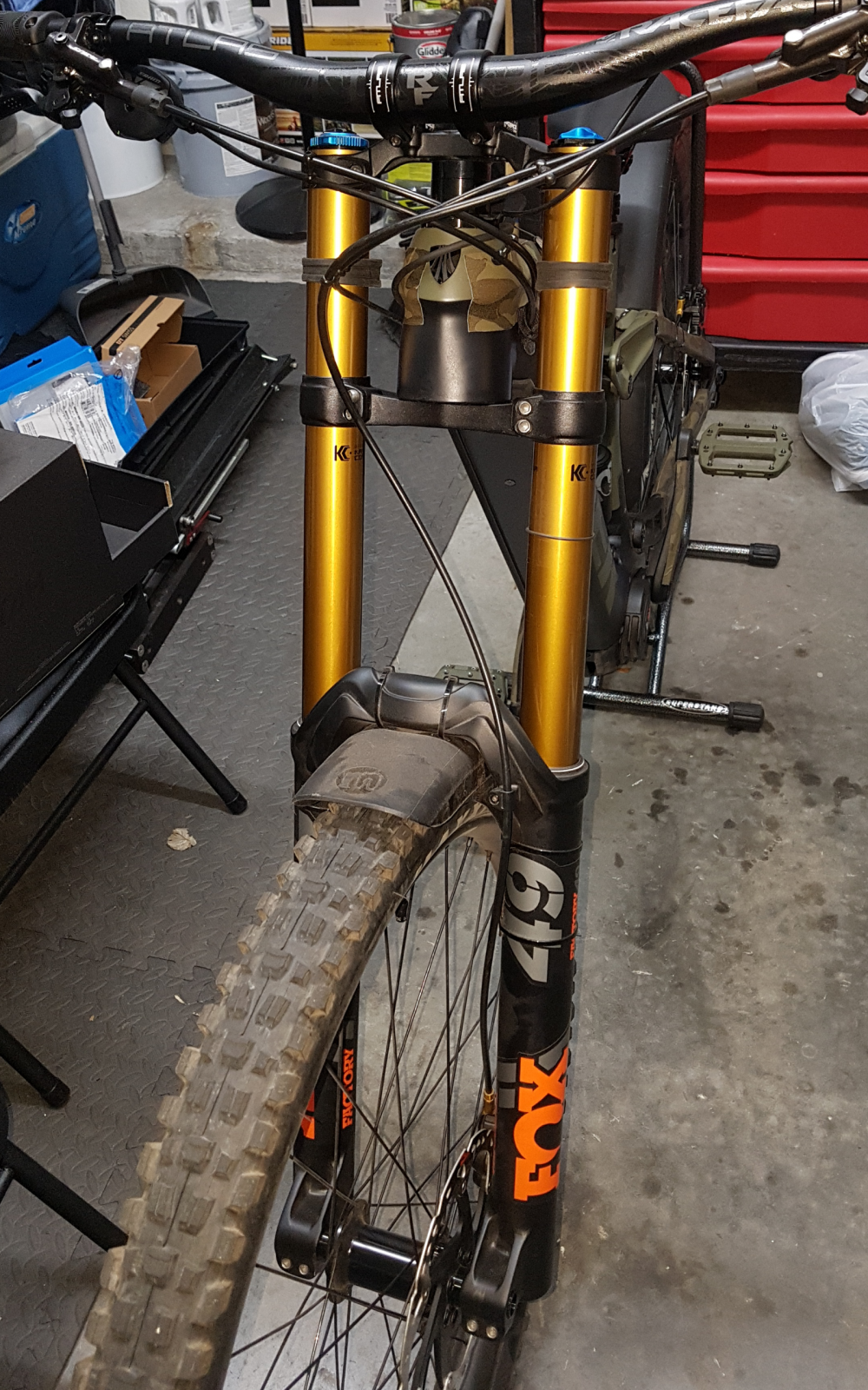

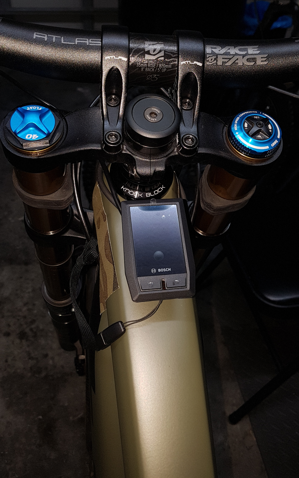

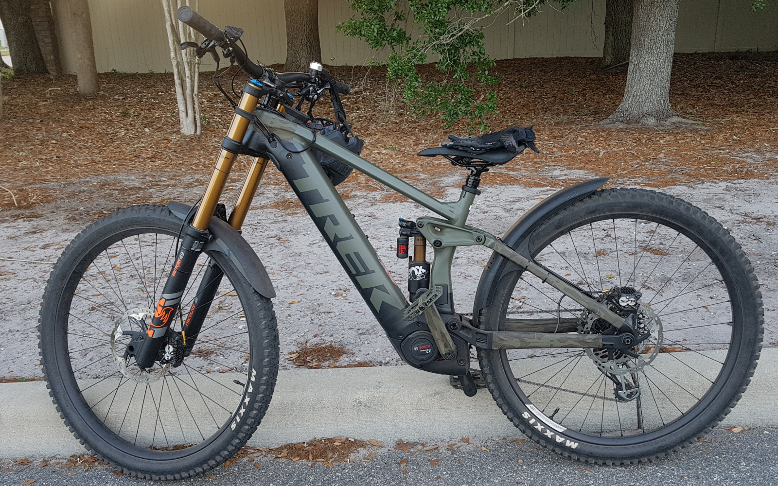

saint brakes, sram x01 drivetrain, ibis wheelset, kiox, fox suspension - cannibalized from my other bikes, except for the kiox

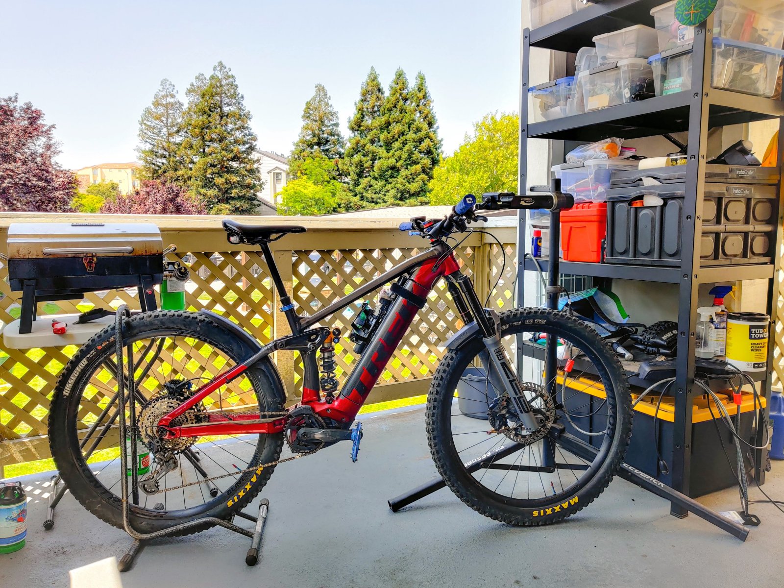

Finally showed some love to the bike and decided to post since I have found a lot of help on this forum.
My Rail 7 Medium is almost 12 months old and has almost 3000 miles on it. I love how the bike feels right now.
I'm really skeptical about upgrades, but these are my options for my northern California terrain and my ~160 pounds weight:
Right out of the box (or almost)
Mino link set to the high position​
Maxxis tires with cush core (Assegai on front and Dissector or DHRII on the back, both 2.6 ~20PSI)
OneUp dropper post 180mm​
Ergon saddle​
Shimano H03C brake pads​
Six months old upgrades:
Zeb ultimate 160mm (I'm not a sensitive person, but the bike felt way better after this)​
40mm stem and 35mm 770mm handlebar​
Recent upgrades:
220mm rotors (Magura) with North Shore Billet adaptors: more control​
Ohlins TX22m 230x60 (~156mm travel) with Sprindex coil (390-430 pounds) set to 430: way more traction, couple of bottoms out​

What about that Ohlins coil,much better than stock one?

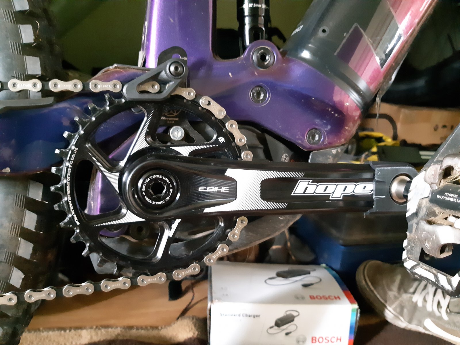

Thanks for that, I just checked that area after today’s ride and it’s surprisingly blemish free!
Wish I could say the same for most of the shoddy Project paint work….
Probably worth doing before it does get torn up a bit, mine is invisiframed, which has actually saved a bit of damage, I had a chain snap and the roll on of the motor made the chain wrap around the chain ring, which caused a bit of damage to the invisiframe kit only.

Hello, I used my new ohlins today, yes I'd say it's quite a bit smoother and not a noticable amount of bob (and i left it open all ride), compared to the stock shock, which I had no problems with at all and I thought it was great, but I wanted a coil. I also have it with 60mm stroke, giving a little more travel. Smash pot next I think
