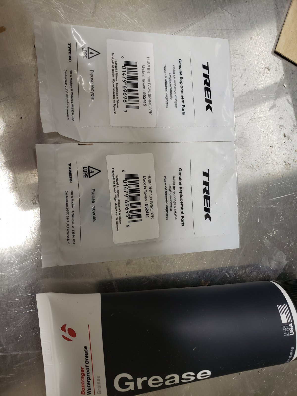

108 tooth free hub upgrade kit. Goes in this week.

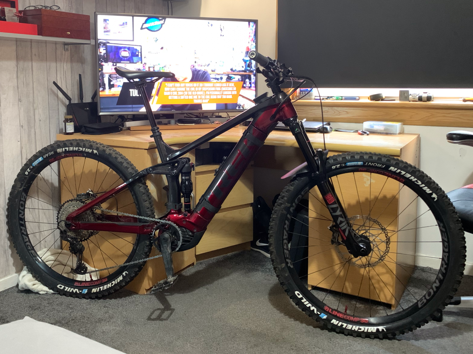

Rail 7 Upgrades so far
Kiox Controller.
Lyrik internals.
170mm air shaft.
Michelin EWilds 2.6.
Rapid drive 108 conversion.
Hope Tech 3 v4/e4 brakes with 220/203 rotors.
Fox Transfer 175 seat post with OneUp leaver.
Ergon saddle and Grips.
OneUp 35mm stem and 35mm rise OneUp carbon bars.
OneUp EDC tools in the stem (2021 version)
Invisiframe.
RRP mudguards.
Custom decals on Fork and wheels.
Some of the most important mods I’ve done are tidying up the cables, stopping them rattling and weather proofing the battery housing and the rear pivot area

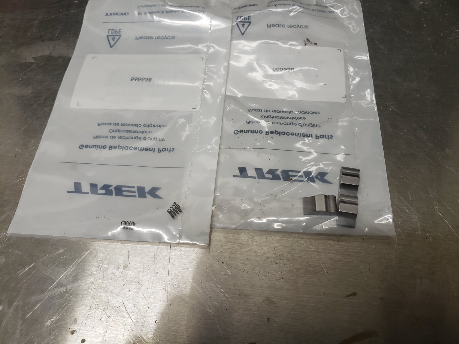

...so instead of 3 pawls, you now have 6, so there is noticeably less free movement before the hub engages
I notice the lag of engaement in the motor, not really in the rear hub. Is it that noticeable? Seems a cheap upgrade anyway.
It is very noticeable, I would say especially so on an eeb because of the slight lag at the motor. 3 pawls gives 54 points of engagement whereas 6 pawls you have 108. I think from memory this translates to just 3° of freeplay with the 6 pawl upgrade vs 6° with the standard 3 pawls. It doesn't sound like a lot but you'll definitely notice the difference

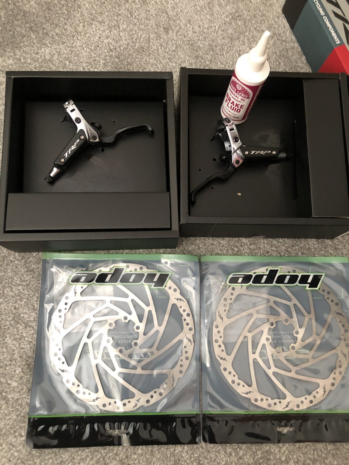

For those running larger than 200 stock brake rotors, Care to share info of where and what you bought?
I know I can now easily run a larger front since I put on the ZEB, but the rear already has a spacer/ adapter. I am thinking anything that helps braking is a good thing. ( stock rail 7 brakes currently)
Also maybe mention if you had issues with warp or fitment along the way.
Thanks.

I use Magura, 220mm front and 200mm rear.
I like the consistency on long (>1000m elevation) alpine downhills. They are a fit finicky to bleed and adjust.

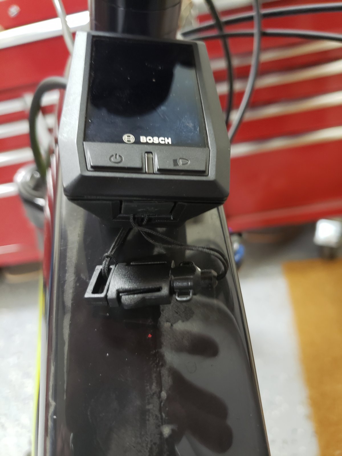

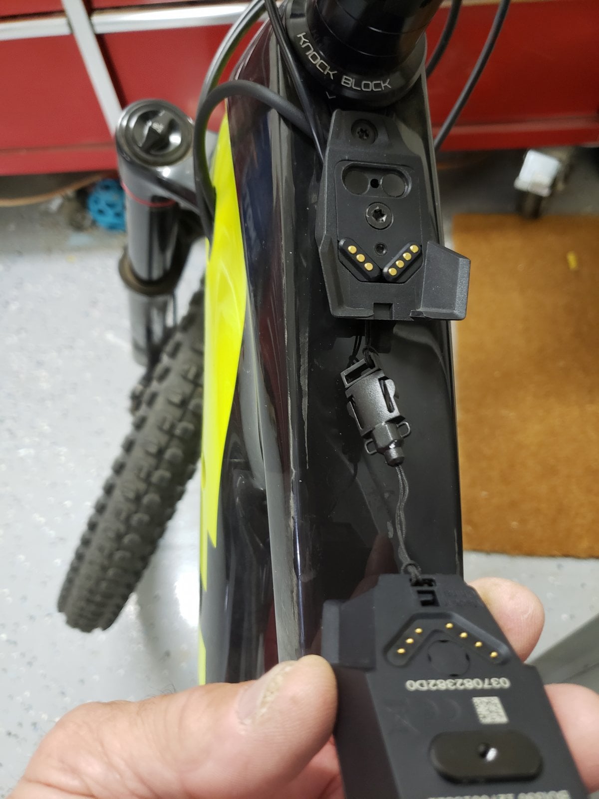

Put a leash on my Kiox. After a rough and rocky decent in the desert I got to the bottom and noticed the screen was blank. The Kiox was knocked sideways a little. Popped it back in and all was well. Must have hit it with my knee on one of the switchbacks. Would have been a big deal if had been gone. It could have popped out and bounced down over the cliff and been gone forever.
View attachment 62486View attachment 62487
Not sure if it works for you, but all you need is a little counter sunk screw to screw the kiosk to the base plate, I think it's M4 from memory, used in a lot of computers etc
Also installed the 108 tooth freehub upgrade. Super clicky now. Might notice the difference on a technical climb
That is a good idea. i may just screw that puppy on there. Then i don't need to worry a loosing it or having it stolen
