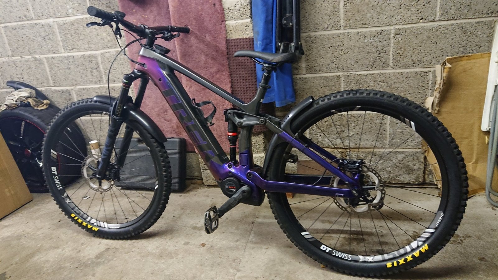

Latest updates, dt swiss hx1501's, maxxis dfr & dhf , xt rotors, and finally the kiox mount has arrived after 3 months
@Gazzaaitken (or anybody who has done it) How did you manage to attach the speed sensor magnet on the rear wheel's centerlock? I changed to DT Swiss wheel as well, but now struggling to find a way to attach the magnet as there are no screws now. Thank you!
I used a magnet I got on Amazon and some araldite epoxy glue. Give it a try

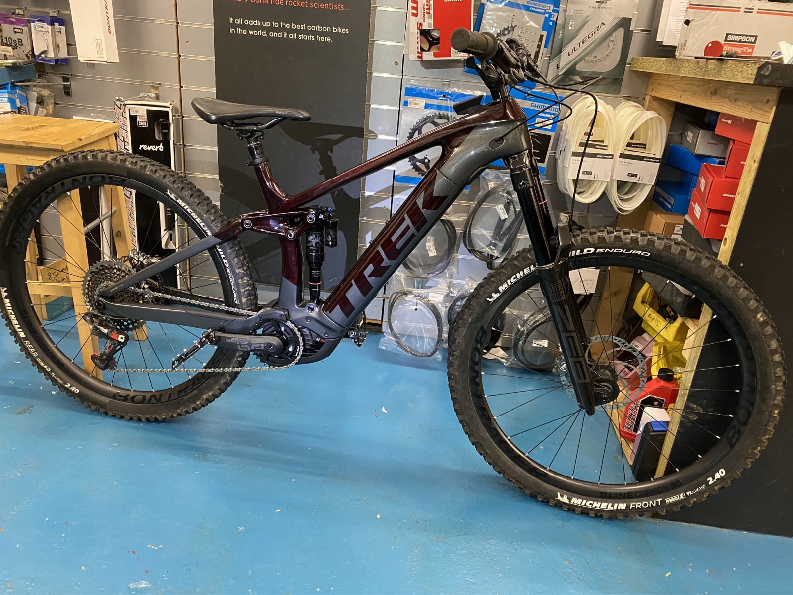

I bough a 2021 9.8. I have upgraded
Bontrager line pro 40 carbon wheels
Michelin enduro tyres running tubeless.
Magura MT7 pro brakes with 220mm floating router on the front with 200mm on the rear.
SRAM XO1 groupset (without cranks)
Magura brake/shifter single clamps
DMR death grip grips with red anodised clamps
DMR V12 Pedals
Out of all of these upgrades, the brakes have made the biggest difference .

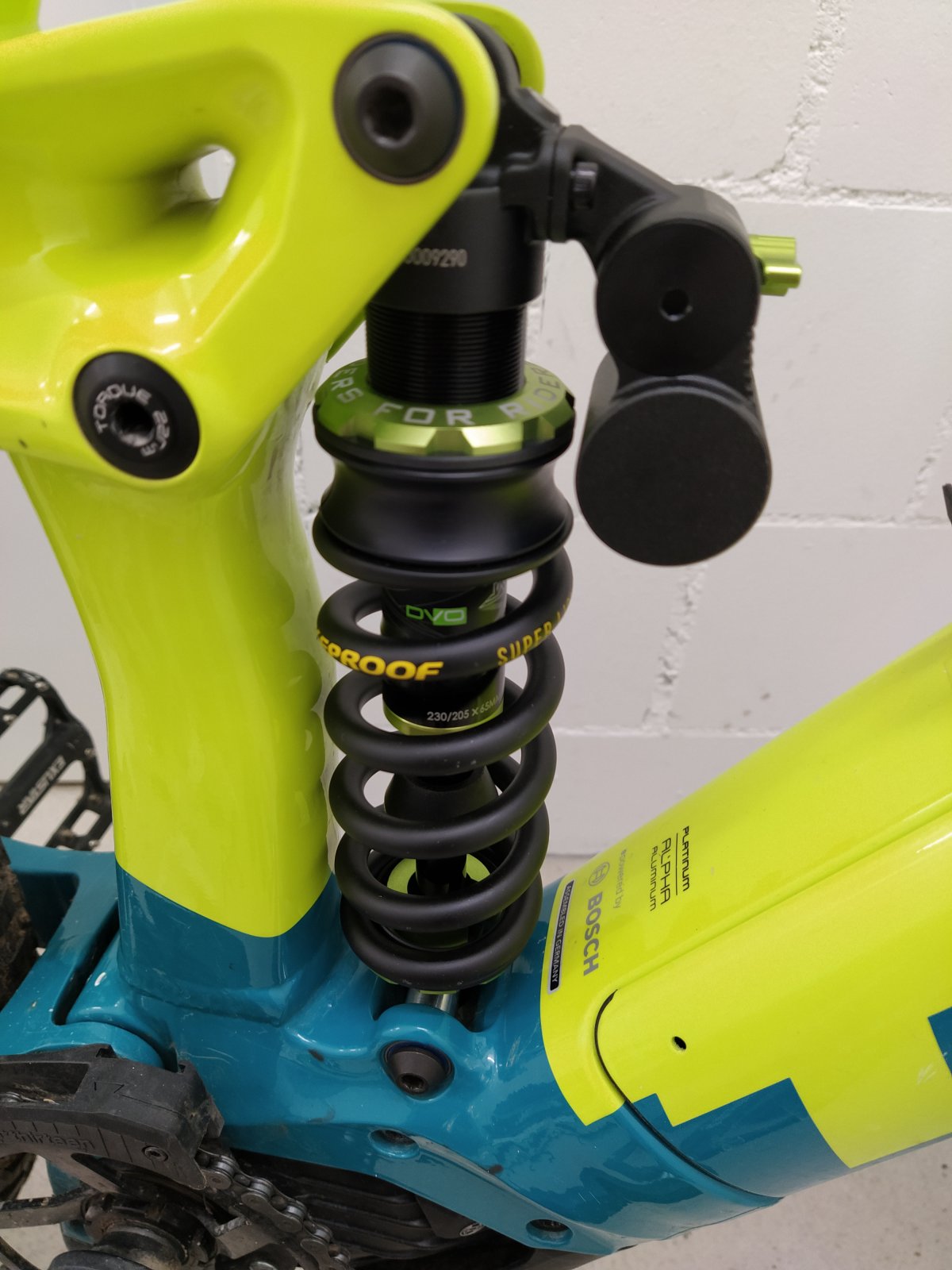

Today, i received the hardware for the shock (thx @Offset). So I just replaced the RS Deluxe with a DVO Jade X coil with a Nukeproof spring. Starting with a 600lbs spring. Couldn't try it yet, will do that tomorrow!
Why did you change the hardware? I used the stock hardware on mine.
