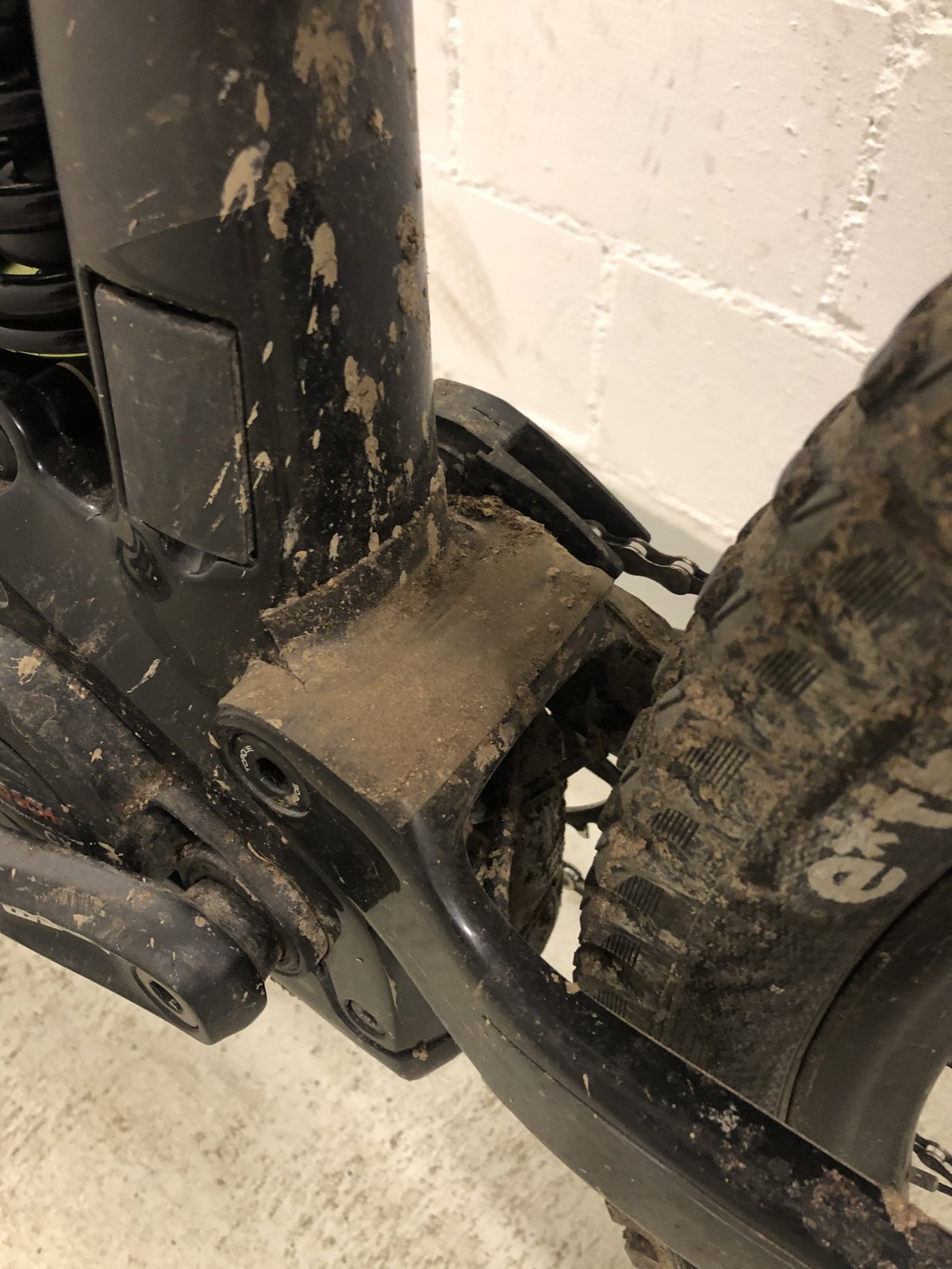

Anybody got an idea/hint of what to get as a rear fender for a 2021 Rail 9?
Front fender is an easy-ish one as due to the Zeb fork one simply get a ZEB Fender | AC-FEN-ZEB-A1 | RockShox
but... what fits (maybe with a bit of dremel) in the rear and saves your ass (from mud :) ) ?
Ugly as sin but effective...
Doing some more searching it indeed seems to come down to the 760 mudhugger, or a front RRP; either way, I guess I can always dremel it to make it a bit shorter and less ugly, next to of course unmounting it when the weather allows, tie wraps are cheap and plenty ;)
Thanks!
And ordered...:
We'll see how ugly she becomes with both a Zeb front and a huge mudhugger on the back.... and then to find some mud ;)

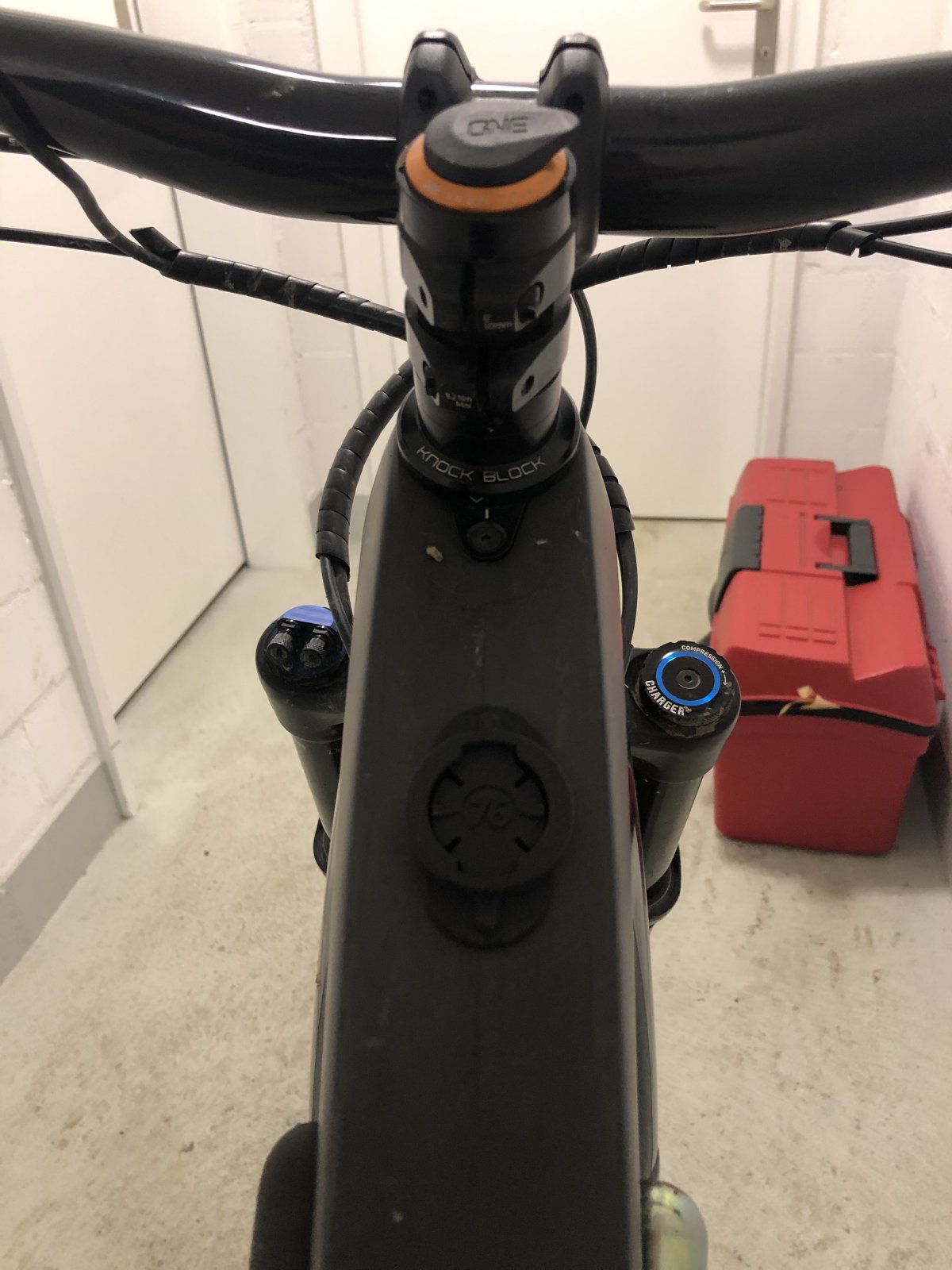

Garmin mount by Project 76, one-up edc in the stem and spare tube attached to the frame with a one-up strap. Slapper tape hack to prevent dirt and gravel to go where not intended

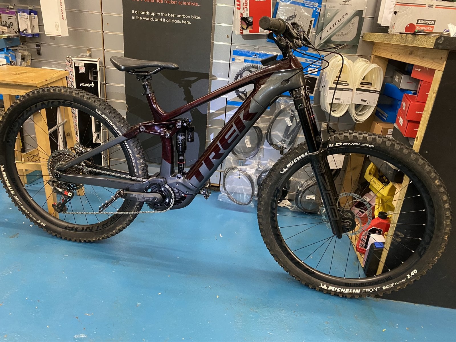

I bough a 2021 9.8. I have upgraded
Bontrager line pro 40 carbon wheels
Michelin enduro tyres running tubeless.
Magura MT7 pro brakes with 220mm floating router on the front with 200mm on the rear.
SRAM XO1 groupset (without cranks)
Magura brake/shifter single clamps
DMR death grip grips with red anodised clamps
DMR V12 Pedals
Out of all of these upgrades, the brakes have made the biggest difference .
2021 9.9 x0
Eagle AXS upgrade
Easton Monkeylite bars
XTR SPD pedals
Rocket Ron Tires
Stans latex (going to remove the bontrager juice in it now)
side bottle mount
FrameShield (on certain areas)
SRAM lock-on foam grips
Selle IT saddle (which one tbd)
more to follow no doubt...
