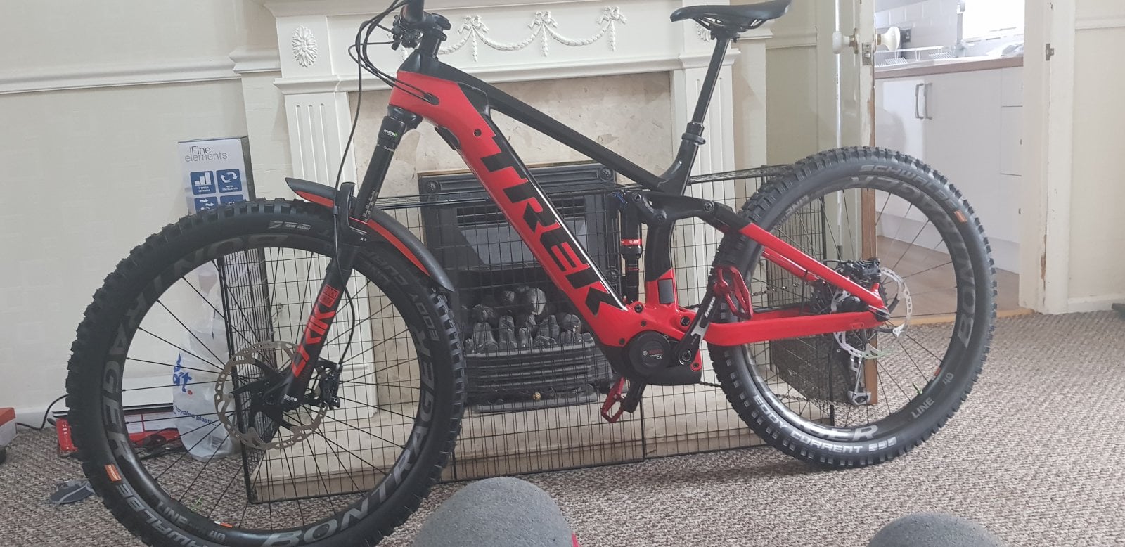

Dano78
Dec 3, 2019
160
34
Uk
Trek rail 9.8
Diety 800mm bars
Rockshox airshaft upgrade to 170mm did it myself what a hero !
Plus tryes fitted eddy current with cush core bike shop weren't happy fitting that !
Hope 155mm crank arms fitted , the bike shop had to reprogrammed my bike if you go shorter than 160mm ,
And one up pedals
