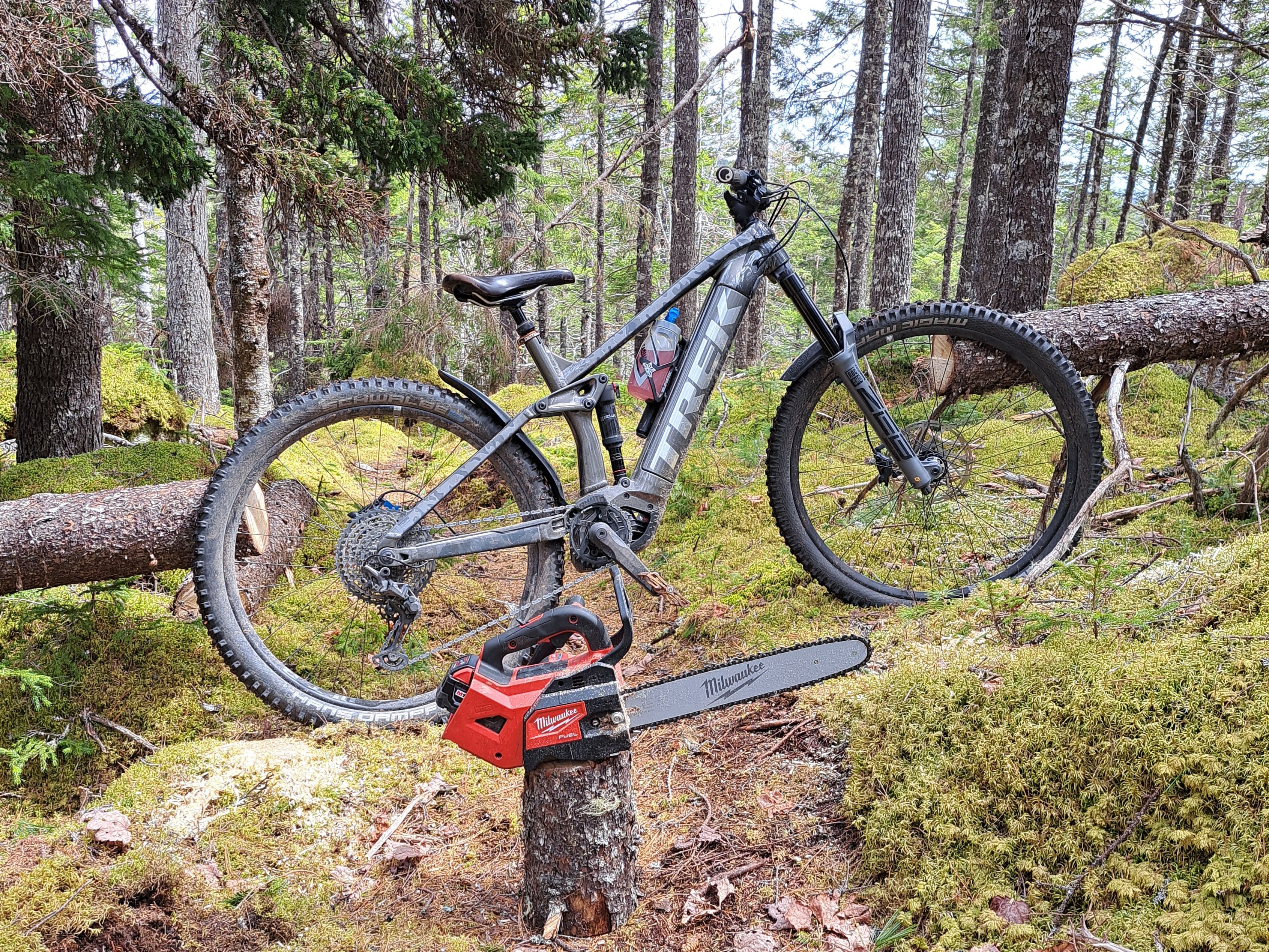

I put 38s on my rails. I briefly thought about asthetics, but function over form.
