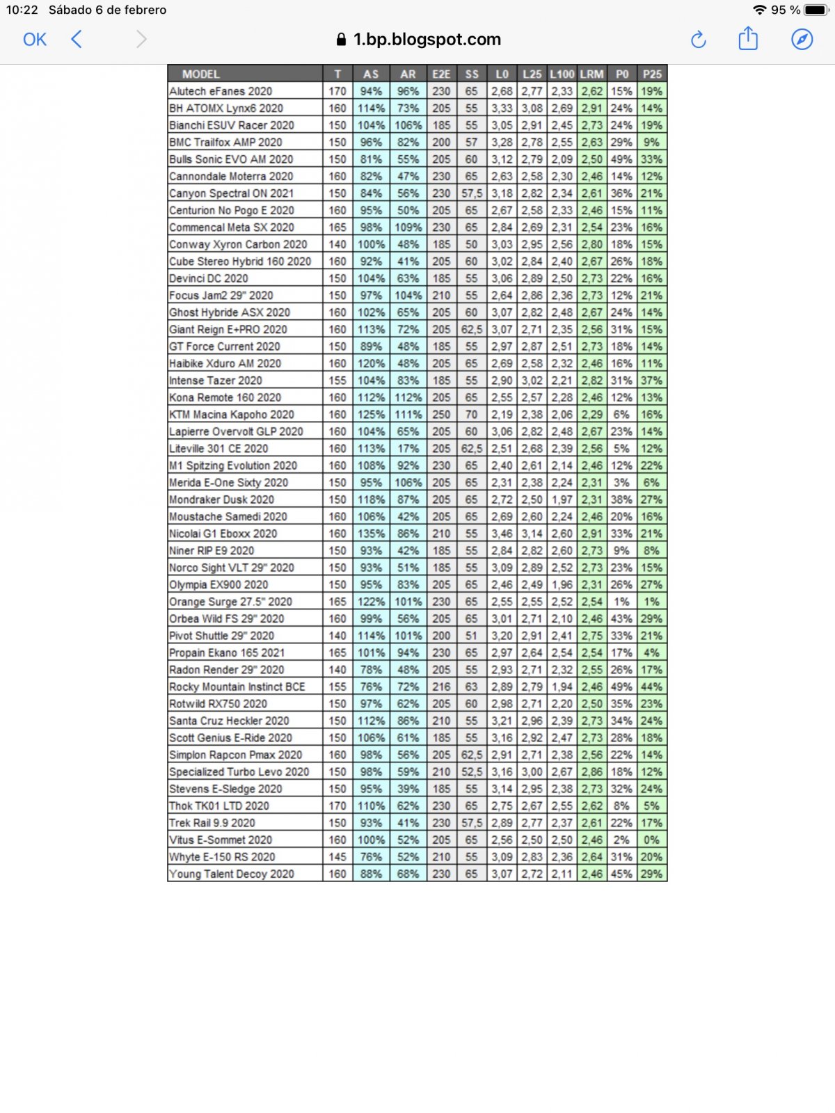

The Rail hasn't got a lot of progression to its suspension
You keep saying this and I'm wondering what you're basing this supposition on? The only review I've seen that goes into suspension kinematics is by that Spaniard who has done literally hundreds of bikes and he says the Rail is progressive (2.9-2.6). As I asked previously, how much progression is needed?
"That Spaniard" as you so call him, mostly analyses pictures to locate the pivot points and his findings should not be taken as gospel, just a guide. Either way 2.9 to 2.6 is very mild progression. My last DH bike went from 3.2 to 2.0. MX bikes have very progressive linkages for good reason.
The rail should be just fine on a coil as you guys have found. But personally I'd run a progressive spring for hard charging.
zaykay
Dec 3, 2019
93
79
Finland
That Spaniard had it 2.9 - 2.375 which is 18%. I would categorise it lower end of middle ground when comparing to another linkages. For sure not the best linkage ratio for coil but can be made work really well especially if you keep adjusting the clickers and shock tune is not too light. Running the compression full open will cause bottoming in faster g-outs and drops. For me it does not make sense since you loose the control provided byt the damping. I’m running stiffer clickers than Fox recommends for DHX2 and it works great. I’ve learned it’s the HS rebound which is finicky with the abs linkage.

This is interesting:
Doomanic
🛠️Wrecker🛠️
Jan 21, 2018
8,479
9,959
It is? I think you misspelled incomprehensible, because that’s what it is without some idea of what the column headers are referring to.

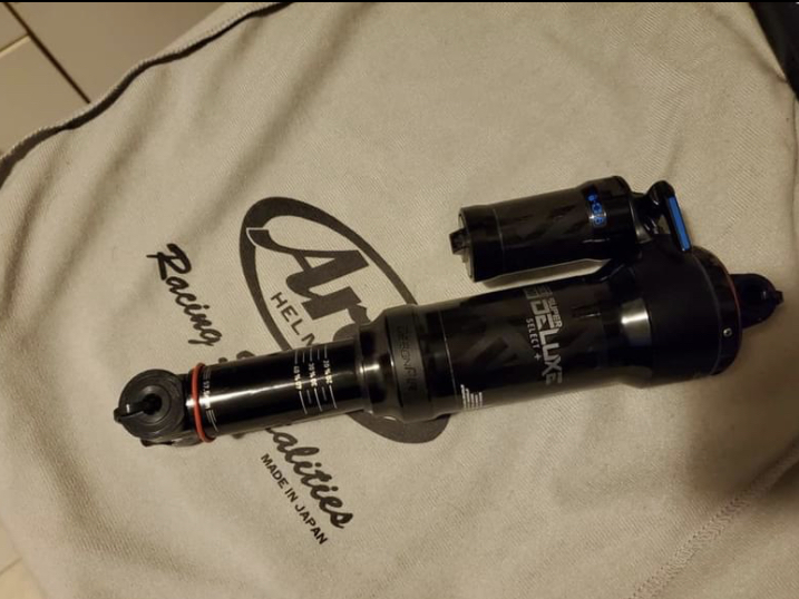

Considering swapping out the super deluxe for the jade x. Any feedback from someone who has done this?
Railingit187
Feb 8, 2021
19
7
Just ordered mine today, should be here early next week. Hardware is the biggest issue. Thanks trek ?
What is wrong with the thru shaft super deluxe? Is it not what trek wants it to be? I just have the deluxe on my 9.7 and trying to swap it out with a super deluxe ultimate non thru shaft. I like the progressiveness, the reason I do not want to go to coil.
