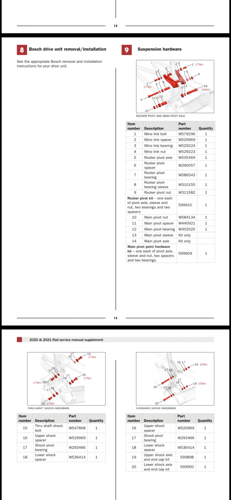

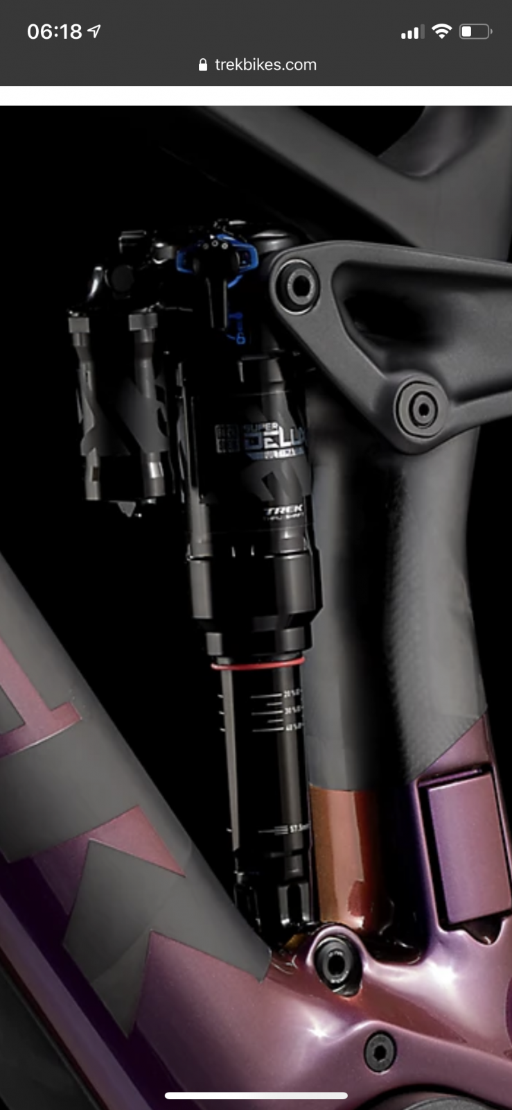

Riding a Rail 9.7 in XL std shock Mount - is the linkage the same as the 9.8/9.9 so you're able to buy / switch the rear shock to the thru shaft Trunnion mount?
The linkage is the same. You need to get the proper boots for the trunnion mount and lower mount.
Thank you very much- seems to be the first bike I have owned where choosing which shock to run is not as straightforward any previous ride , where just matching the eye to eye and stroke with the right hardware. ?

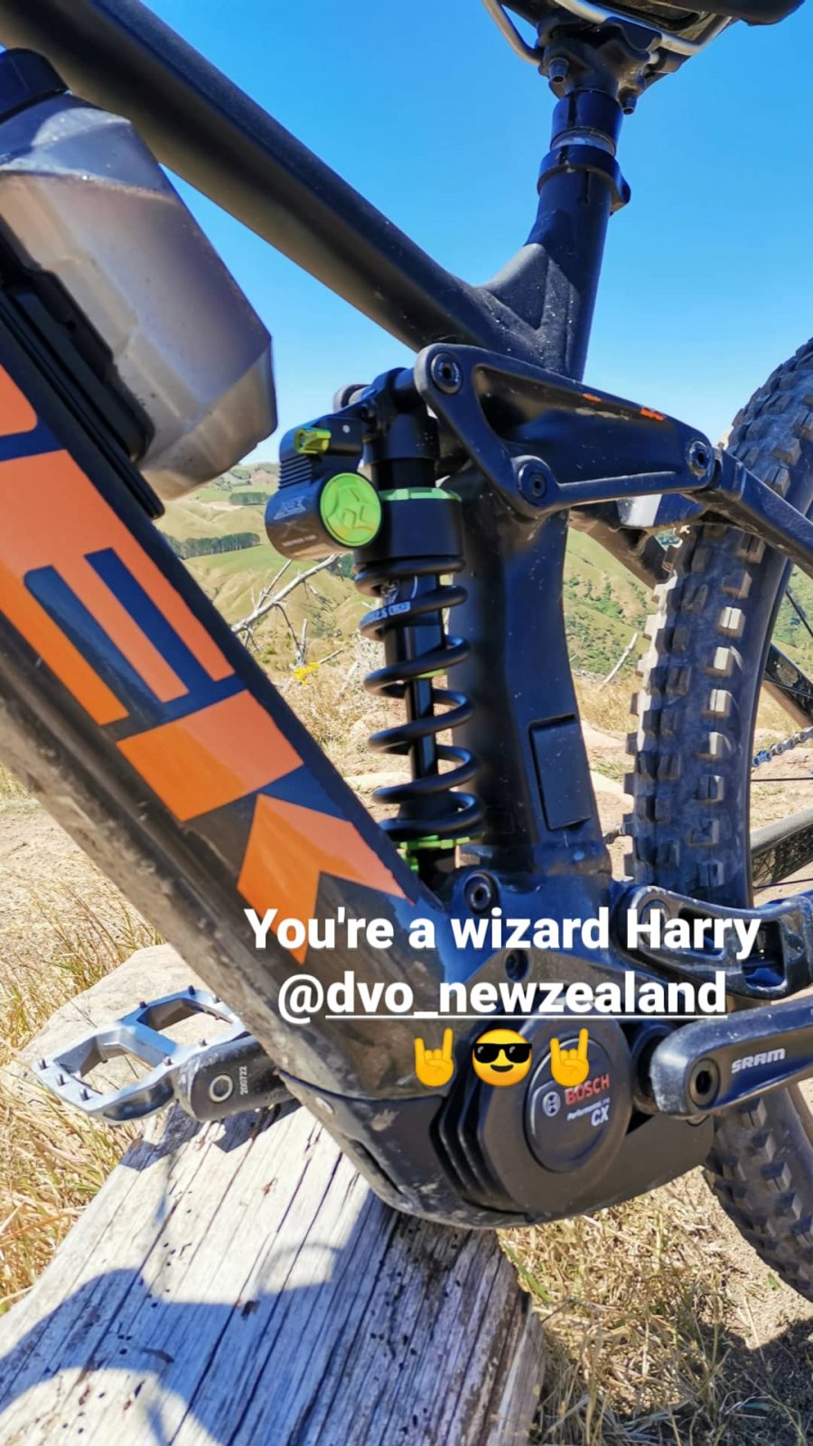

Be interesting to hear your feedback. Is Jesse tuning it to your weight? I'd like to hear how it goes straight out of the box before you do anything to it.
Jesse sprung and tuned it for my weight, sag was spot on and I went out 1 click of rebound. So plush and so much grip, holds up really well. Lock out is locked out! Trail is actually really good but I just have been running it wide open with great success.

I just followed your lead and got a Jade X with progressive spring.
You mean wound right in then one click out? If so that's what I run mine at. I was really unhappy with mine and about to sell or swap it until I adjusted the reboud right in from where it was set. It rides like your described now apart from a few bottom outs which I can live with.
I can't help but wonder though, with 18 clicks of adjustment whether there's something not quite right with the rest of it if we are running them so damped?
All suspension clickers should be wound all the way in and then counted out, I'm at 3 out from fully closed sometimes 4 out on the rebound. The stiffer the spring rate the more rebound you need to add to counter the force of the spring, most suspension circuits have the most effect with the first few clicks as the taper of the needle gets further away it has less restriction on the flow of oil. Just think of it like a garden tap.
If yours is fully closed you could maybe get a stiffer tune on the rebound circuit, a few bottom outs I wouldn't worry about unless they are very violent, you should recheck your sag just to make sure you have the correct spring, or maybe try a progressive spring.
Also don't be afraid to ride it in trail mode.

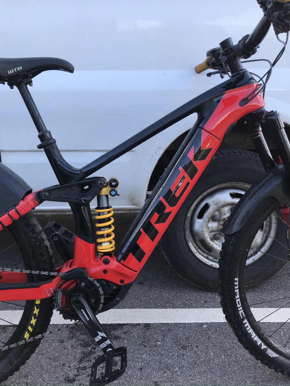

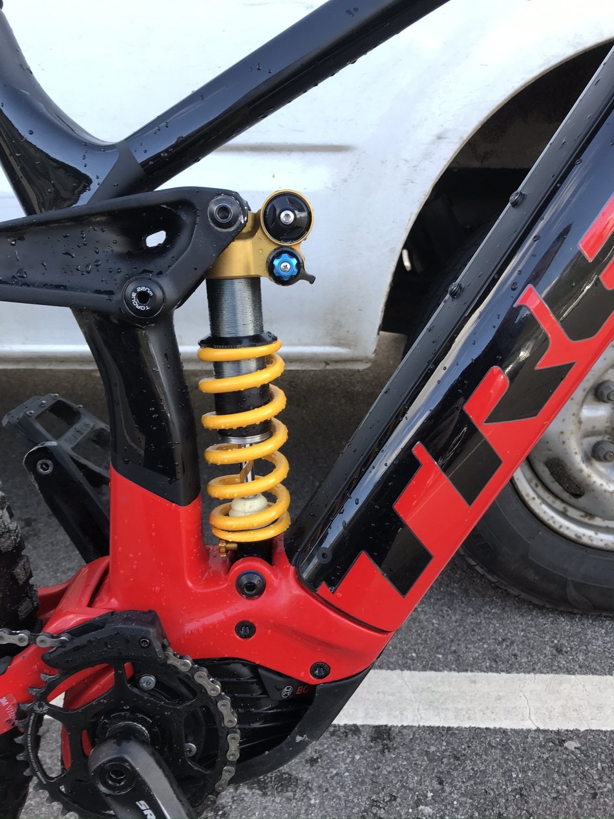

Is there a reason hardly anyone has opted for the Ohlins TTX 22 like Stan has? I know Ohlins aren't cheap so is it best bang for buck type thing? I like the idea of the Ohlins purely down to the amount of space it takes up. I have a custom bag being made and I have designed it around the current shock on the bike and I think the TTX 22 seems to not stick out as much but the angle of Stan's photo could be hiding it slightly.
Purely cost for me. The Jade X is about £200 cheaper.
I have the ttx 22 and love it. I spoke with someone at tftuned and they said a fewof them ran the ohlins on Rails so that swung it for me.
Plenty of room with a large frame, if I remember tomorrow I can get a side on photo for you.

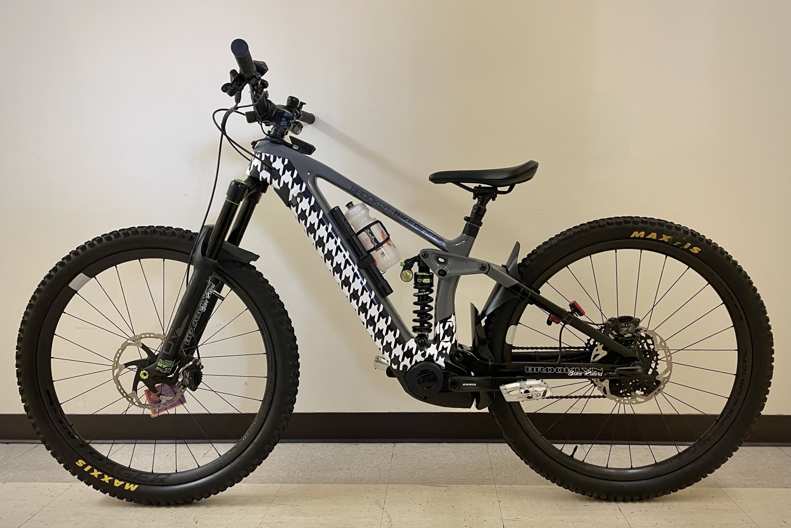

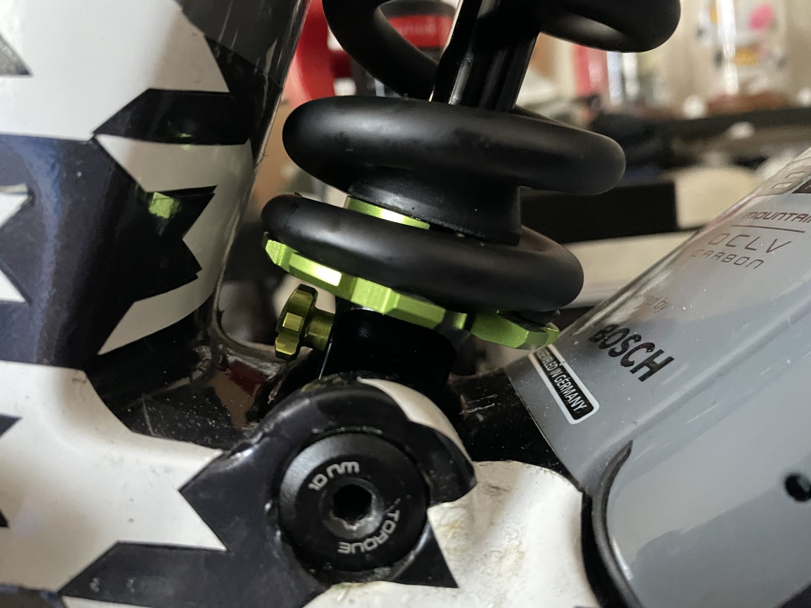

Finally got my DVO JadeX (230mm x 57.5mm) fitted to a 2020 Rail 9.7 (medium), after a few months of waiting. Originally wanted a Topaz3, but the piggy back was too long and didn't allow for full travel of the shock. The JadeX fits great on the medium Rail, with the original mounting hardware, though I needed to face the rebound knob towards the back. Now I just need to ride it.
JadeX Coil, fitted with DU Bushing, so it can be mounted using the original hardware.
JadeX, Rock Shox Deluxe Select+
Rebound knob needs to faced towards the back.
The shock clears fully compressed.
The only clearance issue I will is if ever want to flip the compression switch up, it will hit the bottom of the water bottle.
