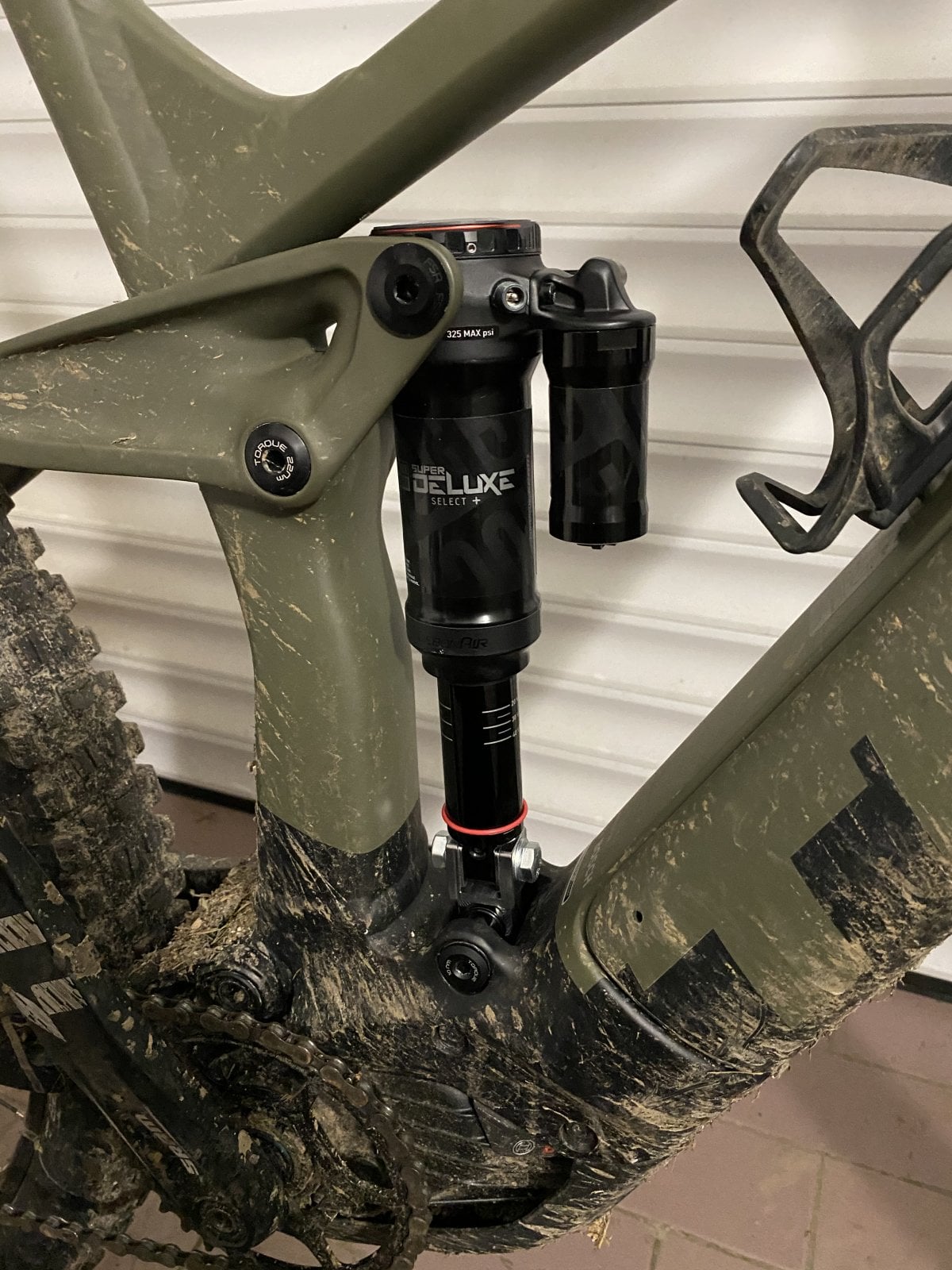

I haven't tried it, but I think not enough clearance for a piggyback. With my converted trunnion 205x60, there is around 5 mm clearance.

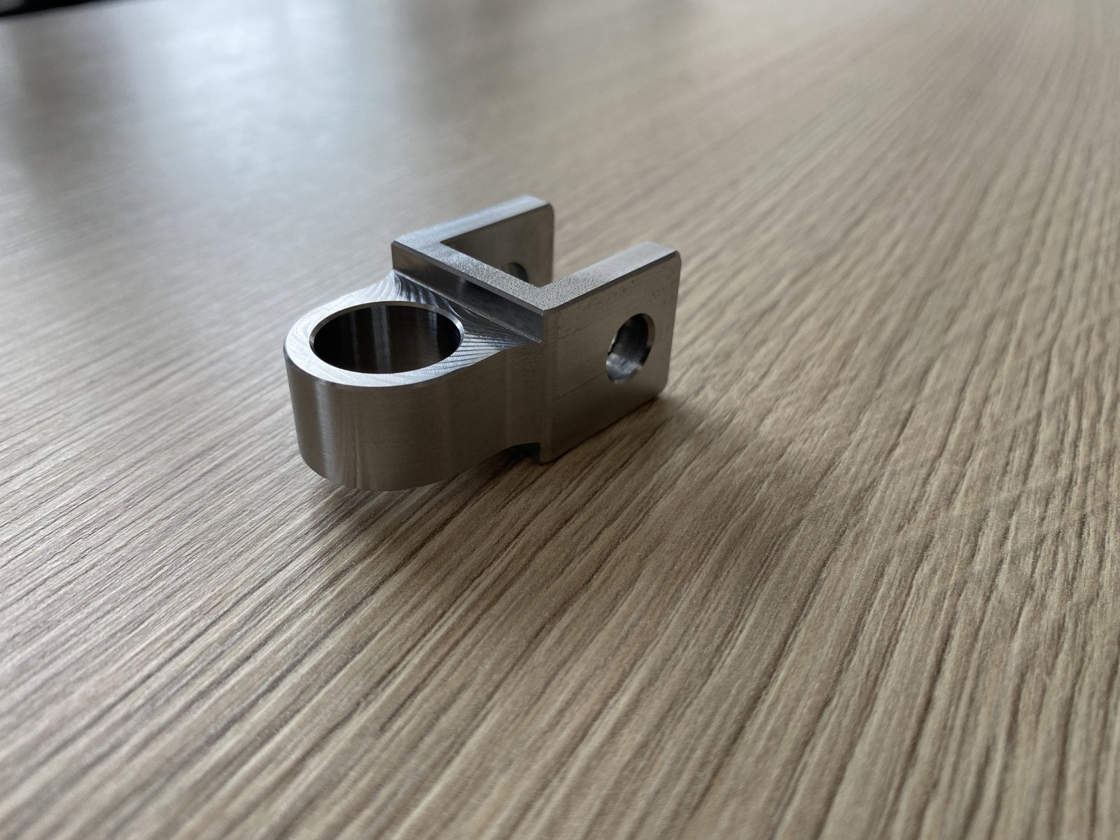

Hello guys, I'm a new member and I have a question for you. I have a Trek Rail 9 alloy 2020 size L and I want to change the rear shock. To do this I see that is necessary the adapter to mount a rear shock with standard mount. Now my original rear shock have trunnion mount.
Could you tell me which adapter I need to mount an Ohlins rear shox with standard mount please? I have also difficult to find a rear shock with these dimension 230x57,5, I see somebody use 230x60, which problems can I found? if there are problems the warranty is valid?

On a medium- sized Rail, when I tried the Topaz 3, the piggyback was hitting the frame at about 50-60% of the travel.

Also the rockshox air can will foul on the frame

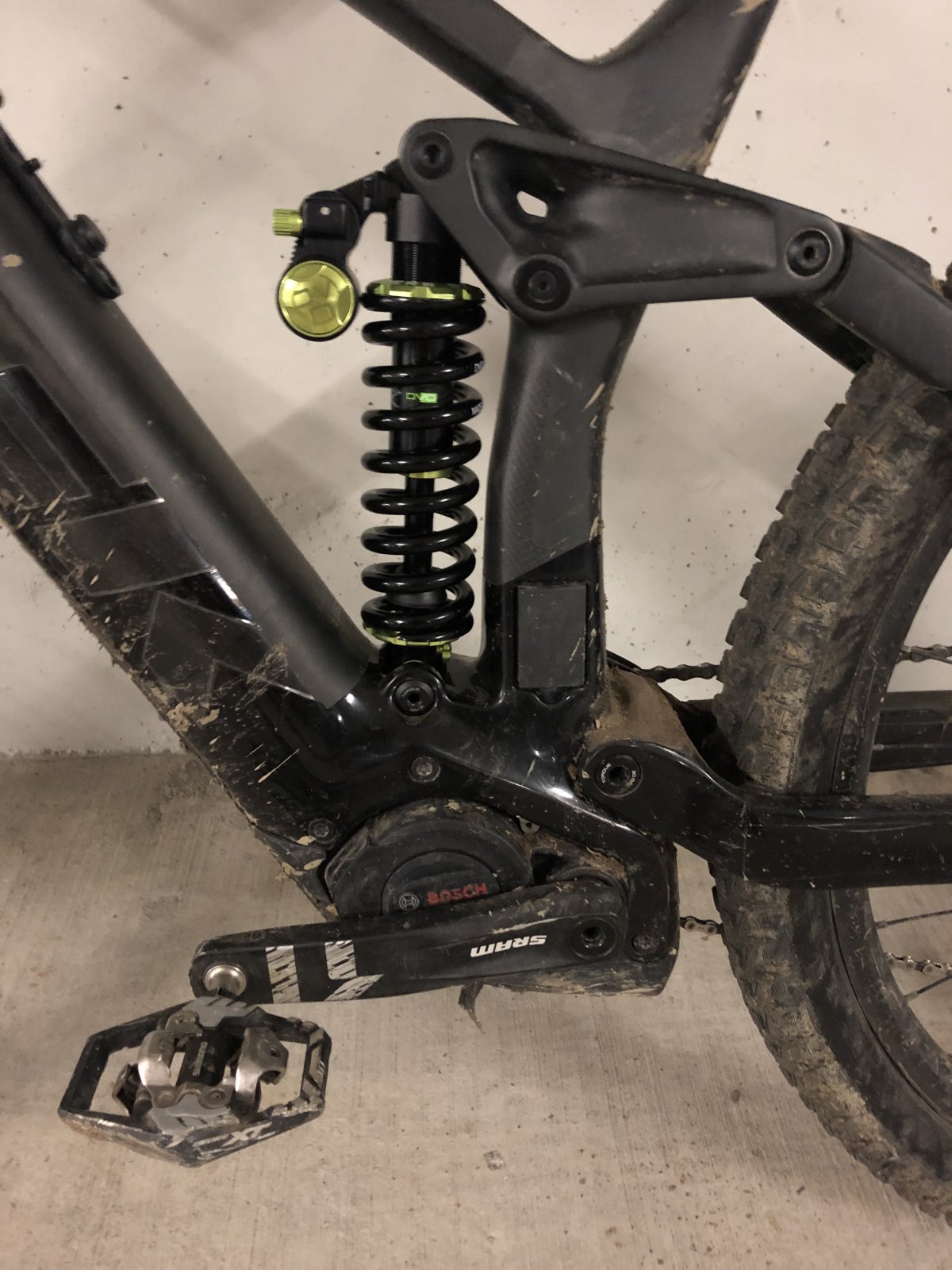

DVO Jade X uses different offset spring cups to change stroke. No rebuild required. It also has an offset reservoir so has plenty of frame clearance on full compression.
