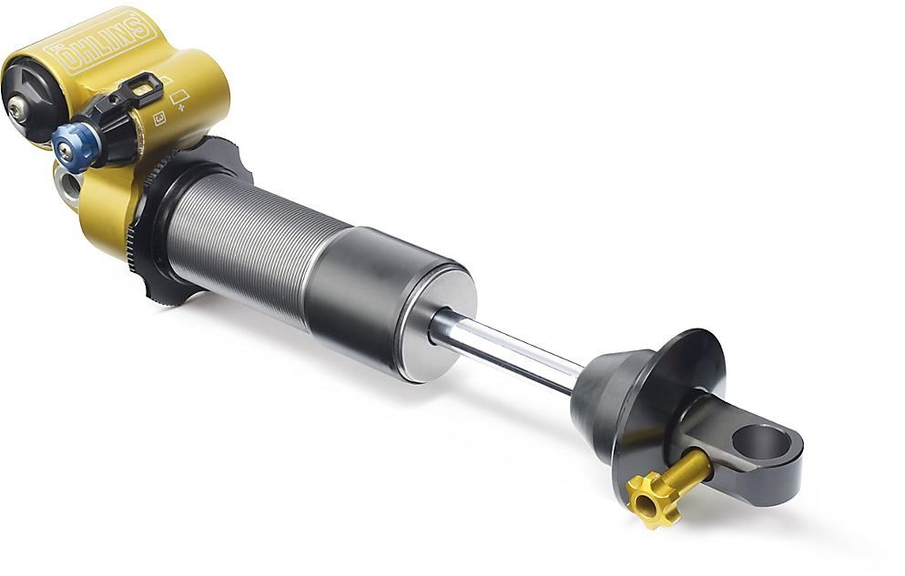

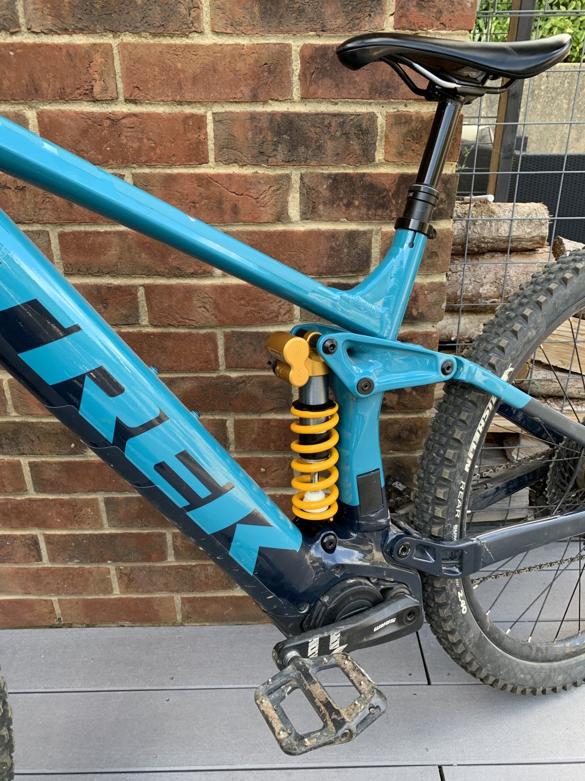

View attachment 34562Ohlins TTX 22 for me! Will work with XL and L frames and mine has mounting hardware for Trunnion frame. ?
Hey man I'm looking at doing this as I already have the ttx 22 on my slash. What's the detail on the trunnion mount? Is it a different shock body? Looks sick!

Anyone know if a Ohlins TTX 22 will fit in a medium frame. I think from reading through everything the Jade X is the only coil mentioned in a medium frame.

There's two types of TTX22M. This type fits the Medium Rail according to TFTuned.;
The TTX 22M 16 series is the more 'traditional' looking one with a normal piggyback, against the above. Just advise which you want/prefer, the performance is identical between them.

No, shock is the same. As long as it’s the correct size TF Tuned sell the mounting hardware with Through Bolt to fit to Trunnion frame mounts. Give them a call, they’ll talk you through it!

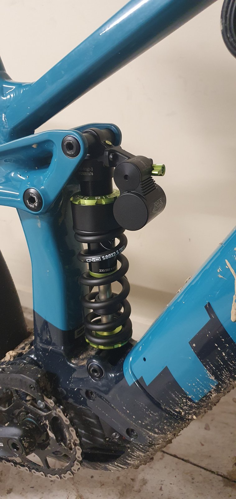

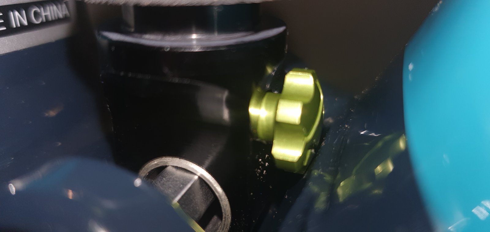

Finally got correct mounting hardware, fits great on Med frame with Reb adjuster on rear at the bottom. Mine came with the LS spring too.

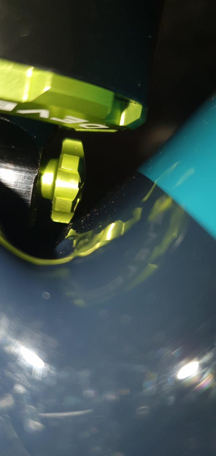

Can confirm the EXT Storia does fit, but needs the shorter piggyback option. (45mm rather than 55mm).
Bike was running 230x60 for a bit more rear travel, had to put a spacer in, so it's now 230x59 to ensure it doesn't hit on hard bottom out.
