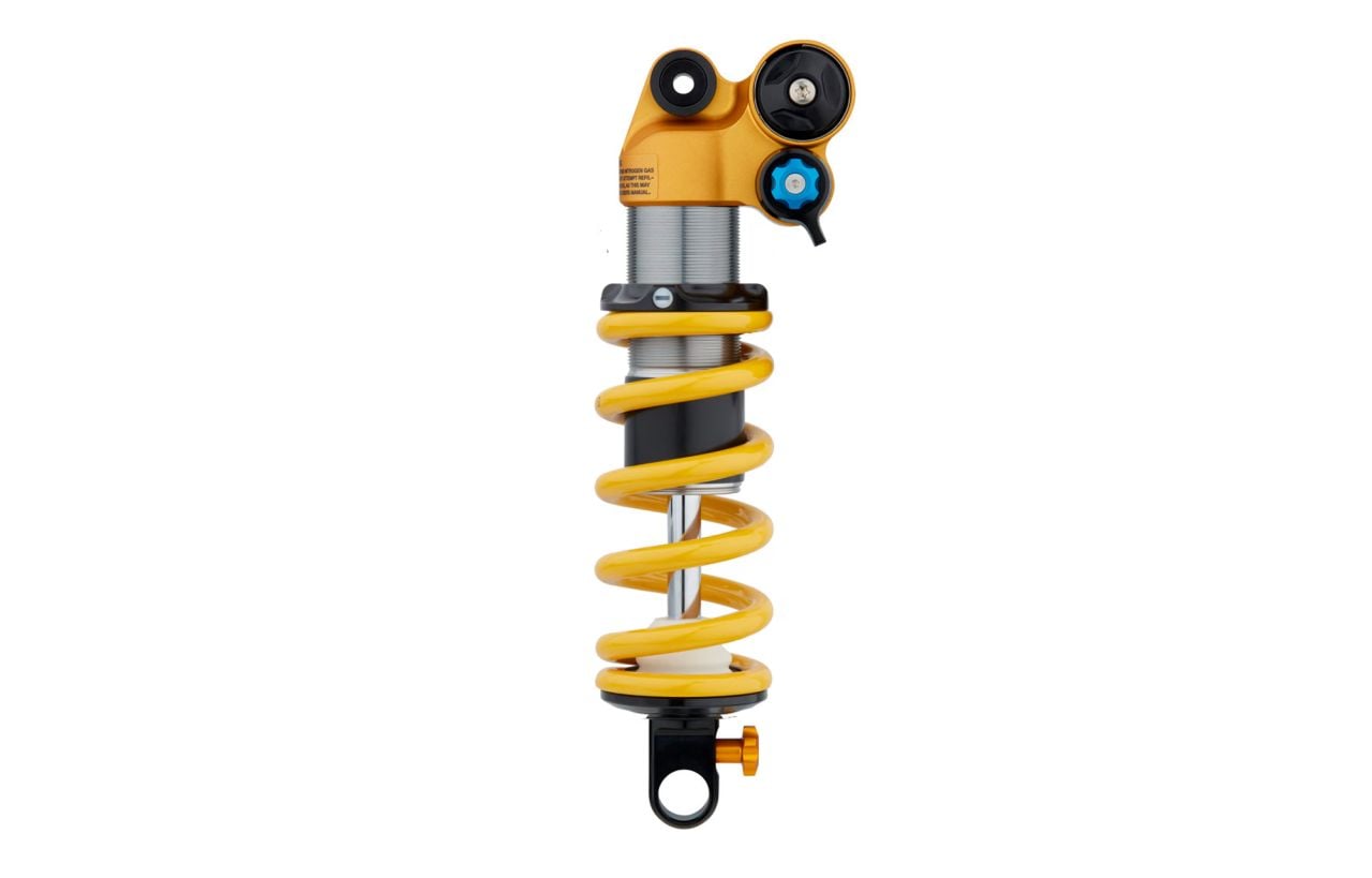

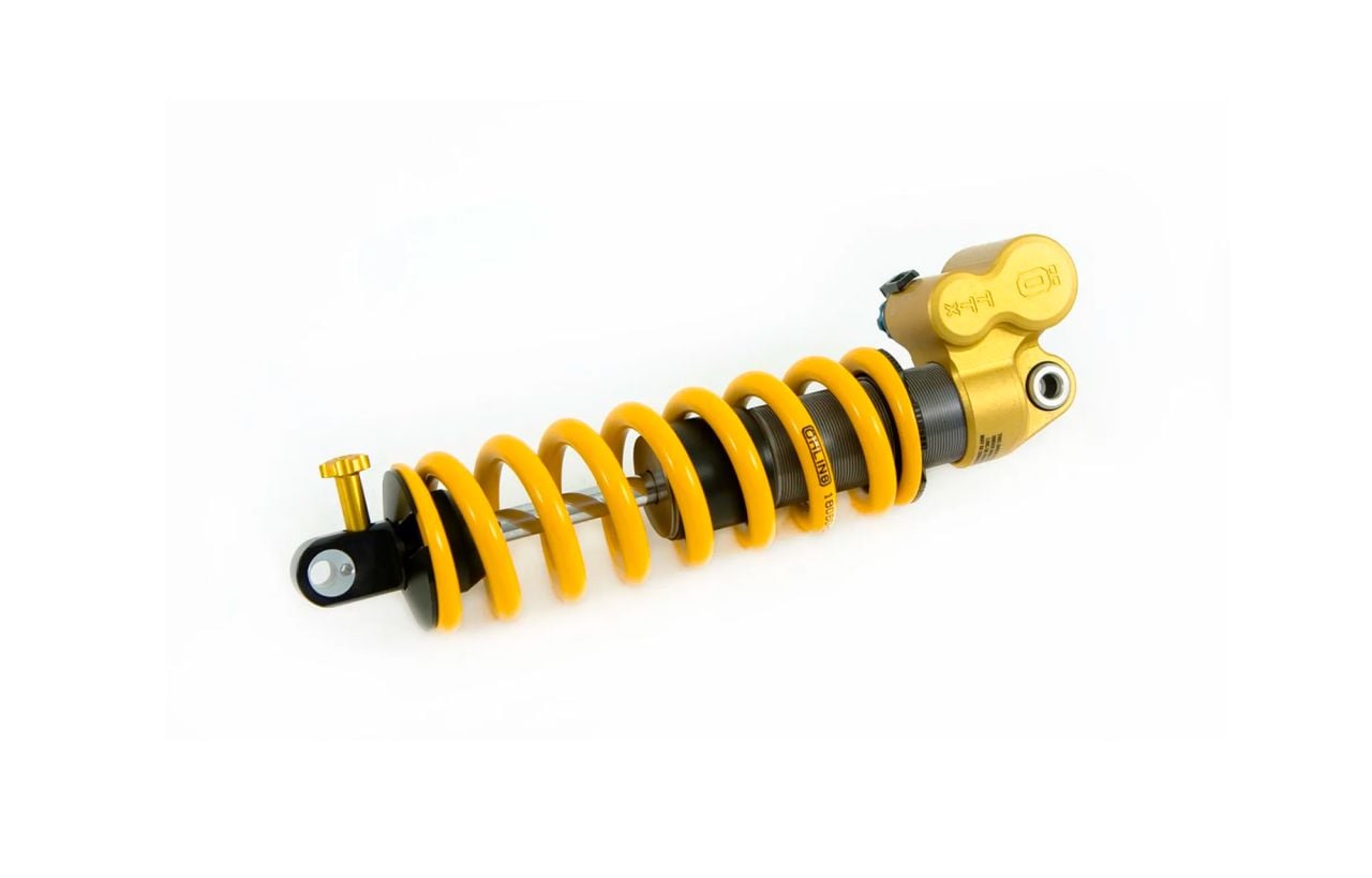

I found an Öhlins TTX22M coil shock with a 230x65 size that I’m looking to install on my Large Trek Rail 7 Gen 2 with an aluminum frame. Before I commit, I want to make sure it’s a good fit for my bike in terms of compatibility and performance.
Has anyone here installed a 230x65 shock on a Gen 2 Rail 7 aluminum, or does anyone know if there are any issues with frame clearance or geometry? With the extra travel, would the shock potentially hit anything under compression? Also, I noticed that the yellow adjuster knob is at the bottom of the shock—does anyone know if it’s possible to rotate it by 180 degrees to move it to a different position?
Any advice on mounting hardware or setup tips would be super helpful!

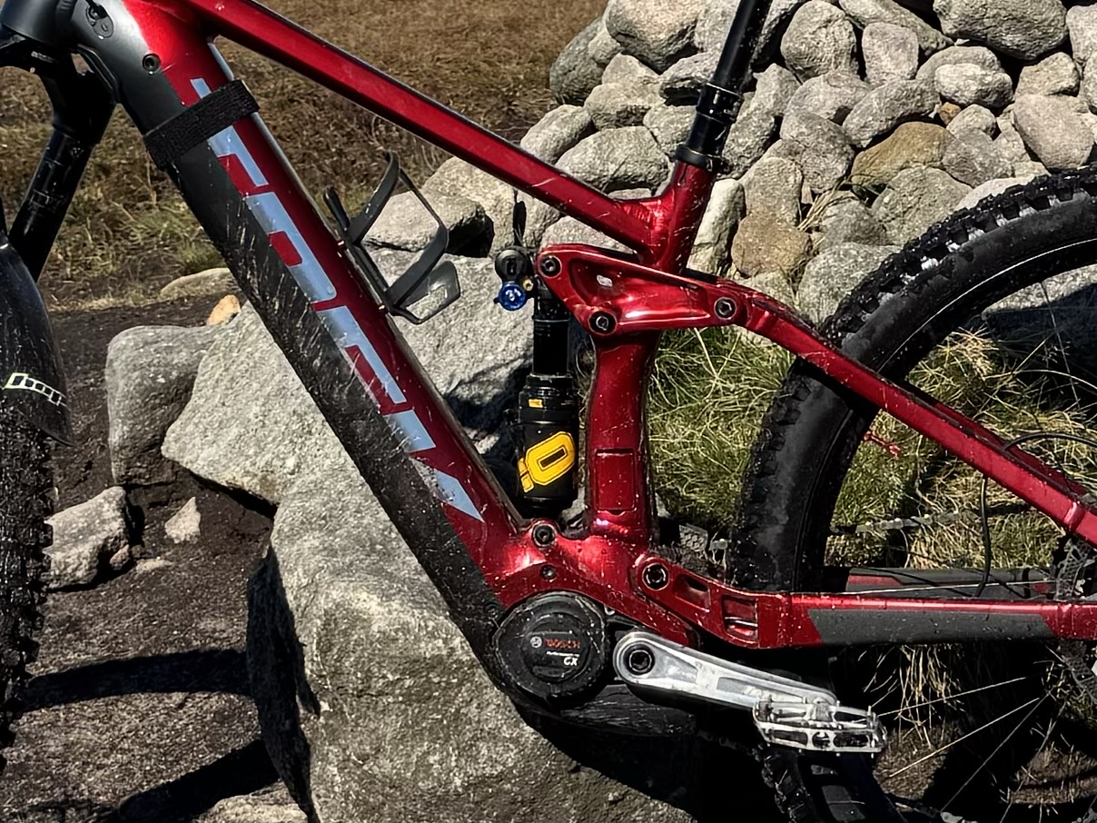

I borrowed an Ohlins TX22m coil damper in 230 x 65mm (from my mrs's) and ftted it on my alloy Rail5 - medium frame.
used the origonal Trek mount hardware & turned the damper shaft 90* to position the rebound adjuster (y)
as to overstroke, had no problems riding my local park tech & flow trails so red runs with drops & chunk :cool:

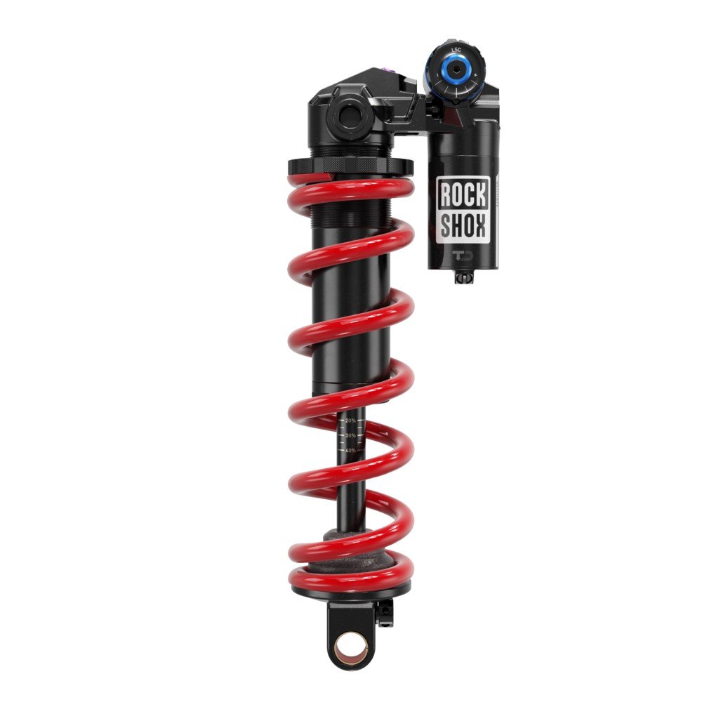

I'm new here i would like to ask everyone if someone try this option for the coil shock , Rockshox VIVID coil trunnion mount 205x60 with 25mm shock craft lift kit if the spring or collar of the shock will not touch in between rocker mount?

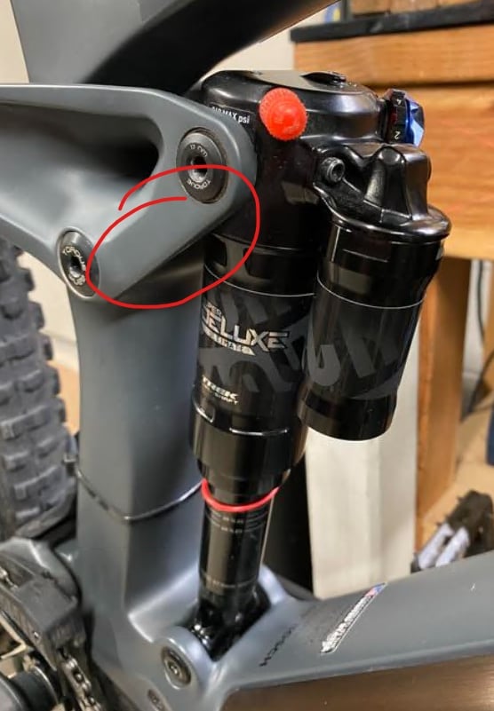

I removed the air can on my superdeluxe to check what (if any) tokens were installed. As it turns out there's a blue spacer underneath the bump stop which is clearly used to limit travel. I've no doubt this could be easily cut off and thus give full stroke. Normally i cross reference the parts catalogue in these situations to make sure things like air cans - damper body's etc are indeed the same. I wasn't brave enough to cut it off just in case something collides internally or there isn't enough clearance in the seat stay bridge at bottom out. To replace the spacer is a FULL strip down job, with all the special tools involved, the main piston is quite an intricate thing!
I was in a bit of a rush to go out riding, so didn't measure the spacer, but 5mm seems about right. Who's going to do it first ?
No volume tokens BTW...
i cut the blue spacer i wrap the stanchion of the shock to make it sure the saw will not touch i cut it both opposite side and if ech side have few MM left i snap it
