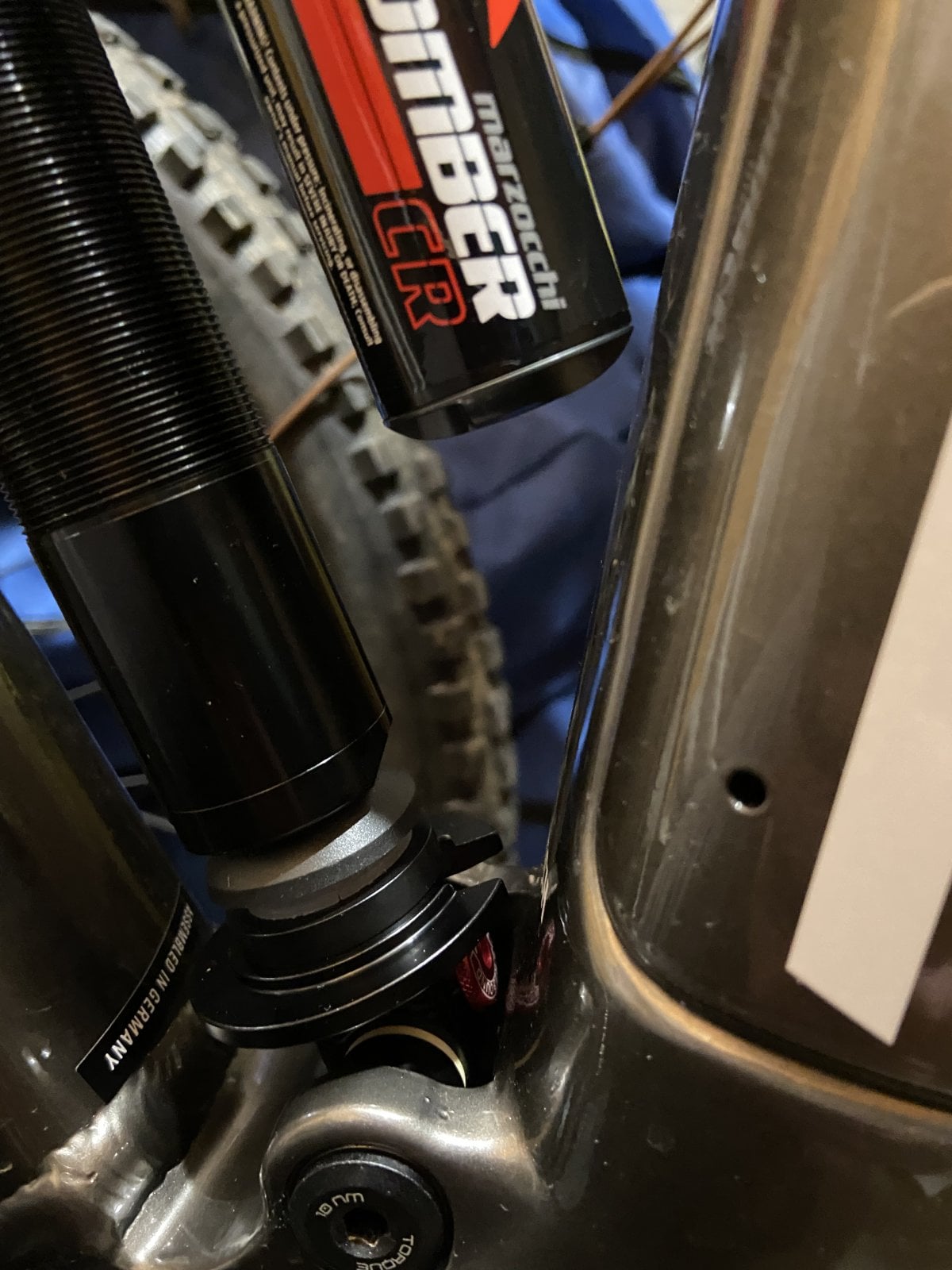

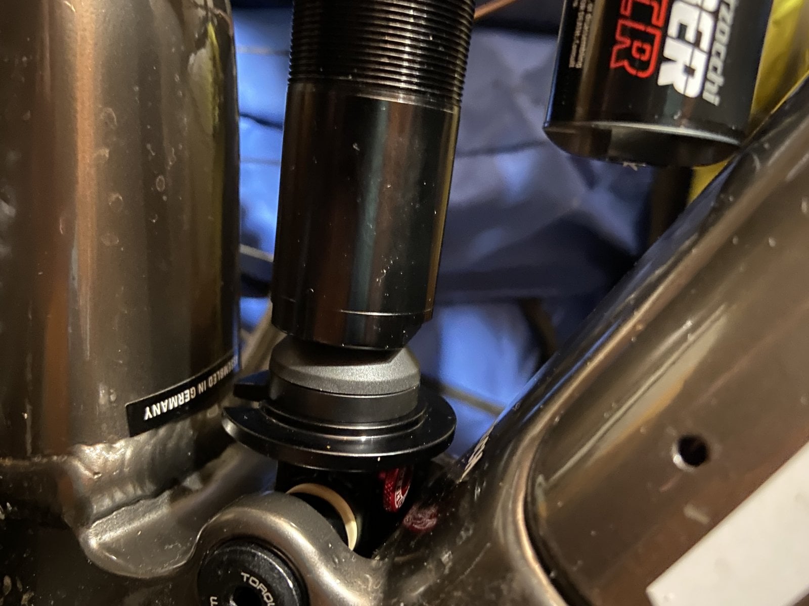

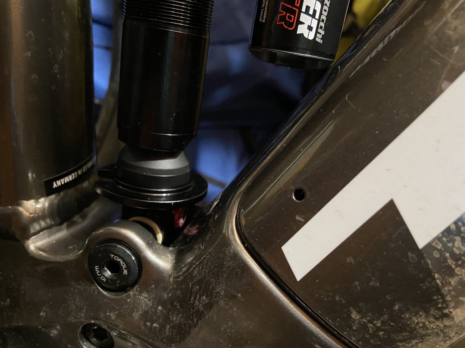

So I got my Bomber CR today, and it is a really close fit. It does touch The downtube on full compression, but I thinking we Are takling mm here… I have heard That some people use «nylon washer» to travel down, what Are those? Are they Easy to fit?
If that bumpstop is rubber, on full compression something is going to give if the can is touching already.

Any tips on how I could make this work? ...before i try to return the shock'
What is the shock travel now?
You can put shims under the bump stop to make it bottom out before the can hits the frame, but its less than optimal if you need to go under 57,5mm as it will reduce suspension travel under the stock 150mm
Yeah, i was wondering about that, but do it need to be special "shims" Or is it like normal washers? easy to install/buy?
The stoke is now 60mm on the cr- so I can lower it to "stock"

So I installed nylon shims to reduce the travel to around 57mm, think this will work’ piggyback did not hit The downtube on full compression (bouncing)
