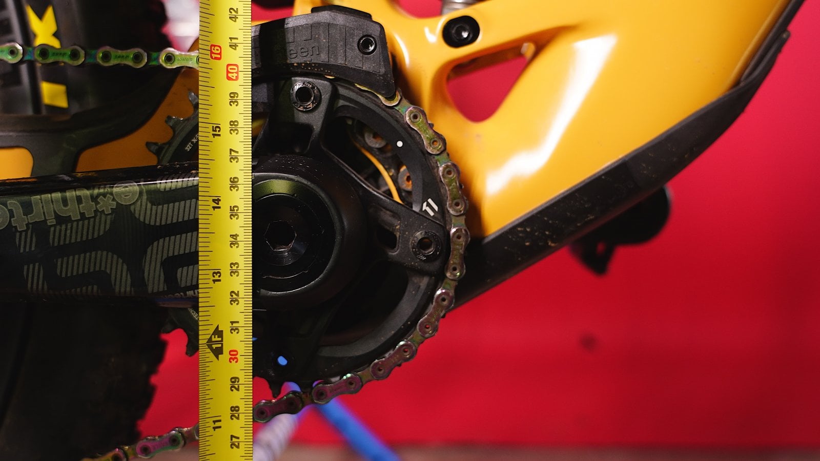

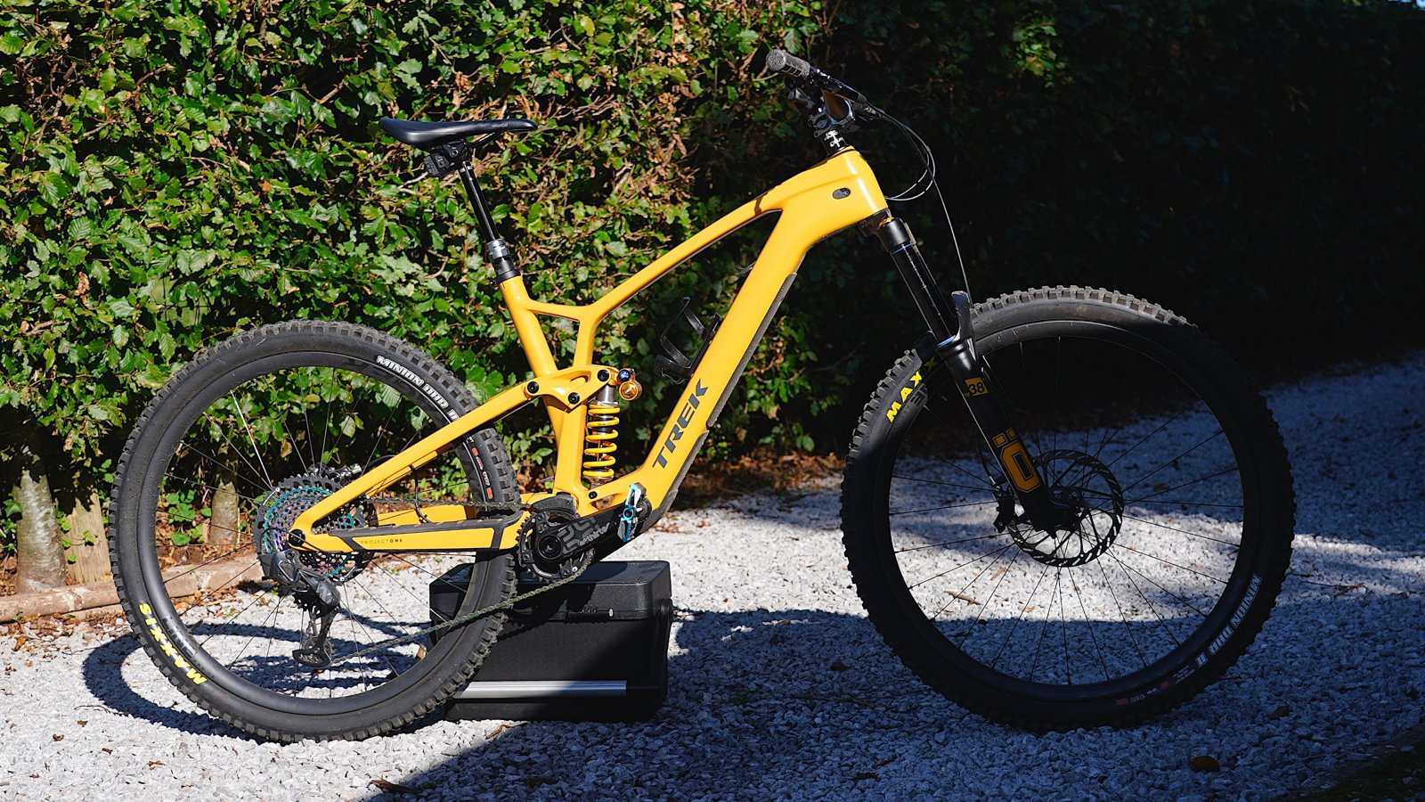

I'm running the Mino in high, with 170mm fork. BB height is 344mm with 2.4" tyres. Thats pretty good for a 152mm / 170mm travel bike I think.
Edit - should add that a 170mm fork and longer stroke shock will prob void any warranty.

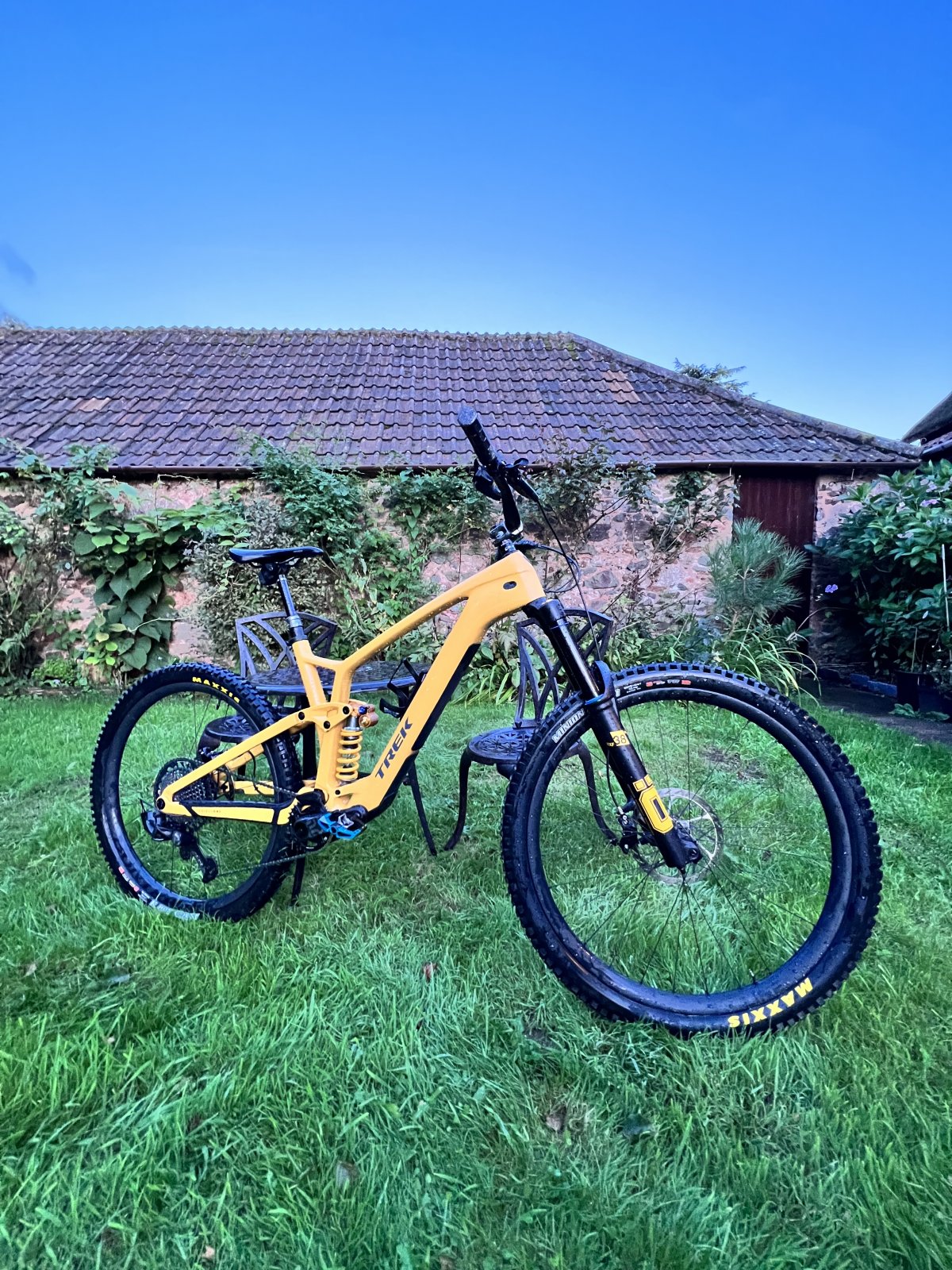

I never did any rides on the EXe. I had my LBS strip it to the frame and build it per my specs. Mine is mullet with a 160 fork. So far, so good. I only have 4 rides in, so still getting used to the geometry. The bike felt really good on my 25 mile ride this morning. It climbs and descends really well. It is only going to get better as I ride it more.

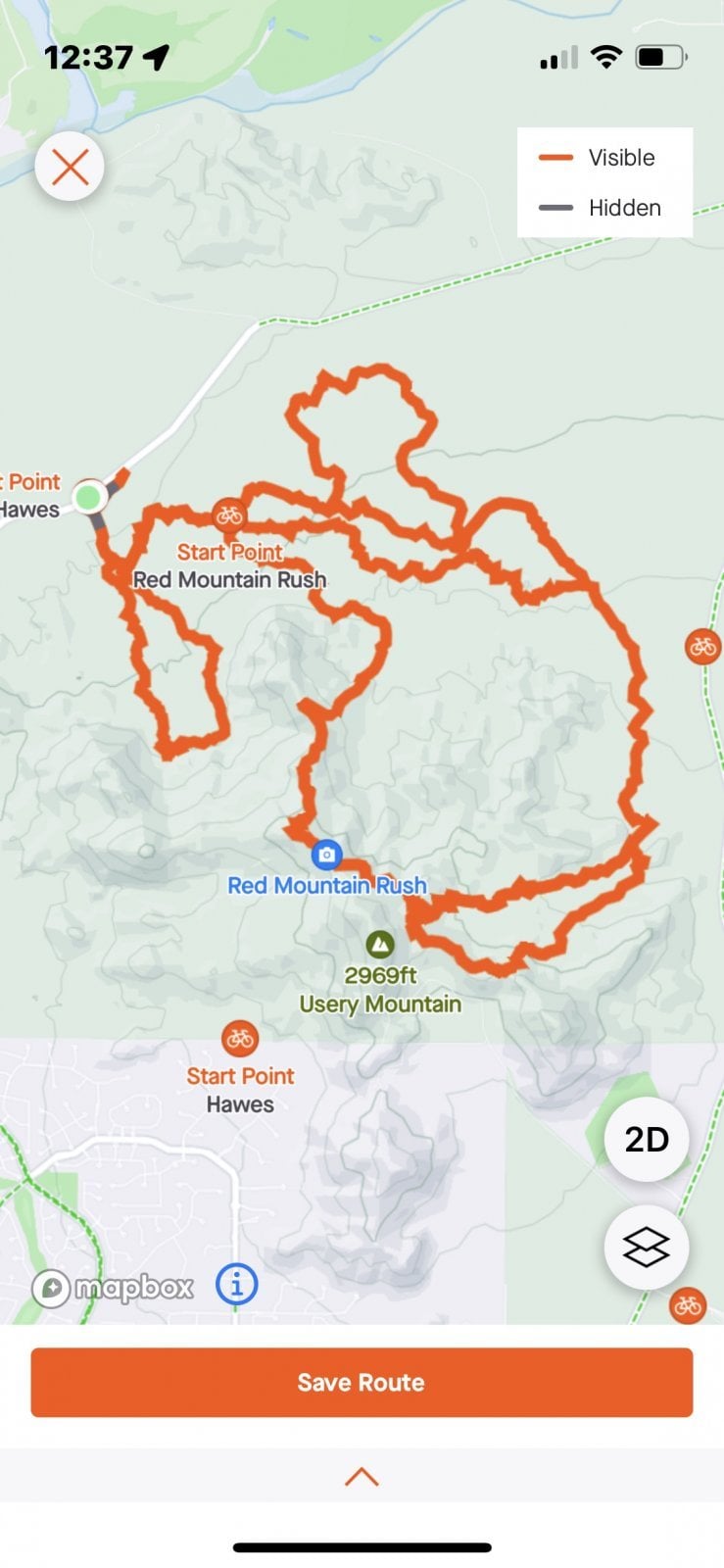

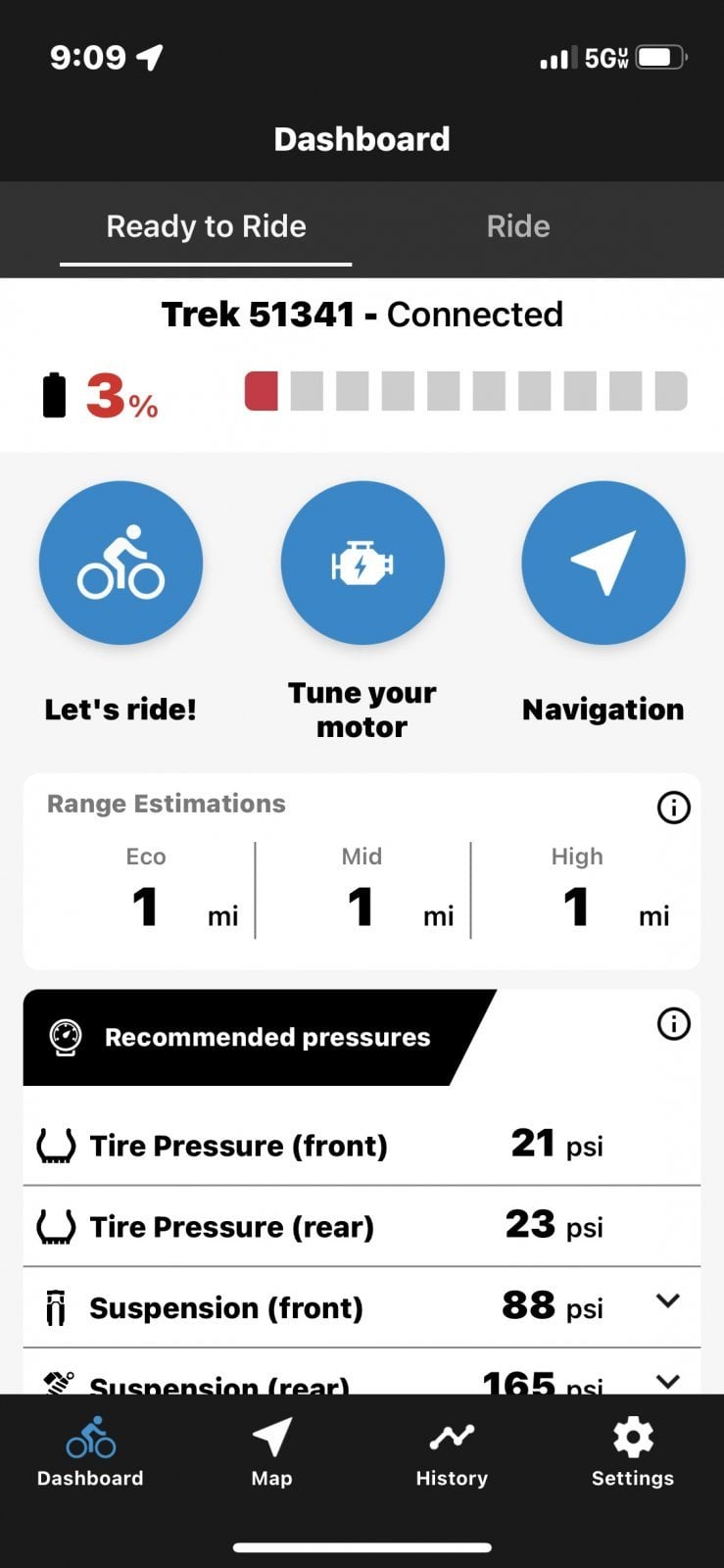

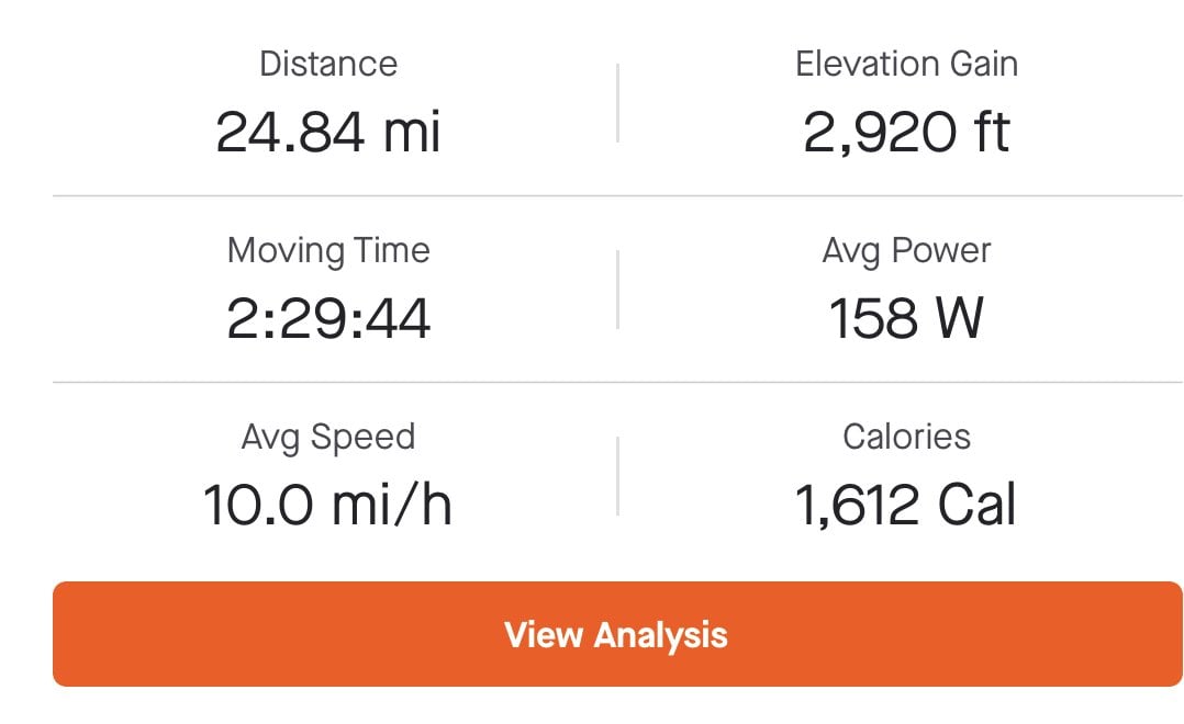

I rode this morning until the battery drained to only 3%. I wanted to do a full range test. This was on my local trails, Hawes in Mesa, AZ. These trails are a mix of intermediate and advanced, with a touch of beginner mixed in. I rode mostly in a combination of Eco and Trail, using Boost only for the steeper and punchier climbs. Here are my ride numbers and map of the ride:
