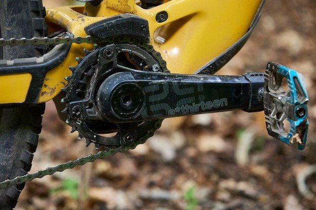

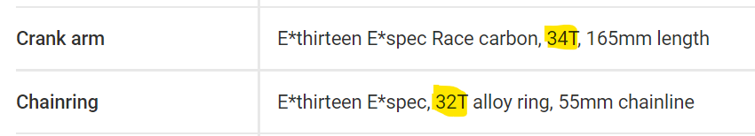

Does anybody know what pattern the E13 chainring is? Shimano, Bosch or Brose?
Has anybody gone up to a 34t?
The TQ to Chainring/Spider connector is TQ's own lobe design. Depending on your level, you got a 1pc e13 or 2pc-spider. 2pc spider shown in the pic is 104 BCD that will fit any standard ring. (you may be able to order this as a spare part)
34t: you CAN fit it, but after riding many iterations, the 32t has the best range for me. Larger ring can push the chain outside the main pivot center, creating more pedal bob. The only reason I could see doing this is if you are very fit and/or spinning out your cassette 10t often. What is the main driver for trying a 34t? maybe it is something else.
My 9.8XT has two chainrings according to the spec. On the one chainring on my bike, I couldn't see the tooth count and I didn't feel like counting them.

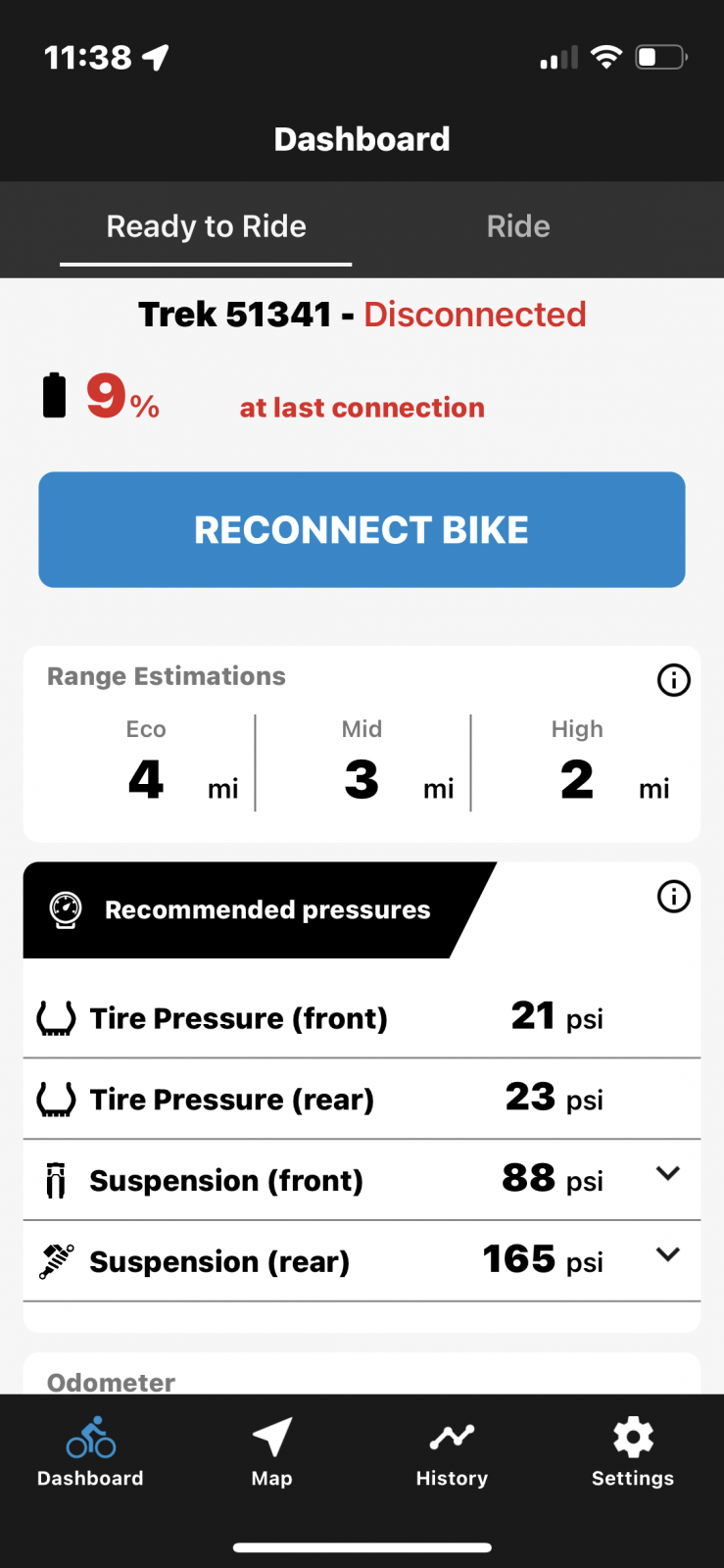

Another ride today. Did about 20 miles with about 2,700’ elevation. There was 9% battery remaining when I finished the ride. Range is ok, but do think TQ could have done better with range. That said, the EXe is an in incredible bike. Other than the extra power you can’t tell the difference between this and a full pedal MTB. Highly recommend this bike. No regrets here.
5CCAD7B7-20EC-486D-AFF2-9E1E01467A28.jpeg 17F52549-9177-419F-A727-BCD8653A2DCE.png ADA2DDFF-88A6-4BBE-9723-EEA087B58D54.png
Curious about where you have your app tune settings. I found that it makes a huge difference in range.

The crank says for Bosch so I assume maybe the chainring is as well? E13 crank
There are 2 different chainrings. One that comes equipped with Sram and one for bikes with Shimano. You can look at the pictures on the Trek website and see the differences. My girlfriend got her 9.7 in July and wanted to put her Sram cassette on, but our Trek LBS said the Shimano cassette wasn't compatible with the Shimano chainring and the individual chainrings wouldn't be available until the 1 quarter of 2023. Not sure If any of that has changed, since then.
