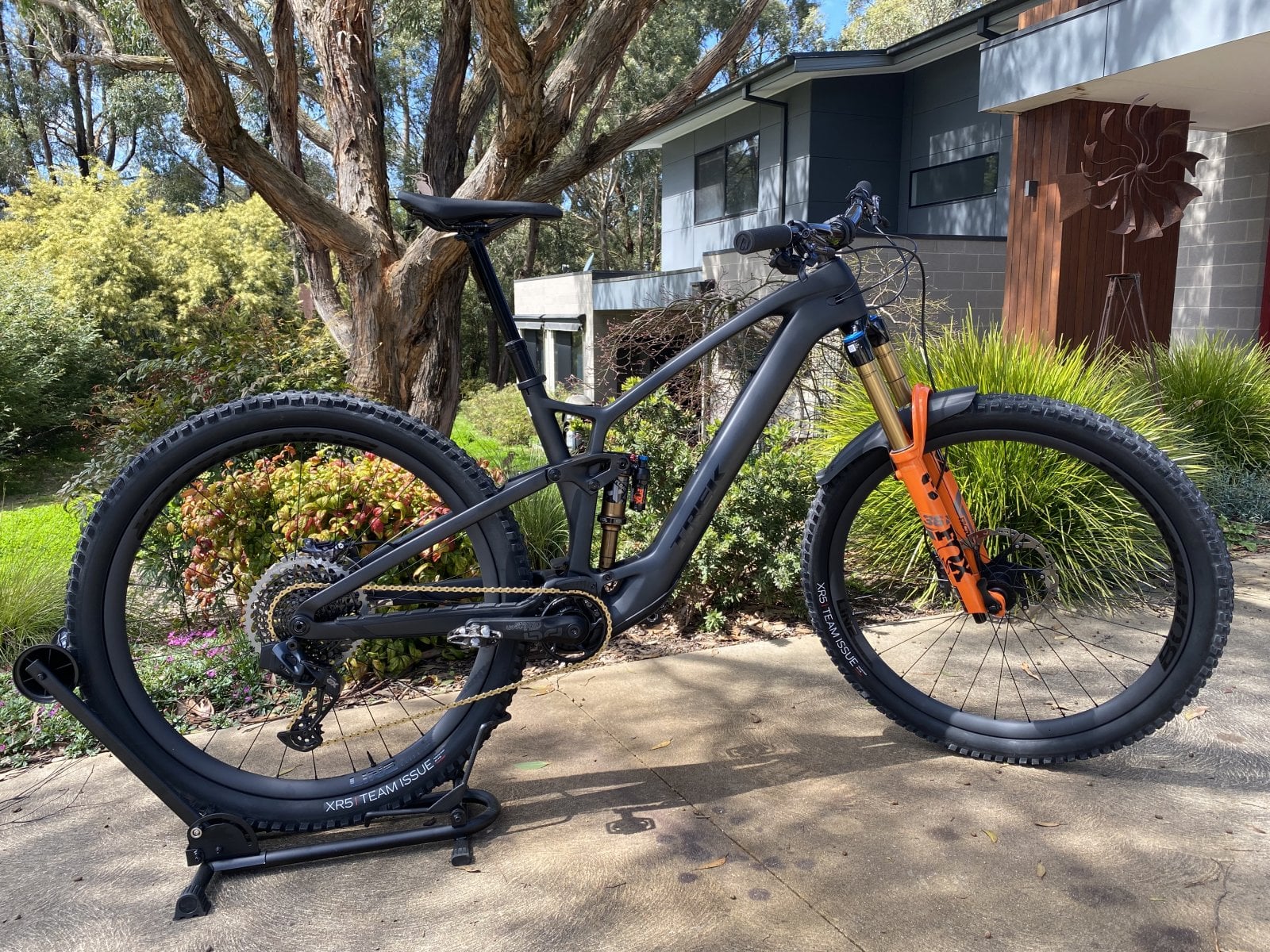

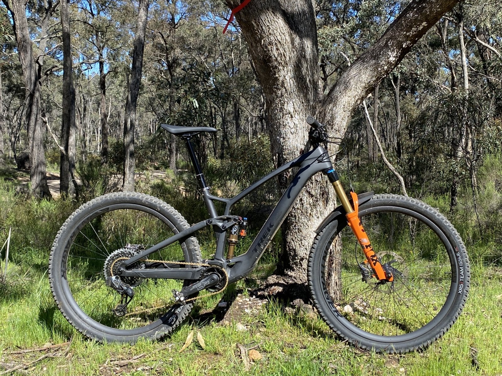

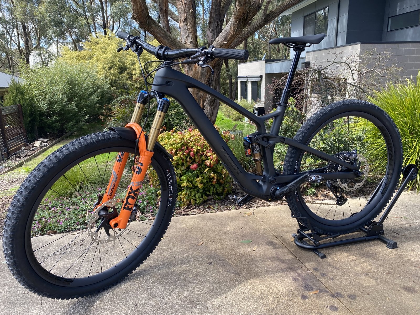

All i've used of the original 9.5 is the frame, motor, seat and seat post, tyres and electrics. All the rest is in a pile waiting to be sold.
The bike has following upgrades.
Fox Factory 36 with 160mm travel
Fox Factory Float X shock
Sram GX AXS derailleur
Sram XO1 Polar Grey Cassette
Sram XX1 Gold chain
Bontrager Line Elite wheels
Deity Skywire Stealth Carbon bars
Deity Supracrush grips
Wolf Tooth ispec dropper remote
Wolf Tooth top cap
Ethirteen 40mm stem
Carbon stem spacers
XT Brakes
RT86 brake rotors, courtesy of Trek
Look X-Track enrage pedals.
I took it out for its maiden voyage this morning. I did 44km with 640 meters of climbing. I used a mix of eco and mid, both modes have been turned down form the default setting. I finished with 8% battery left. This bike handles extremely well, but she's a slow old ride uphill compared to my Rail, but when it levels out and and you keep your speed up, it's very fast between the trees. My suspension settings need a bit of work to get it working how i want and i think it would benefit from skinnier tyres as the 2.6's are just too big for it i feel. Overall it's a very impressive bike and it's nice to ride a bike that doesn't sound like it's going to fall apart going downhill.
