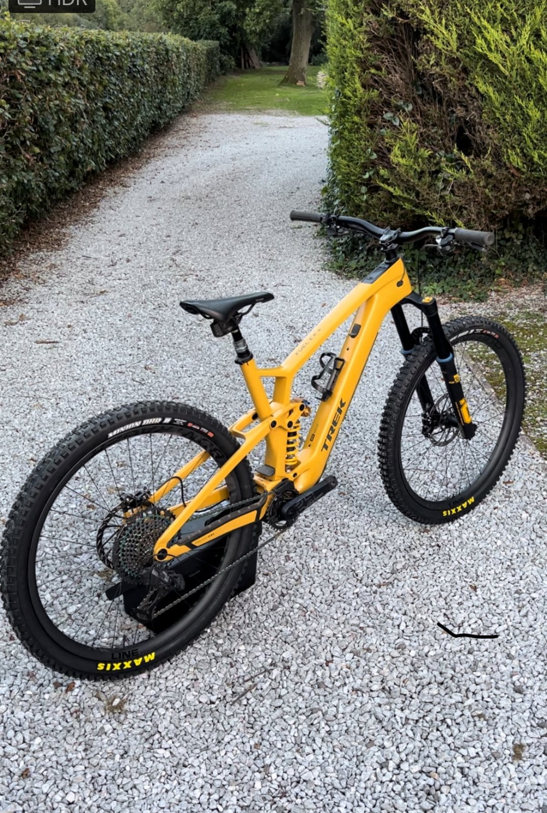

Hey there, nice build :- ) Always happy to see ZEB on anything :- ). Just like I would build it. While I have no intention to swap from my Kenevo SL as I love it as a bike, even if the motor is the weaker aspect of it (purely from sound standpoint for me), I am really interested in deeper comparison.
I up-duroed many bikes in my short lifetime so I am curious where you will find limit to the rear suspension. Imho geometry is already as aggressive as can be so it's all about the 14cm in the back. Can the bike take 62,5 or even 65mm stroke? Or does the wheel run into seattube. Perhaps with mullet it could up-stroke?
Yo hey there, thanks for the post. There is a guy that has run 160mm travel in the rear without issues on a X2. Apparently if you remove one of the float X spacers in the stock shock you can up the travel to 150mm. Reports after these changes however state there is little to no difference in feel on the bike, which does not surprise me. I won't lie, hitting park jump lines on the kenevo was a breeze for me and my heart rate was quite mild. Hitting the same lines on this bike makes me peak in the beat department. It's a very lively rig, takes some getting used to.
Not once after a few jump cases did I feel unsafe. The kenevo felt like an all out safer/dead ride to me. But yes, two very different bikes.
The recommendation from Trek is to run the flip chip in HIGH when mulleting the rig. If this bike is this lively now, I would be very worried about it in a 27,5" at the rear. I can get this bike into a manual easier than any other ebike I have ever ridden (I have had a ride on most out there). It's a gem.

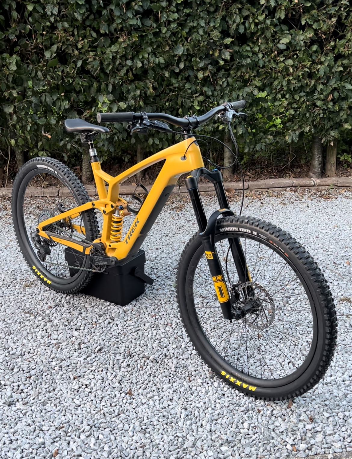

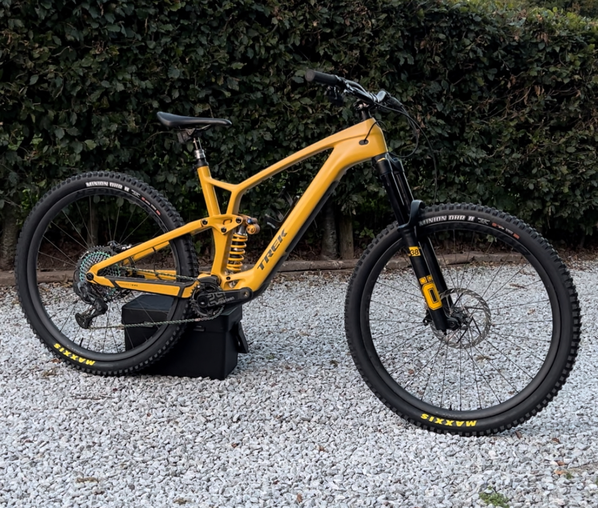

170mm Ohlins Fork, 150mm Ohlins Coil, DD DHR2
19.28 KG.

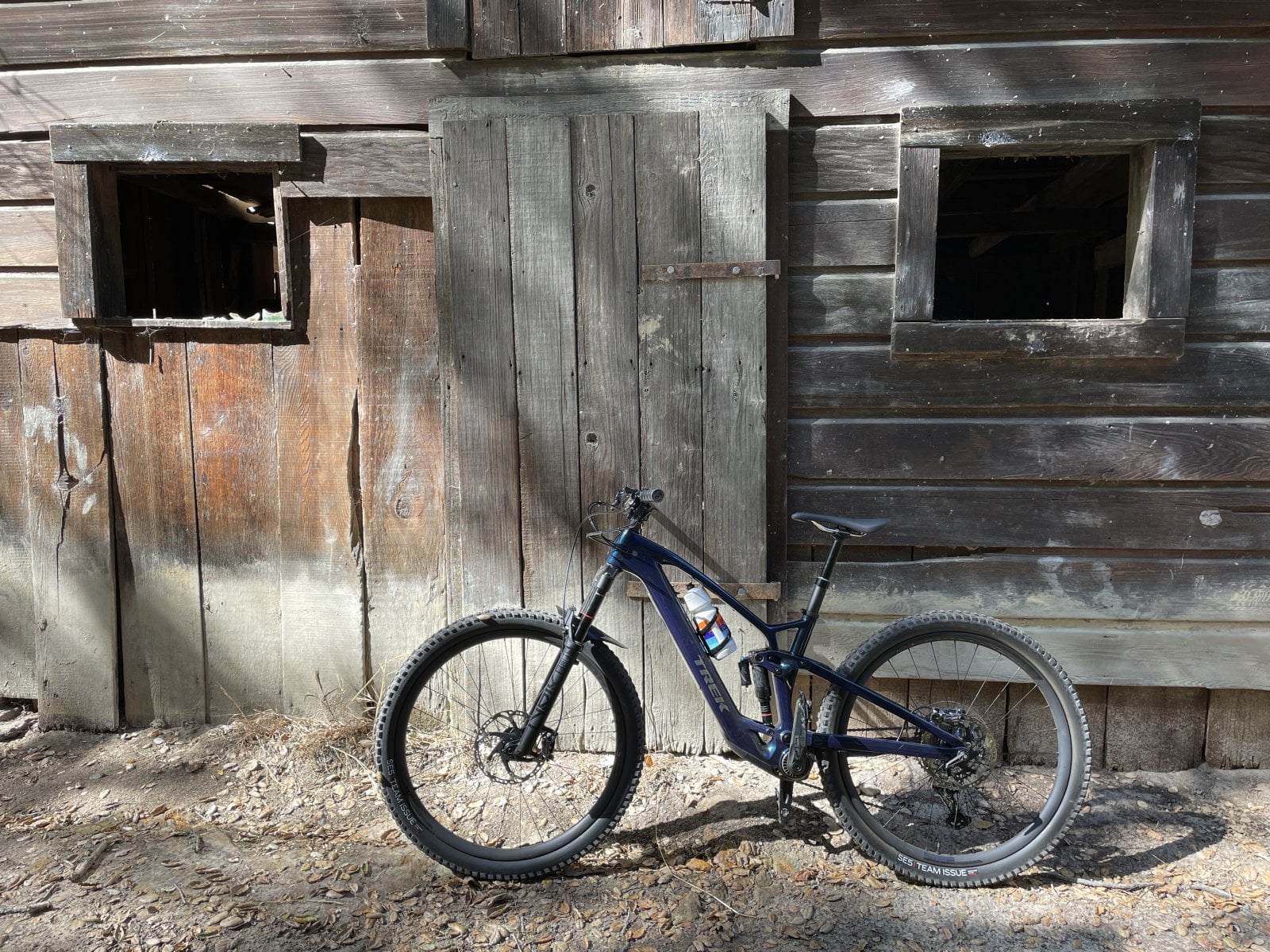

I just had my first ride on my new Trek Fuel EXe 9.8 XT. This was actually my first ride on trails with an e bike so I have no comparison info other than to my 2016 Giant 29er SC bike. The XC is a good bike with a carbon frame, carbon wheels and Shimano XT 12x. In short, I really like this new bike. I didn't notice any motor sound but I didn't take it up anything very steep. The ECO power mode was enough 95% of the time. Actually it was enough all of the time but it was fun to kick it up a notch on a couple of steeper segments. The assist was very easy to manage and not conspicuous.
The full suspension was comfy compared to my XC bike. The more slack geometry felt awkward but it wasn't a problem. I was worried about a couple of tight switchback turns on my usual ride but with this ebike I could go slower than usual and still power out of the turn in time to stay upright and make it up the hill. The bars on the Fuel are 840mm wide. On my XC bike they are 650mm wide. That is a huge difference and I definitely prefer the narrow bars. I will cut down the new ones to 720mm and see how I like them. That should make it a lot easier to adjust to the slack geometry. If anyone has any questions about any of this, please contact my publicist.

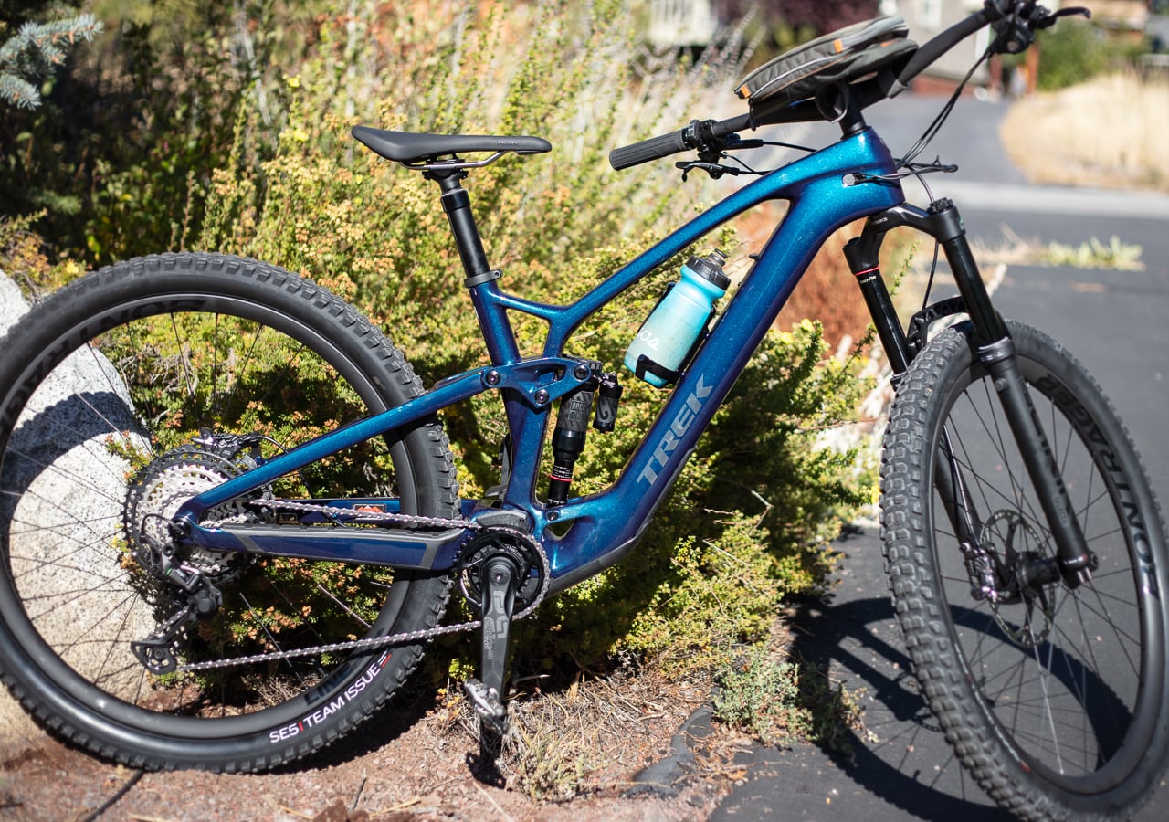

Here is a photo of it in bright sunlight. The Mulsanne Blue looks much darker in the shade.
The full suspension was comfy compared to my XC bike. The more slack geometry felt awkward but it wasn't a problem. I was worried about a couple of tight switchback turns on my usual ride but with this ebike I could go slower than usual and still power out of the turn in time to stay upright and make it up the hill. The bars on the Fuel are 84mm wide. On my XC bike they are 65mm wide. That is a huge difference and I definitely prefer the narrow bars. I will cut down the new ones to 72mm and see how I like them. The bars on the Fuel are 84mm wide. On my XC bike they are 65mm wide. That is a huge difference and I definitely prefer the narrow bars. I will cut down the new ones to 72mm and see how I like them. That should make it a lot easier to adjust to the slack geometry. If anyone has any questions about any of this, please contact my publicist.
Looks great, what size are you riding?
I’ve got a medium 9.8, and had my bars trimmed to 780mm, you’re right the stock ones are HUGE - I wouldn’t go too much smaller though, even new XC bikes now come standard with 760mm or wider bars.
I got a medium too. I'm 5'10" but I have short arms and legs and I prefer maneuverability to stability.
That looks really nice'
19.28 KG.
