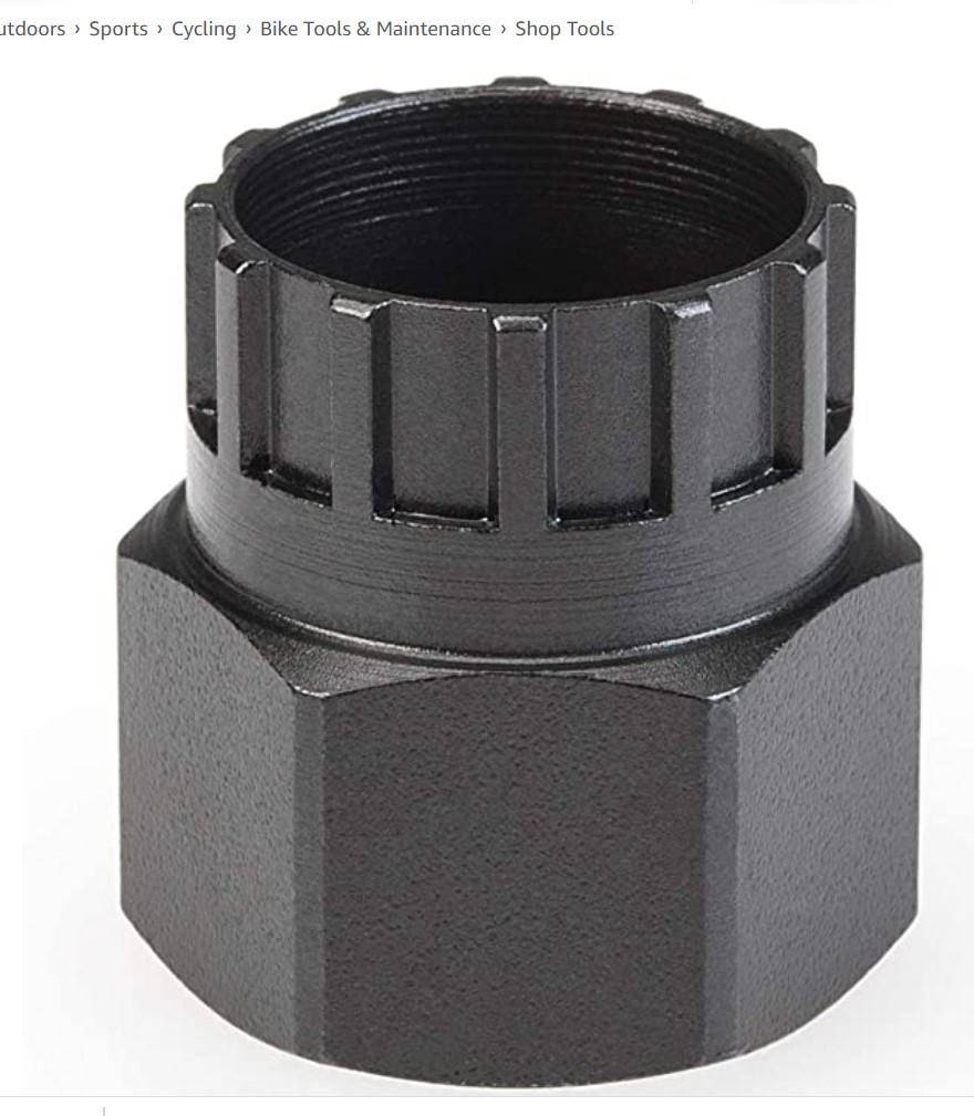

Thanks for that info! Is the lockring tightening tool the same as any standard lockring tool required for a common cassette? It looks like it could be.
That would not work, you would want a Park Tool BBT-22 or similar. The splines are different than cassette lockring. The BBT-22 is a bottom bracket tool for cartridge BBs.

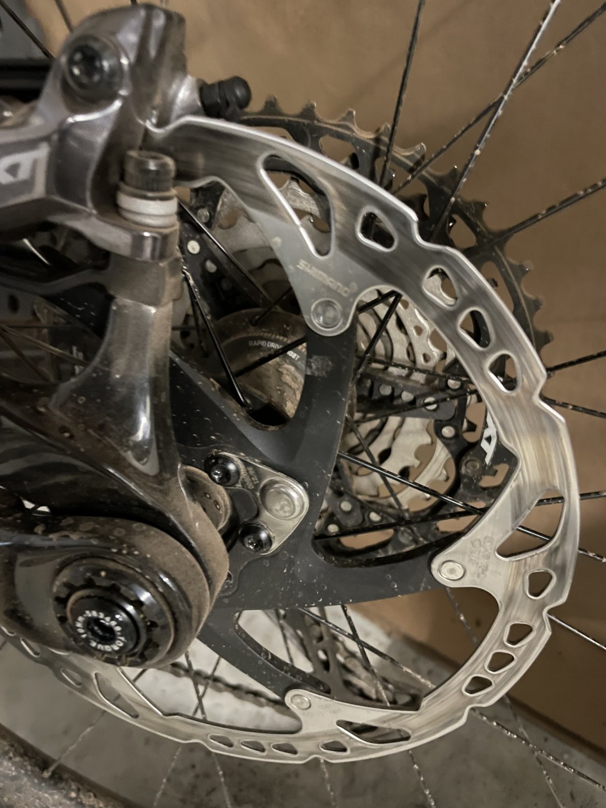

This is the magnet on my 9.8XT. I guess you can just buy another from Trek. I have a Levo one spare that *might* work. I'll be likely crossing that bridge at some point when I try mullet.
