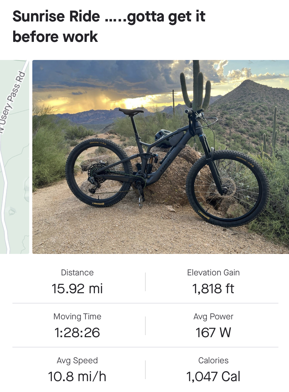

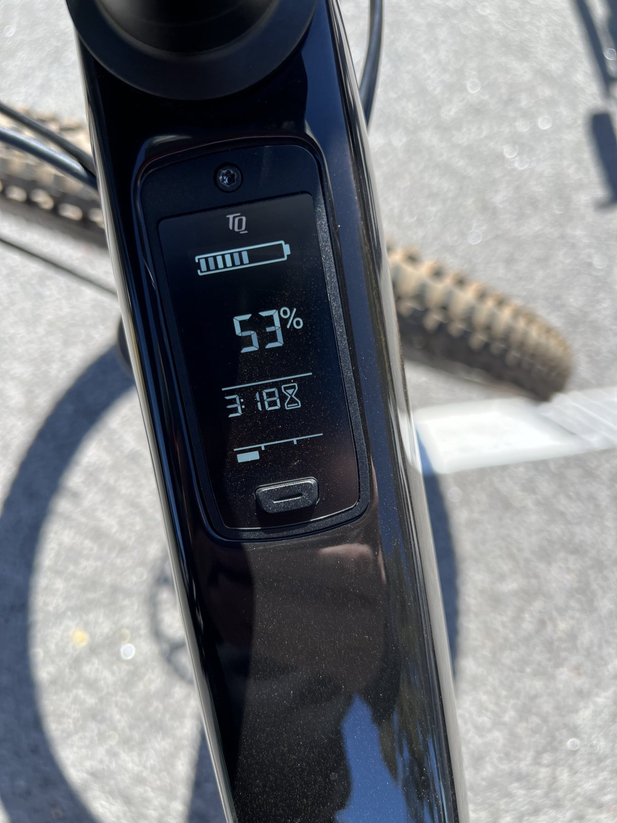

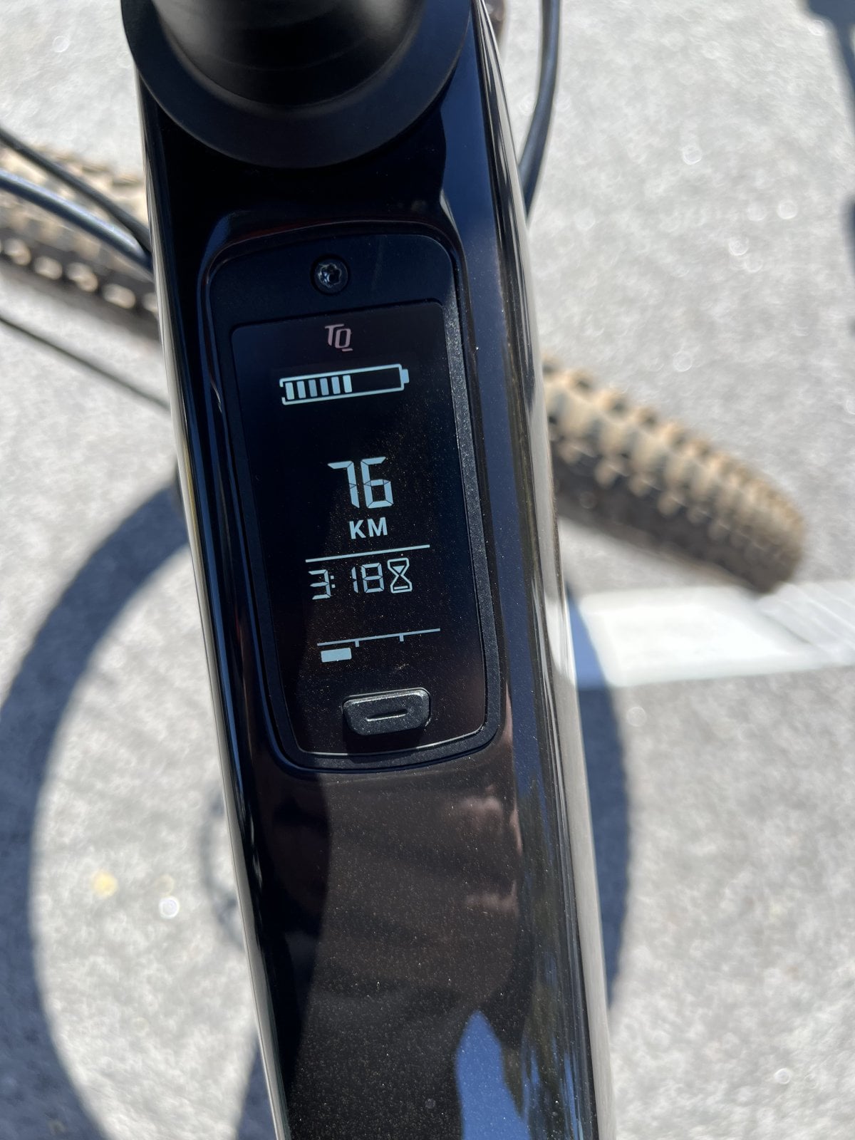

Third ride on the EXe. The power delivery is so smooth and natural. There is still no noise from the motor. Battery life was better than the last ride, but I still don’t think it is as good as my Rise was, but very close. My ride numbers are as follows:
Ascent = 1,818’
Miles = 15.92
Battery Used = 57%
If these numbers hold true for an entire ride to 0% battery, I would get the following numbers:
Ascent = 3,189
Miles = 27.92

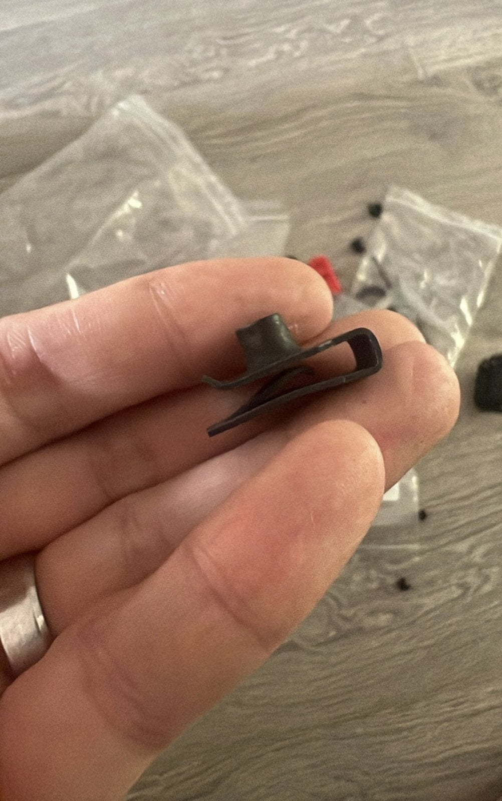

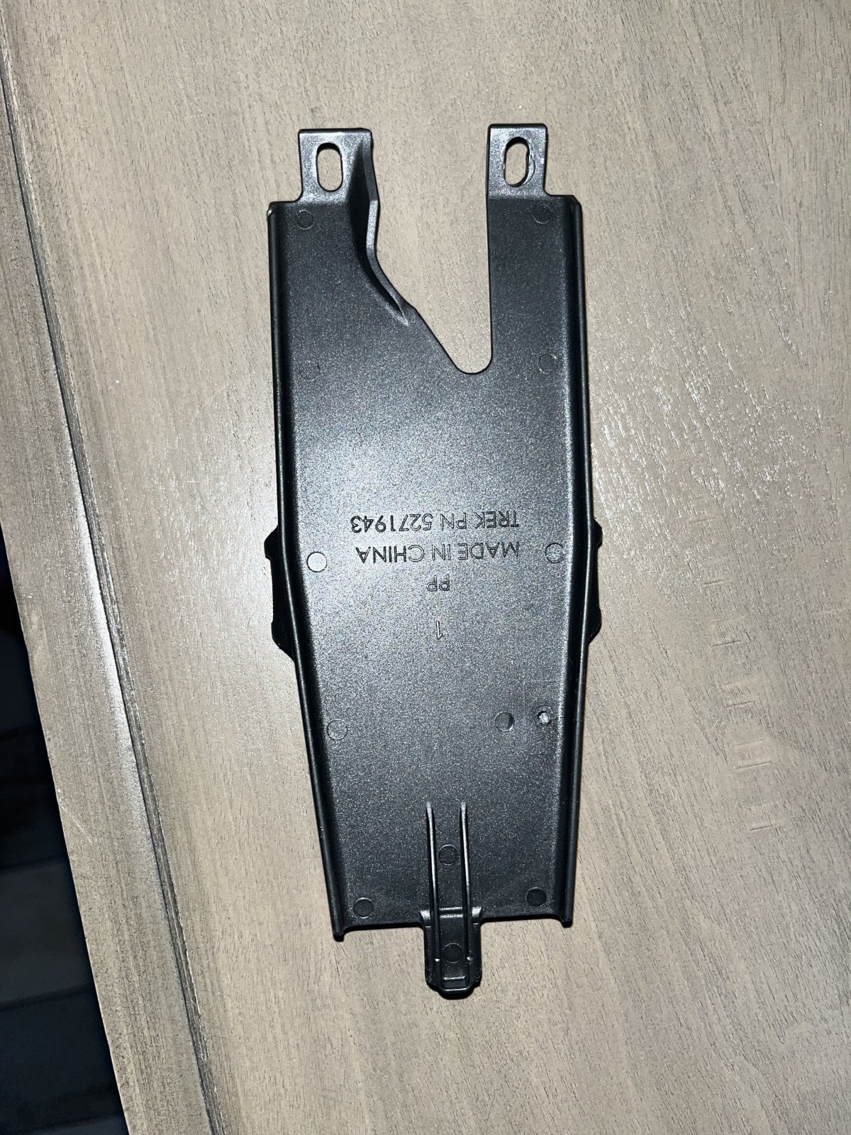

Mine came in a bag of accessories with some other pieces (tokens etc). Here’s what it looks like.
If you remove the battery to run the bike acoustic only, there is meant to be a spring clip with a threaded hole that you take off the lower battery cover (storage tab shown) and clip it over the lower mounting hole in the frame so you can re attached the lower cover. Mine didn't come with this and the bike shop says none of their bikes came with it. Is this the same for everyone?View attachment 96656

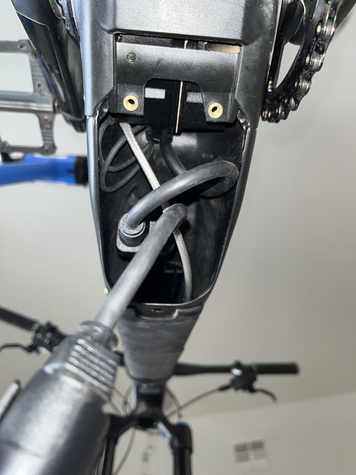

My bike was missing the clip to run it without the battery also. It was also installed without the cable covers for the battery to slide in and out without interference from the cables. I’ll show pictures above. There is also an aluminum cable organizer/ channel that runs almost the length of the top tube. It mounts to the top tube using a T-nut that slides inside the track to hold the metal channel to the top tube. The T-nut was never attached to the track. Once the battery was removed, it would not reinstall because the metal channel hung down off the top tube. I spent a lot of money for these mistakes. My LBS took care of it, but still a little frustrating. Pics and parts diagram attached for reference.
Ascent = 1,818’
Miles = 15.92
Battery Used = 57%
Ascent = 3,189
Miles = 27.92

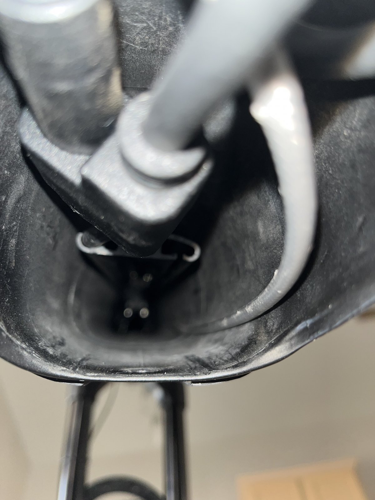

Thanks for posting re this! Very handy to know.

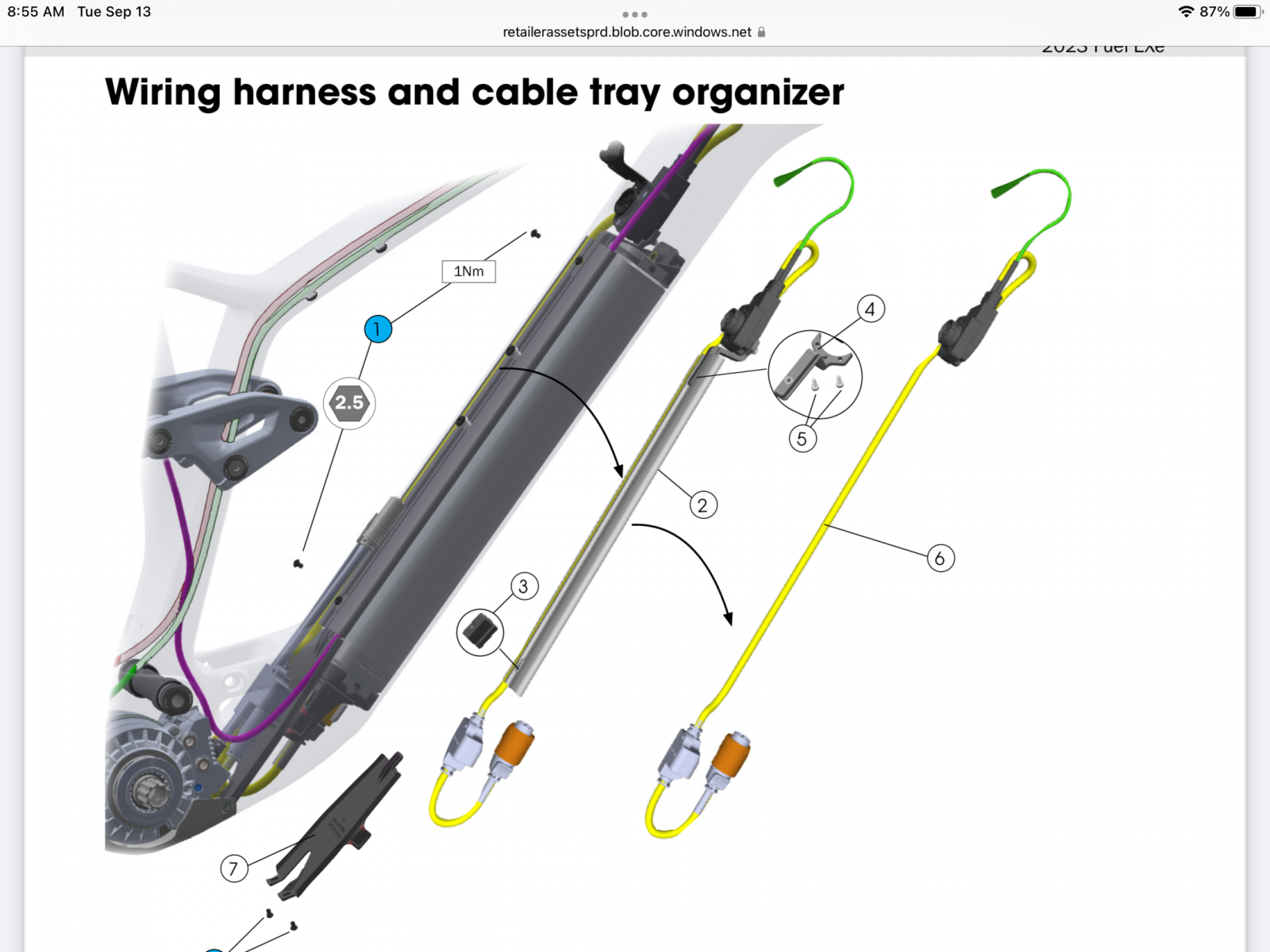

In having a close (as possible) look at the exploded parts diagram it looks like the power wire (part #6) should have run *inside* the left side of that channel (part #2) and the Dropper cable (purple) should have run inside the channel on the right hand side?
But they didn't run your Dropper cable inside the channel? Am I viewing that correctly?

I think I'm missing the bits to run without a battery. I guess I'll chase it up, even though I can't imagine using it.
you are correct, it wasn’t run inside the channel. it
yes, you are seeing that correctly. From the factory, they come with the the dropper cable inside the channel. My cable is not in the channel.
