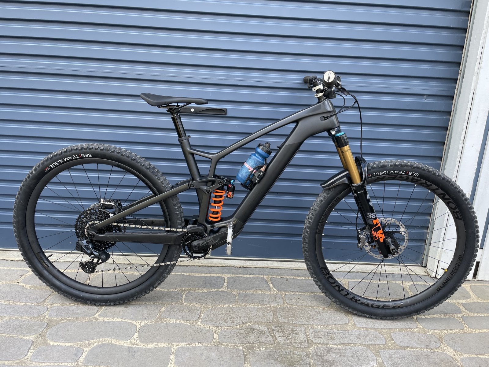

New bike day yesterday. Just received my 9.5 EXe in Dnister Black. This is a full custom build, every part except the frame and motor.
I took it for a ride this morning on some easy trails. My bike shop mechanic wanted me to go for an easy ride and bring the bike back in to re-torque the spokes. The bike has an incredibly natural feel, at times, I wasn’t sure the assist was working because the power delivery was so smooth. The motor is absolutely silent on the trail, I never heard a thing. My trails are kitty litter over hard pack, so “crunchy” sounding, which may have masked the sound a little, but again, I couldn’t hear a thing. The bike is extremely comfortable and I can easily toss it around and pop off natural features. I sized up as I am exactly between a medium and large. I made the absolute right choice. I am running this mullet with a 160 mm fork. It is definitely more lively agile than 29” front and rear. The geometry of this bike is REALLY good and I can’t wait to take it on some steeper descents.
I have ridden my previous EMTB, an Orbea Rise. The EXe is better handling, much quieter, with no motor rattling. It has a more natural feeling pedal assist than the Rise, which is hard to believe as the Rise felt really natural. It is better than the Rise in pretty much every category, except power delivery. The difference in the 50 nm motor vs. the 60 nm motor is noticeable for sure. This does not bother me as I do not want a lot of assist, I’d still like to use my legs a lot. I’ve ridden my wife’s Turbo Levo SL, and it is definitely more powerful than that bike.

That’s a beauty, congrats. For the shock, what travel did you go with? I assume currently there’s no way to install a longer travel shock?

I went with the factory size 140 mm
Beautiful bike!
I am seriously considering going the same route, 160mm fork and mullet.
What size is yours? I'm concerned about the seat tube angle and that the mullet will slacken it out too much for me. I'm 6'2" and all legs so don't want to be too far over the back wheel.
Also, is the shock 60mm stroke? Did you consider 65mm?

My bike is a large and I am 5’9”. I am exactly in between the medium and large size and went with the large. Sizing up was the right call. I was worried about the wheel base lengthening and slackening out the bike with the 160 mm fork and 27.5 rear wheeI. I thought it may affect handling, poppiness and tight turns. I’ve only take one ride thus far, but based on the first ride, none of the above will be an issue. I will have it out on a couple rides this weekend on some bigger, faster trails and will report back. I went with the factory length shock in a Fox Float X2.

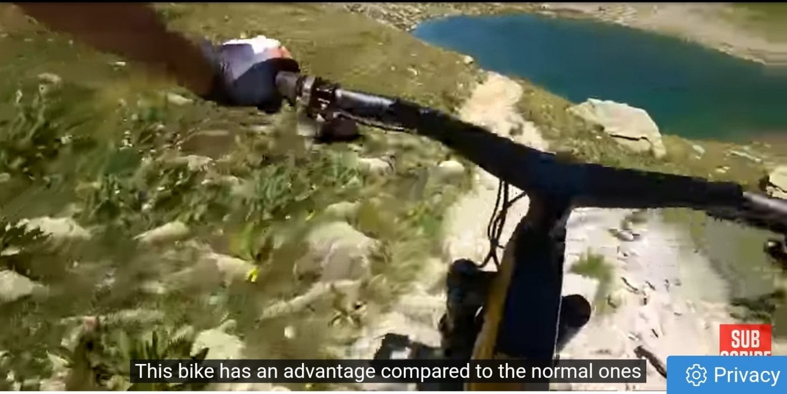

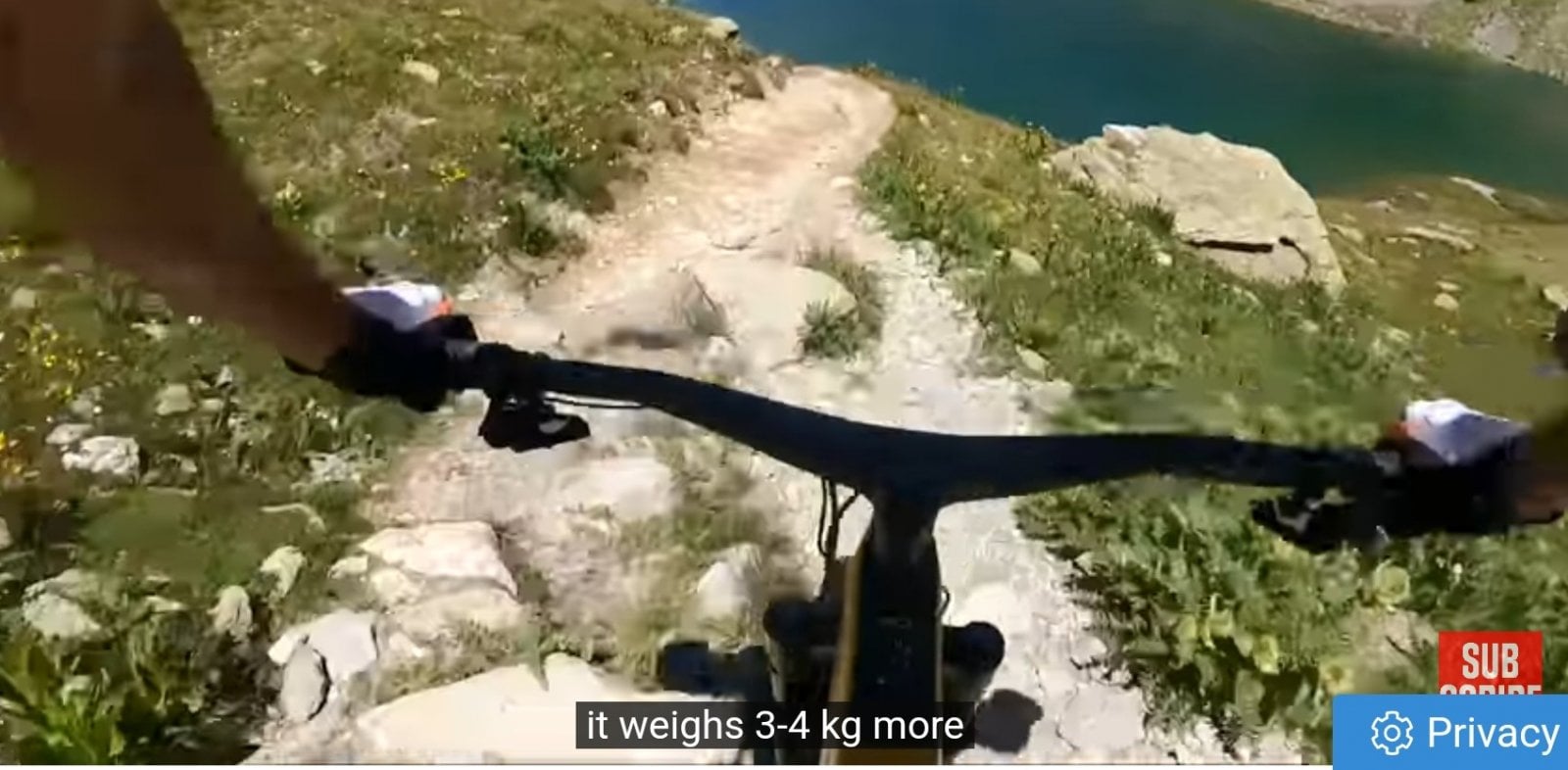

That doesn’t sound good. I don't think it's unique to the 9.8 XT models either, as they all have the same engine.

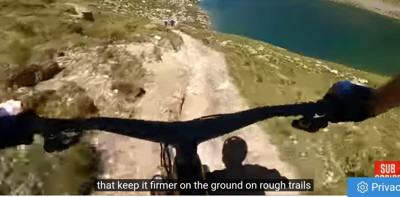

In the following YouTube test, the engine doesn't sound good either. You can hear a clicking noise with every step.
In the video the reviewer says:
"This bike has an advantage compared to normal ones ... it weighs 3-4 kg more ... that keep it firmer on the ground on rough trails."
Perhaps another 3-4 kg would keep it even firmer on the ground on rough trails?
Or even just an extra 1-1.5kg for a Bosch CX4 motor? ;)
...IMO, adding another 3 lbs AND a noisy motor isn't what this bike is about...

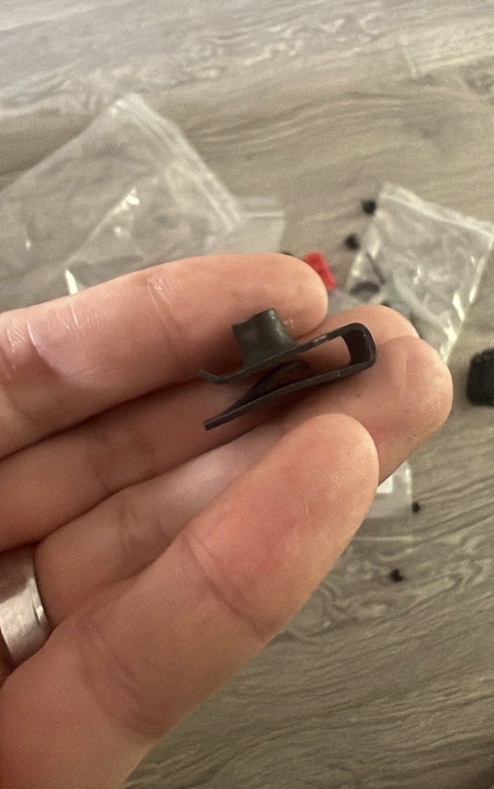

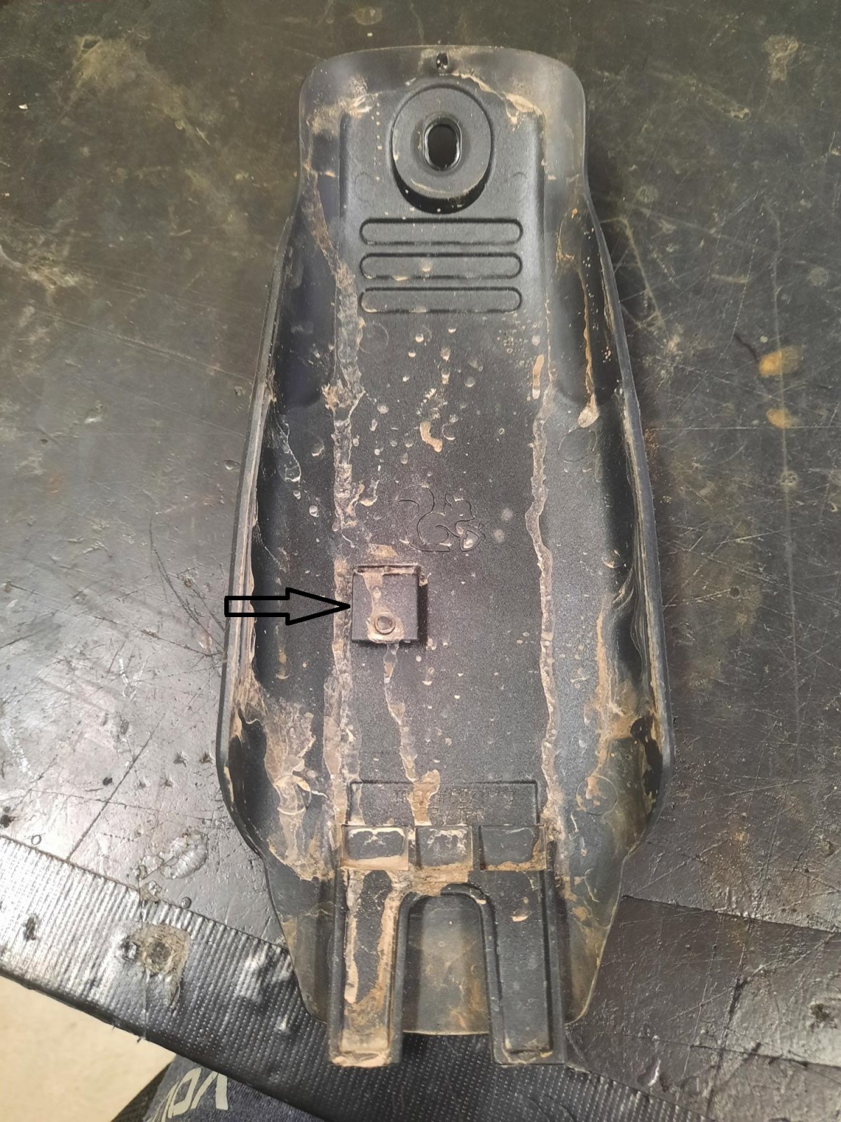

If you remove the battery to run the bike acoustic only, there is meant to be a spring clip with a threaded hole that you take off the lower battery cover (storage tab shown) and clip it over the lower mounting hole in the frame so you can re attached the lower cover. Mine didn't come with this and the bike shop says none of their bikes came with it. Is this the same for everyone?
If you remove the battery to run the bike acoustic only, there is meant to be a spring clip with a threaded hole that you take off the lower battery cover (storage tab shown) and clip it over the lower mounting hole in the frame so you can re attached the lower cover. Mine didn't come with this and the bike shop says none of their bikes came with it. Is this the same for everyone?View attachment 96656
Mine came in a bag of accessories with some other pieces (tokens etc). Here’s what it looks like.
Thanks Rob. I will go back to the bike shop and ask a few more questions. Didn't get any tokens either. Maybe the 9.7 doesn't come with tokens though.
