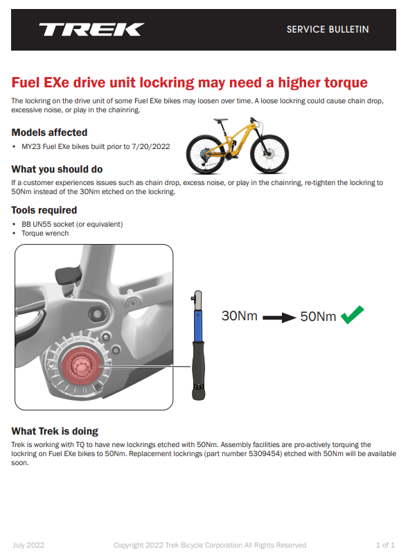

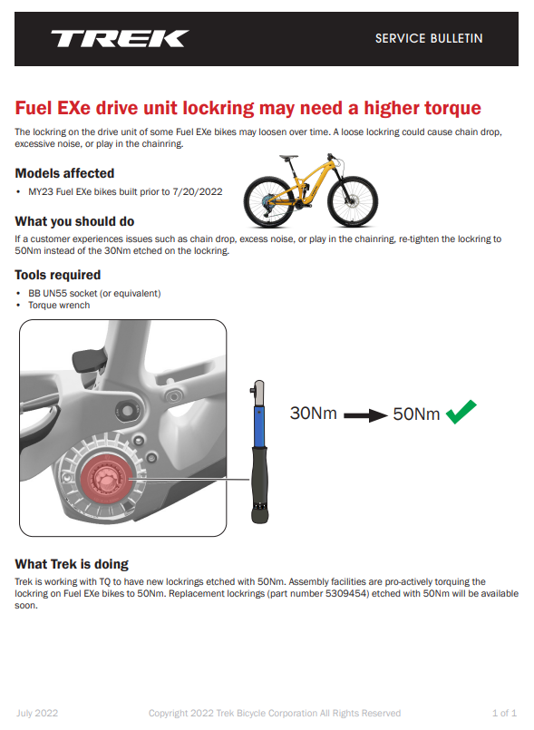

Thanks for the tag, folks. Jujujuice and I have been in discussion as he is communicating with me through Instagram. We're unsure of the issue and I haven't been privy to any updates since our team in Australia is working with that dealer and also in communication with TQ. It does sound like either a service bulletin is missed or there is something about those specific motors causing it to sound off. I've ridden three of these so far and they've all been quiet and I haven't had any of the symptoms. Either way, we'll spend time with TQ to look into it and find a solution.
Also, see attached for the lockring service bulletin. This reads exactly like the noise being described.
My LBS did this and it did not make a bit difference in my grind/clatter sound.
I listened to the video and the grinding does sound annoying. Does it make the grinding noise when you are coasting too? I think I could hear the grinding when I could also hear the cassette spin.
It is odd that the noise is so conspicuous in the video but was quiet or unnoticeable at the shop. I added your noise video.
noise video
The sounds between the clattering sounds are the baseline motor sound and chain and cassette sound , Which are normal. My phone just exaggerates everything.
Found it Thankyou!
And yes I have also been constantly dropping chains along with the creaking. Much appreciated.
When I replaced the chain on mine it was clear the chain guide was positioned way too high and not doing anything I lowered it by a fair bit too make it work.
Not sure if this is the same for yours?

Get your chainring torque checked owners. After two rides this weekend I had major creaking from the BB. After my ride yesterday I felt the chainring was a bit loose by moving it with my hand.
When the cranks were removed the chainring was hardly hand tight.
My bike has the 30nm stamp on it but the serial (still speculation) suggests it's one of the newer models that got torqued properly from the factory.
Torqued it to 50nm this morning and all good now!
By "Chainring", I think you mean "Lockring".
That lock ring must have a bunch of margin in it. Going from 22 ft-lbs to 36 ft-lbs (60% higher) is pretty extreme for the same part. Yet no talk about any Loctite to keep it there over time. There is a bunch of high and cyclic loading going on down there that would benefit from a secondary locking feature.
I wonder if it was designed to be torqued to 50Nm or 30Nm? I hope it was designed for 50Nm and there was a miscommunication between engineering and mfg.
