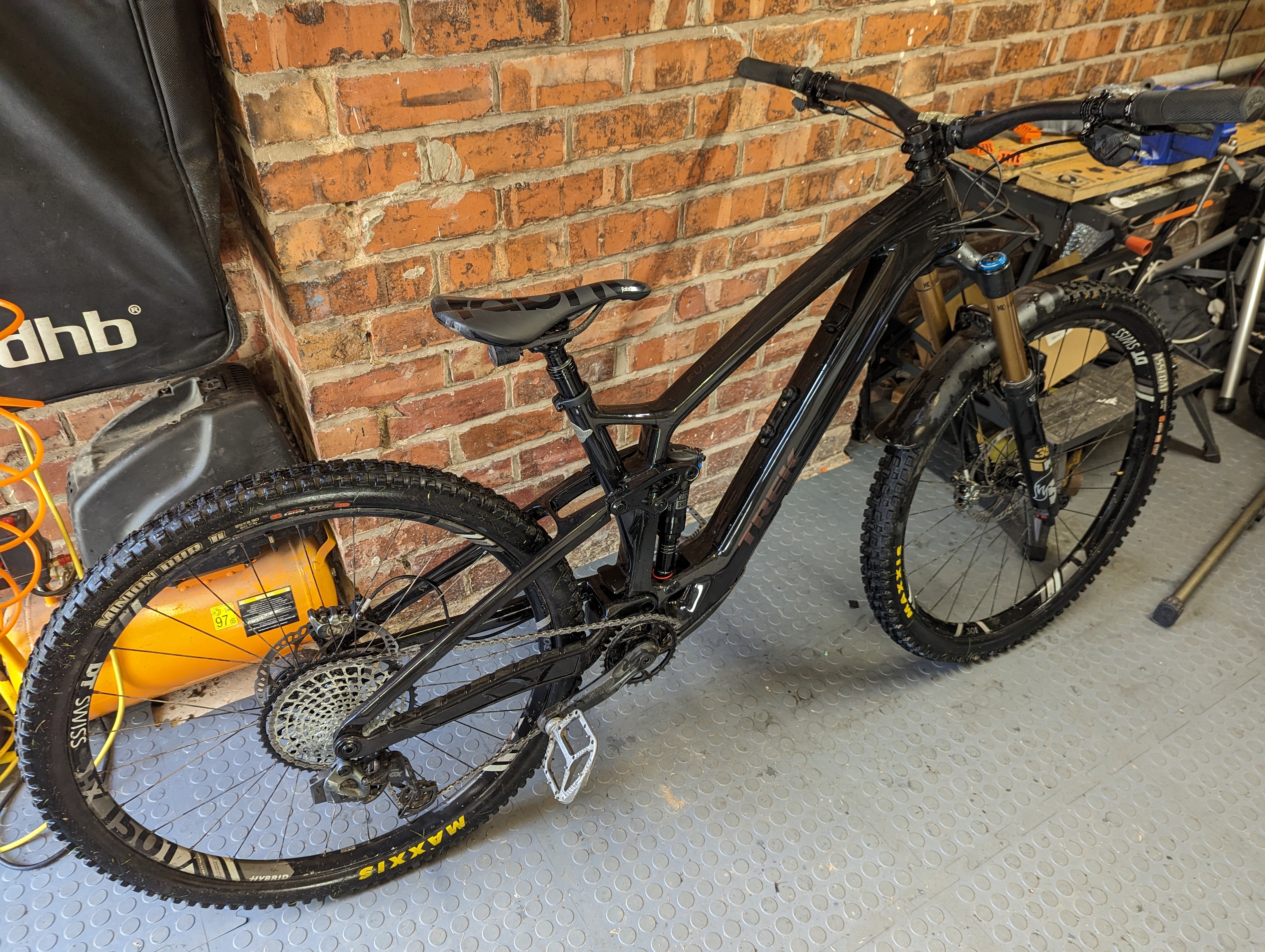

Yesterday I had my first ride and it feels great. In eco (max 80W) and mid (max 150W) motor is practically silent, in max it can be heard but it is not annoying. I think in eco 1500-1800 meters elevation are possible. Went down on a S1/S2 trail and it felt great also down. Very smooth on the fast parts of the trail and enough adsorbing on the rough stuff.
Mine's still basically stock, apart from the 160mm Lyrik.
Small niggles aside, I really like the way the bike rides. It's my first proper emtb and it does exactly what I hoped - smooth, quiet, great geometry, and rides like a (slightly heavy) regular bike. No range anxiety since I'm still used to an analogue bike and it's fine with the assist switched off.
Really gotta sort out that front brake cable...!

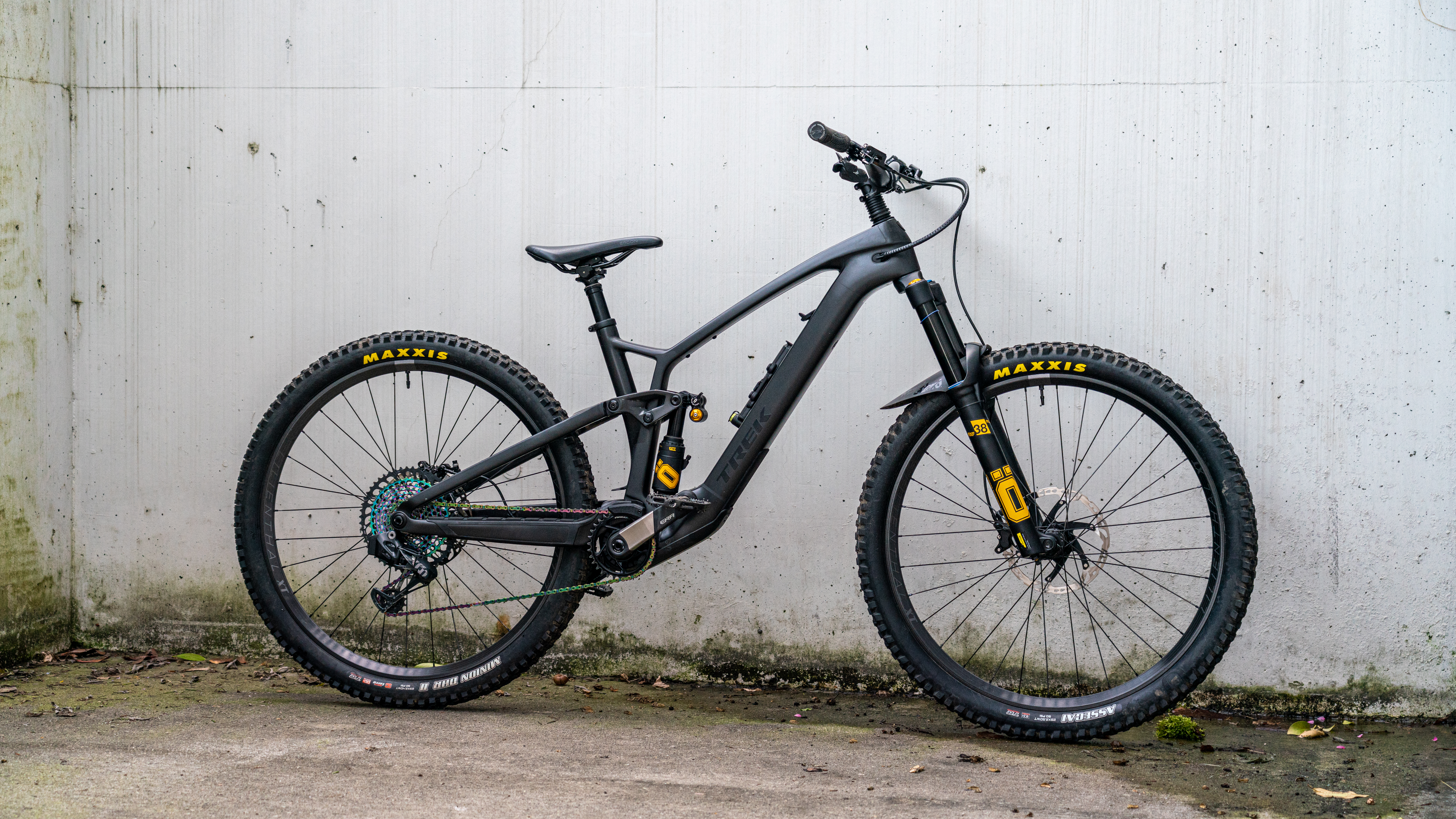

I had ordered the Fuel EXE 9.8 GX AXS, but after the delivery date kept being pushed back, I decided on an existing 9.5.
I then invested the saved money in some nice parts:
-Öhlins RXF 38 and TTX2
-I9 Hubs with Lilienthal Rims
-Direttissima Brakes
-OneUp pedals and bar
-AXS derailleur
-ERA carbon cranks
The RXF surprised me very positively, very comfortable and yet good ground feedback.
Despite the large fork, the weight remains relatively low. 18.9 kg with pedals.
edit: smaller picture size

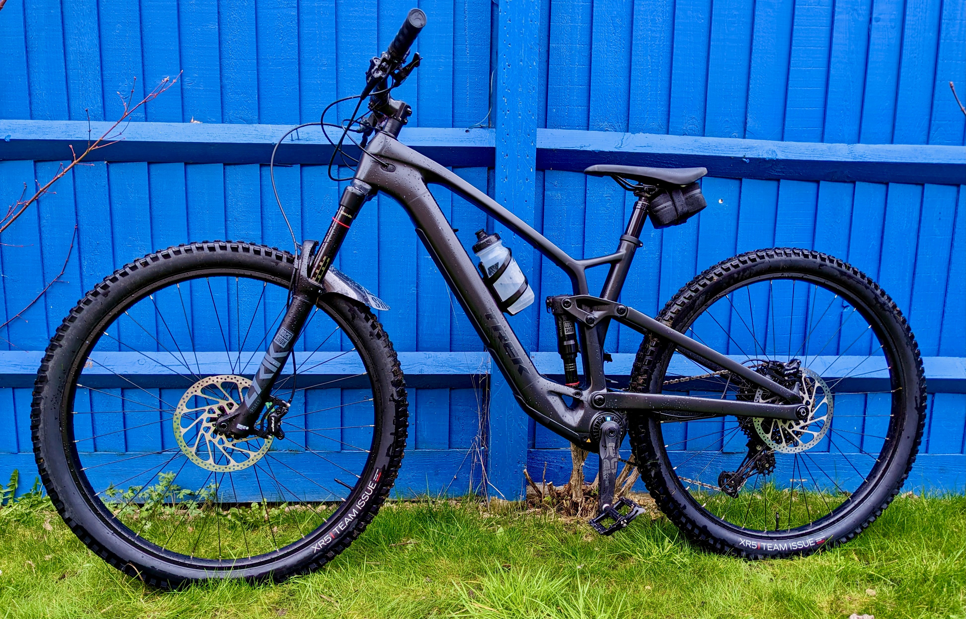

Here is my current build:
Build Kit:
- X01 AXS derailleur and shifter
- X01 Eagle cassette
- XX1 Eagle Chain
- I9 Hydra Hubs
- Nox Farlow; 27.5 rear wheel / 29 front wheel (gonna run it mullet)
- DT Swiss Competition Spokes
- Deity Bladerunner pedals
- Deity Apex 35 stem
- Deity Skywire 35 mm handlebars
- 5DEV 155 mm cranks
- Shimano XTR brakes
- Bike Yoke Revive dropper post, 160 mm
- Rck Shox Super Ultimate Deluxe coil shock w/ Sprindex coil
- Fox 36 Performance Elite 160 mm fork
- Specialized Power Arc Pro seat
- SRAM HS2 disc brake rotors - 200 mm
- Bridgestone Kryptotal RE 27.5 (rear tire); Kryptotal FR 29 (front tire)
- Lizard Skin Peatty lock-on grips
- Jagwire braided cables
- Trek Range Extender (should arrive in less than a month)

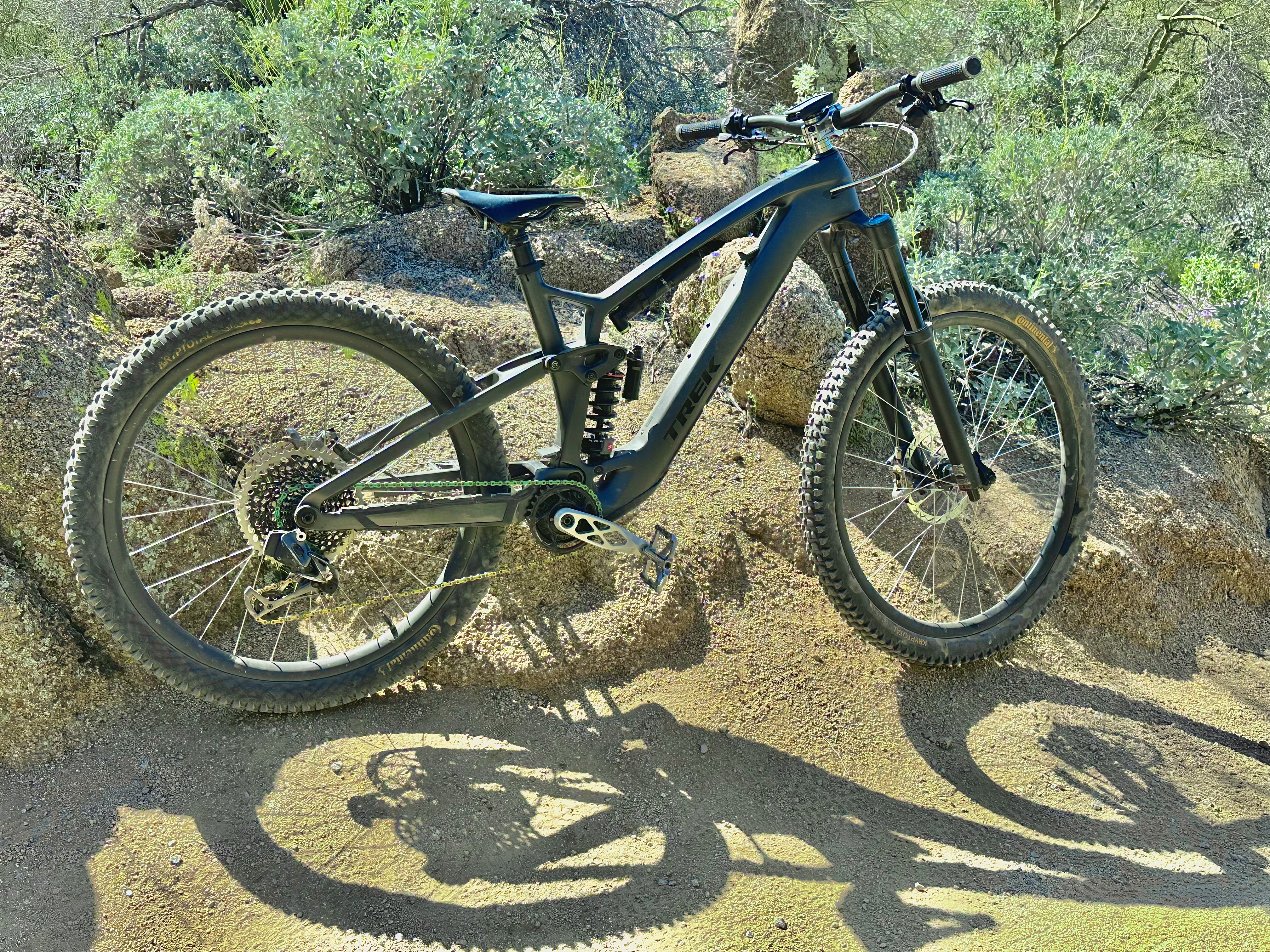

Just a quick question: how do you like the geometry with 160mm fork in combination with mullet? Is it not a too flat drive angle?
I really like this in mullet. This is my first mullet. It definitely makes it a little more agile and able to handle tight corners and switchbacks better. As an example, my Orbea Rise was 29”/29” with a shorter wheelbase. The mullet EXe still handles tight stuff better.
I
have been riding mullet alver the last 8 years (27.5/26) pedal bike nd I loved it. I made my 9.5 built also mullet, but I got a 150mm fork, therefore I asked how it feel because maybe I might choae to longer my fork with another air spring.

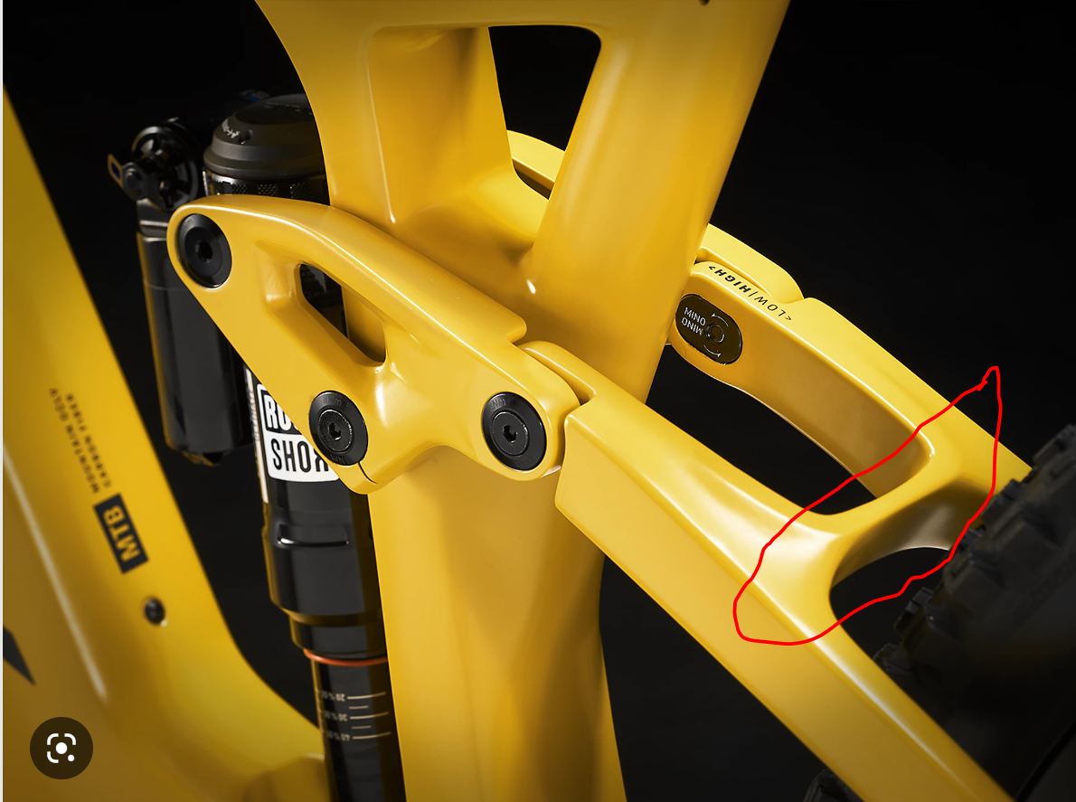

How do you find it with the coil? Are you running a bit of additional stroke? Plenty of clearance with the smaller rear wheel I guess.
I have an old bike with coil suspension (2007 SX Trail II) and always loved the feel of the ride. Tempted to do the same as you.
160 mm / 152 mm
I tried 65mm stroke for 152mm rear travel too but I got a bit scared looking at clearance on hard compressions,so I have ordered a 2.5mm spacer making it 146mm instead.
Balancing the 6mm extra travel vs potential issues with the rear triangle made the choice easy for me.
I urge you do release all air ( or use no spring and compress you frame completely) and the factor in a bit of flex too. I got scared. Maybe you are more brave than me :)
Agree - I had a look at mine using a 65mm stroke shock from my other bike, and it looks too close for comfort - the bridge between the seat stays comes very close to the seat tube - all it would take is a bit of flex in the system somewhere and there would be a nasty crunching sound.
But if you run it mullet - 27.5 at the rear then this should give enough space given the smaller diameter of the wheel, right?
It might/should do if you run the bike in the mino link high position as this would move the seat stay bridge further away from the seat tube, but I didnt try this out. It has nothing to do with the wheel size as such , its the seat stay bridge that is the potential problem.
Yes, you are absolutely right - I forgot about this bridge. Thank you for the selfexplaining picture...
